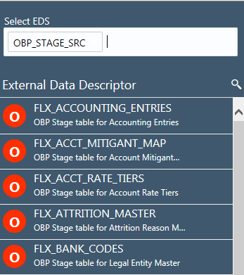

4.     To define a connector, you must have a source with EDD and a target, which is ADI.
5.     Click Source to select the required EDDs. Here, you can filter your selection based on the EDS selected. The EDD node’s color depends on the source system type.
Figure 27: Connectors - Source
Description of Connectors - Source Window This illustrations displays EDD list.
For example:
§       File types are in blue.
§       Oracle types are in red.
§       HDFS types are in orange.
6.     If you select ‘OBP_STAGE_SRC’ as the EDS, it displays the EDDs for that particular EDS selected.
7.     Click Search Search icon  to search for a particular EDD. You can select multiple EDS.

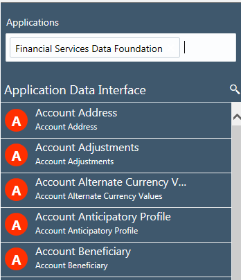

9.     Click Target. Here you can filter ADIs based on the application selected.
Figure 28: Connectors - Target
Description of Connectors - Target Window This illustrations displays ADI list.
10.  Click Search to search for a particular ADI.
11.  Select the required ADI. Drag it to the canvas and then link the input and output nodes.

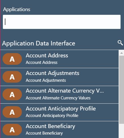

5.     Click Source to select the required ADIs.
6.     Here, you can filter your selection based on the ADI selected. The ADI node’s color depends on the source system type.
7.     Click Search Search icon to search for a particular ADI.
8.     Select the required ADI. Drag it to the canvas and then link the input and output nodes.

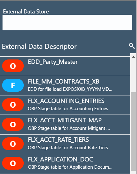

9.     Click Target. Here you can filter EDS based on the application selected.
Figure 32: Connectors - Target
10.  If you select ‘OBP_STAGE_SRC’ as the EDS, it displays the EDDs for that particular EDS selected.
11.  Click Search Search icon  to search for a particular EDD. You can select multiple EDS.
12.  Select the required EDD and drag it to the canvas.
