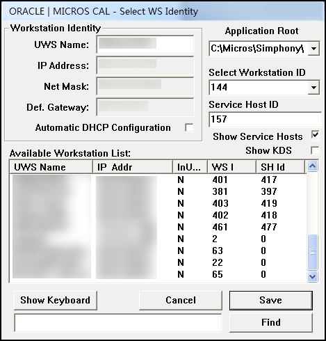

  9. In the Select WS Identity dialog, select the Show Service Hosts option, select the appropriate service host from the available workstation list, and then press Save. Make sure the Service Host ID and Workstation ID populate. The workstation automatically restarts several times when installing the CAL package.
    Figure 38-2 Select Workstation Dialog
    This figure shows the Select WS Identity dialog.

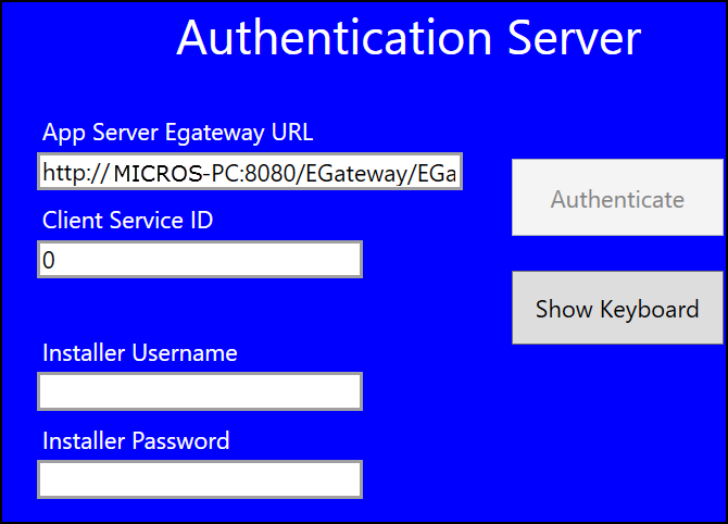

    2. For Simphony version 2.9, enter the following details in the Authentication Server application:
      • Client Service ID: Enter the Service ID for Check and Posting. You can find the Service ID in the Workstations tab of the Property Parameters module.
      • Installer Username: Enter the Install User Security Username configured in the Security tab of the Property Parameters module. Contact your system administrator for assistance.
      • Installer Password: Enter the Install User Security Password configured in the Security tab of the Property Parameters module. Contact your system administrator for assistance.
      Figure 38-3 Authentication Server Application for Simphony 2.9
      This figure shows the Authentication Server application in Simphony 2.9.

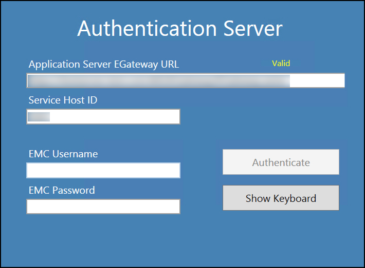

    3. For Simphony version 2.9.2 and later, enter the following details in the Authentication Server application:
      • Service Host ID: The service host ID. This value is automatically populated.
      • EMC Username: Enter your EMC user name.
      • EMC Password: Enter your EMC password.
      Figure 38-4 Authentication Server Application for Simphony 2.9.2
      This figure shows the Authentication Server application in Simphony 2.9.2.
