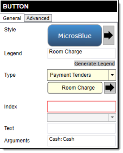

  4. Click Button.
  5. On the General subtab, enter the button name in the Legend field.
  6. Select Payment Tenders from the Type drop-down list.
  7. In the Select Tender/Media Payment dialog, select the OPERA PMS room charge payment tender, and then click OK.
  8. In the Select Payment Type area, select Other1:LoadablePms from the Payment Type drop-down list.
  9. Click the Edit... link in the Command column.
  10. In the Payment Configuration dialog, select the Opera payment method from the Functions drop-down list.
  11. Position and size the button on the page. Use the Style arrow to change the color.
    Figure 56-17 Room Charge Payment Button
    This figure shows a Room Charge payment button as configured in the Page Design module.
  12. Click Save.
