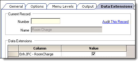

  9. Click the Data Extensions tab, and then select the check box in the Value column for the Enh.IFC – Room Charge.
    The Value check-box must be selected for the room charge tender media(s). Deselect the check-box for all other tender medias.
    Figure 56-16 Tender/Media Room Charge Data Extensions Tab
    This figure shows a required Tender/Media Room Charge data extension configuration.
