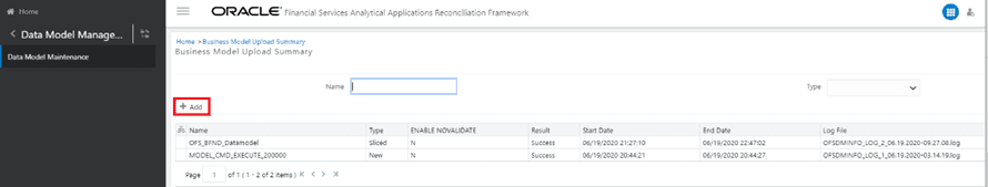

1.     Click Data Model Management on the left pane of the OFSAAI platform.
2.     Navigate to Data Model Management, and select Data Model Maintenance.
Figure 5: Business Model Upload Summary Page
This illustration shows the Business Model Upload Summary Page that the user can use to Add and upload the model.
3.     Click + Add icon to open up the Business Model Upload window.

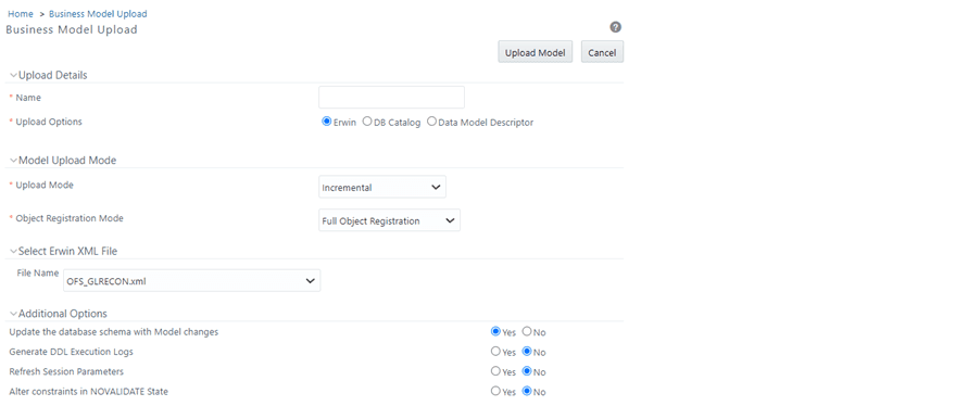

Figure 6: Business Model Upload Window
This illustration shows the Business Model Upload Window, where the user needs to enter the Mandatory fields that include, Name Upload Options, Upload Mode, and Object Registration Mode. There is also an Additional Options section, select the required options, and Upload the Model.
4.     In the Business Model Upload window, enter the Mandatory fields.
5.     In the Upload Details pane, enter the Model Name and Select Upload Options as Erwin.
6.     Select the Upload Model from the drop-down list. You can select Incremental, Rebuild, or Sliced upload mode.
7.     Select the Object Registration Mode from the drop-down list as Full Object Registration or Incremental Object Registration. You can select Incremental Object Registration for the Upload Mode as Incremental and Sliced. It is recommended to select incremental only if the changes are minimal.
8.     Select the Erwin XML or Database XML file for upload from the File Name drop-down list.
9.     In the Additional Options pane, select the required options.
10.  Click the Upload Model button to upload the model.
