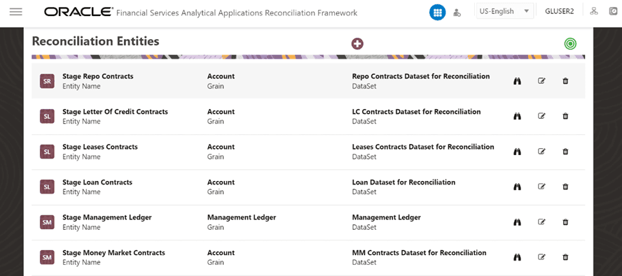

Figure 9: Entity Configuration Page
NOTE:
The Reconciliation Entities window consists of predefined data. You can Add, View, Edit, or Delete the reconciliation entities using these predefined data.
Topics:
· Navigation within the Entity Configuration
When you navigate to the Reconciliation Entities screen, the settings are presented as a list. This Settings page displays the following information about the entity:
· Entity Name: The name of the Reconciliation Entity.
· Grain: The Granularity of data within the entity, for example, Ledger, and Account.
· DataSet: Add the Dataset from the drop-down list for the selected Entity.
You can add the new entities in this Reconciliation Entities window, each entity can further be viewed, edited, or deleted.
You can perform various activities on the selected entity in the Reconciliation Entities window.

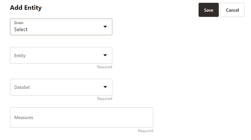

· Add
: Click the Add icon
to add a new entity to the Reconciliation Entities window. The Add
Entity window is displayed.
Figure 10: Add Entity Window
Enter the information in the following fields:
§ Grain: The Granularity of data within the entity, ex, Ledger, Account.
§ Entity: The name of the Reconciliation Entity.
§ DataSet: Add the Dataset from the drop-down list for the selected Entity.
§ Measures: Select the relevance Balance attribute. Multiple selections are permitted.

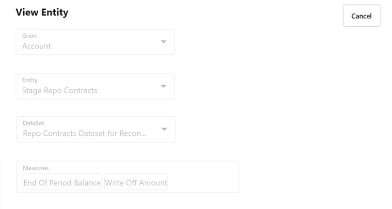

· View
: Click the View icon
to view the detailed definition of an entity in read-only mode. For example,
the following window is displayed for the Stage General Ledger Data is
displayed.
Figure 11: View Entity Window

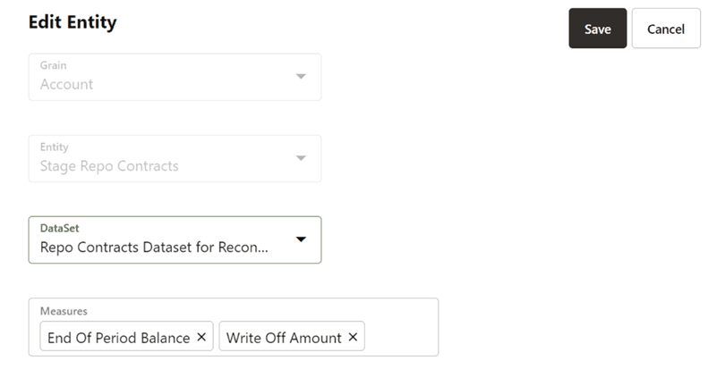

· Edit
: Click the Edit icon
to modify the entity settings. The Edit functionality is only enabled
for DataSet and Measures.
NOTE:
If you modify DataSet and Measures it might impact the rules in which this entity is being used.
Figure 12: Edit Entity Window

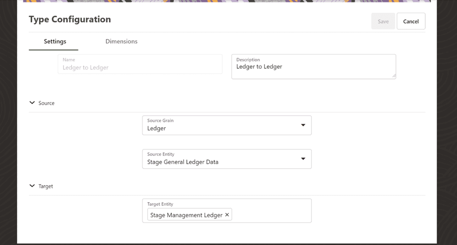

The Type Configuration page lists the predefined reconciliation definition types that can be used during a reconciliation definition. These configurations are:
· General Ledger to Product Processor
· Ledger to Ledger

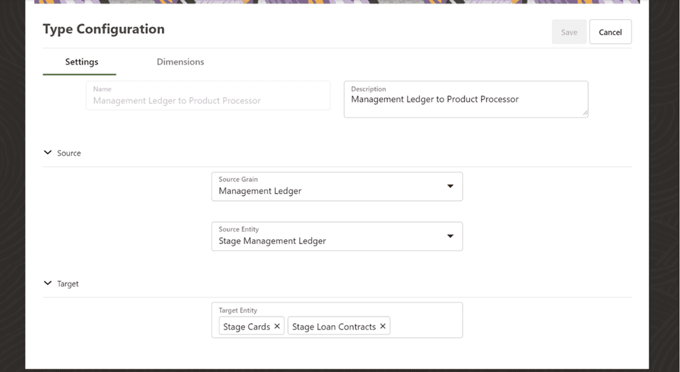

· Management Ledger to Product Processor

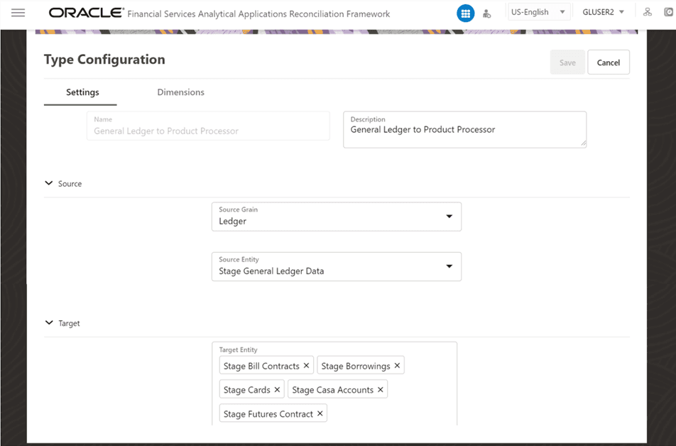

You can navigate to Type Configuration, and select General Ledger to Product Processor, to View, Edit, or Delete General Ledger to Product Processor type.
It consists of two tabs:
· Settings
· Dimensions
The Settings tab displays the name and the description of the reconciliation type that you want to view (General Ledger to Product Processor configuration for this section).
It is further divided into two panes:
· Source: This pane displays the Source Grain and the Source Entity for General Ledger to Product Processor type. The Stage General Ledger data is the default source entity used for reconciliation definition.
· Target: This pane displays the Target Grain and Target Entity for General Ledger to Product Processor type. The Target entities refer to the Stage instrument tables (Product Processors) of the Oracle Financial Services Data Foundation.
When you click the View icon, you can only view the selected reconciliation type, on the Settings page. All the panes in the Settings page are disabled for modifying the Reconciliation type in the Read-only mode.
Click the Edit icon to edit the selected reconciliation type. All the panes in the Settings tab are enabled for editing except the Name.
Figure 14: General Ledger to Product Processor Settings Tab for Edit

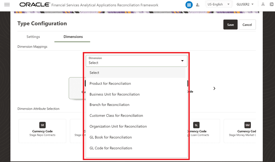

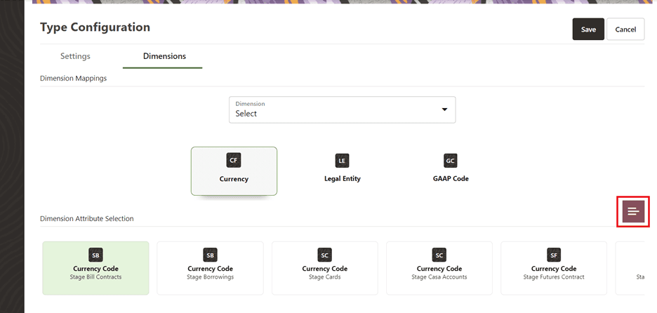

The Dimensions tab consists of two panes as Dimension Mapping, and Dimension Attribute Selection. The dimensions such as Legal Entity, Currency, and GAAP Code are mandatory dimensions and must be selected to proceed with GL Reconciliation executions.
NOTE:
It is assumed that mandatory reconciliation dimensions are present in all the bank’s GL source systems.
· Dimension Mapping: This pane displays the Legal Entity, Currency, and GAAP Code for the selected dimension. The dimensions Legal Entity, Currency, and GAAP Code must be selected to proceed with the GL Reconciliation executions. You can configure additional optional dimensions based on the requirement.
· Dimension Attribute Selection: This pane allows you to map the respective dimension attribute to each of the entities selected in the Settings view. As an example, the Stage Cards, Stage General Ledger Data, and Stage Loan Contracts have been configured for dimensions.
When you click the View icon in this pane, the corresponding mappings of the entities present in the Dimension mapping pane are displayed with the selected dimension attributes in a read-only mode.
NOTE:
The Dimensions tab functions remain the same for all three types of configurations.
Figure 15: Dimensions Tab for View
Topics:

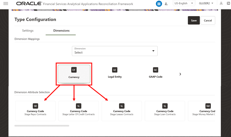

When you select the Dimension from the drop-down list in this pane, the mapping of the respective dimension is done for all the entities defined in the Settings tab.
Figure 16: Dimensions Tab Edit
You can select the optional dimensions such as Product, Organization Unit, and so on and map these dimensions to the Reconciliation type, so for each dimension respective attributes of the entities must be selected. For more information on the optional dimensions, see the Data Requirement section.
By default, these mandatory dimensions Legal Entity, Currency, and GAAP Code are available in the reconciliation type.
For example, only a Legal Entity dimension must be selected against the Legal Entity and any other dimension cannot be selected. You are expected to select a valid Legal Entity, GAAP, and Currency hierarchy while configuring the mandatory dimensions.
You can select one or more entities to map the attributes for the respective dimension.

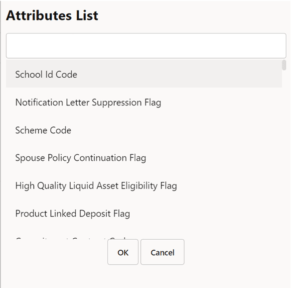

Select any of the entities within the Dimension Attributes Selection pane to enable the Attribute icon. Click Attributes to add optional Dimension Attributes.
Figure 17: Attribute Icon on Dimensions Tab
The Attributes list displays the list of the attributes that can be associated with the selected Dimension Attributes, as shown in Figure 18. The attribute list shows the combined attributes for all the Stage tables selected.
Select the attributes and click the OK button.
Figure 18: Attribute List window
In the Ledger to Ledger (GL to GL) reconciliation, the difference between two sources of the GL for the same Legal Entity and the Consolidation Type is identified. This difference is identified at the granularity of the GL code for the selected hierarchy, the mandatory dimensions, and the selected optional dimensions. Adjustments are not passed in the Ledger to Ledger reconciliation. Also, the difference is identified by comparing the Source Ledger with the Target Ledger, to ensure that all the GL codes’ amount is covered to calculate the difference.
A Legal Entity in the bank can maintain the same GL data (either solo or consolidated) in one or more source systems. If GL data is maintained in the multiple source systems, then it is essential to compare the GL balances among such GL sources to ensure that all GL sources reflect the accurate and uniform balance. Any difference, between two GL source systems, is expected to be rectified outside the framework. Reconciliation definition is applied at Legal Entity Level - either Solo or Consolidated.
NOTE:
The Adjustment Entry is not passed in the GL to GL reconciliation.
NOTE:
The STG_MANAGEMENT_LEDGER table is included in the data model of the OFSAA Reconciliation Framework. This table can be used as a Target Ledger table. The STG_MANAGEMENT_LEDGER is a single table to store the thick ledger of the bank and it is configuration.
Topics:
· Navigation within the Settings
· Navigation within the Dimensions
You can navigate to Type Configuration, and selecting Ledger to Ledger, to either View, Edit, or Delete Ledger to Ledger type.
· Settings
· Dimensions
The Settings tab displays the name and the description of the reconciliation type that you want to view (Ledger to Ledger configuration for this pane).
· Source: This pane displays the Source Grain (Ledger) and the Source Entity for the Ledger to Ledger type. The Stage General Ledger data is the default Source Entity used for reconciliation.
· Target: This pane displays the Target Grain (Management Ledger) and the Target Entity for the Ledger to Ledger type. The Target entities refer to the Stage Management Ledger tables (Ledger) of the Oracle Financial Services Data Foundation application.
When you click the View icon for the selected reconciliation type, you cannot make any changes on the settings page, as it is in the read-only mode. All the panes on the Settings tab are disabled for making any changes when you click the View icon.
Changes can be made to this page when you click the Edit icon for the selected reconciliation type. All the panes in the Settings tab are enabled for editing except the Name.
Figure 19: Ledger to Ledger Settings Tab for Edit
For information on Navigating within the Dimensions tab see the Navigation within the Dimensions section.
Management Ledger to Product Processor Reconciliation definition is to identify the difference between management ledger system and Product Processor data. It is also used to nullify the difference by posting adjustment entries up to the amount of difference.
Topics:
· Navigation within Dimensions
You can navigate to Type Configuration, and select Management Ledger to Product Processor, to either View, Edit, or Delete Management Ledger to Product Processor type.
· Settings
· Dimensions
The Settings tab displays the name and the description of the reconciliation type that you want to view (Management Ledger to Product Processor configuration for this pane).
The tab is further divided into two panes:
· Source: This pane displays Source Grain (Management Ledger) and Source Entity for Management Ledger to Product Processor type. Stage Management Ledger data is defined here as the default source entity to be used for reconciliation definition.
· Target: This pane displays the Target Grain (Account) and Target Entity for Management Ledger to Product Processor type. Target entities refer to Stage instrument tables (Product Processors) of the Oracle Financial Services Data Foundation application.
When you click the View icon for the selected reconciliation type, you cannot make any changes on the Settings tab, as it is in the read-only mode. All the panes on the Settings tab are disabled for making any changes when you click the View icon.
Changes can be made to this tab when you click the Edit icon for the selected reconciliation type. All the panes in the Settings tab are enabled for editing except the Name.
Figure 20: Management Ledger to Product Processor Settings Tab for Edit
