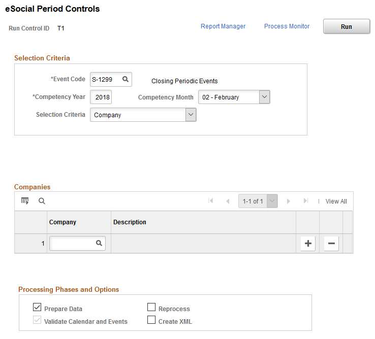

Use the eSocial Period Controls page (GPBR_ESOC_PER_CTRL) to close or reopen assessment periods for processing periodic events.
Image: eSocial Payroll Controls page
This example illustrates the fields and controls on the eSocial Payroll Controls page.
Run the GPBR_ES_PERC process to close or reopen assessment periods for payroll and payment information submission.
Selection Criteria
Field or Control
Definition
Event Code
Select a periodic control event to, for example, reopen or close a period. As delivered, S-1298 and S-1299 are available for selection.
Competency Year and Competency Month
Specify the period to be reopened or closed.
Selection Criteria
Select to process payroll events for all companies, or a selection of companies that are selected in the Companies section that appears.
Period Type
Select the period type of the specified period to reopen. Values are Annual and Monthly. This field appears if the selected event is S-1298. For S-1299 events, the period type is generated automatically based on the existing period type selected for S-1200, S-1210, and S-1280 events of the specified period.
Companies
This section appears if the Selection Criteria field is set to Company. Select a list of companies for which the selected event generates.
The system displays a list of eSocial-active companies in this section automatically, if the selected event is S-1299 and the competency month is set to 01 - January.
Processing Phases and Options
