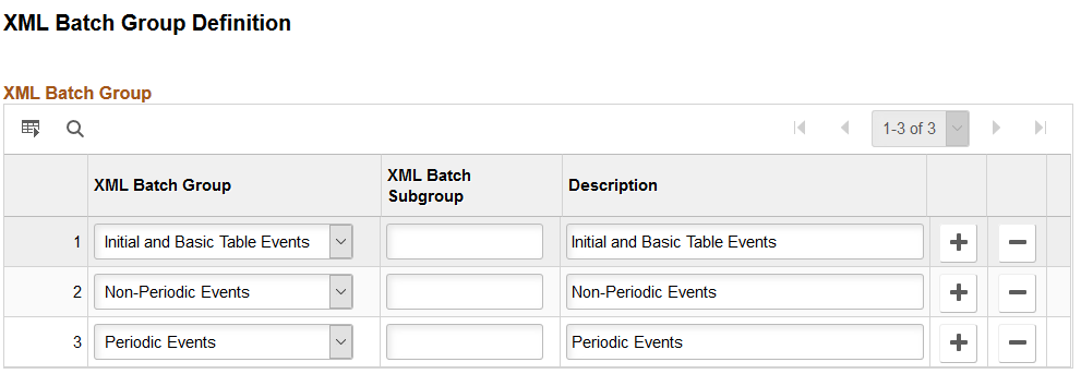

XML Batch Group Definition Page
GPBR_XMLBATCH_GRP
Define XML batch groups and subgroups.

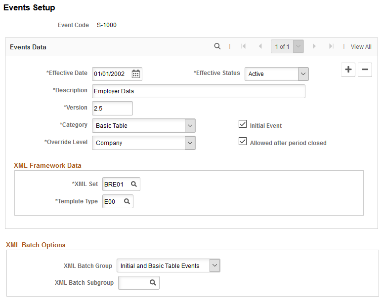

Events Setup Page
GPBR_EVENT_SETUP
Specify basic setup information for event layouts to be included in eSocial reporting.

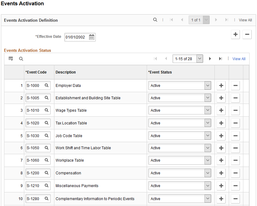

Events Activation Page
GPBR_EVNT_ACTIVTN
Activate events to be processed by PeopleSoft HCM Global Payroll for Brazil.

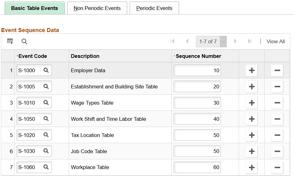

Basic Table Events Page
GPBR_EVENT_SEQNO_B
Specify the order in which basic table events are transmitted to eSocial.

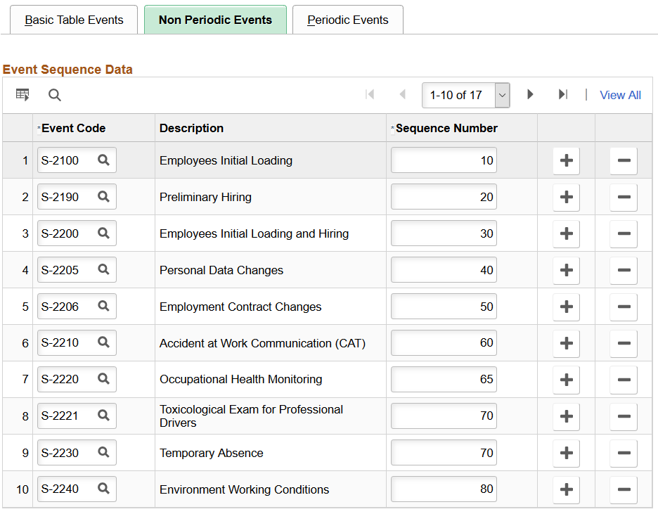

Non Periodic Events Page
GPBR_EVENT_SEQNO_N
Specify the order in which non-periodic events are transmitted to eSocial.

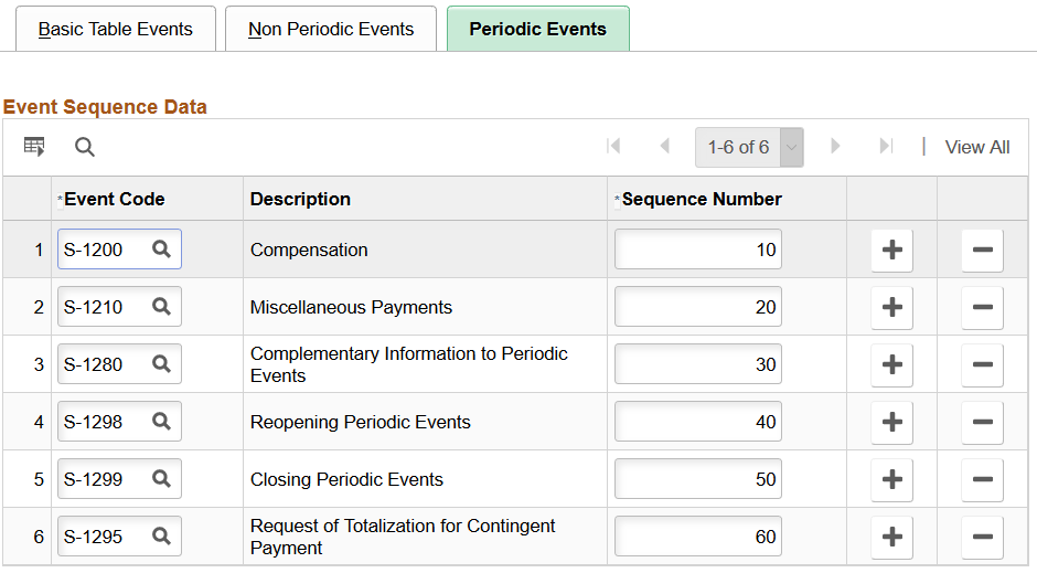

GPBR_EVENT_SEQNO_P
Specify the order in which periodic events are transmitted to eSocial.

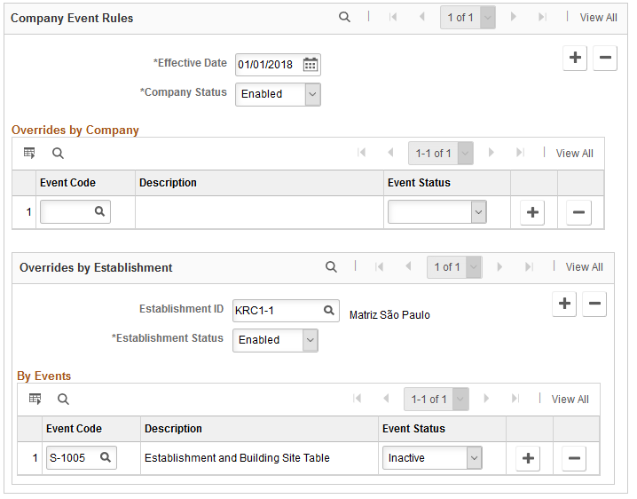

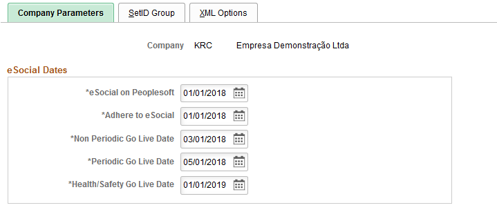

Company Parameters Page
GPBR_COMP_PARAM
Activate companies for eSocial reporting.

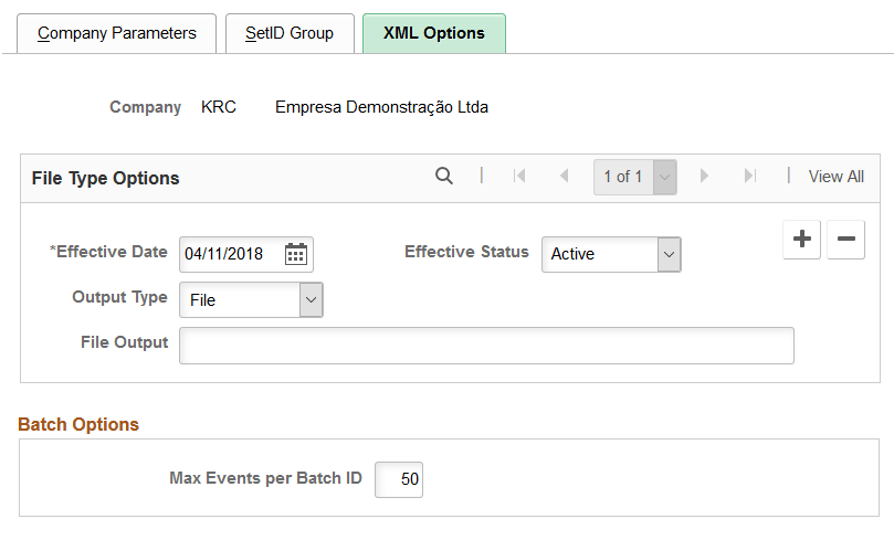

XML Options Page
GPBR_COMP_PARAM2
Specify XML file options for companies.

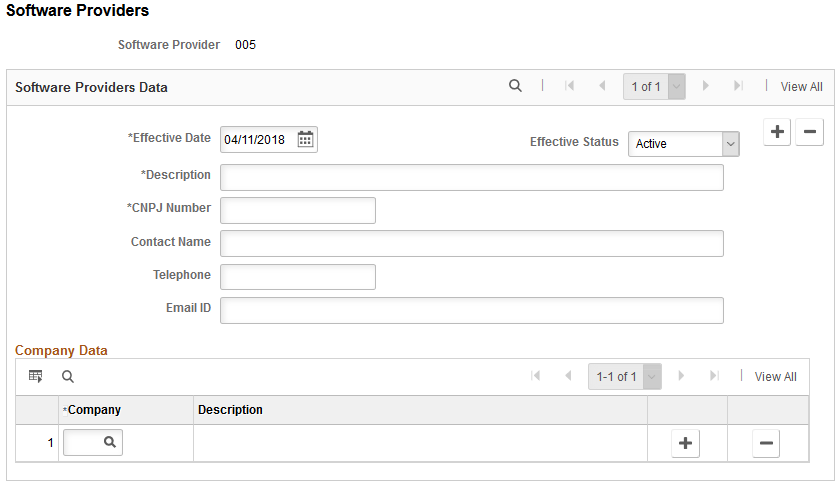

Software Providers Page
GPBR_SOFTW_PROV
Define software providers and contact information.

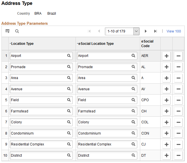

Address Type Page
GPBR_ADDR_TYPE
Map PeopleSoft and eSocial address types.

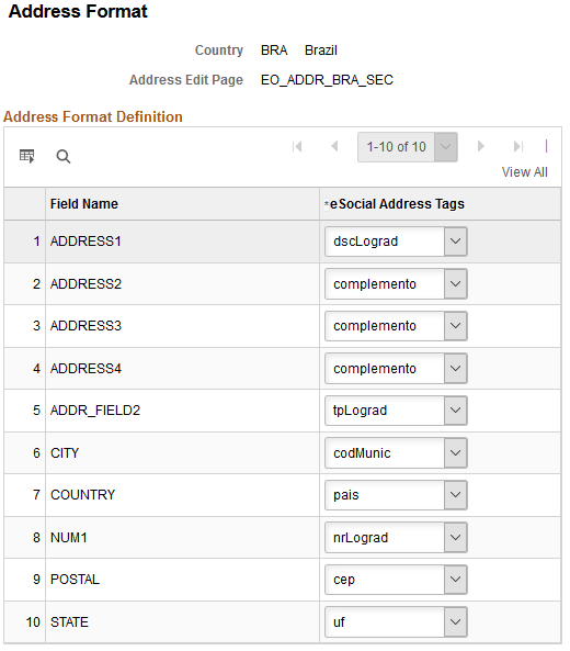

Address Format Page
GPBR_ADDR_FMT
Map PeopleSoft and eSocial address terms.

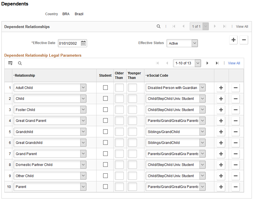

Dependents Page
GPBR_DEP_INF_CODE
Map PeopleSoft and eSocial dependent types.

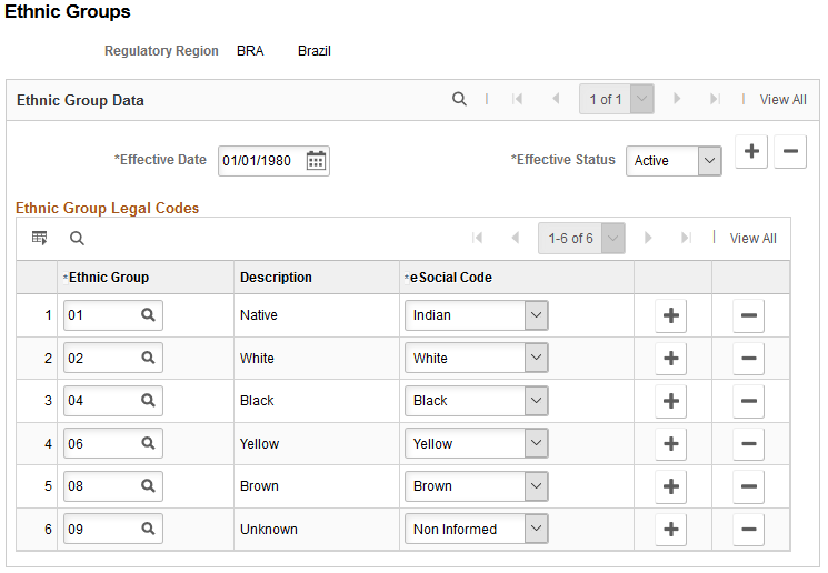

Ethnic Groups Page
GPBR_ETHNIC_GROUP
Map PeopleSoft and eSocial ethnic group codes.

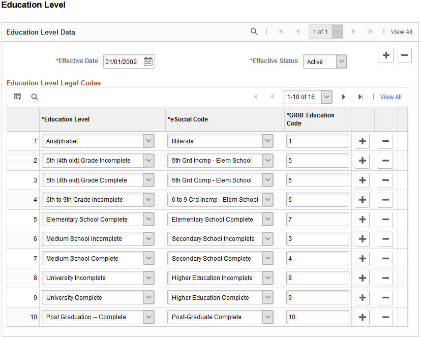

Education Level Page
GPBR_EDUCATIO_CODE
Map PeopleSoft and eSocial education levels.

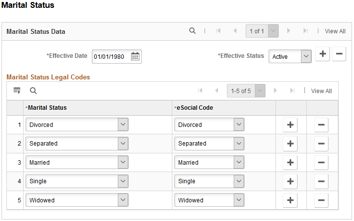

Marital Status Page
GPBR_MARITAL_CODE
Map PeopleSoft and eSocial marital statuses.

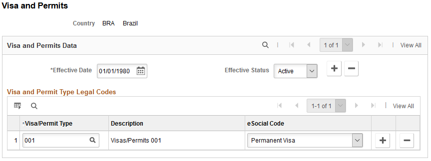

Visa and Permits Page
GPBR_VISA_CODE
Map PeopleSoft and eSocial visa or permit types.

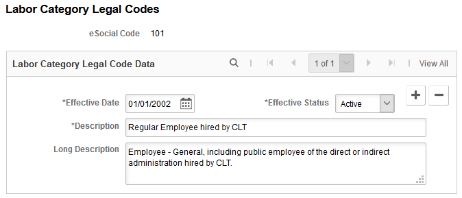

Labor Category Legal Codes Page
GPBR_LBR_CAT_CODE
Define labor category legal codes.

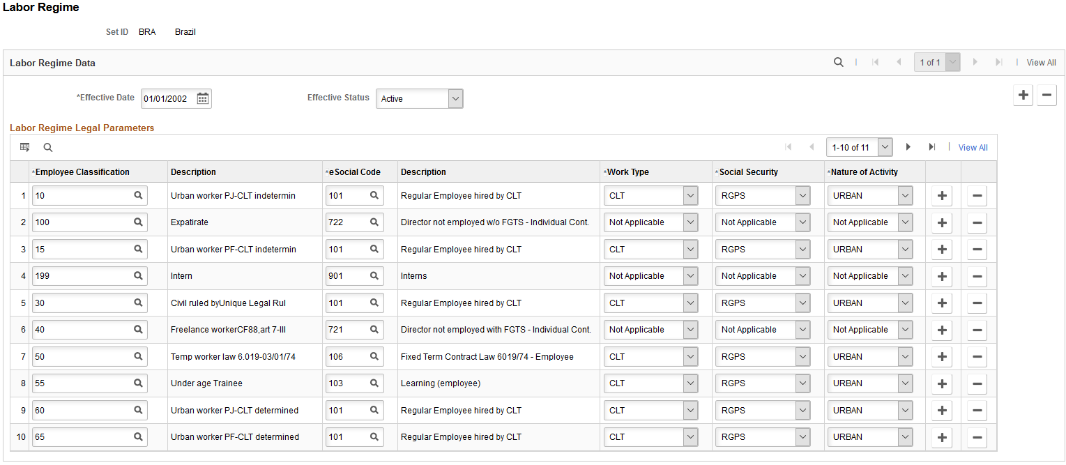

Labor Regime Page
GPBR_LABOR_REGIME
Associate employee classifications with labor-specific codes and information.

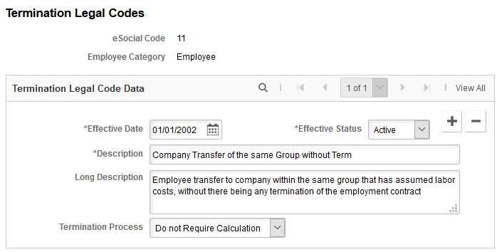

Termination Legal Codes Page
GPBR_TERM_CODE
Define eSocial termination codes.

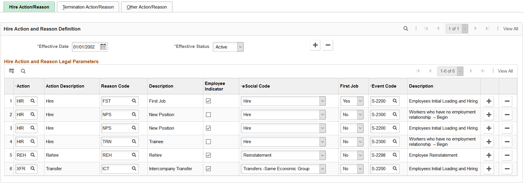

Hire Action/Reason Page
GPBR_HIR_ACT_REA
Identify all hiring actions and reasons, and corresponding events to be used to report to the eSocial system.

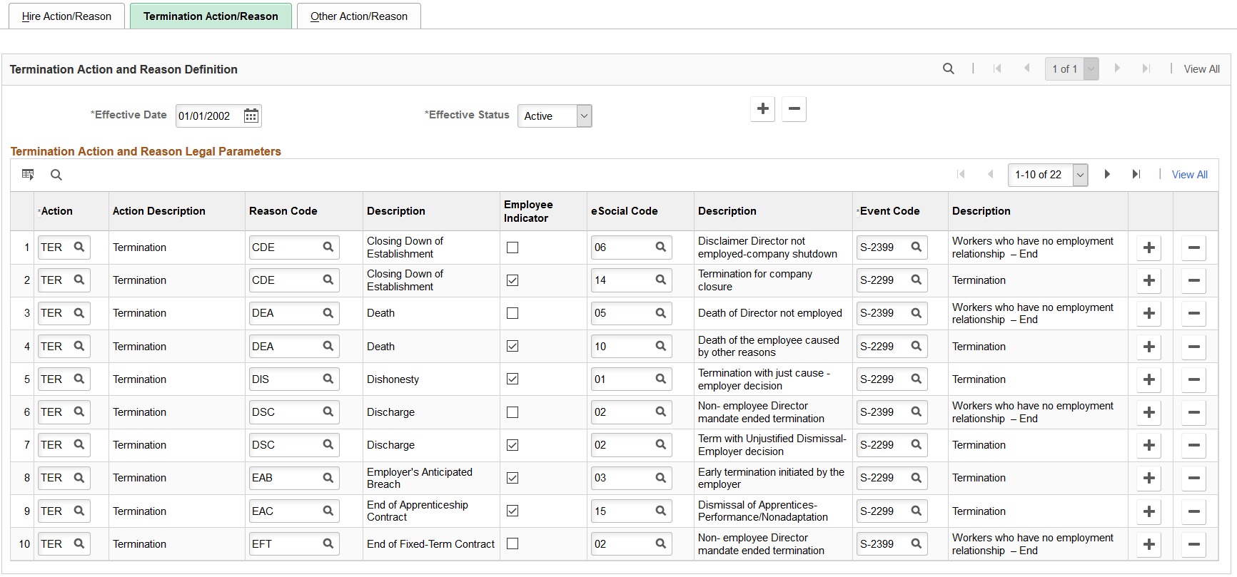

Termination Action/Reason Page
GPBR_TER_ACT_REA
Identify all termination actions and reasons, and corresponding events to be used to report to the eSocial system.

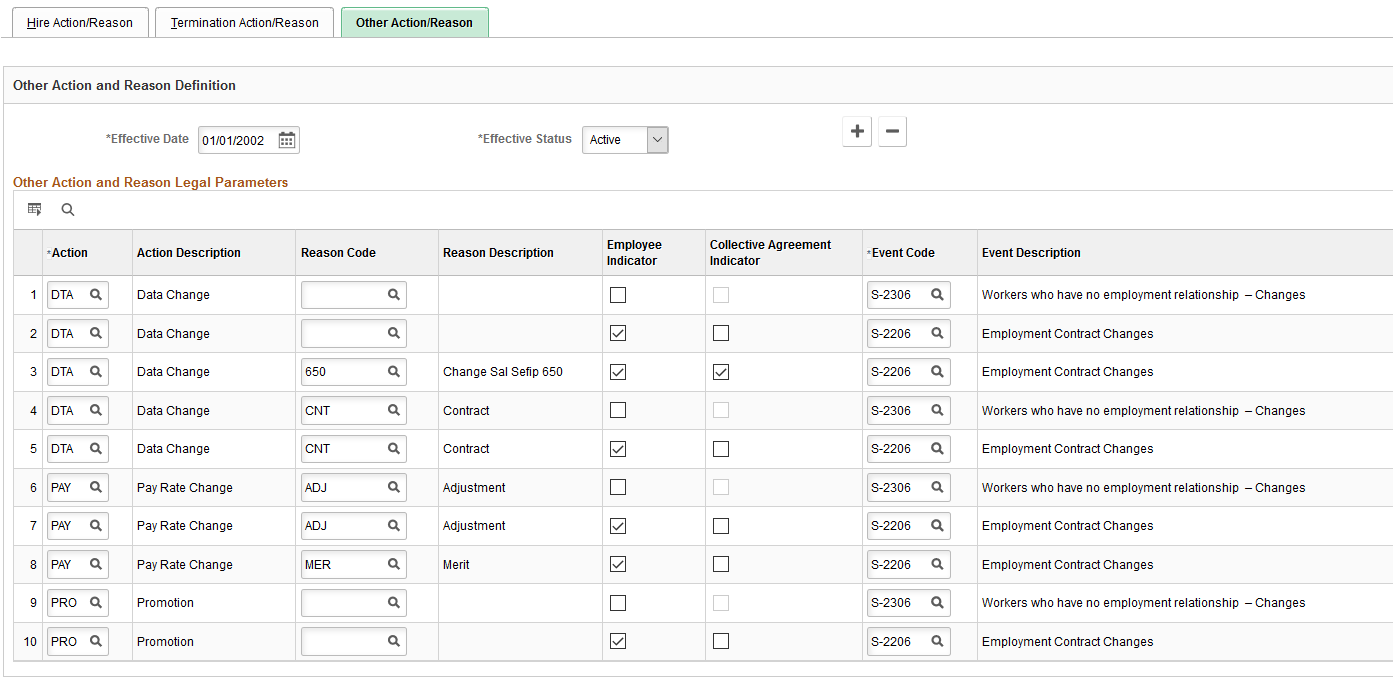

Other Action/Reason Page
GPBR_OTH_ACT_REA
Identify all actions and reasons related to contract changes that need to be reported to the eSocial system.

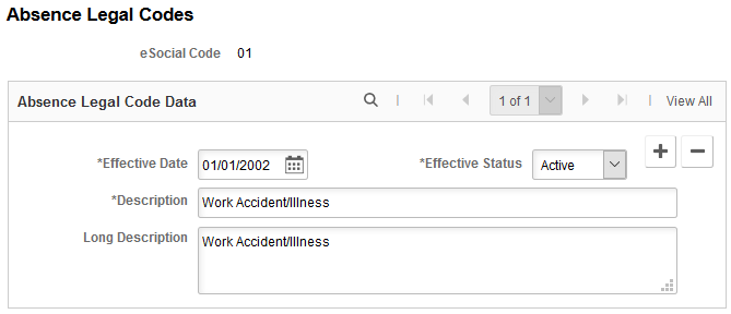

Absence Legal Codes Page
GPBR_ABS_CODE
Define eSocial absence codes.

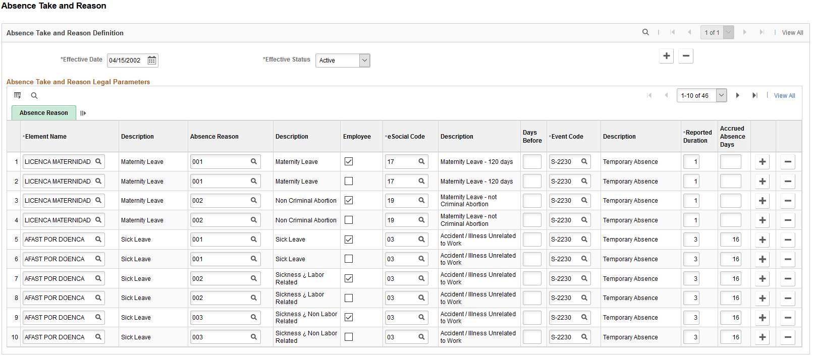

Absence Take and Reason Page
GPBR_ABS_TAKE_REA

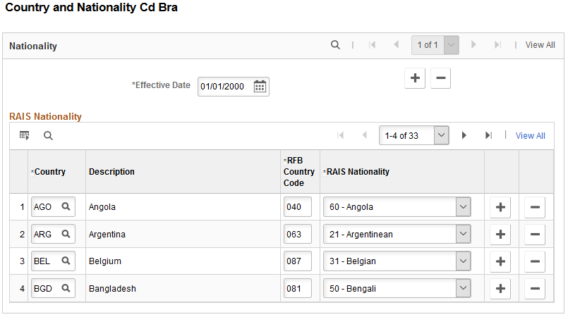

Map PeopleSoft and eSocial absence codes.
Country and Nationality Cd Bra Page
ES_COUNTRY_TBL_BRA
Map country codes with RFB and RAIS nationality codes.

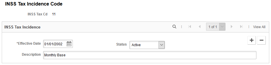

INSS Tax Incidence Code Page
GPBR_SOC_PREV_CD
Define INSS tax codes.

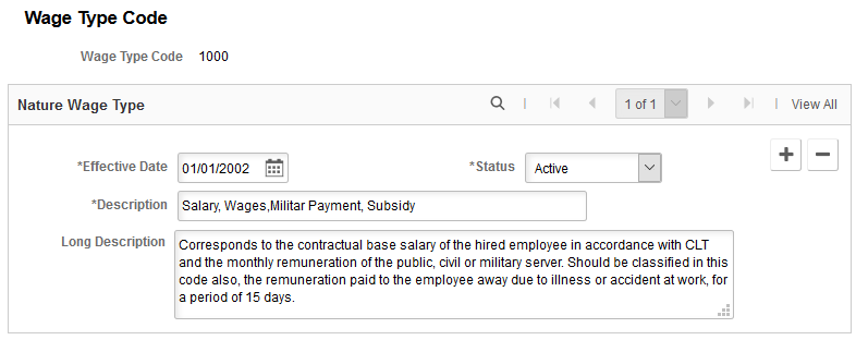

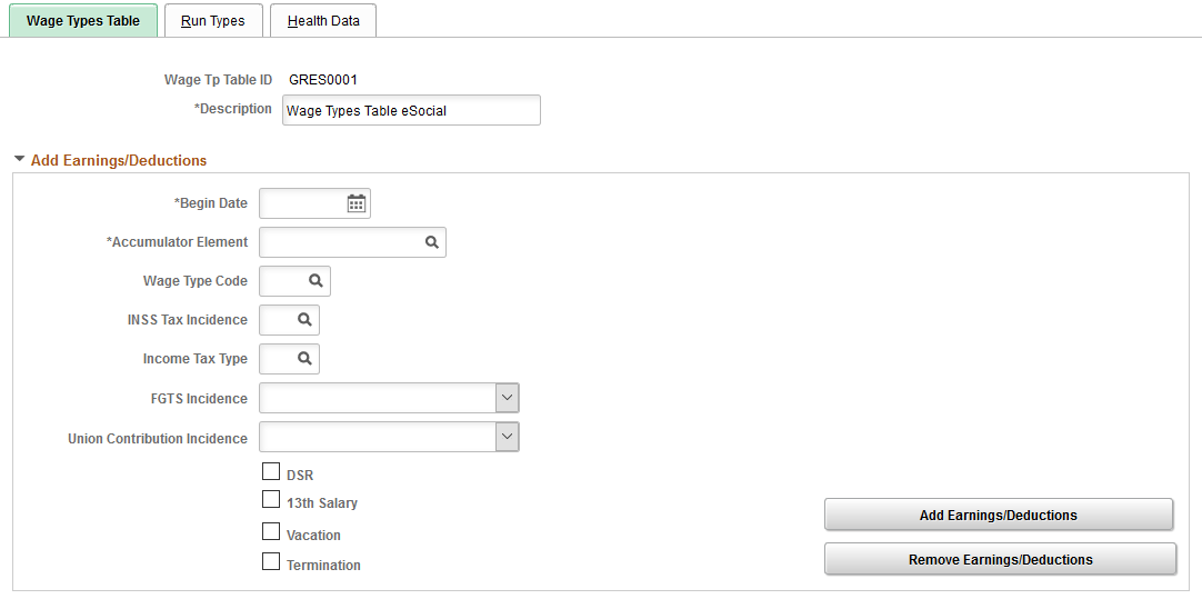

Wage Type Code Page
GPBR_WAGE_CODE
Define wage type codes.
Wage Types Table Page
GPBR_WAGE_TYPE
Assign wage type as well as other incidence codes to accumulator elements for use in eSocial reporting.

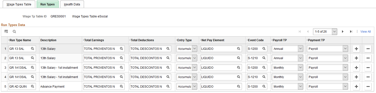

Run Types Page
GPBR_RUN_TYPE
Specify run types, eSocial events, and other needed information for corresponding payroll elements.

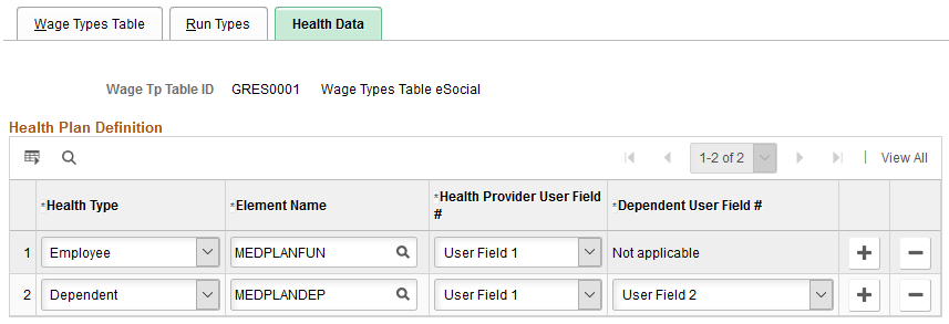

Health Data Page
GPBR_HLTH_WAGE
Specify health plan setup for payroll event reporting.

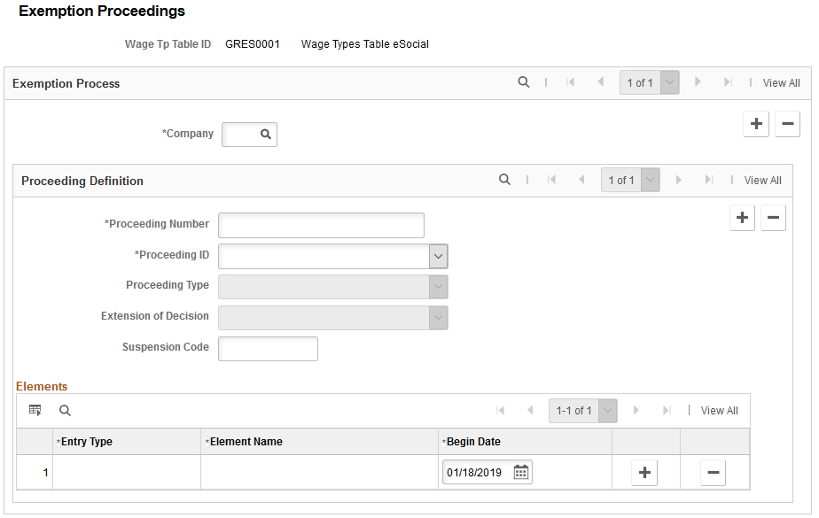

Exemption Proceedings Page
GPBR_PROCEED_DT
Define the wage type proceeding details for companies.

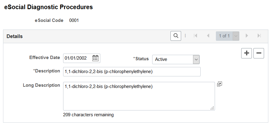

eSocial Diagnostic Procedures Page
GPBR_ESOC_CODE
Define diagnostic procedure codes.

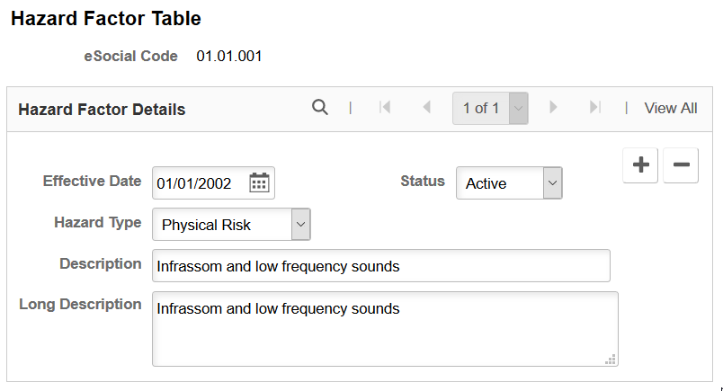

Hazard Factor Table Page
HAZARD_FACTOR_BRA
Define codes.

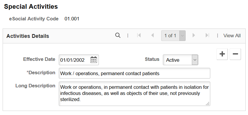

Special Activities Page
ACTIVITIES_BRA
Define special activity codes.

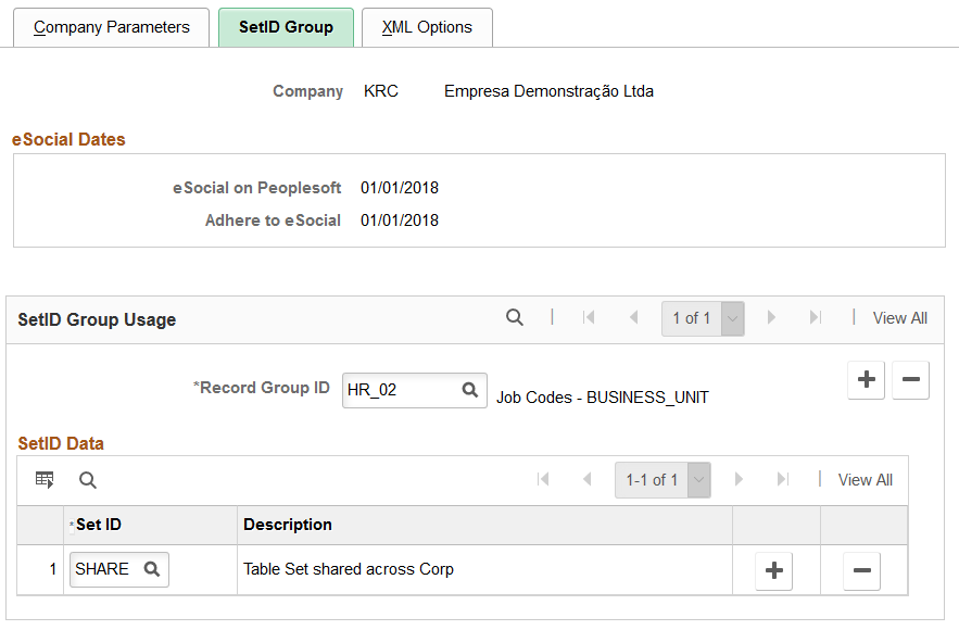

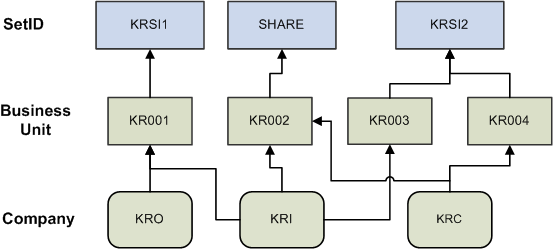

Businesses in Brazil are required to report data to the eSocial system by company. This mechanism works fine with periodic and non-periodic events, but not with events for basic tables (for example, Job Code Table and Work Shift Code), which are keyed by setID in PeopleSoft HCM.
To bridge the gap between setID-based data and the company-based reporting requirement, and ensure that basic table data can be transmitted to eSocial properly, the system provides the SetID Group Page to map between setIDs and companies. When a basic table change occurs, the system uses this mapping information to identify the companies that this change impacts, and generates appropriate events for impacted companies for eSocial processing.
SetID and Company Mapping Example
This example describes how the PeopleSoft system determines what (and for which companies) data gets submitted to the eSocial environment, when a job code is updated in PeopleSoft.
Image: SetID and Company Example
In this imaginary PeopleSoft HCM system, there are three different setIDs, four business units, and three companies. This diagram illustrates how they are linked together to support business processes of the companies:
Job codes are keyed by setID in the Job Code Table (JOB_CODE_TBL); they are available in all three setIDs:
Image: Job Codes Available in the Job Code Table
Suppose that job code 1000 is used in all three setIDs to represent different job positions, as illustrated in this table:
Job Code Table in PeopleSoft
If a user updates job code 1000, the PeopleSoft system needs to identify to which companies this job code change applies based on the setID, and send the correct job code information to eSocial accordingly.
As an implementer, you establish the association between companies and setIDs on the SetID Group Page. When a setID-keyed basic table data is updated, the system can find out from the mapping on this page a list of companies to which the update pertains.
Back to the job code example, suppose that the mapping is already defined on the SetID Group page based on the setID and company mapping diagram, and a user has updated job code 1000 for the SHARE setID. The system accesses the setID and company mapping page and concludes that this job code update needs to submitted for two companies: KRI and KRC. When the staging table loading application engine process (GPBR_ES_XML) runs, this event is split and loaded to staging tables for both KRI and KRC.
In the information that is sent to eSocial, the corresponding setID is added to the job code as prefix to avoid duplicate keys, as illustrated in this table:

The Job Data component is where hiring, terminations, and other contract-related updates take place. When the component is saved, a trigger is run to identify information that may have to be reported to eSocial. PeopleSoft provides the eSocial Actions and Reasons component for customers to identify the actions that need to be submitted to eSocial, according to their business processes.
Use this component to provide the specifics for each action, so that the trigger can determine whether a job data change has to be sent to eSocial, or which event to use based on the individual (employee or non-employee) on whom the action performed. For example, when a hiring action is saved, the S-2200 event that is invoked for hiring an employee is different from the one (S-2300) for hiring a non-employee.
Any actions pertaining to hiring, terminations, and contract-related updates must be set up properly in the eSocial Actions and Reasons component to be included for eSocial processing.

  1. Define XML batch groups and subgroups on the XML Batch Group Definition Page.
  2. Define eSocial events on the Events Setup Page.
  3. Activate events to be processed by PeopleSoft HCM Global Payroll for Brazil on the Events Activation Page.
  4. Categorize eSocial events and sequence them on the Basic Table Events Page, Non Periodic Events Page, and Periodic Events Page.
  5. Activate companies for eSocial reporting and override system-level defaults (if applicable) for companies on the Company Parameters Page.
  6. Associate companies with setIDs for basic table event processing on the SetID Group Page.
  7. Set up company’s XML options on the XML Options Page.
  8. Define software providers on the Software Providers Page.

  1. Map PeopleSoft and eSocial address terms on the Address Type Page and Address Format Page.

  4. Map PeopleSoft and eSocial ethnic group codes on the Ethnic Groups Page.
  5. Map PeopleSoft and eSocial education levels on the Education Level Page.

  8. Define labor category legal codes on the Labor Category Legal Codes Page.
  9. Associate employee classifications with labor-specific codes and information on the Labor Regime Page.
  10. Define termination legal codes on the Termination Legal Codes Page.
  11. Identify all hiring, termination, and other contract-related actions and reasons, and corresponding events to be used to report to the eSocial system on the Hire Action/Reason Page, Termination Action/Reason Page, and Other Action/Reason Page.
  12. Define absence legal codes on the Absence Legal Codes Page.
  13. Map PeopleSoft and eSocial absence codes on the Absence Take and Reason Page.

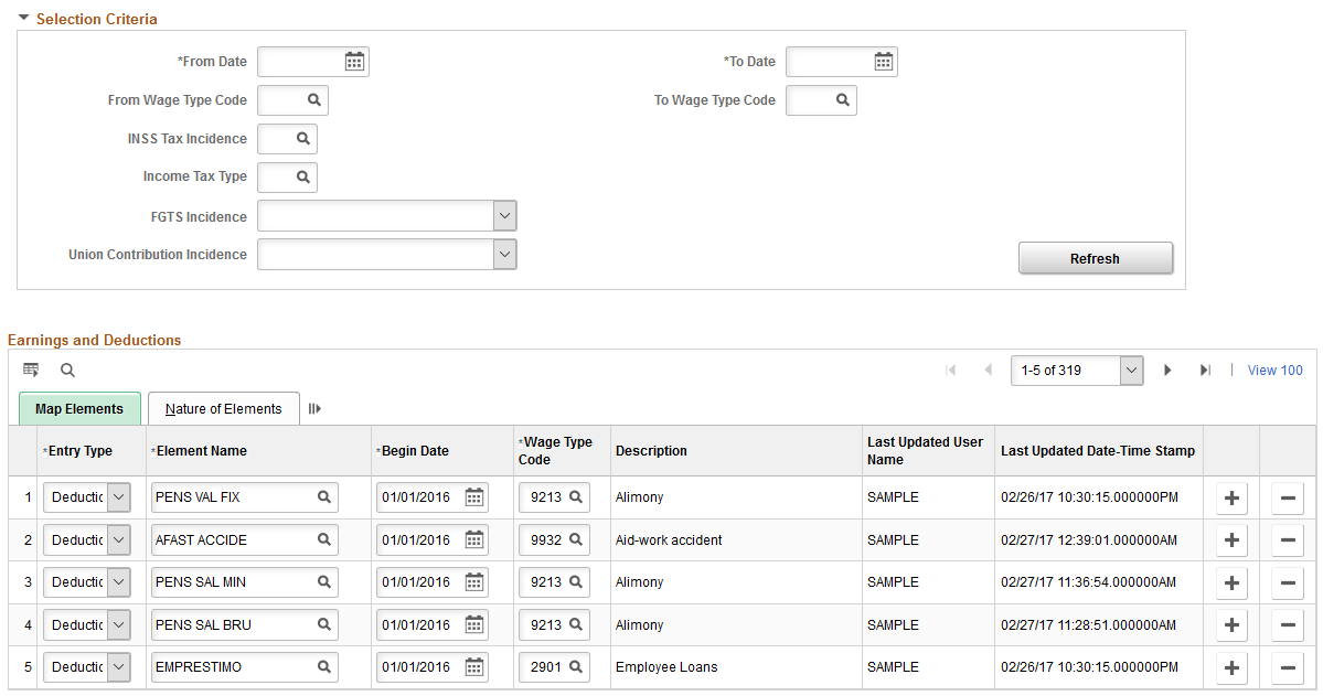

  15. Set up wage types tables on the INSS Tax Incidence Code Page, Income Tax Incidence Code Page, Wage Type Code Page, Wage Types Table Page, Run Types Page, Health Data Page, and Exemption Proceedings Page.

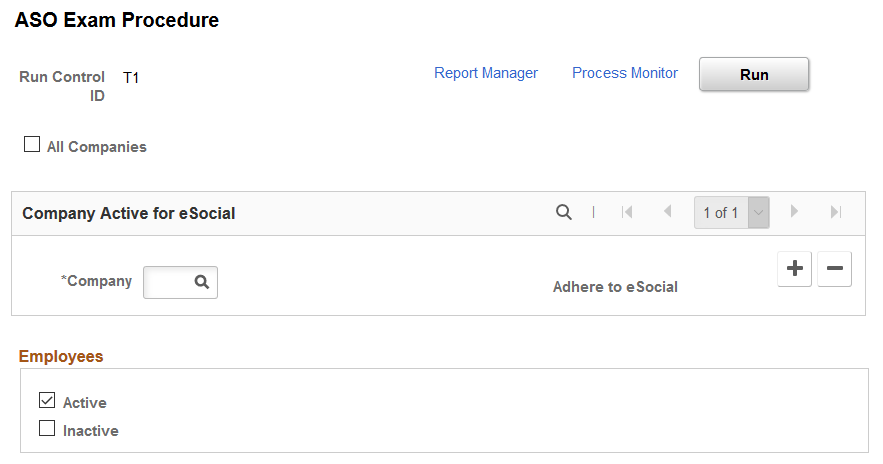

Use the ASO Exam Procedure page (GPBR_ESOC_ASO) to update employee record numbers on ASO exam results.
Image: ASO Exam Procedure page
This example illustrates the fields and controls on the ASO Exam Procedure page.
Companies use the ASO exam results BRA component to record employees’ medical exam results and track their occupational health. Prior to implementing the S-2220 event in eSocial to report employees’ occupational health information to the Government, you need to run a one-time process to update employee record numbers in exam results as needed, so that the exam information can be processed properly.
The Employee Record process checks to make sure that, for each company that is included on the run control page, each ASO exam result created for the company's employee is associated with the correct employee record number, and update as necessary. If the employee of an ASO exam result has more than one employee record, a duplicate ASO exam result will be created for each of his or her additional employee record number. Suppose that the employee has two employee records and is associated with three exam results. When the process runs, it generates a duplicate for each of the three exam results for the additional employee record, and populates the corresponding employee record number on all six exam results. It is the company’s responsibility to review and clean up these exam result records before the go-live date of the health and safety events.
Note: Run the Employee Record process only once for companies that implement the S-2220 event. Nothing happens when you rerun the process for the same company.
Field or Control
Definition
All Companies or Company
Click to include all companies that are enabled for eSocial reporting on the Company Parameters Page in the employee record process.
Alternatively, you can add one or more companies manually by inserting rows to this page. Only eSocial-enabled companies are available for selection.
Active
Select to include active employees in the process.
Inactive and From
Select to include inactive employees (whose HR status is set to Inactive, for example, terminated employees) in the process.
When selected, specify the date from when employees, who became Inactive, will be included in the process.
Use the XML Batch Group Definition page (GPBR_XMLBATCH_GRP) to define XML batch groups and subgroups.
Image: XML Batch Group Definition page
This example illustrates the fields and controls on the XML Batch Group Definition page.
Use this page to define subgroups for XML batch groups that are provided by the PeopleSoft system. Each event is associated with an XML batch group and subgroup for delivery purposes.
Use the Events Setup page (GPBR_EVENT_SETUP) to specify basic setup information for event layouts to be included in eSocial reporting.
Image: Events Setup page
This example illustrates the fields and controls on the Events Setup page.
Events Setup page
The Brazilian government has published a set of event layouts for use in eSocial reporting. These event layouts are delivered and grouped into four categories on this page. In addition to category grouping and the override level allowed, some of these layouts are selected to be included in the initial data loading process. The event setup also contains parameters to be used for generating XML outputs in the XML Report Framework, and packaging them for delivery.
Events Data
Field or Control
Definition
Event Code
Displays the code of the event layout.
Effective Date
Displays the effective date of the event.
In the future, if the government makes updates to an event, for example, inactivate an event or change the release version, PeopleSoft delivers the update with a new effective-dated row for the corresponding event.
Effective Status
Select the effective status for the event layout. By default, PeopleSoft-delivered events are set as Active.
Only active events are available for further setup on the Events Activation Page.
Version
Enter the version for the event. This value is used in XML as a namespace.
Category
Select the category to which this event layout belongs. Values are:
Basic Table
Non Periodic
Periodic
Termination
Totaling
Initial Event
Select to classify this event as an initial event and include it in the initial data loading process.
Override Level
Select the override level supported by this event setup.
Values are Company and Establishment.
Events can be configured further at the company or establishment level on the Company Parameters Page.
Allowed after period closed
Select to allow the transmission of data that is identified by this event to the government even after the pertinent period has been closed (which is indicated by the submission of the S-1299 - Closing Periodic Events event).
XML Framework Data
Field or Control
Definition
XML Set
Enter the name of the XML set table in the XML Report Framework for this event layout version.
Template Type
Enter the template that is used to fill out the layout in the XML Report Framework.
Exclusion Template Type
Enter the template that is used to generate exclusions for this event layout. This field appears if the selected event category is Periodic.
XML Batch Options
Use this section to link the event with a batch group and subgroup. When XML outputs are generated, PeopleSoft packages them in batches and deliver them to the third-party system using web services. A batch can contain up to 50 (predefined by the government) XML outputs of the same group type for any given company.
Field or Control
Definition
XML Batch Group
Select a batch group type for the event. Values are:
Initial and Basic Tables Events
Non-Periodic Events
Periodic Events
XML Batch Subgroup
Specify a batch subgroup for the event.
Subgroups for XML batch groups are defined on the XML Batch Group Definition Page.
Use the Events Activation page (GPBR_EVNT_ACTIVTN) to activate events to be processed by PeopleSoft HCM Global Payroll for Brazil.
Image: Events Activation page
This example illustrates the fields and controls on the Events Activation page.
Customers may choose to process eSocial events using more than one system, for example, sending employer data from an ERP Financials system, and Payroll-related information from various Payroll systems. Use this page to activate events to be submitted to the eSocial environment through PeopleSoft HCM Global Payroll for Brazil.
The system prepopulates on this page all active events that are defined on the Events Setup Page. You can update the information as necessary. Events and statuses specified here are system-level defaults for all companies that are enabled for eSocial; you can override them at the company-level for individual companies on the Company Parameters Page.
Field or Control
Definition
Event Code and Description
Enter the code of an event to be activated. Active events that are defined on the Events Setup page are available for selection.
The corresponding event description is displayed after an event code is selected.
Event Status
Select Active to include the event in eSocial reporting using PeopleSoft.
Select Inactive to exclude it from eSocial reporting using PeopleSoft.
Use the Basic Table Events page (GPBR_EVENT_SEQNO_B) to specify the order in which basic table events are transmitted to eSocial.
Image: Basic Table Events page
This example illustrates the fields and controls on the Basic Table Events page.
Note: Events are submitted to the eSocial system by category in this order: Basic Table, Non Periodic, and Periodic. For each category, events are assigned a sequence number to indicate the order in which they are sent. If there are two events to be submitted in the same batch, the event with a smaller sequence number has to be sent before the event with a larger number.
The system prepopulates on this page all basic table events that are defined on the Events Setup Page. You can update the information as necessary.
Field or Control
Definition
Enter the code of an event to be included in the Basic Table category. Active events that belong to the Basic Table category are available for selection.
Sequence Number
Enter the sequence number for the event, which is used in the batch processing logic. The smaller the number, the higher priority the event has in the event submission sequence within its category.
Use the Non Periodic Events page (GPBR_EVENT_SEQNO_N) to specify the order in which non-periodic events are transmitted to eSocial.
Image: Non Periodic Events page
This example illustrates the fields and controls on the Non Periodic Events page.
Non Periodic is the second category to be submitted to eSocial.
The system prepopulates on this page all non-periodic events that are defined on the Events Setup Page. You can update the information as necessary.
Field or Control
Definition
Enter the code of an event to be included in the Non Periodic category. Active events that belong to the Non Periodic or Termination category are available for selection.
Sequence Number
Use the Periodic Events page (GPBR_EVENT_SEQNO_P) to specify the order in which periodic events are transmitted to eSocial.
Image: Periodic Events page
This example illustrates the fields and controls on the Periodic Events page.
Periodic is the third category to be submitted to eSocial.
The system prepopulates on this page all periodic events that are defined on the Events Setup Page. You can update the information as necessary.
Field or Control
Definition
Enter the code of an event to be included in the Periodic category. Active events that belong to the Periodic category are available for selection.
Sequence Number
Use the Company Parameters page (GPBR_COMP_PARAM) to activate companies for eSocial reporting.
Image: Company Parameters page (1 of 2)
This example illustrates the fields and controls on the Company Parameters page (1 of 2).
Image: Company Parameters page (2 of 2)
This example illustrates the fields and controls on the Company Parameters page (2 of 2).
Use this page to activate all companies that have to report data to the eSocial environment. If a company takes the default setup that is defined on the Events Activation Page, you only need to set the company status to Enabled and specify both eSocial on PeopleSoft and Adhere to eSocial dates.
Note: In addition to the company setup performed in the Company Parameters component, be sure to also verify that only one establishment is selected as the headquarters unit for each company that is enabled for eSocial reporting.

Company
Displays the company to which the eSocial dates and event rules applies.
Enter the date the company began to report data to eSocial using PeopleSoft.
This date cannot be updated after the initial data loading process has run.
Note: The eSocial on PeopleSoft date and Adhere to eSocial date are the same for customers who implement eSocial reporting on their existing PeopleSoft HCM Global Payroll for Brazil system. For new customers, these dates can be different. The eSocial on PeopleSoft date is the date when eSocial processing begins and events are being reported. It is an important date as it is used to control the eSocial historical data regarding rectification events.
Adhere to eSocial
Enter the date the company is required to report data to eSocial (using PeopleSoft or not). This date is either earlier than or equal to the eSocial on PeopleSoft date.
The implementation of eSocial is going to be done in phases. The Adhere to eSocial date is also used as the go-live date for basic table events, which is set to January 1, 2018.
Non Periodic Go Live Date
Enter the date that the company begins the creation and submission of non-periodic events to the government.
The implementation of eSocial is done in phases. The current go-live date for non-periodic events is set to March 1, 2018.
Enter the date that the company begins the creation and submission of periodic events to the government.
The implementation of eSocial is done in phases. The current go live date for periodic events is set to May 1, 2018.
Health/Safety Go Live Date
Enter the date that the company begins the creation and submission of health and safety events to the government. These events are currently not supported in Global Payroll for Brazil; they are scheduled to be released in future images.
The implementation of eSocial is done in phases. The proposed go-live date for health and safety events is set to July 1, 2019.
Company Event Rules
Field or Control
Definition
Effective Date and Company Status
Enter the effective date of the company status that is selected on the Company Status field. The default value for the effective date is today's date. The effective date should be earlier than the eSocial on PeopleSoft date and the Adhere to eSocial date.
Overrides by Company
Use this section to enter, if available, any event exceptions for the company listed. For example, if the company decides to not use the PeopleSoft HCM system to submit employer data (which is currently an active event at the system level), enter the S-1000 Employer Data event here and set its status to Inactive.
If the company takes the system-level defaults that are specified on the Events Activation Page without exceptions, do not fill out this section.
Overrides by Establishment
Use this section to enter, if available, any event exceptions for the establishment listed. For example, the company may use the PeopleSoft HCM system to submit job code data for most of its establishments, and a legacy system for a couple other establishments from previous acquisitions. In this case, add a row for each establishment with the exception. Enter the S-1030 Job Code Table event here and set its status to Inactive. Furthermore, if the company has an establishment that does not use the PeopleSoft HCM system for eSocial reporting, add a row for this establishment and disable it in this section.
If all company establishments take the system-level defaults that are specified on the Events Activation Page without exceptions, do not fill out this section.
Note that establishment overrides do not apply to all events. For example, they are not applicable to S-1280, S-1298, S-1299, and S-1300 events, which are company-based.
Use the SetID Group page (GPBR_SETID_GROUP) to associate companies with setIDs for basic table event processing.
Image: SetID Group page
This example illustrates the fields and controls on the SetID Group page.
SetID Group page
Use this page to associate companies with setIDs. The mapping is needed when PeopleSoft submits basic table data to eSocial, some of which is keyed by SetID.
Information entered on the SetID Group page pertains to basic table events only.
Field or Control
Definition
Record Group ID
Enter the record group ID for the basic table data that is keyed by SetID. A record group is a set of control tables and views for a given setup data, for example, job codes and work shift codes.
SetID Data
Use this section to specify the setIDs with which the company associates to access the basic table data specified in the Record Group ID field.
Use the XML Options page (GPBR_COMP_PARAM2) to specify XML file options for companies.
Image: XML Options page
This example illustrates the fields and controls on the XML Options page.
XML Options page
File Type Options
Field or Control
Definition
Output Type
Select the output type of XML files (for archiving in a database or specific directory).
If String is selected, XML output (in the form of string) is generated and inserted into the XMLGF_STRNG_TBL record.
If File is selected, XML output (in the form of file) is generated and stored in the specified file output directory.
File Output
Specify the directory where generated XML files are stored. This directory needs to have the right permission for file storage, and is required if the selected output type is File.
This directory path needs to end with either “\” or “/”.
Batch Options
Field or Control
Definition
Max Events per Batch ID (maximum events per batch ID)
Enter the maximum number of XML outputs that can be included in a batch to be delivered to the eSocial system. Based on the document provided by the government, this number is 50. You can modify this limit to anything under 50 if necessary.
Use the Software Providers page (GPBR_SOFTW_PROV) to define eSocial software providers and contact information.
Image: Software Providers page
This example illustrates the fields and controls on the Software Providers page.
Use this page to enter the contact information of your eSocial software vendors, in case they need to be contacted, for example, as a result of eSocial event layout changes from the government.
Field or Control
Definition
Software Provider
Displays the 3-digit code for the software provider.
Description
Enter the software provider name.
CNPJ Number
Enter the CNPJ (national ID) for the software provider.
Contact Name, Telephone, and Email ID
Enter the name, phone number and email address of the contact person for the software provider.
Company Data
Use this section to enter all companies that use products of the software provider.
Use the Address Type page (GPBR_ADDR_TYPE) to map PeopleSoft and eSocial address types.
Image: Address Type page
This example illustrates the fields and controls on the Address Type page.
Address Type page
Use the Address Format page (GPBR_ADDR_FMT) to map PeopleSoft and eSocial address terms.
Image: Address Format page
This example illustrates the fields and controls on the Address Format page.
Address Format page
Field or Control
Definition
Address Edit Page
Defaults to EO_ADDR_BRA_SEC page, which is the delivered secondary page used to enter person’s address information for the country of Brazil.
Field Name
Displays a field that is used to store address information.
eSocial Address Tags
Select the xml tag name under which the address field value will be reported to the eSocial system.

Use the Dependents page (GPBR_DEP_INF_CODE) to map PeopleSoft and eSocial dependent types.
Image: Dependents page
This example illustrates the fields and controls on the Dependents page.
Dependents page
Use this page to map dependent relationship codes that the eSocial system expects with the ones that are maintained in PeopleSoft. eSocial codes are more descriptive than PeopleSoft ones. On this page, specify applicable attributes to “modify” PeopleSoft codes if necessary, and pair them with matching eSocial codes.
Field or Control
Definition
Relationship
Select a dependent relationship value (relationship to employee) that is used in PeopleSoft.
Student
Select to add the student attribute to the dependent relationship selected in this row.
Older Than and Younger Than
Enter, if applicable, the age limit attribute for the selected dependent relationship selected in this row.
eSocial Code
Select the corresponding eSocial relationship to map to the selected dependent relationship along with any added attributes.
Use the Ethnic Groups page (GPBR_ETHNIC_GROUP) to map PeopleSoft and eSocial ethnic group codes.
Image: Ethnic Groups page
This example illustrates the fields and controls on the Ethnic Groups page.
Ethnic Groups page
Field or Control
Definition
Ethnic Group
Specify an ethnic group code that is available under the selected regulatory region in PeopleSoft. The corresponding ethnic group description is displayed after a code is selected.
eSocial Code
Select the corresponding eSocial code to map to the selected ethnic group.
Use the Education Level page (GPBR_EDUCATIO_CODE) to map PeopleSoft and eSocial education levels.
Image: Education Level page
This example illustrates the fields and controls on the Education Level page.
Field or Control
Definition
Education Level
Select an education level in PeopleSoft.
eSocial Code
Select the corresponding eSocial code to map to the selected education level.
GRRF Education Code
Select the code that is currently used in legal reports provided by PeopleSoft HCM to map to the selected education level.
Use the Marital Status page (GPBR_MARITAL_CODE) to map PeopleSoft and eSocial marital statuses.
Image: Marital Status page
This example illustrates the fields and controls on the Marital Status page.
Marital Status page
Field or Control
Definition
Marital Status
Select a marital status in PeopleSoft.
eSocial Code
Select the corresponding eSocial code to map to the selected marital status.
Use the Visa and Permits page (GPBR_VISA_CODE) to map PeopleSoft and eSocial visa or permit types.
Image: Visa/Permits page
This example illustrates the fields and controls on the Visa and Permits page.
Field or Control
Definition
Visa/Permit Type
Specify a visa or permit type that is available under the selected regulatory region in PeopleSoft. The corresponding description is displayed after a code is selected.
eSocial Code
Select the corresponding eSocial code to map to the selected visa or permit type.
Use the Labor Category Legal Codes page (GPBR_LBR_CAT_CODE) to define labor category legal codes.
Labor category legal codes need to be associated with employee classifications for eSocial processing.
Image: Labor Category Legal Codes page
This example illustrates the fields and controls on the Labor Category Legal Codes page.
Use the page to define labor category legal codes that are expected by eSocial.

Use the Labor Regime page (GPBR_LABOR_REGIME) to associate employee classifications with labor-specific codes and information.
Image: Labor Regime page
This example illustrates the fields and controls on the Labor Regime page.
Labor Regime page
Use this page to associate labor category codes with employee classifications. This information is used to identify the appropriate events to be submitted in regards to employer-employee relationships, as well as other specific attributes.
Field or Control
Definition
Employee Classification
Select an employee classification to be included in eSocial processing. Employee classes that are created for the BRA setID on the Employee Class page are available for selection.
See Also Defining Additional Employment Setup Data
In order for employees to be included in eSocial reporting, their employee classifications must be set up on this page.
eSocial Code
Select a labor category legal code to associate with the selected employee classification.
Labor category legal codes are defined on the Labor Category Legal Codes Page.
Work Type
Select an applicable labor law for the selected employee classification. Values are CLT, Not Available, and RJP. The value is used to identify if the employee classification is for employees (if CLT or RJP is selected) or non-employees (if Not Applicable is selected).
Social Security
Select, if applicable, a social security type for the selected employee classification. Values are Not Applicable, RGPS, RPPS, and RPSE.
Nature of Activity
Select if the selected employee classification applies to URBAN or RURAL employees, or Not Applicable.
Use the Termination Legal Codes page (GPBR_TERM_CODE) to define eSocial termination codes.
Image: Termination Legal Codes page
This example illustrates the fields and controls on the Termination Legal Codes page.
Field or Control
Definition
eSocial Code
Displays the eSocial code of the termination mentioned in the descriptions.
Define termination codes on this page in accordance with the termination reasons that are available on Table 19 from the Brazilian Government.
Employee Category
Displays whether the termination legal code is defined for Employee or Non-Employee.
Termination Process
Select whether or not payment calculation is required for the termination legal code. For terminations with payment calculation, the termination payment amount is included in each of their termination events to be submitted to the government.
See Also eSocial Termination Events Page
Use the Hire Action/Reason page (GPBR_HIR_ACT_REA) to identify all hiring actions and reasons, and corresponding events to be used to report to the eSocial system.
Image: Hire Action/Reason page
This example illustrates the fields and controls on the Hire Action/Reason page.
Use this page to specify the list of hiring actions and reasons that need to be submitted for eSocial processing, and corresponding events to be used based on employment relationship types, and whether or not the reported employment is the first job for the hired individual.
Any hiring actions and reasons that are not set up on this page are excluded from eSocial reporting.
Field or Control
Definition
Action
Select a hiring action in PeopleSoft. Typical values are HIR (Hire), XFR (Transfer), and REH (Rehire).
Reason Code
Select a reason for the selected action.
If no reason is specified, the setup for this row applies to all reasons for the selected action.
Employee Indicator
Select if the setup for this row applies to employees with employment relationship, as specified on the Labor Regime BRA page. Clear this option if it applies to non-employees.
eSocial Code
Select the corresponding eSocial code to map to the selected action and reason.
First Job
Select Y if the setup for this row applies to the first employment of hired individuals. If not, select N.
Select an event to be used to submit hiring transactions of the corresponding setup to the eSocial system.
Use the Termination Action/Reason page (GPBR_TER_ACT_REA) to identify all termination actions and reasons, and corresponding events to be used to report to the eSocial system.
Image: Termination Action/Reason page
This example illustrates the fields and controls on the Termination Action/Reason page.
According to the government’s requirements, terminations have to be reported by the seventh day of the month following the termination date, by the termination payment date, or before the triggering of payroll events, depending on information such as the nature of employment (employees and non-employees), termination reason and employment relationship. Use this page to specify all termination actions and reasons that need to be submitted to the eSocial system for employees and non-employees, and the corresponding events to be invoked to handle those terminations. Any actions and reasons that are not set up on this page are excluded from eSocial reporting.
Field or Control
Definition
Action
Select a termination action in PeopleSoft. Typical values are TER (Termination), and XFR (Transfer).
Reason Code
Employee Indicator
Select if the setup for this row applies to employees with employment relationship. Clear this option if it applies to non-employees (for example, trainees or apprentices).
eSocial Code
Select, if applicable, the corresponding eSocial termination code to map to the selected action and reason. This code is used by the system to identify if the event should be generated online (by saving an HCM component), or through a batch process when the termination amount paid to the employee is a required information for the event.
See Also Termination Legal Codes Page.
Select an event to be used to submit termination transactions of the corresponding setup to the eSocial system.
Use the Other Action/Reason page (GPBR_OTH_ACT_REA) to identify all actions and reasons related to contract changes that need to be reported to the eSocial system.
Image: Other Action/Reason page
This example illustrates the fields and controls on the Other Action/Reason page.
Some contract changes, such as salary increase, promotions, transfers between establishments, work shifts, and so on must to be reported to the eSocial system before the triggering of payroll events or before absence and termination events, depending on the nature of employment (employees and non-employees). Use this page to specify all contract-related actions and reasons that need to be submitted to the eSocial system for employees and non-employees, and the corresponding events to be invoked to handle those transactions. Any actions and reasons that are not set up on this page are excluded from eSocial reporting.
Field or Control
Definition
Action
Select an action in PeopleSoft. Typical values are DTA (Data Change), PAY (Pay Rate Change) and XFR (Transfer).
Reason Code
Employee Indicator
Select this option if the setup for this row applies to employees with employment relationship. Clear this option if it applies to non-employees.
Collective Agreement Indicator
Select this option to use the setup for this row to generate events to inform the Government of retroactive supplementary salary amounts, which result from salary increases caused by one of these reasons: collective agreement, collective dispute, collective convention or law enforcement.
This option becomes editable on a row when an action, a reason code, and the Employee Indicator field are selected. Note that this option can only be selected for one row on this page.
Event Code and Event Description
Select an event to be used to submit transactions of the corresponding setup to the eSocial system.
Use the Absence Legal Codes page (GPBR_ABS_CODE) to define eSocial absence codes.
Image: Absence Legal Codes page
This example illustrates the fields and controls on the Absence Legal Codes page.
These codes are referenced on the Absence Take and Reason Page.
Use the Absence Take and Reason page (GPBR_ABS_TAKE_REA) to map PeopleSoft and eSocial absence codes and specify reporting requirements for temporary absence types.
Image: Absence Take and Reason page
This example illustrates the fields and controls on the Absence Take and Reason page.
The Brazilian government requires that several types of absences be reported when they occur. When these absences are entered or updated using the Absence Event BRA component or the Vacation Acquis Prd-Sched BRA component, they are expected to be submitted to eSocial before the triggering of payroll events or termination events. They include, but not limited to, maternity leave, accident at work, illness leave, vacations, and so on.
Use this page to specify all absence types that need to be included for eSocial processing and respective reporting requirements. Do not enter absence types that are not required for eSocial reporting, for example, unjustified absence from work, or sick leave for less than three days.
Field or Control
Definition
Element Name
Specify an absence take in PeopleSoft.
Absence Reason
Specify the reason for the selected absence take. Absence reasons are associated with absence takes through absence take types on the Absence Take Types page (GP_ABS_TYPE).
If no reason is specified, the setup for this row applies to all reasons for the selected absence take.
Employee
Select if the selected absence take and reason applies to employees. Clear this option if it applies to non-employees.
eSocial Code
Select the corresponding eSocial code to map to the selected absence take and reason.
These codes are defined on the Absence Legal Codes Page.
Days Before
Enter the number of days, before the beginning of absence, that the selected absence event (for example, S-2230) needs to be submitted to eSocial (for an early submission).
Event Code
Select an event (for example, S-2230) to be used to submit transactions of the corresponding absence setup to the eSocial system by the closing of the period (the 7th day of the next month) in normal circumstances.
Reported Duration
Enter, for the selected absence take and reason, the minimum number of days for absences to be included for eSocial reporting by the closing of the period.
In other words, if an employee reports absence using the selected take and reason, and the number of absence days is lower than the reported duration, the absence is not reported to eSocial.
Accrued Absence Days
Enter, for the selected absence take and reason, the number of accrued absence days to be reported to eSocial as soon as this number is met, instead of waiting until the closing of the period.
Use the Country and Nationality Cd Bra page (ES_COUNTRY_TBL_BRA) to map country codes with RFB and RAIS nationality codes.
Image: Country and Nationality Cd Bra page
This example illustrates the fields and controls on the Country and Nationality Cd BRA page.
Use this page to map codes from the Country table to RFB and RAIS nationality codes. When the project (which includes the eSocial functionality) is applied, a batch process is executed automatically to convert RAIS nationality codes that were referenced in the Brazil (History) section of the Add a Person or Modify a Person - Regional Page to associated country codes.
Field or Control
Definition
Country and Description
Select a country code. Country codes are stored in the COUNTRY_TBL table in PeopleSoft. The corresponding country description is displayed after a country code is selected.
RFB Country Code
Enter a 3-digit numeric Secretaria da Receita Federal do Brasil (Department of Federal Revenue of Brazil) code to map to the selected country code.
RAIS Nationality
Select a nationality code that is used in RAIS reports to map to the selected country code.
Use the INSS Tax Incidence Code page (GPBR_SOC_PREV_CD) to define INSS tax codes.
Image: INSS Tax Incidence Code page
This example illustrates the fields and controls on the INSS Tax Incidence Code page.
Global Payroll for Brazil delivers a list of social security incidence codes for use in eSocial reporting.

Use the Wage Type Code page (GPBR_WAGE_CODE) to define wage type codes.
Image: Wage Type Code page
This example illustrates the fields and controls on the Wage Type Code page.
Wage Type Code page
Global Payroll for Brazil delivers a list of wage type codes for use in eSocial reporting.
Use the Wage Types Table page (GPBR_WAGE_TYPE) to assign wage type as well as other incidence codes to accumulator elements for use in eSocial reporting.
Image: Wage Types Table page (1 of 2)
This example illustrates the fields and controls on the Wage Types Table page (1 of 2).
Image: Wage Types Table page (2 of 2)
This example illustrates the fields and controls on the Wage Types Table page (2 of 2).
Wage Types Table Setup
Wage types table setup supports the processing of S-1010 Wage Event Table event reports. The S-1010 event is responsible for initial loading earnings and deduction elements and other related information that is used in payroll for companies, as well as tracking its data changes moving forward.

  • Entering tax exemption details for companies (if any) on the Exemption Proceedings Page.

Field or Control
Definition
Wage Tp Table ID (wage types table ID)
Enter the identifier of the wage types table.
Wage types table IDs function like setIDs in the event splitting process for payroll events. They are associated with companies on the (BRA) Company Details BRA Page.
Add Earnings/Deductions
Use this section to look up payroll elements by accumulator and enter default codes and properties. Matching accumulator elements are displayed on the Earnings and Deductions section, along with default codes and properties.
Field or Control
Definition
Begin Date
Enter the start date when this wage type code definition becomes valid.
The government can return an error for a submitted event that has a retroactive date. If the begin date is earlier than the actual month and year, this system message appears:
Warning -- date out of range. The date entered is out of the actual month and year period.  This is not normally true for this date. Either acknowledge that the date is OK, or correct the entered date.
Accumulator Element
Specify an accumulator. Only accumulator elements are available for selection.
Wage Type Code
Select a wage type code.
Wage Type Codes are defined on the Wage Type Code Page.
INSS Tax Incidence
Select an INSS tax code.
INSS tax codes are defined on the INSS Tax Incidence Code Page.
Income Tax Type
Select an income tax code.
Income tax codes are defined on the Income Tax Incidence Code Page.
FGTS Incidence
Select an FGTS code. Values are:
FGTS - 13th Salary
FGTS - Base
FGTS - Termination (Prior Notice)
Not Applicable
Suspended by Judicial Decision
Union Contribution Incidence
Select a union contribution code. Values are:
Not Applicable
Union Cont. - Monthly Base
Union Contribution - Value
DSR
Select to search for elements that are used to calculate DSR.
13th Salary
Select to search for elements that are used to calculate 13th salary payments.
Vacation
Select to search for elements that are used to calculate vacation payments.
Termination
Select to search for elements that are used to calculate termination payments.
Click to add matching accumulator elements to the Earnings and Deductions section.
Remove Earnings/Deductions
Click to remove matching accumulator elements from the Earnings and Deductions section.
Selection Criteria
You can use this section to query payroll elements and wage type codes to which they are currently mapped.
Results are displayed in the Earnings and Deductions section.
Earnings and Deductions: Map Elements
When you click the Add Earnings/Deductions button in the Add Earnings/Deductions section, the system populates the Earnings and Deductions section with all earning and deduction elements for the selected accumulator, and the wage type code that are specified in the Add/Remove Accumulator section. You can add or remove them manually as necessary.
Field or Control
Definition
Entry Type
Displays or enter either Deduction or Earnings.
Element Name
Displays or enter payroll elements that need to be reported on event S-1010. Available values are filtered by the selected entry type.
Begin Date
Displays or enter the start date when the selected wage type code definition becomes valid.
A “date out of range” warning message appears if the entered start date is earlier than the actual month and year.
Earnings and Deductions: Nature of Elements
The system populates this section with other codes and properties of the accumulator elements that are specified in the Add Earnings/Deductions section. You can add or remove them manually as necessary.
Note: To specify an element for use in alimony calculation, select an alimony-specific value, for example, 51, 52, 53, 54, or 55, as its income tax type.
Field or Control
Definition
Type
Displays the nature of the element. Values are:
Deduction
Earning
Informative
Informative Deduction
Use the Run Types page (GPBR_RUN_TYPE) to specify run types, eSocial events, and other needed information for corresponding payroll elements. This information is used in compensation-related events, for example, S-1200, S-1210, S-2299 and S-2399. It does not apply to S-1010 event reports.
Image: Run Types page
This example illustrates the fields and controls on the Run Types page.
Run Types page
Field or Control
Definition
Run Type Name
Select a run type process. Results of selected run type processes are reported to eSocial.
Total Earnings and Total Deductions
Select accumulators to be used for total earnings and total deductions respectively.
Net Pay Element
Select the net pay element for the selected run type process.
Event Code
Select the eSocial event with which the corresponding run type associates.
(S-1200 and S-1210) When the Identify Calendars option of the payroll event process is triggered for the S-1200 and S-1210 events, the system selects all applicable calendars for the selected companies and competency period on the eSocial Payroll Events run control page.
(S-2299 and S-2399) Similarly, when the termination event process is run on the eSocial Termination Events run control page, applicable calendars for payment are identified as well.
Based on the type (payroll or termination) of event processing, applicable calendars are finalized calendars that are linked to run types, which are associated with the corresponding events on the Run Types Page. A company is associated with wage types table setup (which contains run type setup) on the (BRA) Company Details BRA Page.
See Also Processing Phases and Options
Payroll Tp (payroll type)
Select if the payroll is done monthly, annually (for example, 13th salary), or not applicable.
Payment Tp (payment type)
Select the payment type. Values are:
N/A
Payroll
Term Non Empl (termination for non employees)
Termination
Vacation
Use the Health Data page (GPBR_HLTH_WAGE) to specify health plan setup for payroll event reporting. This information is used in compensation-related events, for example, S-1200, S-1210, S-2299 and S-2399. It does not apply to S-1010 event reports.
Image: Health Data page
This example illustrates the fields and controls on the Health Data page.
Health Data page
Field or Control
Definition
Health Type
Select Employee or Dependent.
Element Name
Select an applicable deduction element.
Health Provider User Field #
Select the user field number that is used to track the health provider for employee or dependent. This field is applicable to both Dependent and Employee health types.
Dependent User Field #
Select the user field number that is used to track the dependent number. This field is applicable only to the Dependent health type.
Use the Exemption Proceedings page (GPBR_PROCEED_DT) to define the wage type proceeding details for companies.
Image: Exemption Proceedings page
This example illustrates the fields and controls on the Exemption Proceedings page.
Use this page to enter proceeding details for companies that have tax exemptions (INSS, income tax, FGTS, and union) specified in their elements on the Wage Types Table page. Data changes to this page, once validated, will be submitted to eSocial for the referenced company using the S-1010 event.
Field or Control
Definition
Company
Select a company. Only companies that are associated with the listed wage types table ID on the Company BRA page are available for selection.
Proceeding Number
Enter the judicial process number.
Proceeding ID
Select the proceeding identification. Values are:
FGTS
Income Tax - IRRF
Social Prevision INSS
Union Contribution
Proceeding Type
Enter the government proceeding type. This field is required if the selected proceeding ID is Social Prevision INSS. Values are:
Administrative
Judicial
Extension of Decision
Enter the decision extension type. This field is required if the selected proceeding ID is Social Prevision INSS. Values are:
INSS Employer Cont. + Dis Ins.: The employer’s social security contribution plus discount of the insured.
INSS Employer Contribution: The employer’s social security contribution.
Suspension Code
Enter the suspension code.
Entry Type
Enter the element type, Deduction or Earnings.
Element Name
Specify an element. Elements are available for selection based on these conditions:
  • If the selected proceeding ID is Social Prevision INSS, elements with the 91, 92, 93 or 94 INSS tax code are available for selection.
  • If the selected proceeding ID is Income Tax - IRRF, elements with the 91, 92, 93, 94 or 95 income tax code are available for selection.
  • If the selected proceeding ID is FGTS, elements with the 91 FGTS tax code are available for selection.
  • If the selected proceeding ID is Union Contribution, elements with the 91 union tax code are available for selection.
Begin Date
Enter the date when the corresponding element information begins to be validated for eSocial reporting. The current date is prepopulated if no element is chosen. If an element is selected, the system populates this field with the same begin date this element has on the Wage Types Table page.
Use the eSocial Diagnostic Procedures page (GPBR_ESOC_CODE) to define diagnostic procedure codes.
Image: eSocial Diagnostic Procedures page
This example illustrates the fields and controls on the eSocial Diagnostic Procedures page.
The system prepopulates this component with diagnostic procedure codes from table 27 in eSocial. Diagnostic procedure codes are referenced on the Laboratory Exams BRA Page to support worker health reporting using the S-2220 event.
Use the Hazard Factor Table page (HAZARD_FACTOR_BRA) to define hazard factor codes.
Image: Hazard Factor Table page
This example illustrates the fields and controls on the Hazard Factor Table page.
The system prepopulates this component with hazard factor codes from table 23 in eSocial. These codes are used in work environment condition reporting using the S-2240 event.
While you can access the cloned Hazard Factor Table page (GPBR_HAZARD_FACTOR) from Set Up HCM > Product Related > Global Payroll & Absence Mgmt > eSocial BRA > Legal Code Setup > Hazard Factor Table > Hazard Factor Table, it is recommended that you access this page using the Workforce Monitoring navigation.
Field or Control
Definition
eSocial Code
Displays the 9-digit code for the eSocial hazard factor.
Hazard Type
Specify the type of the hazard factor. Values are:
Biological Risk
Chemical Risk
Ergonomic Risk
Mechanical Risk
Other
Physical Risk
Use the Special Activities page (ACTIVITIES_BRA) to define special activity codes.
Image: Special Activities page
This example illustrates the fields and controls on the Special Activities page.
The system prepopulates this component with special activity codes from table 28 in eSocial. These codes are used in work environment condition reporting using the S-2240 event.
While you can access the cloned Special Activities page (GPBR_ACTIVITIES) from Set Up HCM > Product Related > Global Payroll & Absence Mgmt > eSocial BRA > Legal Code Setup > Special Activities > Special Activities, it is recommended that you access this page using the Workforce Monitoring navigation.
