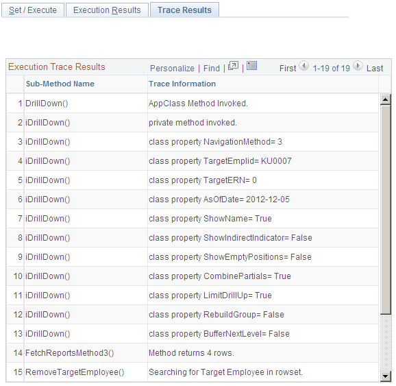

Invoke Direct Reports API - Trace Results Page
HR_DRPT_API_TRACE
View the trace log of a method execution.

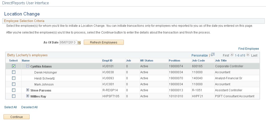

<Application Context> - Employee Selection Criteria Page
HR_DR_DIRECTREPORT
View a list of direct reports and select employees to add to the API Results list on the Invoke Direct Reports UI API page.
Direct reports information is used throughout HCM applications, especially in the manager self-service applications. Typically, direct reports information is used in a way that involves navigating an organizational hierarchy. For example, a manager uses Direct Reports to promote or give a raise to an employee. You may use direct report information in:
  • Drill-down mode, enabling managers to select workers for processing in a self-service application.
  • Chain of command mode, which determines workflow for approvals and notifications.

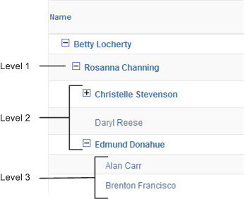

For example, the following hierarchical list represents a reporting structure with Betty Locherty (KU0007) at the top of the reporting structure. This reflects how the process displays the hierarchy in a table or list form for easy query. The list indents each different level of the reporting structure. The collapse (-) and expand (+) icons appear next to other workers that are managers.
Image: Example: Direct reports hierarchy list
This example illustrates a hierarchical list for the manager Betty Locherty and her direct reports.
Example of a direct reports hierarchy list
The resulting direct reports table entries would reflect a row for Betty Locherty and each worker that reports up to her: The level from Betty is defined as well as whether this person is a manager or supervisor. Then, additional rows are added for all the other managers that report to Betty and their reports. This table illustrates this scenario:
Note: This example is simplified with no employee record number or job information. It is used only to illustrate the concept of how the hierarchy is transformed to a table.

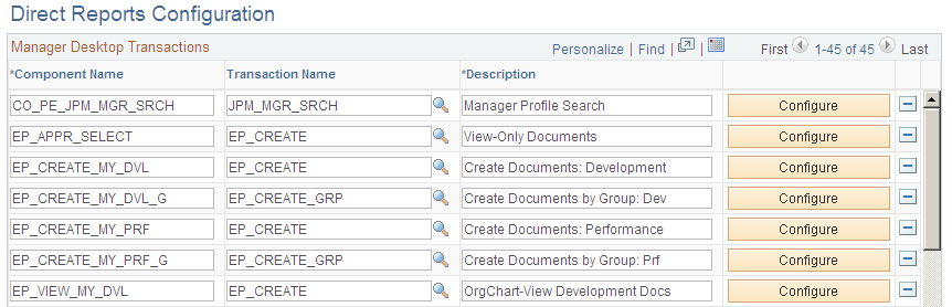

Use the Direct Reports Configuration page (HR_DR_UI_CFG_1) to configure the components and transactions that include the direct reports data functionality.
Image: Direct Reports Configuration page
This example illustrates the fields and controls on the Direct Reports Configuration page. You can find definitions for the fields and controls later on this page.
Displays a list of components and transactions for which direct reports functionality is enabled. You can add a new component and transaction or click the Configure button to specify how the direct reports API and UI function within the context of the component and transaction.

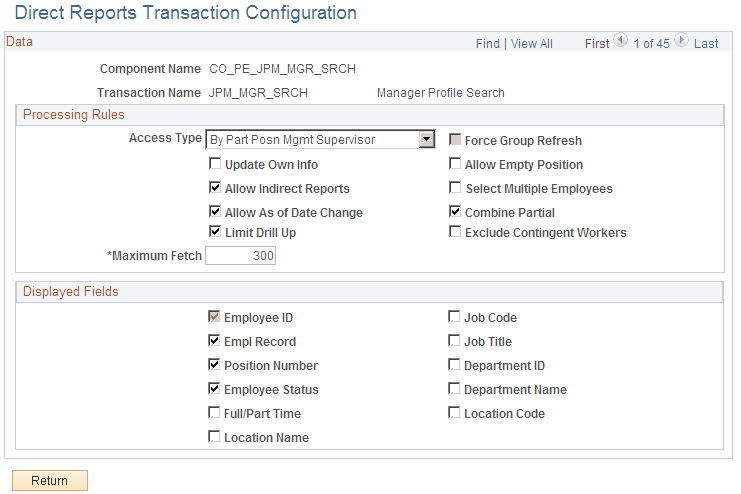

Use the Direct Reports Transaction Configuration page (HR_DR_UI_CFG_2) to select the actions and fields that appear on the direct reports UI for a transaction.
Image: Direct Reports Transaction Configuration page
This example illustrates the fields and controls on the Direct Reports Transaction Configuration page. You can find definitions for the fields and controls later on this page.
Processing Rules
Field or Control
Definition
Access Type
Select the reporting relationship to use for determining who reports to whom. This field defines the reporting relationship used by the Select Employee page for this transaction component and determines which method is used to identify who approves the transaction. Available options are:
  • By Department Manager ID: Defines the reporting relationship based on information in the Manager ID field on the Department Profile page (DEPARTMENT_TBL_GBL). For users who are department managers, the system displays a list of the workers who are in the user's department.
  • By Dept Security Tree: Determines person data access using information from the security tree. The system presents the user with a list of people whose data the user has access to, based on the security tree.
  • By Group ID: Determines data access using the Group ID set up in the group build feature.
  • By Part Posn Mgmt Dept Mgr ID: Defines the reporting relationship by the Reports To field on the Work Location page (JOB_DATA1) and the information in the Manager ID field on the Department Profile page. This is designed for the organizations that use Partial Position Management. The system searches for reporting relationship based on Report To first, and then for Department Manager ID.
  • By Part Posn Mgmt Supervisor: Defines the reporting relationship by both the Reports To and the Supervisor ID fields on the Work Location page. This is designed for the organizations that use partial Position Management. The system searches for reporting relationship based on Report To first, and then for Supervisor ID.
  • By Reports To Position: Defines the reporting relationship based on information in the Reports To field on the Work Location page. The system presents the user with a list of people whose job record indicates that they report to that user's position.
  • By Supervisor ID: Defines the reporting relationship based on information in the Supervisor ID field on the Work Location page. The system presents the user with a list of people whose job records indicate that they are supervised by the user.
Update Own Info
Select to indicate that the user can update their own records. When you select this check box, the manager's information is returned in the direct reports results list along with their direct reports or management hierarchy.
Allow Indirect Reports
Select to return indirect reports of the user. This navigates down the organizational hierarchy and returns direct reports of direct reports and so forth until the lowest reporting level is reached.
Allow As of Date Change
Select to enable the ability to change the as of date.
Limit Drill Up
Select to limit the drill up.
Maximum Fetch
Enter the maximum amount of rows the system should retrieve.
Force Group Refresh
Select to run the Group Build process (GBP002) to refresh the group membership prior to displaying direct reports. If you do not select this check box, the group members as of the last scheduled run of the process appear on the page. The system only makes this check box available if you select the access type By Group ID.
Allow Empty Position
Select to return unfilled position reports. This check box is available when you select one of the position-related options as an access type.
Select Multiple Employees
Select to enable the user to select more than one worker from the search results. If this field is selected, a check box appears next to the names in the results list, otherwise a Select button appears.
Note: You should not modify this value on delivered transactions, as they are built for selection of single or multiple values and if you change the setting, the transaction as delivered might not work.
Combine Partial
Select to indicate, when using one of the partial position management navigation methods, that the secondary method be applied even if the primary method returns valid data.
Exclude Contingent Workers
Select to not include contingent workers in the direct line reporting hierarchy.
Displayed Fields
Select one or more fields to appear within the direct reports list when rendered by the application.

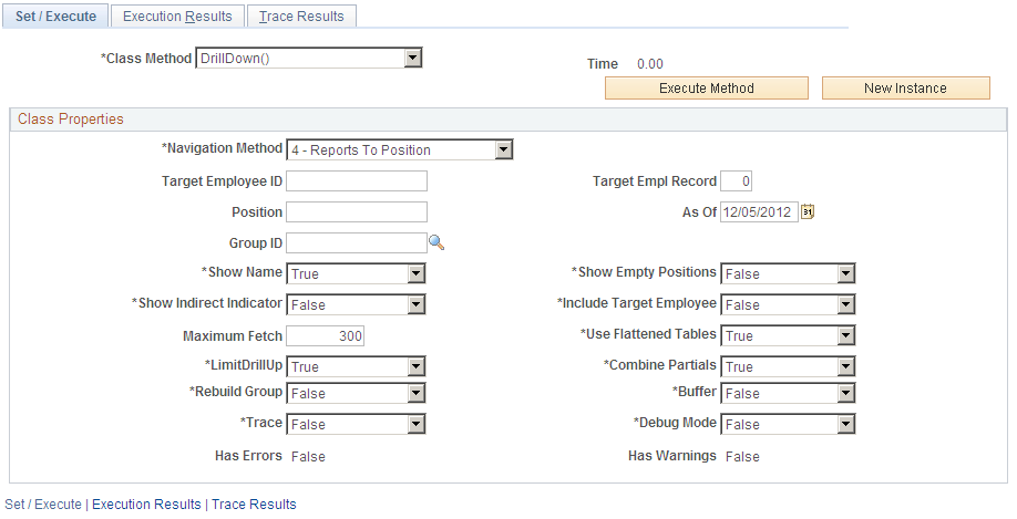

Use the Invoke Direct Reports API - Set / Execute page (HR_DRPT_API_EXEC) to test the direct reports API.
Image: Invoke Direct Reports API - Set / Execute page
This example illustrates the fields and controls on the Invoke Direct Reports API - Set / Execute page. You can find definitions for the fields and controls later on this page.
Field or Control
Definition
Class Method
Select a method from the available options:
  • DrillDown()
    Logically navigates down one level in the reporting structure to expose all of the direct reports for the worker . This is the most common use of the application class — this method returns the direct reports for a worker/job.
  • DrillUp()
    Logically navigates up one level in the reporting structure to expose the worker's supervisor and all the supervisor's direct reports.
  • GetPeers()
    Invokes the GetSupervisor() method for the target worker, and then invokes DrillUp() to expose all of the direct reports for this supervisor (which is the same as returning all the peers for a particular person).
  • GetSupervisor()
    Gets the supervisor for the target worker. This method is useful if the application needs to determine the target worker's supervisor, but not the supervisor's direct reports. For example, to send a notification to an worker's supervisor, the application must determine the identity of the supervisor.
Execute Method
Click to execute the method using the class properties you set.
Class Properties
The properties and their default values, if any, of the selected class appear in this page region. You can change any of these before executing the method.
Field or Control
Definition
Navigation Method
Select the method to use when determining reporting relationships. The options are: 1 - Department Security Tree, 2 - Supervisor ID, 3 - Department Manager ID, 4 - Reports To Position, 5 - Position / Supervisor ID, 6 - Position / Dept Manager, and 7 - Group ID.
Target Employee ID
Enter the employee ID of the target employee.
Target Empl Record
Enter the employee record number of the target employee.
Position
Enter the position of the target employee.
As Of
Enter the as of date to use when determining reporting relationships.
Group ID
Enter a group ID when Navigation Method is Group ID.
Show Name
Indicate if the system should include employee names in the Direct Reports Rowset grid. The default value is True.
Show Empty Positions
Identify whether unfilled positions should be returned in the Direct Reports Rowset grid when the navigation method is position-based. The default value is False.
Show Indirect Indicator
Identify whether the Direct Reports Rowset grid should indicate whether an employee has direct reports. The default value is False.
Note: Not applicable when Navigation Method = Department Securityor Group ID.
Include Target Employee
Should the target employee be filtered out of the returned Direct Reports Rowset and Supervisor Rowsets grids. When True, the target employee is not filtered out. When False (which is the default), circular reporting relationships are not shown.
Maximum Fetch
Enter the maximum number of rows to return.
Use Flattened Tables
Select True or False.
For better performance, the PeopleSoft application provides the framework for creating flattened views of reporting structures so that they can be accessed easily.
LimitDrillUp
Indicate if the user be allowed to DrillUp to a level higher than the target employee/job that was first specified. For example, when used in a manager self-service transaction, should I be able to drill down 2 levels, and then up 3 levels to expose and select my peers? On the other hand, when used in a notification process, drilling up beyond the initial target employee/job is essential. When True (which is the default), DrillUp is limited.
Combine Partials
Indicate, when using one of the partial position management navigation methods, whether the secondary method be applied even if the primary method returns valid data. The default value is True.
Rebuild Group
Specify, when the Navigation Method is Group ID, if the system should force the group to be rebuilt, even if group results for this effective date already exist.
Buffer
Indicate if the service should buffer the next level up and down to increase performance. The default value is False.
Trace
Indicate if the service should generate a trace of processing when executing class method. The default value is False.
Debug Mode
Specify, when Debug Mode = True, if any exceptions encountered during execution should be displayed prior to the results set being displayed.
Use the Invoke Direct Reports API - Execution Results page (HR_DRPT_API_RSLTS) to view the exceptions and data returned by a method.

Use the Invoke Direct Reports API - Trace Results page (HR_DRPT_API_TRACE) to view the trace log of a method execution.
Image: Invoke Direct Reports API - Trace Results page
This example illustrates the fields and controls on the Invoke Direct Reports API - Trace Results page. You can find definitions for the fields and controls later on this page.
Data appears on this page only if you select True for the Trace class property.

Use the <application context> - Employee Selection Criteria page (HR_DR_DIRECTREPORT) to view a list of direct reports and select employees to add to the API Results list on the Invoke Direct Reports UI API page.
Image: <application context> - Employee Selection Criteria page
This example illustrates the fields and controls on the <application context> - Employee Selection Criteria page. You can find definitions for the fields and controls later on this page.
Example of Location Change where you select an as of date and employees page
Access the <application content> - select page (HR_DR_SELECT_EMPS) [enter an as of date and click Continue on the <application content> page (HR_DR_ADDL_INFO)].
Use this page to select the direct reports. The direct reports plug-in executes within the context of the component and returns the results to the API Results grid on the Invoke Direct Reports UI API page.
Field descriptions for the example, and for any <Application Context> Employee Selection Criteria page (HR_DR_DIRECTREPORT), are as follows.
Field or Control
Definition
Find Employee
The Find Employee link above the header grid enables you to select from the same list of direct and indirect reports as if you expanded all nodes.
To search within your direct reports organization, click the Find Employee link. Enter criteria on the Find Employee page (HRDR_SRCH_EMPS_SEC), and then click Search.Select an employee to open in the transaction.
The Find Employee link appears only when the transaction applies to individuals. It does not appear for transactions where you select groups of individuals until you get to the point where you select individuals in that group
Note: The Direct Reports UI setup determines which employees are available for selection and which fields appear on the <Application Context> - Employee Selection Criteria page.
HR Status
The HR Status field appears on the Employee Selection Criteria page only if the Allow Indirect Reports check box is selected on the Direct Report Transaction Configuration page
Inactive employees can have active employees reporting to them directly or indirectly.
