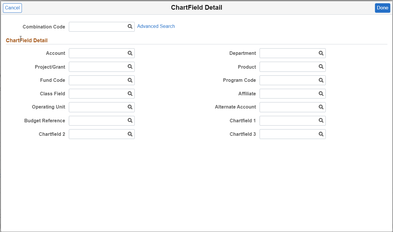

Use the ChartField Details page (HMCF_CHARTFLD_FLU) to enter or review ChartFields or combination codes in PeopleSoft HCM transactions.
For more information, refer Enter Time Page for Elapsed Time Reporter
Image: ChartField Details page (1 of 2)
This example illustrates the fields and controls on the left side of the ChartField Details page (1 of 2). You can find definitions for the fields and controls later on this page.
Fluid ChartField Details (1_2) Page
The Advanced Search link allows you to search for more options.
Image: ChartField Detail with combination code
This example illustrates the fields and controls on the ChartField Detail with combination code.
ChartField Detail (2_2) Page
Note: This page might have a more specific name, depending upon the transaction page from which you access it.
If the combination code is already entered on the transaction page, this detail page displays the associated ChartField values. If you are in correction mode or in a new effective dated row on the transaction page, then you can make changes to individual ChartField values and let the system determine if the new combination is valid. Otherwise the page is display only and you can only review the ChartField values.
If there is no combination code entered on the transaction page, all ChartField values are blank on the detail page and you can enter the specific ChartFields required.
Note: Only the ChartFields that are active on the Standard ChartField Configuration page are visible on this page.

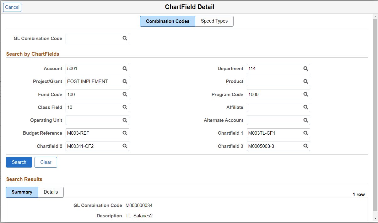

Search Options
Select from the available options to search for an existing ChartField combination. The options available include the following, depending upon the combination code tables that you have set up:
  • Combination Codes
    This option is available if you populated the Valid Combination table (VALID_COMBO_TBL).
  • Speed Types
    This option is available if you imported SpeedType values from PeopleSoft General Ledger.
Use the Search Combination Codes page (HMCF_CF_SEARCH_FL) to search for ChartFields using valid combination codes.
Image: Search Combination Codes page
This example illustrates the fields and controls on the Search Combination Codes page. You can find definitions for the fields and controls later on this page.
Fluid Search Combination Codes Page
Image: Combination Codes_Summary tab
This example illustrates the fields and controls on the Combination Code Details_Summary tab.
ChartField Details_Summary tab
Image: Combination Code_Details tab
This example illustrates the fields and controls on the Combination Code_Details tab.
ChartField Details_Details tab
Note: Only the ChartFields that are active on the Standard ChartField Configuration page are visible as fields on this page.
To search for a combination code:
  1. Enter individual ChartField values.
    The system finds all ChartField combination codes that match those ChartField values.
  2. Select the combination code that you want.
    The system returns you to the ChartField Details page with all individual ChartField values populated.
