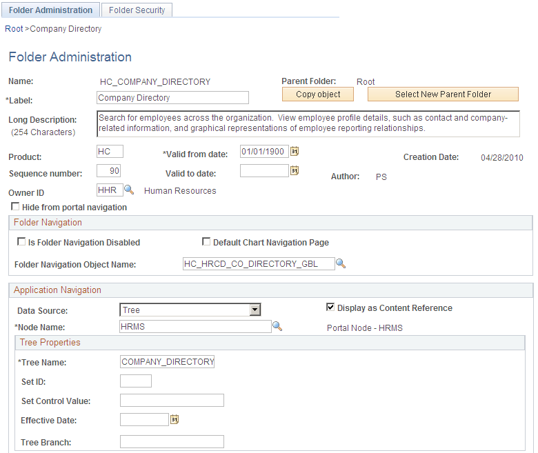

Folder Administration Page
PORTAL_FLDR_ADM
Update the portal folder definition for the Company Directory.

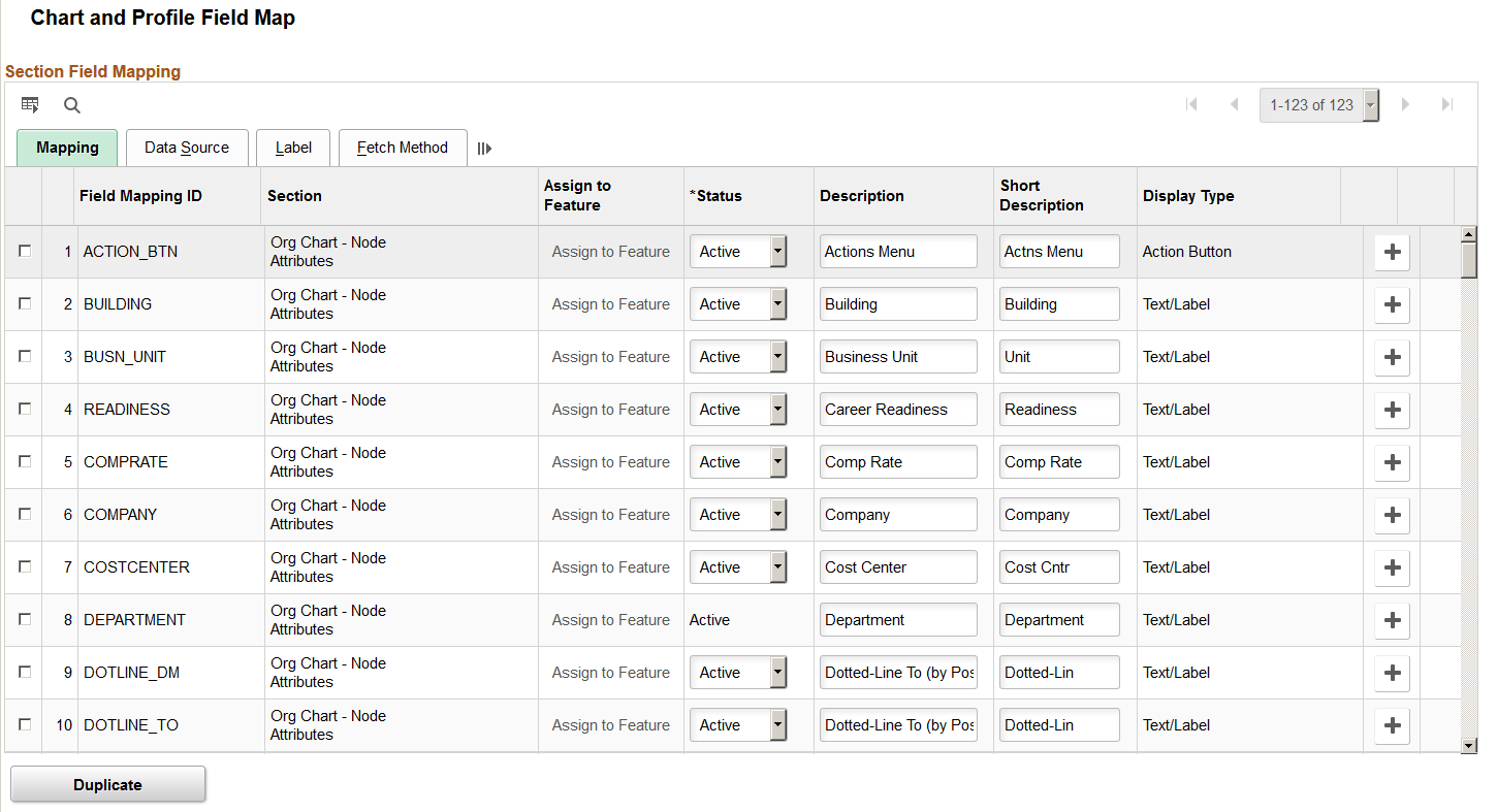

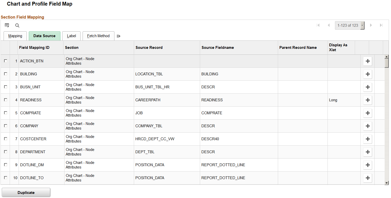

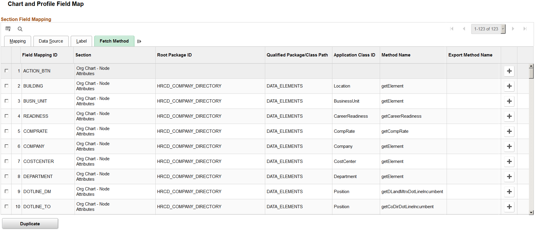

Chart and Profile Field Map Page
HRCD_SETUP_FLD_MAP
Define the org chart and profile field page mappings. Maintain or add additional fields that should be available on the Org Chart and Profile pages of the Org Chart Viewer.

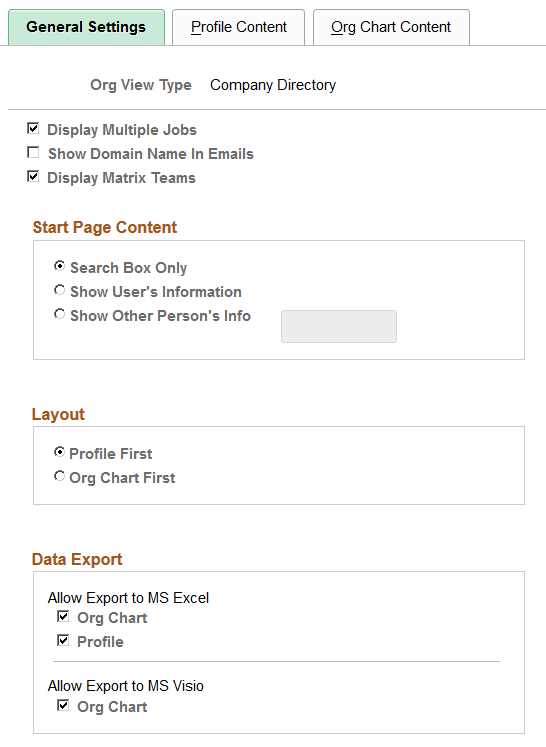

Chart and Profile Settings - General Settings Page
HRCD_SETUP_GENERAL
Define default startup page content and layout settings for each org view type.

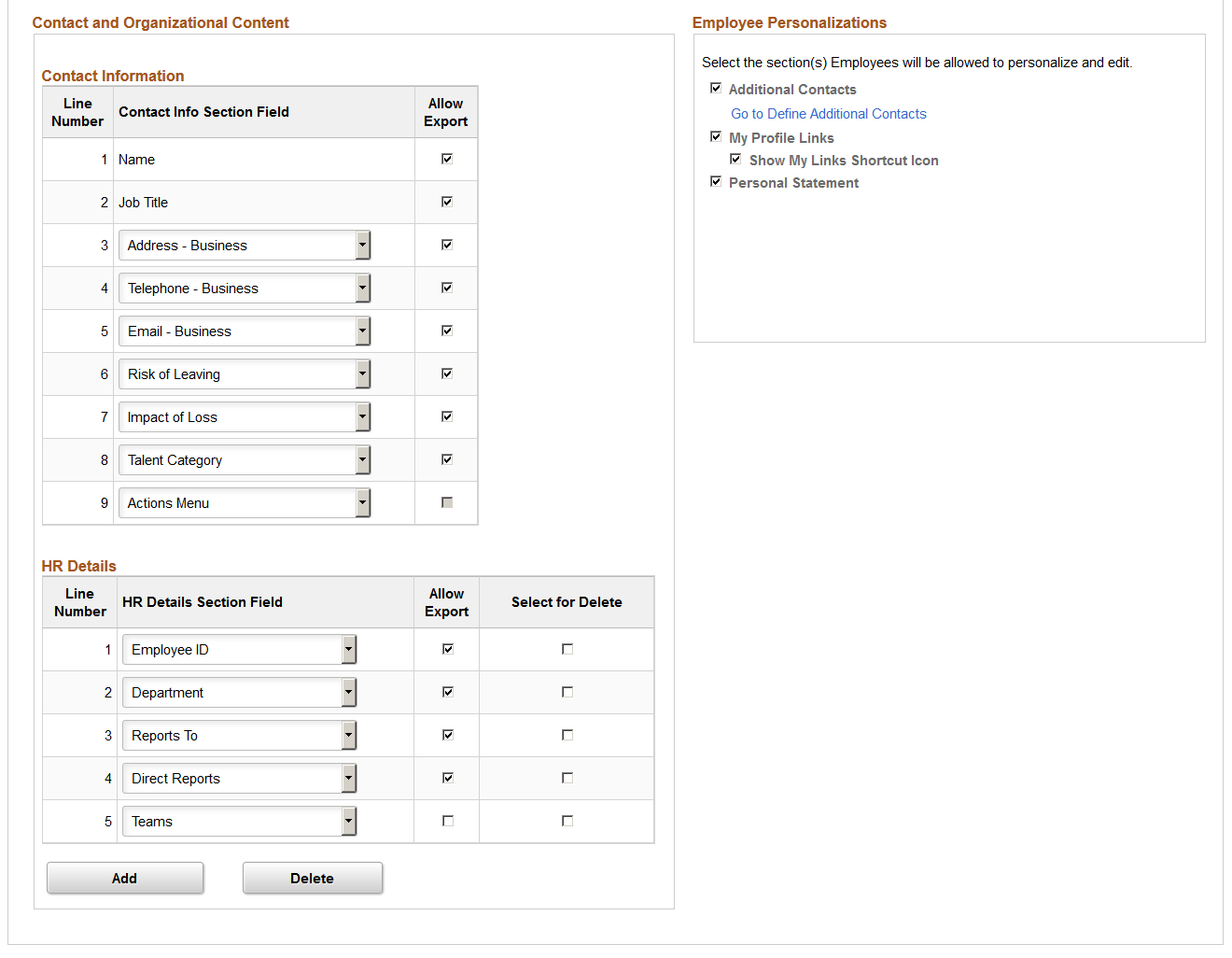

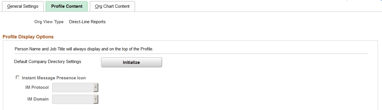

Chart and Profile Settings - Profile Content Page
HRCD_SETUP_PROFILE
Select the contact information, HR details, and employee personalization field options that should appear on the Profile page for each org view type.

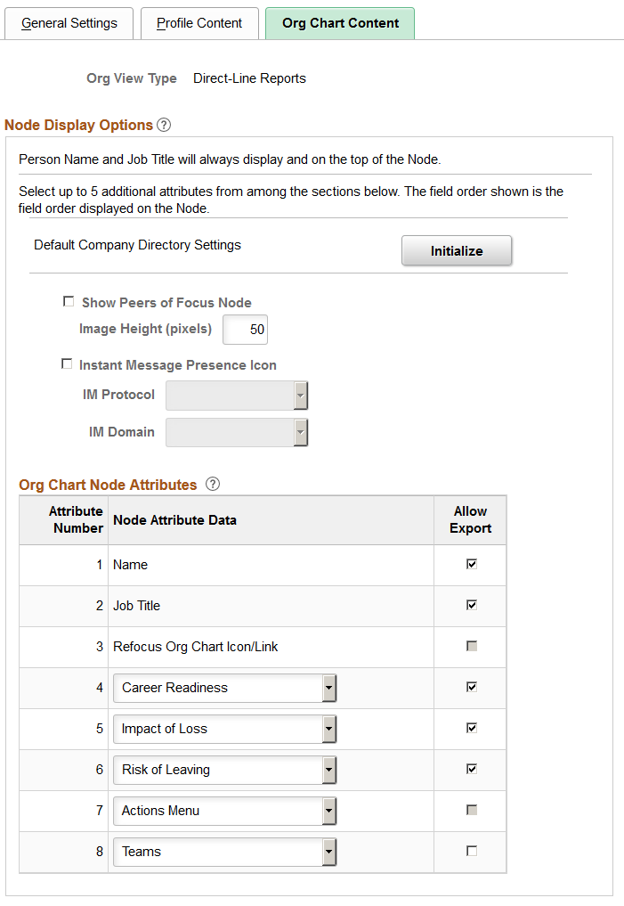

Org Chart Content Page
HRCD_SETUP_OC_NODE
Select the organization chart field options that should appear on the Org Chart page for each org view type.

  3. Update the Company Directory (HC_COMPANY_DIRECTORY) folder definition to ensure the tree name is equal to the tree created in step 1. This information is used for the Org Chart Viewer, Company Directory folder.
    Note: This step needs to be performed any time the tree name is changed.
    See Folder Administration Page.

    1. (Optional, since many fields are delivered) Map fields for the org chart and profile pages.
      See Chart and Profile Field Map Page.

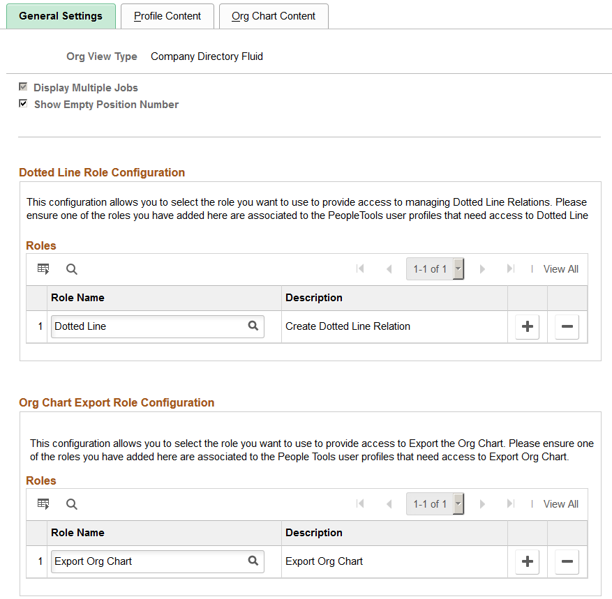

Understanding the PeopleSoft Fluid User Interface for the Company Directory
The Fluid Company Directory uses much of the same setup as you would to support the company directory on a workstation or mobile devise (see Understanding the Org Chart Viewer and Company Directory Setup Steps). Remember these important steps when working with the Fluid Company Directory feature:
  1. Run the Direct Reports Table Build process (Set Up HCM, Common Definitions, Direct Reports for managers, Direct Reports Table Build).
  2. Build your trees using the Tree Builder component (Set Up HCM, Common Definitions, Org Chart Viewer, Tree Builder)
  3. Build the HC_HR_COMPANY_DIRECTORY1 search index (PeopleTools, Search Framework, Administration, Deploy/Delete Object and PeopleTools, Search Framework, Administration, Schedule Search Index).
    Search definitions are business objects that are made available for text search. Each search definition is associated with a query to capture the business context data needed for the search. The search definition provides the information required by the search framework to enable the system to create search results (search documents). For more information, see Understanding PeopleSoft Search Framework Implementation for HCM.

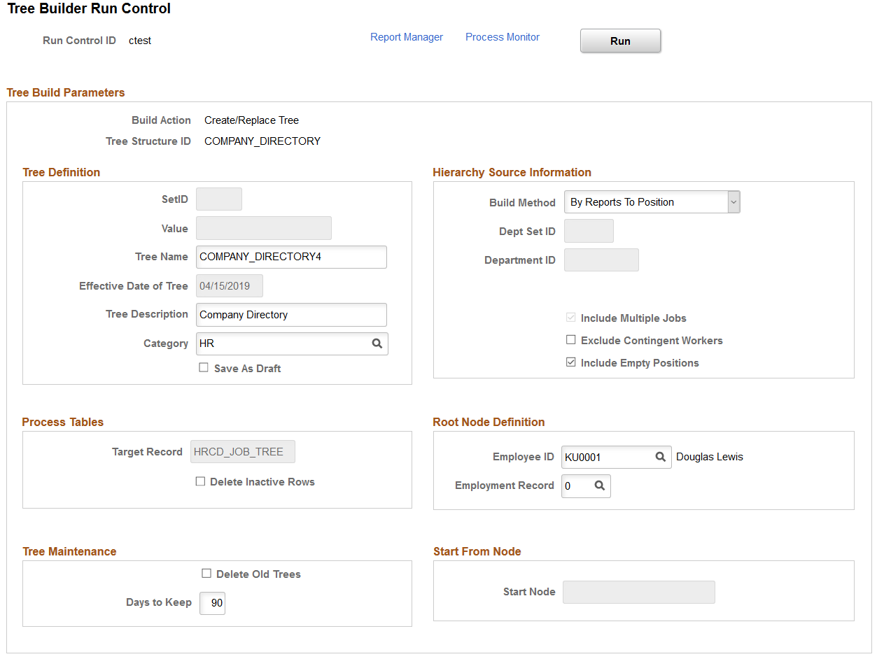

Use the Tree Builder Run Control page (HR_TREEBLD_RNCTL) to run the Job Tree Builder process to create or rebuild an entire tree, update a portion of a tree starting from a specific node, or update the tree's source data table without making any alterations to an existing tree.
Image: Tree Builder Run Control page
This example illustrates the fields and controls on the Tree Builder Run Control page. You can find definitions for the fields and controls later on this page.
Use the Job Tree Builder (HR_TREEBLD_RNCTL) component to create trees. You can use trees to define your reporting structures for the Company Directory and Matrix Teams configured to use a tree.
The Job Tree Builder Run Control page executes the HR_TREEBLD Application Engine process. This process creates trees of jobs using the selected Build Method option.
Warning! Certain characters are inappropriate for use in a URL and should not be used in the names of trees that you use.
For a list of these characters, see PeopleTools: PeopleSoft Tree Manager, "Creating Trees," Understanding Steps to Create Trees, Characters Not Used in Tree Name, SetID, Set Control Value, and Tree Branch
See Understanding the Org Chart Viewer and Company Directory Setup Steps.
Field or Control
Definition
Build Action
Indicate whether you want to create or rebuild an entire tree, update a portion of a tree starting from a specific node or location on a tree, or update the trees source data table without making any alterations to an existing tree. Valid values are:
  • Create/Replace Tree
    Creates a new tree or, if a tree exists for the Tree Definition parameters entered on this page, deletes and recreates the tree.
  • Update Existing Tree-From Node
    Updates an existing tree from a tree node identified in the Start Node field. The start node cannot be a root node from an existing tree. All nodes under the selected tree node will be refreshed according to the hierarchy Build Method selected.
  • Update Process Tables Only
    No tree processing occurs. The target table is updated, enabling you to manually add new Jobs added by the process to the tree using Tree Manager.
The following table represents the fields within each group box that are available, depending on the Build Action value that is selected:
Group Box
Create/Replace Tree
Update Existing Tree-Form Node
Tree Definition
  • Tree Name
  • Tree EffDt
  • Tree Description
  • Category
  • Save As Draft
  • Tree Name
  • Tree EffDt
  • Save As Draft
N/A
Hierarchy Source Information
Build Method
Build Method
N/A
Root Node Definition
  • Employee ID
  • Empl Record
N/A
N/A
Start From Node
N/A
Start Node
N/A
Note: N/A indicates that a field availability is not applicable for this method and group box.
Field or Control
Definition
Tree Structure ID
Select a tree structure ID. The value selected in Tree Structure ID field determines the fields that are required to uniquely identify a tree and it tells the process which type of tree it should build when the process is run.
For example, Matrix Teams use the MATRIX_BY_JOB tree structure ID and Company Directory trees use the COMPANY_DIRECTORY tree structure ID.
Note: If you are building a job tree for the Company Directory or Matrix Teams, you must enter the corresponding Tree Structure ID values.
The system uses the HR_JOBTREE_META table to retrieve meta-data from the tree structure ID to auto-populate the following fields on this page: Set ID, Tree Name, Tree EffDt, Tree Description, Category, Target Record, and Exception Table. The tree structure ID also determines the fields that are required in the Tree Definition group box.
Tree Definition
Many of the fields in this group box are available when the Build Action values Create/Replace Tree and Update Existing Tree-From Node are selected.
Field or Control
Definition
SetID and Value
Enter the set ID and set control value of the tree, if applicable. Availability of this field depends on the configuration of the tree structure ID.
For example, these fields are not available when using the COMPANY_DIRECTORY or MATRIX_BY_JOB tree structures required by the Org Chart Viewer, Company Directory or Matrix Teams features.
Tree Name
Enter the name of the tree.
This field is available when the Create/Replace Tree and Update Existing Tree-From Node Build Action values are selected.
Note: For the Company Directory to work properly, you need to update the portal definition to use the same tree name you have identified here.
Effective Date of Tree
Enter an effective date for the tree. If a date is not provided, the process will use the system date when creating the tree. This enables you to leave this field blank and set up the run control as a recurring process.
This field is required for the Update Existing Tree-From Node build action. When updating an existing tree, you must point the process to a unique tree, so an effective date is required. When you select the Update Existing Tree-From Node build action option, this field provides by default the current tree for the SetID, Set Control Value, and Tree Name field values you entered on this page. SetID and Set Control Value field values may not be required for all tree structure IDs.
This field is available when the Build Action values Create/Replace Tree and Update Existing Tree-From Node are selected.
Tree Description
Enter the description of this tree.
This field is available when the Build Action value Create/Replace Tree is selected.
Category
Enter the tree category for a tree.
Save As Draft
Select this check box when you want to save the tree in draft mode. To change the status of the tree, run the process again with the Save As Draft check box deselected or save the draft as a valid tree through Tree Manager.

Include Multiple Jobs
Indicates if the tree is to include nodes for both primary and non-primary jobs. If this field is not selected, only nodes for active primary jobs will be included in the tree.
For the tree structure ID COMPANY_DIRECTORY, this value comes from the Chart and Profile Settings - General Settings page and the check box is not available on this page.
Note: For the tree structure ID COMPANY_DIRECTORY, if you have selected the Display Multiple Jobs check box on the Chart and Profile Settings - General Settings page, the system will allow additional jobs in the search only when these jobs are present in the tree. Therefore, if you change the Display Multiple Jobs setting on the Chart and Profile Settings - General Settings page, you should run the Job Tree Builder process to ensure that all jobs are captured on the tree.
Exclude Contingent Workers
Select to exclude contingent workers who do not have direct reports.
Note: To maintain the integrity of the hierarchy, contingent workers with active direct reports are always included in the tree, whether or not this check box is selected.
Include Empty Positions
Select to include empty positions within your Company Directory tree. When you build your tree with this check box selected, empty positions will display within the fluid Company Directory pages.
This option is available when your organization uses partial or full Position Management and you select a Build Method that is position-based (By Part Posn Mgmt Dept Mgr ID, By Part Posn Mgmt Supervisor, or By Reports To Positions).
This video provides and overview of viewing empty positions on the Company Directory::
Image Highlights, PeopleSoft HCM Update Image 28: Company Directory-Display Empty Positions
Process Tables
Field or Control
Definition
Target Record
The Target Record field is display only. This field is populated based on the Tree Structure ID value. The target record refers to the table containing the source data for all trees created using the selected Tree Structure ID.
Delete Inactive Rows
Select this check box to have the process delete rows in the process table associated with inactive employee jobs.
The fields in this group box are available when the Build Action value Create/Replace Tree is selected.
Field or Control
Definition
Employee ID and Employment Record
Enter the employee ID and his or her employment record number that should serve as the topmost node, or root node, of the tree.
Tree Maintenance
Field or Control
Definition
Delete Old Trees
Select this check box for the process to delete trees older than the number of days listed in the Days to Keep field.
Days to Keep
Indicate the number of days back to keep trees.
Start From Node
The field in this group box is available when the Build Action value Update Existing Tree-From Node is selected.
Field or Control
Definition
Start Node
Select a node from the tree specified in the Tree Definition group box of the page.
The Job Tree Builder process will delete any nodes reporting directly or indirectly to the start node specified. Then it will create nodes based on the Build Method value selected.
Note: Depending on how the existing tree was created, an employee may have multiple nodes in the existing tree. For example, this can occur when:
- The employee has or had multiple jobs.
- The employee reports to a position that has or had multiple incumbents.
- The employee is or was assigned to a department with multiple managers (Manage Positions with multiple incumbents). If the prompt list shows multiple nodes for the same person, then review the tree in Tree Manager to ensure that you are selecting the appropriate start node.

Use the Folder Administration page (PORTAL_FLDR_ADM) to update the portal folder definition for the Company Directory.
The portal folder HC_COMPANY_DIRECTORY is delivered to use the tree name COMPANY_DIRECTORY. If your organization uses another name, you will need to update the portal folder definition in order for the Company Directory to work properly to match the tree name you entered when creating your tree.
Image: Folder Administration page for the Company Directory
This example illustrates the fields and controls on the Folder Administration page. You can find definitions for the fields and controls relevant to the Company Directory later on this page.
Field or Control
Definition
Element Definition
Enter the tree name you used when building the tree for the Company Directory. This tells the Company Directory where to find the structure for the portal breadcrumbs and org chart.
For trees based on the tree structure ID of COMPANY_DIRECTORY, the system uses the required Tree Name field to uniquely identify a tree. The delivered field value is COMPANY_DIRECTORY, but the Company Directory will work with any tree name as long as you created the tree based on the COMPANY_DIRECTORY tree structure ID.
Effective Date
(Optional) Enter the effective date for the tree.
If this field is populated, the Company Directory uses the effective date of the Tree Name value identified on the Folder Administration page.
If this field is blank, the Company Directory uses the current effective dated tree identified in Tree Name field.
Leaving this field blank enables you to run a nightly process that creates a new effective-dated version of the tree. If the Effective Date field is left blank, you do not need to make any changes to the Folder Administration page because the Company Directory will always use the current tree.
For more information and details on setting up and working with the portal folders, see PeopleTools: PeopleTools Portal Technologies, "Administering Portals," Understanding Folder Administration.
Use the Chart and Profile Field Map page (HRCD_SETUP_FLD_MAP) to define the org chart and profile field page mappings.
Image: Chart and Profile Field Map page: Mapping tab
This example illustrates the fields and controls on the Chart and Profile Field Map page: Mapping tab. You can find definitions for the fields and controls later on this page.
Use the Chart and Profile Field Map component to define the data elements that are configured in the Chart and Profile Settings pages as well as the Talent Summary setup pages. This component has four tabs that you use to define the rules for fetching and displaying each data element.
Mapping Tab
Use this tab to map the data elements.
The delivered data that appears on this tab cannot be modified except for Status, Description, and Short Description.
Field or Control
Definition
Section
Enter the section that is located on the various pages to which this field should be mapped. Valid values are Profile - HR Details, Profile - Contact Information, General, and Org Chart - Node Attributes.
Note: The General field option is used for the Talent Summary feature.

Data Source Tab
Use this tab to identify the source record information specific to the data element.
Image: Chart and Profile Field Map page: Data Source tab
This example illustrates the fields and controls on the Chart and Profile Field Map page: Data Source tab. You can find definitions for the fields and controls later on this page.
The delivered data in this tab cannot be modified.

Fetch Method Tab
The tab is used to assign the code used for fetching and displaying the data element.
Image: Chart and Profile Field Map page: Fetch Method tab
This example illustrates the fields and controls on the Chart and Profile Field Map page: Fetch Method tab. You can find definitions for the fields and controls later on this page.
The delivered data in this tab cannot be modified, but new rows can be added.
Field or Control
Definition
Qualified Package/Class Path
Displays the qualified package/class in the root package ID that resolves the field mapping element value.
Application Class ID
Displays the application class ID in the qualified package/class path that resolves the field mapping element value.
Note: Any class assigned here must be inherited from HRCD_COMPANY_DIRECTORY:DATA_ELEMENTS: DataElementBase.
Method Name
Displays the method name in the application class ID that resolves the field mapping element value.
Note: Field mapping IDs that are configured to use a method name getElement are using the logic inherited from the base class.
Export Method Name
Displays the method name in the application class ID that resolves the export data for the field mapping element. An export method is only required when if the logic in the class assigned to method name is not also compatible with export.

Use the Chart and Profile Settings search page to select an org view type for page configuration.
Image: Chart and Profile Setting search page
This example illustrates the fields and controls on the Chart and Profile Setting search page. You can find definitions for the fields and controls later on this page.
You use the Chart and Profile Settings component to configure the pages of the Org Chart Viewer for each org view type.
  • The desktop Org Chart Viewer component consists of up to three types of organizational views (shown as folders and tabs to the user). The PeopleSoft application delivers these desktop org view types:
    • Company Directory — a view of the Company Directory.
    • Direct-Line Reports — a view of a user’s direct-line reports.
    • Matrix Reports — views of the matrix teams associated with a user.
  • You can also define settings for the PeopleSoft Fluid User Interface, which is designed to be used on mobile devices, but can also be used on a laptop and desktop. The PeopleSoft application delivers the Company Directory Fluid org view type for this.
All org view types use a similar setup format. The Chart and Profile Settings component may contain up to three pages (the General Settings, Profile Content, and Org Chart Content pages), however, some fields and pages are hidden depending upon the org view type you select.
Field or Control
Definition
Org View Type
Select from one of the list of valid values to define the setup for that specific org view type.
Valid values for the desktop version of the org chart viewer are Company Directory, Direct-Line Reports, or Matrix Reports.
The valid value for the PeopleSoft Fluid User Interface is Company Directory Fluid.
Use the General Settings page (HRCD_SETUP_GENERAL) to define default startup page content and layout settings for each org view type.
Image: Chart and Profile Settings – General Settings page for the Company Directory Fluid org view type
This example illustrates the fields and controls on the Chart and Profile Settings – General Settings page for the Company Directory Fluid org view type. You can find definitions for the fields and controls later on this page.
Chart and Profile Settings - General Settings page for the Company Directory Fluid org view type
Image: Chart and Profile Settings – General Settings page for the Company Directory org view type
This example illustrates the fields and controls on the Chart and Profile Settings – General Settings page for the Company Directory org view type. You can find definitions for the fields and controls later on this page.
Chart and Profile Settings - General Settings page for the Company Directory org view type
This video demonstrates the dotted line role configuration feature:
Image Highlights, PeopleSoft HCM Update Image 24: Company Directory Setup Enhancement

Field Availability on the General Settings Page by Org View Type
These tables list the field elements available on the Chart and Profile Settings - General Settings page according to the Org View Type value you select:
Fields at the top of the page:
The following field elements are available at the top of the page for the mentioned org view types:
Page Element
Company Directory
Direct-Line Reports
Matrix Reports
Yes
(display only)
Yes
N/A
N/A
Show Empty Position Number
Yes
N/A
N/A
N/A
Show Domain Name in Emails
N/A
Yes
Yes
Yes
Display Matrix Teams
N/A
Yes
Yes
Yes
Dotted Line Role Configuration group box:
The following field elements are available in the Dotted Line Role Configuration group box for the mentioned org view type:
Page Element
Role Name
Yes

General Settings
Use the first several check boxes on the General Settings page to specify the amount of detail the system should display about a person.
Field or Control
Definition
This field is available for selection for the Company Directory org view type.
Select to have the Company Directory search feature return all multiple job or additional job rows for a person. Deselect this option to have the system display the primary job only for the person.
Note: For the Company Directory Fluid org view type, this field is display only and comes from the setting that was selected for the Company Directory org view type.
When you select this check box, the Job Title fields on the Profile Content and Org Chart Content pages will be automatically selected. Also, the Company Directory - Profile page will display the Additional Jobs field in the HR Details group box.
This field is available for the Company Directory Fluid org view type.
Select this check box to have the Company Directory pages display the position number in an empty position row or org chart node box. The text Empty Position and the position title always display for rows or org chart nodes of vacant positions. Deselect this option to display only the text Empty Position and the position title without the position number. This check box is deselected by default.
Note: You must use a Company Directory tree that includes empty positions in order for empty positions to appear within the Company Directory pages. For more information on building trees that include empty positions, see the Tree Builder Run Control Page topic.
This field is available for the Company Directory Fluid Org View Type.
Field or Control
Definition
Role Name
Select the role or roles that will provide a user access to the Profile - Manage Dotted Line Page, where a person can create or remove dotted line reporting relationships.
The PeopleSoft application delivers the Dotted Line role for this purpose, but you can identify other roles that should be granted access to the dotted line pages. You must ensure that at least one of the rows entered here is associated with a user’s profile.
Note: If no roles are defined in this setup grid, users will not be able to manage dotted line relationships in the Company Directory profile pages.
Org Chart Export Role Configuration
Field or Control
Definition
Role Name
Select the role or roles that will provide a user the ability to export the org chart data from the Organization Chart Page. When you enter a role here and assign this role to the user, the Export to Excel and Export to Visio menu items will be available from the Actions List.
The PeopleSoft application delivers the Export Org Chart role for this purpose, but you can identify other roles that should be granted access to export org chart functionality from the Actions List menu of the Company Directory Org Chart page. You must ensure that at least one of the rows entered here is associated with a user’s profile.
Note: If no roles are defined in this setup grid, users will not be able to export the Company Directory organization chart from the fluid pages.
Start Page Content
These fields are available for the Company Directory Org View Type.
Use this group box to specify the default settings for the Company Directory start page. Choose from one of the three options to define what information the system should display to the user when first accessing the Company Directory. Users can override this default setting by defining their own preferences.
Field or Control
Definition
Search Box Only
Select this option to display the search field only, where you can search by name, job title, department, or email for any active person in the system. You will also have the option to use an advanced search, where you can enter additional search criteria.
Show User's Information
Select this option to have the system display the information of the user accessing the Org Chart Viewer pages. The user will appear as the focus of the node or Profile page, depending on the layout setting selected.
The search field is also available at the top of the page when you select this option.
Show Other Person's Info
Select this option and enter a person’s employee ID in the accompanying field to have the system display the information of this employee on the startup page. The identified person will appear as the focus of the node or the Profile page, depending on the layout setting selected.
Note: In order to populate this field, a tree must already be created and the tree name must match the Tree Name provided on the portal folder definition HC_COMPANY_DIRECTORY.
For more information, see PeopleTools: PeopleTools Portal Technologies, "Administering Portals," Managing Portal Objects.
See Org Chart Viewer - Preferences Page.
Layout
These fields are not available for the Company Directory Fluid org view type.
Use this group box to define which page of the Org Chart Viewer pages the system should display first. The value you select here will determine the page order. The user can override these default settings by defining personal preferences.
Field or Control
Definition
Profile First
Select this option to have the system display the Profile page for the focus person. The Profile page displays detailed information about the person, such as contact information, HR details, and personalized links and information. This option will also display the Profile page as the first page in the component.
Org Chart First organizational chart first
Select this option to have the system display the Org Chart page. The Org Chart page displays a multi-leveled graphical representation of the focus person’s reporting structure, as well as high-level details about this person. This option will also display the Org Chart page as the first page in the component.
Data Export
Use this group box to enable exporting options for the user.
Field or Control
Definition
Allow Export to MS Excel (allow export to Microsoft Excel) – Org Chart and Profile
Select these check boxes to enable the user to export profile or org chart information to a Microsoft Excel spreadsheet.
Users will be able to export the following hierarchical reporting details:
  • Focus node’s manager.
  • Focus node.
  • Focus node’s siblings if such is selected to display via the Org Chart tab setting.
  • Focus node's hierarchy (from focus node down); all of the manager’s direct or dotted-line (matrix) reports, and their indirect reports.
Allow Export to MS Visio – Org Chart
Select this check box to enable the user to export org chart information to a Microsoft Visio drawing.
Use the Profile Content page (HRCD_SETUP_PROFILE) to select the contact information, HR details, and employee personalization field options that should appear on the Profile page for each org view type.
Image: Chart and Profile Settings- Profile Content page for the Direct-Line Reports org view type (1 of 2)
This example illustrates the fields and controls on the Chart and Profile Settings - Profile Content page (1 of 2). You can find definitions for the fields and controls later on this page.
Image: Chart and Profile Settings- Profile Content page for the Direct-Line Reports org view type (2 of 2)
This example illustrates the fields and controls on the Chart and Profile Settings - Profile Content page (2 of 2). You can find definitions for the fields and controls later on this page.
The Profile pages will display detailed information about a person using the fields you select on this page for the individual org view types. The field content is specific to the org view type.
The field elements on this page are available for all org view types unless otherwise specified.

Initialize
Click to have the system provide by default the same settings you established for the Company Directory org view type.
This field element is available for the following org view types: Direct-Line Reports and Matrix Reports.
The Instant Message field elements are not available for the Company Directory Fluid org view type.

Contact and Organizational Content
Select fields in this group box that should appear on the Profile page. This information comes from the HR tables. The field elements in this group box are available for all org view types unless otherwise specified.
Field or Control
Definition
Contact Information
Select contact-related fields that will appear as person profile data in the Contact Information group box or page of the Company Directory - Profile page.
Note: Although the Contact Information section will display the fields in the order you select, it will first group the information in the following contact type order and then by the order you select:
1. Phone number types
2. Email types
3. Address types
4. Other
For example, you have defined the following sort order:
Address- Business
Telephone - Mobile
Email - Business, and then
Telephone - Business
The Contact Information section will display phone number contacts first, then email contacts, then addresses, with each group sorting the content within those contact types according to your defined order. In this scenario it would appear like the following:
Telephone - Mobile
Telephone - Business.
Email - Business
Address- Business
Valid fields values are:
  • Name
    This field display is always selected and listed as line number 1.
  • Job Title
    For the Company Directory org view type, Job Title is always selected for line number 2 when Display Multiple Job is selected on the General Setting page. If Display Multiple Job is deselected, then you have the option of selecting Job Title or leaving this field blank.
    For the other org view types, Job Title is always selected.
  • Action Menu
    Actions Menu is the only field display option available for line number 9.
    Select this field display option if you want to enable the user to perform self service transactions from his or her profile, such as an address or name change, or for direct or indirect reports.
    The Actions Menu values are configured through PeopleSoft Related Content Services. This framework enables developers and subject matter experts to link application pages with contextually relevant collaborative content. For more information, see PeopleTools: PeopleTools Portal Technologies, "Developing and Configuring Related Content".
  • Department
    Department is always selected for the Company Directory Fluid org type for line number 3.
These options are available for the remaining line numbers:
  • Address - Business
    When you select and address field and you have licensed and enable Oracle Maps Services on the Installation table, the page will display the View Address Map button to access a map of the address on the Profile pages.
  • Building
  • Email - Business
  • Floor Nbr (not available for the Company Directory Fluid org view type)
  • Location (not available for the Company Directory Fluid org view type)
  • Telephone - Business
  • Telephone - Mobile
Addition values specific to the Direct-Line Reports and Matrix Reports org view types:
  • Career Readiness *
  • Comp Rate *
  • Hire Date
  • Impact of Loss *
  • Organizational Relationship
  • Risk of Leaving *
  • Talent Category *
Note: * These field elements are considered to be sensitive data. Sensitive data will only display if the employee reports to the signed-in user, hence the user will only see this information for his or her subordinates.
Job Details
Select job detail fields that will appear as person profile data in the Job Details group box or panel of the Profile page.
The pages will display the fields in the order you select them on this page.
Select from these valid values for all remaining org view types:
  • Business Unit
  • Company
  • Cost Center
  • Department (selected in the Contact Information group box for the Company Directory Fluid org view type)
  • Direct Reports (provided as a page for the fluid user)
  • Dotted-Line To (by Position) (not available for the Company Directory Fluid org view type)
  • Job Family
  • Job Function
  • Manager Level
  • Peers (provided as a page for the fluid user)
  • Employee ID
  • Regular/Temporary
  • Reports To (not available for the Company Directory Fluid org view type)
  • Standard Hours
  • Standard Work Period
  • Union
  • Years of Service
Value specific to the Company Directory org view type: Additional Jobs.
Value specific to the Company Directory and Direct-Line Reports org view types: Teams (provided as a page for the fluid user).
Value specific to the Direct-Line Reports org view type: Salary Plan/Grade/Step.
Note: Salary Plan/Grade/Step is considered to be sensitive data. Sensitive data will only display if the employee reports to the user, hence, the user will only see this information for his or her subordinates.
Value specific to the Direct-Line Reports and Matrix Reports org view types: Reports Count - Total.
Values specific to the Matrix Reports org view type:
  • Other Teams
  • Team Directs
  • Team Peers
  • Team Reports To
  • Team Total Reports
When there is an empty position, only these values will display, if selected:
  • Direct Reports
  • Job Family
  • Job Function
  • Manager Level
  • Peers
  • Reports To
  • Union
Values specific to the Company Directory Fluid org view type:
  • Address - Location
  • Building
  • Employee ID
  • Location
Allow Export
Select this check box to enable the user to export this field content.
This page element is not available for the Company Directory Fluid org view type.

Employee Personalizations
Use information in this group box to determine which personalization group boxes should appear on the right side of the Profile page.
Field or Control
Definition
Display Additional Contacts
Select this option to have the Additional Contact Information group box available on the Profile page. When this option is selected, the system will enable the user to select from the different contact types you specify on the Additional Contact Types page.
If you deselect this option, the Additional Contact Information group box will not be available on the Profile page.
Go to Define Additional Contact Types
Click this link to access the Additional Contact Types page to add or review contact types.
See Additional Contact Types Page.
My Profile Links
Select this option to have the My Profile Links group box available on the Profile page. Profile links enable the user to define shortcut links to other web sites.
When you select this option, the Show My Links Shortcut Icon check box on this page will be available for selection.
If you deselect this option, the My Profile Links group box will not be available on the Profile page.
Select this check box to have the shortcut icons associated with target web addresses appear next to the label entered by the user. Some sites may or may not have a default shortcut icon. For example, when this check box is selected, and the user enters the web address for Oracle (http://oracle.com), the following icon will appear next to the label name.
This option is available when the Display My Profile Links check box is selected.
Personal Statement
Select this option to have the Personal Statement group box available on the Profile page. This functionality enables the user to enter personalized text. Users will update their personal statement using the Rich Text Editor.
See PeopleTools: Using PeopleSoft Applications, "Using PeopleSoft Application Pages," Working With the Rich Text Editor
If you deselect this option, the Personal Statement group box will not be available on the Profile page.
Use the Org Chart Content page (HRCD_SETUP_OC_NODE) to select the organization chart field options that should appear on the Org Chart page for each org view type.
Image: Org Chart Content page
This example illustrates the fields and controls on the Org Chart Content page. You can find definitions for the fields and controls later on this page.
Node Display Options
Field or Control
Definition
Initialize
Click this button to have the system provide by default the same settings you established for the Company Directory org view type.

Image Height (pixels)
Enter size in which the height of an employee picture should appear within the node. This option is available when the Display Photo check box is selected on the HCM Options Page of the Installation Table.
This field element is not available for the Company Directory Fluid org view type.
Field or Control
Definition
Instant Message Presence Icon
Select this check box to have the Org Chart node display the IM icon for a person, if IM information exists in the HR person model. Instant Message IDs for a person can be stored on the Contact Information page of personal data in HR.
IM Protocol (instant messaging protocol)
Identify the IM protocol that the system should use when displaying the IM icon. Valid values include GTALK, MSN, XMPP, and YAHOO. If a person does not have an IM protocol type defined in his or her personal data, the icon will not display for this person. This field is available when you select the Instant Message Presence Icon check box.
IM Domain
Displays the Instant Message domain associated with the IM Protocol you selected for all protocols except XMPP. For XMPP, you must select the value of the XMPP server that has been defined by your organization.
See PeopleTools: PeopleSoft MultiChannel Framework, "Configuring Instant Messaging in PeopleSoft MultiChannel Framework"
Org Chart Node Attributes
Field or Control
Definition
Select field attributes that will display in the individual nodes of the chart on the Org Chart page. The fields within the node will appear in the order of the attribute line number. Valid values for line numbers are:
  • Name
    This field is always selected and listed as line number 1.
  • Job Title
    For the Company Directory org view type, Job Title is always selected for line number 2 when Display Multiple Job is selected on the General Setting page. If Display Multiple Job is deselected, then you have the option of selecting Job Title or leaving the field blank.
These values are available for selection for the Company Directory Fluid org view type:
  • Email
  • Telephone – Mobile
  • Phone
  • Reports Count – Directs/Total – This field attribute is always selected for line number 6.
These remaining field selections discussed here apply to the following org view types: Company Directory, Direct-Line Reports, and Matrix Reports, unless otherwise noted.
  • Refocus Org Chart Icon/Link
    This field is always selected and listed as line number 3. This link appears in each node of the organization chart and enables you to change the focus node to another individual.
  • Action Menu
    Action Menu is the only field display option available for line number 7.
    Select this field display option if you want to enable the user to perform self service transactions from his or her profile, such as an address or name change, or to perform these transactions for a direct or indirect report.
    The Action Menu values are configured through PeopleSoft Related Content Services. This framework enables developers and subject matter experts to link application pages with contextually relevant collaborative content.
These values are available for the remaining line numbers.
  • Building
  • Business Unit
  • Company
  • Cost Center
  • Department
  • Dotted-Line To
  • Email - Business
  • Floor Nbr
  • Job Family
  • Job Function
  • Location
  • Manager Level
  • Regular/Temporary
  • Reports Count - Directs
    The Reports Count – Directs option will show the number of employees that directly report to this individual.
  • Standard Hours
  • Union
  • Years of Service
These options are specific to the Company Directory org view type.
  • Reports Count - Directs/Total
    The Reports Count – Directs/Total options will show the number of employees that directly report to this individual as well as the total number of subordinate workers that report indirectly to this person.
  • Reports Count - Total
    The Reports Count - Total option will show the total number of subordinate workers that report up through this person.
These values are specific to the Direct-Line Reports and Matrix Reports org view types:
  • Comp Rate *
  • Employee ID
  • Impact of Loss *
  • Risk of Leaving *
  • Salary Plan/Grade/Step *
  • Job Family
  • Job Function
  • Manager Level
  • Reports Count – Total
Attribute number 8 enables you to display either the Teams or Other Teams link in a node for a person who is part of a matrix team. If the person is not part of a matrix team, the link will not appear in the node. Valid values are:
  • Teams
  • Other Teams
Allow Export
Select this check box to enable the user to export this field content. This option is not available for the Company Directory Fluid org view type.
