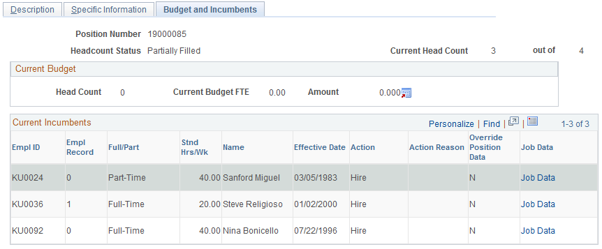

Position Data - Budget and Incumbents Page
POSITION_DATA6
Review the position's current budget and incumbents.

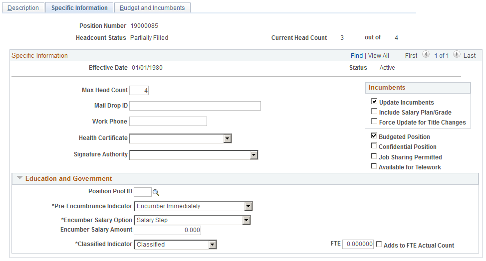

Use the Position Data - Specific Information page (POSITION_DATA5) to enter information that is specific to the position you're creating, such as the work phone number and the mail drop ID.
Image: Position Data - Specific Information page
This example illustrates the fields and controls on the Position Data - Specific Information page. You can find definitions for the fields and controls later on this page.
Field or Control
Definition
Max Head Count (maximum head count)
Enter the maximum head count allowed for this position. The default value is 1 because positions normally have a one-to-one relationship with employees (a position usually has one person assigned to it). However, if this position permits job sharing or can be assigned to more than one person, change the head count to the appropriate number.
Mail Drop ID and Work Phone
Enter the mail drop ID and work phone number assigned to this position, if applicable.
Health Certificate
Select the health certificate required for this position from the list of available options, if applicable.
Signature Authority
Select the signature authority assigned to this position from the list of available options, if applicable.
Update Incumbents
Select to have the system automatically update incumbent job data on the Job Data component. This option isn't applicable until you have assigned an employee to the position, so the default setting for new positions is for this check box to be deselected. A warning appears if the check box is selected when you save a new position.
Note: If you use Guided Self-Service to update position data, be sure that the Update Incumbents check box is selected. This configuration is necessary so that the position data updates made through Guided Self-Service flow through to incumbent job records. It is safe to ignore the warning that appears if the Update Incumbents check box is selected when you save a new position. For more information, see Understanding Updates to Position Data in the Guided Self-Service documentation.
If the employee record is using Position Data and the Update Incumbents check box is selected, then you can also check Include Salary Plan/Grade, which makes the Salary Plan, Grade, and Step fields controlled by the position and cannot be modified in Job Data.
If the Update Incumbents check box is not selected, then the Include Salary Plan/Grade check box is unavailable.
Note: (USF) Federal users don't currently use this field.
Select to include the salary plan and grade in the incumbents update. When you select the Include Salary Plan/Grade check box, then salary plan and grade are included in the incumbent update. When you deselect Include Salary Plan/Grade, then the salary plan and grade are not included in the incumbent update.
Note: If the position data military Rank field is populated, then the Include Salary Plan/Grade field is unavailable for data entry.
Force Update for Title Change
Select to make position title changes trigger the update incumbent process. If this check box is selected when you create a new position data row with a reason of TTL (Title Change) and a change to the data in the Titlefield, then the system creates a corresponding row in the incumbents’ Job Data records. The new job data row has the action code Position Change and the Action Reason Title Change.
Note that the job title is not actually stored on the job record. The job title that appears next to the Position Number field on the Work Location page is pulled from the position data record based on the effective date of the job data row. So if the Force Update for Title Change check box is not selected and no new job data row is created, the title shown on the job data row is based on the previous effective date, which is why the old title continues to appear.
Budgeted Position
This check box is selected by default. If this position's status is proposed or frozen, deselect this check box. Otherwise, leave it selected for reporting purposes, so that the system knows that this is an approved position.
Confidential Position
Select if this position is confidential.
Job Sharing Permitted
Select if job sharing is permitted for this position. If job sharing is permitted, indicate the position's maximum head count (the maximum number of people who can share the position) in the Max Head Count field.
Available for Telework
Select if this position allows workers to work remotely.

Position Pool ID
If appropriate, select a position pool ID from the list of available options. This code maps to the position pool with which this position should be budgeted in Commitment Accounting.
Position pools enable you to group related positions together for budgeting purposes. For instance, you could group all positions related to your PeopleSoft HCM implementation project in a single position pool and then assign a budget to that pool.
Pre-Encumbrance Indicator
Indicate if you want the position to encumber immediately. Values include: Encumber Immediate, Encumber on Requisition, or No Encumbrance.
Calc Group (Flex Service) (calculation group [flexible service])
If you are using Track Flexible Service, select a calculation group for this position.
Encumber Salary Option
If you encumber salaries using Manage Commitment Accounting, select an encumber salary option. The system uses the option that you select here to determine salary when it encumbers the salaries of vacant positions.
Academic Rank
If this is a faculty position, select an academic rank.
Classified Indicator
Associate the position with an FTE (Classification (full time equivalents classification) that you established on the Department Budget FTE page.
When you hire a worker into a position in the Workforce Administration menu, the system displays the FTE data tied to the position in the Job Data pages for the worker.
FTE (full time equivalents)
Enter the FTE value for this position to be used for defining an FTE budget in Manage Commitment Accounting.
Adds to FTE Actual Count
Select to include this position when processing FTE edits for budgeting purposes. Don't select this check box if you don't want to include this position when processing FTE edits.
Important! The FTE fields are provided by default to the employee’s Job record when Education and Government has been enabled in the system. Review the (E&G) Changing FTE Data documentation for considerations you should take when updating any fields that impact the FTE value of the position or a person’s job.
Use the Position Data - Budget and Incumbents page (POSITION_DATA6) to review the position's current budget and incumbents.
Image: Position Data - Budget and Incumbents page
This example illustrates the fields and controls on the Position Data - Budget and Incumbents page. You can find definitions for the fields and controls later on this page.
Field or Control
Definition
Current Budget
The Current Budget group box displays the position's Head Count, Current Budgeted FTE,and Amount.
Current Incumbents
After you assign an employee to the position, this group box displays the Core incumbent's Empl ID (employee ID), Empl Record, Name, and a Job Data link.
Select the Job Data link to access the Job Data component, EmplID is populated automatically. The system transfers you back to the Position Data component when you complete your review or after you have made changes.
