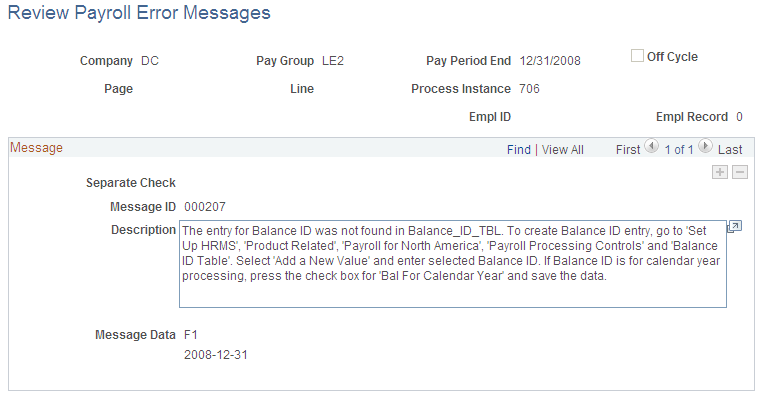

Use the Review Payroll Error Messages page (PAY_MESSAGES) to view payroll error messages that arise when creating paysheets.
Image: Review Payroll Error Messages page
This example illustrates the fields and controls on the Review Payroll Error Messages page.
Field or Control
Definition
Page
If the error is for a specific employee, this field displays the paysheet page number.
Line
If the error is for a specific employee, this field displays the paysheet payline number.
Message
Field or Control
Definition
Separate Check # (separate check number)
This field appears if the error is for an employee and the error occurred on a separate check.
Message ID
The Management Information Systems department uses this to find and correct errors.
Message Data
If the error is associated with an object, such as an earnings code, this field displays the object ID.
Note: The Payroll Error Messages report (PAY011) also lists errors related to employee data.
