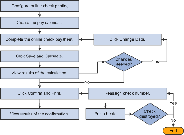

With Payroll for North America, you can calculate, view, and print a single employee check interactively, online.
To process online checks:
  1. Configure the system for online check printing.
  2. Assign a pay run ID to the appropriate pay calendar.
    This is required to access the Create Online Check page.
  3. Enter data on the Create Online Check page.
    1. Enter the hours or an amount.
    2. If necessary, override Job data, taxes, deductions, or garnishments.
    3. Select Save and Calculate.
      The Review/Print Online Check page appears when the process is complete.
  4. View results of the calculation on the Review/Print Online Check page and proceed in one of three ways:
    • Confirm and print the check.
      Select whether to use the BI Publisher or SQR print process.
      Note: If you use the BI Publisher process with the View Paycheck transaction in PeopleSoft ePay, the number of days from check date that you specify on the Paycheck Options Table page determines when the employee can view the check online.
      If the check is destroyed during printing, you can reassign the check number and reprint.
    • Select the Change Data button to return to the Create Online Check page to make changes.
    • Delete the check.
Note: (USF) With few exceptions, federal agencies must issue all certified payment vouchers through the Department of the Treasury.
See Setting Up ECS Controls.
This diagram illustrates the step involved in online check processing from configuring online check printing to the printing of checks:
Image: Diagram showing the step involved in online check processing from configuring online check printing to the printing of checks
This diagram illustrates the step involved in online check processing from configuring online check printing to the printing of checks.

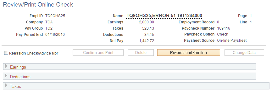

(USA, USF) Use the Review/Print Online Check page (PAY_OL_CHECK_S) to confirm and print a check, delete the check, or return to the Create Online Check page to change data.
Image: Review/Print Online Check page after calculation
This example illustrates the fields and controls on the Review/Print Online Check page after calculation.
When you select Save and Calculate on the Create Online Check page, the system performs the calculation and displays the Review/Print Online Check page.
You must assign a pay run ID to the appropriate pay calendar. Otherwise, the system cannot find any employee data for online single check processing. The fields on this page are display-only and are based on the data that was entered on the Create Online Check page.
Important! Any uncalculated or unconfirmed online single checks are automatically calculated or confirmed by an off-cycle pay run if the online check page numbers fall within the range entered for the off-cycle pay run.

Image: Review/Print Online Check page after confirmation
This example illustrates the fields and controls on the Review/Print Online Check page after confirmation.
Field or Control
Definition
Reassign Check/Advice No (reassign check or advice number)
If the online check was destroyed while printing, select this check box to reprint the check with a different check number. When you select this check box, the Confirm and Print button becomes available.
Confirm and Print
This button is available if you select Reassign Check/Advice No. Select this button to access the Paycheck Printing/Re-assignment page, where you enter the new check number and select OK to print the check with the new number.
Reverse and Confirm
Select to access the Check Reversal page and run the Check Reversal process. You cannot reverse a single check until it has been confirmed and printed. Until then, this button is unavailable.
To reverse a confirmed online check:
  1. Select Reverse and Confirm on the Review/Print Online Check page.
  2. Enter a pay group and a pay end date.
    The reversal is posted to the company, pay group, and pay end date specified here.
  3. Select OK to run the Check Reversal process.
    The system displays the Print Pay Checks page.
  4. Review results of the reversal on the Review/Print Online Check page.
