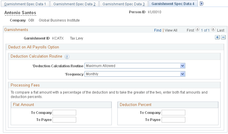

Garnishment Spec Data 4 Page (garnishment specification data 4)
GARNISH_SPEC4
When deducting from all payrolls, define deduction defaults and processing fee defaults.
Before using this page, select Deduct on All Payrolls in the Deduction Schedule field on the Garnishment Spec Data 3 page.

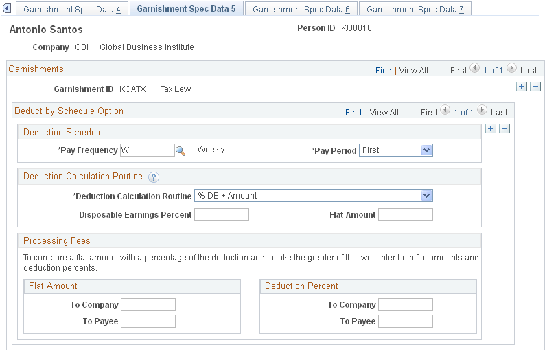

Garnishment Spec Data 5 Page (garnishment specification data 5)
GARNISH_SPEC5
Define the payment schedule for the garnishment and define deduction defaults and processing fee defaults.
Before using this page, select Deduct by Schedule in the Deduction Schedule field on the Garnishment Spec Data 3 page.

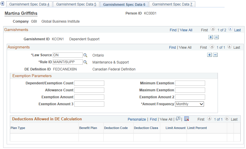

Garnishment Spec Data 6 Page (garnishment specification data 6)
GARNISH_SPEC6_CN
(CAN) Specify the garnishment rule and enter employee-level exemption and deduction overrides.
GARNISH_SPEC6
(USA) Specify the garnishment rule and enter employee-level exemption and deduction overrides.

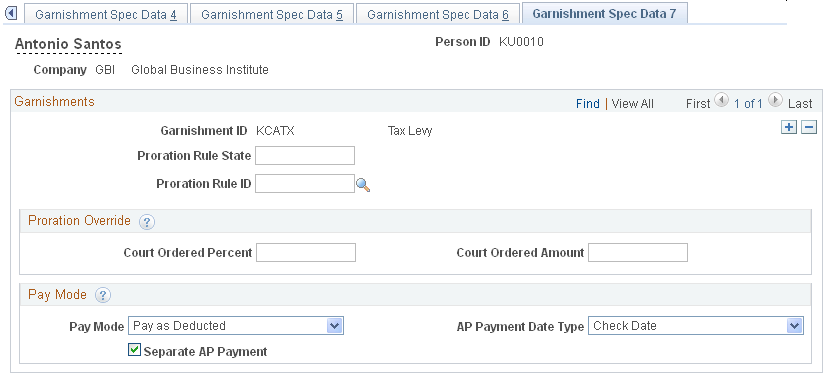

(USA) Enter proration overrides if the proration rule is either CRTORD or CRTDET, and to specify the pay mode for integration with PeopleSoft Payables.
Garnishment Spec Data 7 Page (garnishment specification data 7)
GARNISH_SPEC7_CN
(CAN) Specify the pay mode for integration with PeopleSoft Payables.

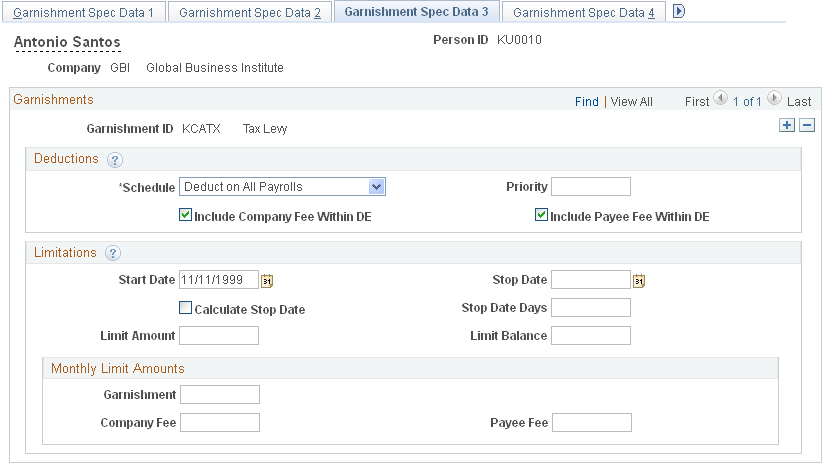

Garnishment Limit Processing
The Pay Calculation process selects only active garnishments for processing. To determine whether a garnishment is active, the system verifies that the garnishment meets all off following conditions:
  • The status of the garnishment on Garnishment Spec Data 1 page is set to Approved or Received.
  • The Start Date field on the Garnishment Spec Data 3 page is blank or the date entered is less than or equal to the check date of the paycheck being processed.
    Note: If the paycheck being processed is an adjustment check, the system uses an adjustment date (the highest earnings end date) instead of check date when it verifies the start date.
  • The Stop Date field on Garnishment Spec Data 3 page is blank or the date entered is greater than or equal to the check date of the paycheck being processed.
    Note: If the paycheck being processed is an adjustment check, the system uses an adjustment date (the highest earnings end date) instead of check date when it verifies the stop date.
  • The Limit Amount field on the Garnishment Spec Data 3 page is blank (zero) or the value is greater than the value in the Limit Balance field on the Garnishment Spec Data 3 page.
If a garnishment meets all of these selection criteria, the system proceeds in calculating an amount for the garnishment.
Pay calculation ensures that the garnishment amount calculated plus the YTD garnishment balance maintained by the Pay Confirmation process does not exceed the limit amount specified on Garnishment Spec Data 3 page.
Note: The system does not use the limit balance displayed on the Garnishment Spec Data 3 page for limit processing. For garnishment limit processing, the Pay Calculation process refers to the YTD (year-to-date) balance across all CY (calendar year) balance years for that employee ID and garnishment ID combination. You can view the YTD Garnishment Balance on the Garnishment Balances page.
See Reviewing and Adjusting Garnishment Balances.
Monthly Limit Specification
Some courts impose monthly limitations on the garnishment and the company and payee fees. When processing monthly limitations, the system uses the actual paycheck date—not the pay period end date, which might be in a different month. For example, a pay period might end on January 31, but the paycheck date might be February 1.
Payroll for North America normally calculates deductions, including garnishments, as follows:
  1. Annualizes a monthly amount (multiplying it by 12).
  2. Divides by the appropriate number of pay periods (for example, 52 in the case of weekly pay periods).
In months of the year containing 5 weekly pay periods instead of 4, this can result in deductions of more than the original intended monthly amount. In months containing 4 pay periods, the system deducts less than the intended monthly amount.
For example, a company employee, Steven, has been ordered to pay spousal support of 1,000 USD per month. Ordinarily, the system:
  1. Annualizes this amount to 12,000 USD per year.
  2. Divides by 52 to arrive at a weekly garnishment of 230.77 USD.
If January has 5 weekly pay periods, the system takes 1153.85 USD of Steven's pay. If February has 4 pay periods, the system takes 923.08 USD.
To avoid exceeding the monthly limit in situations like the above, use one of these methods:
  • Define a flat amount for the deduction calculation on the Garnishment Spec Data 5 page.
    You must also select Deduct by Schedule in the Deduction Schedule field on the Garnishment Spec Data 3 page.
  • Enter the monthly limit amount in the Garnishment field in the Monthly Limit Amounts group box on the Garnishment Spec Data 3 page.
    This establishes a monthly garnishment limitation. The system stops taking the deduction after the limit amount is reached in the month.
Field or Control
Definition
% DE + Amount (percent of disposable earnings plus amount)
Select this option to calculate:
Deduction = percent of disposable earnings + flat amount
Use for garnishments such as child support.
% Gross + Amount (percent of gross plus amount)
Deduction = percent of earnings subject to garnishment + flat amount
Greater of % DE or Amount (greater of percent of disposable earnings or amount)
Deduction = greater of a percent of disposable earnings OR the flat amount
Greater of % Grs or Amount (greater of percent of gross or amount)
Deduction = greater of a percent of earnings subject to garnishment OR the flat amount
DE% (disposable earnings percent)
If the deduction is a flat amount only, leave this field blank to indicate that the percent is zero.

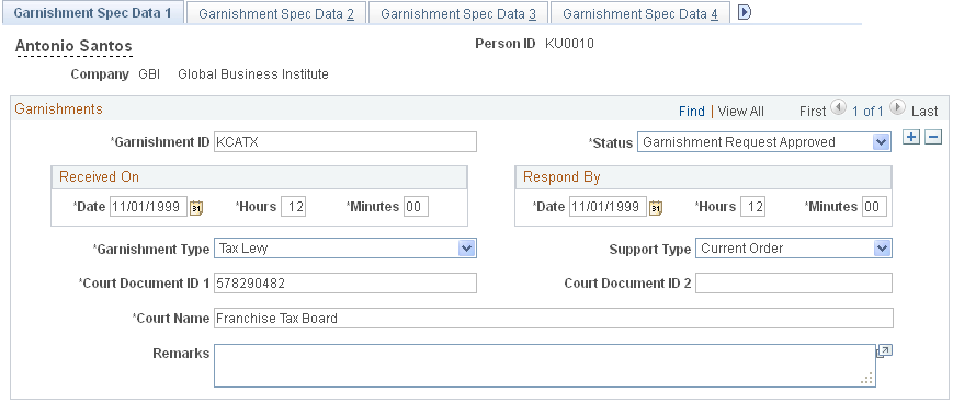

(USA) Use the Garnishment Spec Data 1 (garnishment specification data 1) page (GARNISH_SPEC1) to enter garnishment order information.
Image: Garnishment Spec Data 1 page
This example illustrates the fields and controls on the Garnishment Spec Data 1 page.
Field or Control
Definition
Garnishment ID
In general, define only one garnishment specification for each garnishment order that you receive for an employee. Each garnishment specification must have a unique garnish ID.
See Splitting Garnishment Orders.
Note: Never reuse the same garnishment ID for an employee because the system calculates garnishment balances across all CY balance years for the combination of employee ID and garnishment ID.
Status
Update this field as the status changes throughout the life of the garnishment. This is important because it affects the payroll processing of the garnishment deduction.
If you select Garnishment Request Received or Garnishment Request Approved, the system processes the garnishment when you run the Pay Calculation COBOL SQL process (PSPPYRUN). If you select Garnishment Deduct Completed, Garnishment Deduct Suspended, Garnishment Request Cancelled, Garnishment Request Rejected, or Garnishment Request Released, the system ignores the garnishment during the Pay Calculation process.
Garnishment Deduct Completed: Select this value when the garnishment is paid in full. The system automatically selects this status during pay confirmation processing when the garnishment reaches its limit or stop date.
Note: If you run the Pay Unconfirm COBOL SQL process (PSPUNCNF) after confirming a payroll in which the system set the garnishment status to Garnishment Deduct Completed, the unconfirm does not reset the garnishment status. You must keep this in mind and reset the status if you unconfirm the payroll.
Garnishment Deduct Suspended: Select this value to stop the garnishment deduction in payroll while preserving the garnishment specification data.
Garnishment Request Approved: Select this value when you inform the court, authorized agency, or government agency that you will comply with the garnishment or levy.
Garnishment Request Cancelled: Select this status if the garnishment order is cancelled by the issuing agency, such as the U.S. Department of Education for Student Financial Assistance.
Garnishment Request Received: Select this value when you establish a new Garnishment record, or to define an off-cycle entry for the employee to test the garnishment deduction before you put it into production.
Garnishment Request Rejected: Select this value if you cannot comply with the garnishment or levy. For example, if you have terminated the employee and there are no wages to garnish, you can reject the garnishment.
Garnishment Request Released: Select this status if the garnishment order is released by the issuing agency, such as the IRS (internal revenue service).
Garnishment Request Terminated: Select this status if the garnishment order is terminated by the issuing agency, such as the California Franchise Tax Board.
(CAN) Deduction Code
This field is visible for Canada only. Select a valid before-tax or after-tax garnishment deduction code.
If you select a before-tax deduction code:
  • The following warning appears: Before-tax garnishment requires separate general deduction(s) for Company and Payee Fees.
  • The fields that are associated with the processing of garnishment fees (on the Garnishment Spec Data 3, 4, and 5 pages) become unavailable for entry.
Because the system must process company and payee fees that are associated with garnishments as after-tax deductions, you must define them separately as general deductions. When defining these general deductions, deselect the Garnishment Process indicator in the Deduction table.
Received On
Enter the date and time that you received the writ of garnishment or tax levy from the court, authorized agency, or government agency.
Respond By
Enter the date and time by which you must tell the court, authorized agency, or government agency whether you can comply with the garnishment order. For example, if the employee is no longer employed, you cannot garnish wages.
Garnishment Type
Select the type of garnishment or levy:
Writ of Garnishment: Typical garnishment type for failure to pay.
Tax Levy: Failure to pay taxes.
Chapter 13 Bankruptcy: Bankruptcy in Canada, or topic 13 bankruptcy in the U.S.
Wage Assignment: Similar to a writ, signifying a failure to pay.
Social Security (AWG): Social Security Administrative Wage Assignments.
Child Support, Spousal Support, and Dependent Support: Typically ordered by a family court .(USA) If you select one of these types, also select a value in the Garnishment Support Type field.
Student Loan Repayment: The garnishment type for delinquent student loans.
(USA) Support Type
Applies only for child support, dependent support, and spousal support garnishment types. For these garnishment types, select Current or Arrears.
Court Name
Enter the name of the court, authorized agency, or government agency that has legal jurisdiction over the garnishment.
Court Document ID 1 and Court Document ID 2
Enter any codes with which you identify the garnishment documents from the court or reports that you send back to the court or government agency. For example, garnishment documents might carry a file or case number, but a tax levy usually uses a date and the employee's social security number or social insurance number.

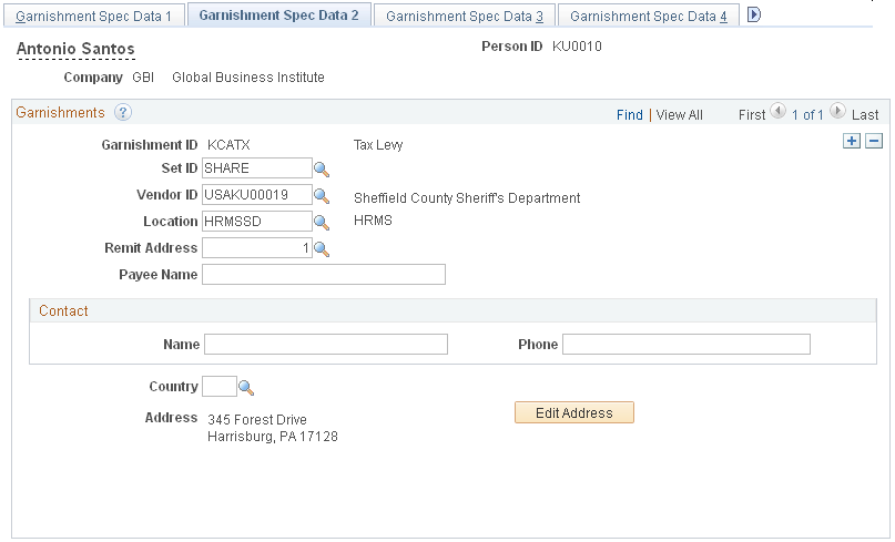

Use the Garnishment Spec Data 2 (garnishment specification data 2) page (GARNISH_SPEC2) to enter garnishment payee and address information.
Image: Garnishment Spec Data 2 page
This example illustrates the fields and controls on the Garnishment Spec Data 2 page.
Note: (USF) These instructions do not apply to U.S. federal government employers.
See Garnishment Spec2 Page.
Note: To process payments through the Payables interface, you must enter a setID, vendor ID, vendor location, and remit address. You should maintain vendor addresses on the Vendor table in the Payables database.
Field or Control
Definition
Vendor ID
(USA) This field must be blank if you're processing the garnishment as an EFT payment. Otherwise, select the vendor ID of the garnishment payee.
Location
If you selected a vendor ID, select the specific location for this garnishment from among the locations set up for the payee on the Vendor table.
Remit Address (remittance address)
If you selected a location, select the address sequence number that represents the garnishment remittance address in the Vendor table.
Note: When you enter the setID, vendor ID, location, and remit address number, the page displays the complete address.
Field or Control
Definition
Edit Address
If you're using the EFT process, you can enter the country in the Country field and select Edit Address to enter address data for information purposes only.
If you're using the Payables interface, you should make all address updates in the Vendor table.
See Maintaining Vendor Information.
Use the Garnishment Spec Data 3 (garnishment specification data 3) page (GARNISH_SPEC3) to select a deduction schedule and enter limit information.
Image: Garnishment Spec Data 3 page
This example illustrates the fields and controls on the Garnishment Spec Data 3 page.
Deductions
Field or Control
Definition
Schedule
Specify how to deduct garnishments:
Deduct on All Payrolls: If you select this value, use the Garnishment Spec Data 4 page to complete the deduction information.
Deduct by Schedule: If you select this value, use the Garnishment Spec Data 5 page to create the deduction schedule and complete the deduction information.
Priority
Select the processing priority of the garnishment in relation to other garnishments for the employee. This is not the same as the deduction priority in the General Deduction table. The system uses this value to process garnishments to which proration rules do not apply.
If you leave this field blank, or assign the same priority number to more than one garnishment specification, the system determines the processing priority by garnish ID. The lower the number, the higher the priority. For example, 100 is a higher priority than 200.
Include Company Fee Within DE (include company fee within disposable earnings) and Include Payee Fee Within DE (include payee fee within disposable earnings)
Select the check boxes to deduct fees from the employee's disposable earnings before taking garnishment deductions.
Note: Payroll for North America provides a garnishment proration option for states that permit proration of garnishments when an employee has more than one of the same type. If you use this option, the system uses the value in the Priority field only for garnishments to which proration does not apply.
Limitations
The fields in this group box impose time and amount restrictions on the garnishment deduction. This functionality is useful when you handle multiple garnishment orders from states where regulations prohibit the collection of more than one garnishment order at a time, or where they impose time limits on the collection of a garnishment.
Field or Control
Definition
Start Date
To start the garnishment deduction immediately, leave this field blank.
Stop Date
Leave the Stop Date field blank if you want the garnishment deduction to go on until the garnishment is satisfied. Otherwise, enter the date the deduction should stop. This date must be greater than the check date for a pay period to withhold the garnishment for that pay period. For example, if the pay period has an end date of March 10, 2000 and a check date of March 12, 2000, then the garnishment stop date must be greater than March 12, 2000 to withhold the garnishment in the March 10, 2000 pay period.
Calculate Stop Date or Stop Date Days
Select this check box to have the system calculate a stop date when you don't know the exact stop date. For example, Tennessee currently has a rule for garnishments of the Writ type, specifying a term of 90 days. In other words, you can only garnish money for 90 days. The 90-day term does not begin until you actually begin taking money from the employee (that is, until the employee has money available to garnish). For example, you might receive a garnishment order on September 1. If the employee has another garnishment of a higher priority, there might be no money available to garnish until November.
In this situation, you cannot enter a stop date because you don't know what the exact start date is. Instead, select the Calculate Stop Date check box and enter the length of the garnishment term (90 for Tennessee) in the Stop Date Days field. As soon as the system can take money for this garnishment, it:
  1. Calculates the stop date by adding 90 days to the processing date of the current pay period.
  2. Enters that date in the Stop Date field.
  3. Deselects the Calculate Stop Date check box.
From this point on, the system takes the garnishment until the end of the term, or until other limits are satisfied.
Limit Amount
Enter a limit amount to establish a maximum total amount for the garnishment deduction. Each time you run the Pay Confirmation COBOL SQL process (PSPCNFRM), the system updates the limit balance, displaying how much of the garnishment has been paid to date. When the limit balance equals the limit amount, the system automatically stops taking the deduction. To not set a limit, leave the limit amount blank.
Limit Balance
This field does not automatically reflect adjustments that you make to garnishment balances. If you make an online balance adjustment to garnishments, make the same update in this field.
Calculations for limit processing use the value displayed in the YTD Garnishment Balance (year-to-date garnishment balance) field on the Garnishment Balances page. Update the Limit Balance field with that value after making any adjustments to garnishment balances.
See Understanding Garnishment Limit Processing.
Use the fields in this group box to enter monthly limits imposed by the court on the garnishment amount, company fee, or payee fee.
Note: Your company or the payee might charge voucher fees, which are handling fees related to garnishments. Enter the fees owed to your company or to the payee in the Processing Fees Defaults group box on the Garnishment Spec Data 4 page or Garnishment Spec Data 5 page, depending on which deduction option you use.
Use the Garnishment Spec Data 4 (garnishment specification data 4) page (GARNISH_SPEC4) when deducting from all payrolls, to define deduction defaults and processing fee defaults.
Note: Before using this page, select the Deduct on All Payrolls in the Deduction Schedule field on the Garnishment Spec Data 3 page.
Image: Garnishment Spec Data 4 page
This example illustrates the fields and controls on the Garnishment Spec Data 4 page.
Deduction Calculation Routine
Field or Control
Definition
Select Maximum to calculate:
Deduction = disposable earnings − exemptions
The system takes all it can get. Use for garnishments such as tax levy and bankruptcy.
Note: If you select this option, the DE Percent and Flat Amount options become unavailable for entry and the system deletes any data existing there.
Frequency
If you specify a flat amount, enter a deduction frequency. The system uses this frequency to adjust the flat amount to the employee's pay frequency to calculate the deduction amount per pay period.
See Common Elements Used in Specifying Employee Garnishment Data.
Processing Fees
Based on the details of the court order, enter processing fees consisting of a percentage of the deduction or a flat amount to be paid to the company or to the payee. On the Garnishment Spec Data 2 page, you specified whether to include the company and payee fees in the employee's disposable earnings.
Some garnishment orders might require that you compare a flat amount with a percentage of the deduction and take the greater of the two. In that case, enter both, and the system automatically takes the greater amount.
Note: If there are company fees, be sure that a General Ledger account for the fees has been established on the General Ledger Liability Accts page in the Company component.
Use the Garnishment Spec Data 5 (garnishment specification data 5) page (GARNISH_SPEC5) to define the payment schedule for the garnishment and define deduction defaults and processing fee defaults.
Note: Before using this page, select Deduct by Schedule in the Deduction Schedule field on the Garnishment Spec Data 3 page.
Image: Garnishment Spec Data 5 page
This example illustrates the fields and controls on the Garnishment Spec Data 5 page.
Field or Control
Definition
Select Maximum Allowed to calculate:
Note: If you select this option, the Disposable Earnings Percent and Flat Amount options become unavailable for entry and the system deletes any data existing there.
Specifying Different Garnishment Amounts in Different Pay Periods
Suppose you receive a garnishment order for an employee who you pay weekly. The order specifies that you garnish 150 USD in the first pay period of the month, 200 USD in the second, 250 USD in the third, 200 USD in the fourth, and nothing in the fifth (for those months that have five pay periods). To set this up:
  1. Enter a pay frequency of Weekly and a pay period of First to define what to deduct in the first weekly pay period.
  2. In the Deduction Calculation Routine group box, select the %DE + Amount option and enter a flat amount of 150.00 USD. Leave the DE Percent field blank.
  3. Insert a row for the second pay period.
  4. Select a pay period of Second and enter a flat amount of 200.00 USD.
  5. Repeat these steps for the remaining pay periods.
(CAN) Use the Garnishment Spec Data 6 (garnishment specification data 6) page (GARNISH_SPEC6_CN) to specify the garnishment rule and enter employee-level exemption and deduction overrides.
Image: Garnishment Spec Data 6 page (CAN)
This example illustrates the fields and controls on the Garnishment Spec Data 6 page for Canada.
Assignments
Select the jurisdictional entity (law source) and unique rule ID for the garnishment rule that you're applying. This information is maintained in the Garnishment Rules table.
You typically enter only the Law Source (province code or ZZ for federally supported rules).
You can use any rule if it applies to a garnishment situation, regardless of the original province designation (Garnish Law Source).
Exemption Parameters
If you must override the values for the exemption amount, minimum and maximum, or frequency that are already established in the calculation formula for the garnishment rule, enter the override values here for the corresponding variables.
If you enter an exemption override, you might also have to change the value in the Amount Frequency field; the system uses this amount frequency to calculate the disposable earnings. The default is Monthly.
Note: To ensure that you enter values in the correct fields, we recommend that you review the calculation formula for the rule. The system ignores values that you enter here for exemption variables that are not already included in the garnishment rule's calculation formula.
See Exemption Variables Page.
Field or Control
Definition
Dependent/Exemption Count
Enter the number of dependents or exemptions claimed by the employee.
Allowance Count
Enter the number of allowances claimed by the employee.
Exemption Amount
Enter the exemption amount for the debtor.
Exemption Amount 2
Enter the exemption amount for the debtor’s first dependent.
Exemptions Amount 3
Enter the exemption amount for each of the debtor’s additional dependents.
Deductions Allowed in DE Calculation
The fields in this topic are not available for entry for users in Canada.

Use the Garnishment Spec Data 7 (garnishment specification data 7) page (GARNISH_SPEC7) to enter proration overrides if the proration rule is either CRTORD or CRTDET, and to specify the pay mode for integration with PeopleSoft Payables.
Image: Garnishment Spec Data 7 page
This example illustrates the fields and controls on the Garnishment Spec Data 7 page.
(USA) Proration Override
If the proration rule of the garnish law state is either CRTORD or CRTDET and the court specified a proration amount or percent:
  1. Enter the state code and select the valid proration rule ID that applies to the garnishment.
  2. Enter the percent or amount of override in the respective field.
Pay Mode
Use this group box to interface with PeopleSoft Payables.
Field or Control
Definition
Pay Mode
Specify how Payables makes the garnishment payment:
Pay as Deducted: Select this value to pay the vendor each time Payroll for North America calculates this deduction.
Pay at Specified Date: Select this value to pay the vendor on a date that you specify in the AP Payment Date Type field.
Pay when Bond Price met: This value does not apply to garnishment processing.
Pay when Collection Completed: Select this value to pay the vendor only when you reach the goal amount or deduction end date. (This pay mode is valid for general deductions and garnishments).
AP Payment Date Type (accounts payable payment date type)
Specify which type of date to use when creating the accounts payable voucher. This field becomes available when you select Pay at Specified Date in the Pay Mode field.
Separate AP Payment (separate accounts payable payment)
Select this check box if the payment for this garnishment should be on a separate check when Payables makes the payment.
Note: The system selects this option automatically if it is not already selected and the employee has multiple garnishments for the same vendor with different vendor location and/or remit address. This ensures that an employee's garnishments for the same vendor with different locations and/or remit addresses are paid on separate invoices/vouchers and sent to the correct addresses.
You can split complex orders such as:
