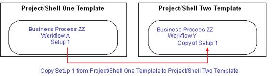

In this copy action, you copy a setup from a business process in one project/shell template to the same business process in another project/shell template.
To copy a setup from one project/shell template to another

  6. Click the Copy From button and choose Templates. A copy window opens, listing all the workflow templates for that BP that exist in all the projects and shells in your environment.
  7. Select the template you want to copy and click Copy. The Workflow Setup window opens.

    Unifier adds the template to the workflow setup log. If you made the setup Active, Unifier will perform an error check on the new setup and notify you of any errors it encounters; otherwise, the error check will not occur until the setup is activated.
