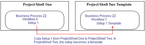

Copy a Setup from a Project/Shell to a Template
In this copy action, you copy a workflow setup from a business process in a project or shell and make it a template in the BP you copy the setup into.
To copy a setup from a project/shell to a template
