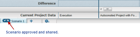

Once the portfolio planner approves a portfolio scenario sheet, Unifier:
- Marks the approved scenario "shared" so that project managers can see the approved dates and numbers. The scenario is set to read-only mode and can no longer be modified or deleted.
- Note: At this stage, the scenario tab shows both the shared and approved icons, next to the scenario name.

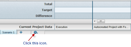

To approve a portfolio scenario use the manage scenario (star) icon.
- At the bottom of the scenario sheet window, select the tab containing the scenario you want to approve.
- Click the Manage Scenarios icon and choose Approve Selected Tab.
- Click Save All.
When you approve a scenario, Unifier automatically shares the scenario and visually marks the scenario tab with an Approved and Shared icon to indicate to project managers that this is the approved scenario.
