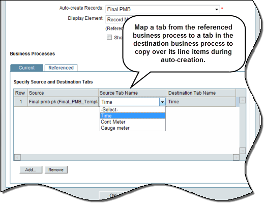

Mapping Line Items from References during BP Creator Auto-Creation
During auto-creation using a BP Creator, you can copy line items from a source (referenced) business process onto an auto-created (destination) business process, when:
For example:
An Asset business process references a Motor Template in a line item (via a BP Picker, BP Data Picker, or a BP Creator.) The line item auto-creates another business process, Motor based on the Motor Template (via a BP Creator.) In doing so, all line items from the Motor Template's detail tabs are copied onto Motor's detail tabs.
In addition to being able to copy line items from detail tabs of a parent business process record to the detail tabs of an auto-created business process record, you can copy line items from tabs of another business process record that is referenced by the parent business process record to the selected tabs of the auto-created business process record.
uDesigner Auto-creation Configuration
Upper and Detail configuration windows display a tabbed Business Processes section with two tabs:
In the Source list of Detail Configuration, select current business process name, or any BP picker or data picker on the upper or detail form of the business process. (Note Upper Configuration will display only those from the upper form.) In the Source Tab Name list, select a tab from the referenced business process. Destination Tab Name provides a list of all tabs in the business process being created (see Auto-create Records field). These are the same as the values in Destination Tab Name in Current tab. Select any tab in which the line items from the referenced business process will be created.
To configure line item mapping in upper or detail form
  1. Click the Company Workspace tab and switch to Administration Mode.
  2. Navigate to uDesigner > Business Processes node Navigator.
  3. Open your line item type business process in which you want to set up line item mapping from a referenced business process to an auto-created business process.
  4. In the Auto-creation Processes, Upper or Detail log, click New to configure auto-creation on the selected BP Creator field placed on the upper or detail form.
  5. Complete line item mapping in the Referenced tab, associating tabs in the source business process to tabs in the destination business process.

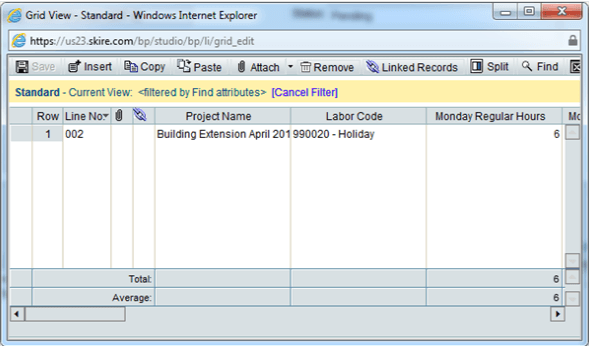

Adding a Grid Summary to a Detail Form
You can add line item grid summary to a line item business process and use it to track and display, for example, the number of hours performed on a project on a daily basis. You can configure the summary to display Total and average amounts. Summary is allowed only for numeric data elements
To configure a grid summary on a detail form
  2. In the left Navigator, click uDesigner.
  3. Click the Business Processes node. The Business Processes log opens.
  4. Open the cost or line-item type business process for which want to configure a Summary for Total Amount and/or Average Amount.
    You can use the Find feature to locate the business process in the Business Process log.
  5. In the Navigator, click Detail Form. The Detail Form log opens.
    Select the detail form to which you want to add the grid summary and either double-click or click click the Open button.

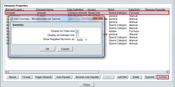

  6. Open the Detail form by either selecting it and clicking the Open button, or by double-clicking the form. The Detail form opens.
    In the Detail form tool bar, click the Properties button. The Elements Properties window opens.
  7. Select an element for which you want to add a summary
  8. Click the Summary button.The Summary dialog box opens.
  9. Select the options you want to use; you can use both average and total summary selections, or just one selection, for the grid summary.
    • Display on Total Line — Use this selection to create a summary row at the bottom of the line item grid at run time.
    • Display on Average Line — Use this selection to create an average row at the bottom of the line item grid at run time.
    • Show Negative Numbers as — Use this selection to define the negative number format.
    • Click the OK button to save your selections.
    • You will see your selections for the numeric data element in the Summary column on the far right of the Elements Properties window.
    At run time, you will see real time updates in the Grid View.
