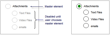

    For example, you could use a radio button for "Attachments" to enable additional options for a user to choose. If the user clicks the Attachments button, additional radio buttons become active so the user can choose what type of attachments to include.

    The elements you select here are the elements whose behavior will be controlled by the master element. These are the elements that will be either required or disabled by the master element, and they must be marked "editable" on the form.
    For example, if the master data element is Attachments, as in the example in step 4, the elements whose behavior is controlled would be Text Files, Video Files, and emails.
