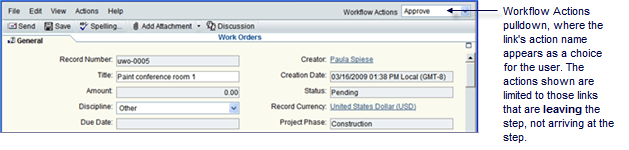

A record status indicates the position a form is in at any point in a business process, such as "approved," "pending," or "closed." Each business process includes at least one, and sometimes many, steps during its workflow. At each step, the Primavera Unifier user must apply a record status to the form. The status is the action that links two steps in a workflow. The action the link takes appears in Primavera Unifier as a choice the user makes on the form. This choice moves the task to the next step.
When designing a business process, you will be specifying what statuses the user can choose from at the completion of each step in a workflow.

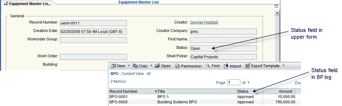

You can include statuses only in the upper portion of a form or in a log.
When you create a company, uDesigner automatically creates a list of default statuses. As administrator, you can add statuses to this list or modify, activate, and deactivate them.
