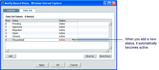

  3. Double-click the status list in the log. The Status Definition window opens.
  4. Click the Data Set tab, and at the bottom of the window, click the Add button.
    uDesigner adds a row with a text box in the Value field.
  5. In the Value field, enter a name for the new status.
    Use only alphanumeric and underscore (_) characters for the name; 20 characters maximum.
  6. To add another record status, click the Add button.
  7. When you are finished, click OK.
