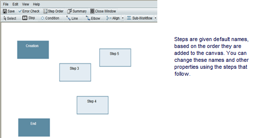

To add steps to a workflow:
  1. Click the S Step button.
  2. To add a workflow step, click anywhere in the canvas area of the window.
  3. Continue to add as many steps as necessary by clicking the canvas again.
  4. When you have added all the steps, click the S Step button again.
  5. Adjust the layout of the workflow as follows:
  1. Click the Select tool.
  2. Click a step and, while holding down the mouse button, drag the step to its new position.
  3. Continue to move the steps into place until you are satisfied with the layout.
    Note: You may need to return to this step during the workflow design process.
