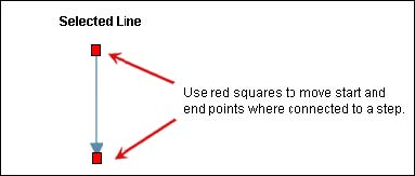

To modify a line:
  1. Click the Select tool, then click the line you want to modify.
  2. Click and hold the red squares to move the start and end points of the line.

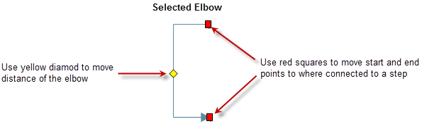

To modify an elbow:
  1. Click the Select tool, then click the elbow you want to modify.
  2. Click and hold the yellow diamond to expand the distance of the elbow, or click on the red squared to move the start and end points connected to the step.

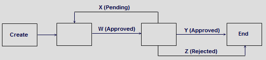

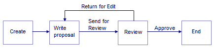

Specifying Each Link’s Action
Each link between steps denotes the progression of the business process through the workflow.
The action the link takes (Approve, Return for Edit, etc.) appears in Primavera Unifier as a choice the user makes on the business process form. This choice moves the task to the next step.

How Terminal Statuses Affect Workflows
Every record, line item, and asset must have a status indication at every step in Primavera Unifier. The status is what moves the record forward in the workflow. A terminal status indicates the end of the workflow or the end of a step within the workflow.
Here are the rules that govern terminal statuses:
