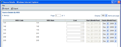

Custom Curves: Source Details
Data displayed on the window is based on several options chosen during setup of the sheet:
Fields on this sheet may be editable depending on the options you chose in the Properties window.
Note: When you click Details, on the Properties window, the system saves the curve even if you click Cancel to exit the Properties window.

To enter data in the Source Details window:
  1. Open the custom curve Source Details window:
    For the earned value sheet, open the EV Properties window, Settings tab. Select a custom curve and click Modify, or create a new custom curve. In the custom curve Properties window, click the Details button.
  2. Depending on the options defined in the custom curve Properties window, the Cost, Start and/or Finish Date fields may be editable across the CBS codes. Add this information as needed.
    • Start is the starting date of the curve.
    • End is the end date of the curve.
    • If you enter a value in the Cost column, the value automatically appears in the last column of the incremental view of the worksheet for the custom curve. You can then open the worksheet and distribute this cost amount across the other columns (and the other time periods) in the worksheet. (See View and work with worksheets.)
To import cost data into the Source Details window:
    For the earned value sheet, open the Properties window, Settings tab. Select a custom curve and click Modify, or create a new custom curve. In the custom curve Properties window, click the Details button.
  2. Click the Export button and download the CSV file. Save the file to your local drive or open the file directly.
  3. Enter the cost or date information in editable Start, End and/or Cost fields as applicable, depending on the entry settings you specified in the custom curve Properties window.
  4. Save the CSV file.
  5. In the Source Details window, click Import, and import the CSV file.
