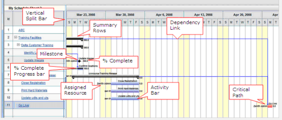

The Gantt Chart is displayed in the right pane of the schedule sheet. The activities are shown as bars and align with activities in the left pane. The activity bar is drawn with the start date, finish date, and duration elements of the activity. The Gantt chart is shown in week/day zoom mode by default.
The Gantt chart displays:

Understanding the Gantt chart view

View the critical path
The critical path calculation can be used to flag activities on the schedule that, if delayed, can cause the schedule to go beyond the pre-planned project or shell end date. Therefore, it is important to have fixed project or shell start and end dates defined for the project or shell. Project or shell start and end dates should not automatically adjust as activities are added or rescheduled.
To view the critical path
  1. Open the schedule sheet.
  2. Click the View menu and choose Critical Path.
    The activities that are on the critical path will change to red on the Gantt chart. The critical path action will also update the system-defined data element uuu_float to zero if it has been included on the activity attributes form (Activity Properties window).
  3. To restore the Gantt chart view, click the View menu and choose Gantt Chart.
