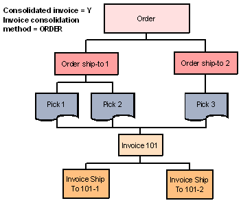

Consolidated Invoice (B49)
Indicates whether to consolidate invoices for shipments made for the same order on the same day.
Important: In Order Management System 21.0 or higher, you cannot select the Consolidated Invoice system control value if it is not already selected. If the system control value is currently selected (set to Y) and you deselect it (change it to N or blank), you cannot then change it back to selected. The option to consolidate invoices will be removed at a later date.

Invoice Consolidation Method (E29)
Defines whether invoices are consolidated for all ship to customers on the order or only within the same ship to customer.
Code:
Purpose: This system control value controls whether to consolidate invoices for the same order on the same date.
Yes/no field: If this field is currently selected, invoices are consolidated. Any pick slips for an order that ship (bill) on the same day are included on the same invoice.
Important:                            In Order Management System 21.0 or higher, you cannot select this field if it is not already selected. If the system control value is currently selected (set to Y) and you deselect it (change it to N or blank), you cannot then change it back to selected. The option to consolidate invoices will be removed at a later date.
Related system control values:
         The Invoice Consolidation Method (E29) system control value defines whether the system consolidates invoices across all ship-to addresses on the order, or only within the same ship-to address.
         If the Capture Addresses for Invoice (J24) system control value is selected, invoice consolidation can be affected when any of the shipments on an order or order ship-to have different billing or shipping addresses.
         If the Generate Invoice Number at Pick Gen (H80) system control value is selected, any invoice numbers assigned at pick slip generation are not consolidated.
         Invoice consolidation does not apply to express-billed orders or credit invoices.
         If this system control value is selected, in order to prevent the generation of multiple copies of the same shipment confirmation, you should leave the Send Shipment Confirmation from Billing (L98) system control value unselected and always wait until the day’s billing is complete to generate shipment and return confirmation emails. If you consolidate invoices:
         The system sends a shipment confirmation for the first shipment that goes through billing and sends a shipment confirmation for each subsequent shipment that goes through billing on that same day. In this situation, each subsequent shipment confirmation contains all of the information across shipments (since the shipments are consolidated into one invoice).
         You do not have the option of Stopping and Restarting Shipment and Return Confirmation Emails because the system does not keep track of the last confirmation email generated, so there is no way to prevent the process from generating multiple copies of the same email. See Sending Internet Order Ship Confirmation (ESCF) for an overview on generating shipment and return confirmation emails.
         If the Delay Billing Updates (K85) system control value is selected, the system consolidates invoices that are created for the same order and on the same day before the Delay Billing Update Process is executed.
When this system control value is unselected, all pick slips produce separate invoices, regardless of when they ship (bill).
Authorizations: The setting of this system control value and the Invoice Consolidation Method (E29) system control value controls the number of authorizations processed for an order during batch authorization.
         If Consolidated Invoice (B49) is unselected, the system generates a separate authorization request for each pick for the order.
         If Consolidated Invoice (B49) is selected, the system:
         If the Invoice Consolidation Method (E29) is set to ORDER, generates an authorization request across all picks for the order (across all ship tos on the order).
         If the Invoice Consolidation Method (E29) is set to ORDER SHIP, generates an authorization request across all picks for each order ship to on the order.
See Authorizations When Consolidating Invoices for more information.
Important:                            After changing the setting of this system control value, end the background jobs and then restart them to make your change take effect.
For more information: See the Invoice Consolidation Method (E29) system control value for a discussion of invoice consolidation and examples.
Purpose: Use this screen to define whether to consolidate invoices for all ship-to addresses on an order, or only within the same ship-to address, for shipments that occur on the same system date.
Code field:
         ORDER = consolidate shipments on the same system date for all order ship-to addresses onto the same invoice.
         ORDER SHIP = consolidate shipments on the same system date onto the same invoice only if the shipments are for the same order ship-to address.
The system checks this setting only if the Consolidated Invoice (B49) system control value is selected.
Important:                           In Order Management System 21.0 or higher, you cannot select the Consolidated Invoice (B49) system control value if it is not already selected. If the system control value is currently selected (set to Y) and you deselect it (change it to N or blank), you cannot then change it back to selected. The option to consolidate invoices will be removed at a later date.
Authorizations: The setting of this system control value and the Consolidated Invoice system control value controls the number of authorizations processed for an order.
         If Consolidated Invoice (B49) is unselected, the system generates a separate authorization request for each pick associated with the order.

Invoice Consolidation Examples
In the following examples, an order includes two ship-to addresses. There are two separate pick slips for the first ship-to address and a pick slip for the second ship-to address. All three pick slips ship and bill on the same system date. These examples illustrate the effects of the three related system control values.
Example 1: Consolidated invoice is unselected. In this situation, each pick slip produces a separate Invoice Header, each with a single Invoice Ship To record.
Example 2: Consolidated invoice is selected and Invoice consolidation method is ORDER. In this situation, all three pick slips are consolidated into a single Invoice Header number. There are two separate Invoice Ship To records, one for each order ship-to address.

Example 5: Consolidated invoice is selected, Invoice consolidation method is ORDER SHIP, and Capture addresses for invoice is selected. In this situation, if there is a different billing or shipping address on the second pick slip for the first order ship-to address, the different addresses prevent any invoice consolidation. Each separate pick slip produces a separate Invoice Header number and Invoice Ship To.

INVOICES Order Control Summary Shipment Update Method
When the Order Control Summary Shipment Update Method (I55) system control value is set to INVOICES, the system updates the # Orders shipped field when the Billing Async creates an invoice for an order, excluding credit invoices.
The Orders shipped total includes:
         Invoices for an order, excluding credit invoices.
         A single order with multiple invoices updates the # Orders shipped by the number of invoices created. For example, an order with 2 invoices updates the total by 2.
         An order with multiple recipients updates the # Orders shipped by the number of invoices created for each ship to. For example, an order with 2 ship-to customers, each ship to containing 2 invoices, updates the total by 4.
If you use Consolidated Invoice (B49), the system counts a consolidated invoice as one invoice, regardless of how many separate shipments are processed through billing.

Consolidate invoices: If the Consolidated Invoice (B49) system control value is selected, the system consolidates invoices that are created for the same order and on the same day before the next run of the Delay Billing Update Process.
Example:                  If the Consolidated Invoices (B49) system control value is selected and the Invoice Consolidation Method (E29) system control value is set to ORDER, when you generate three pick slips for an order before running the Delay Billing Update Process, the system creates one invoice for all of the pick slips. However, if you run the Delay Billing Update Process after generating two pick slips and before generating the third pick slip, the system creates one invoice for the first two pick slips and creates a separate invoice for the pick slip that was generated after running the Delay Billing Update Process. See the Invoice Consolidation Method (E29) system control value for a discussion of invoice consolidation and examples.
