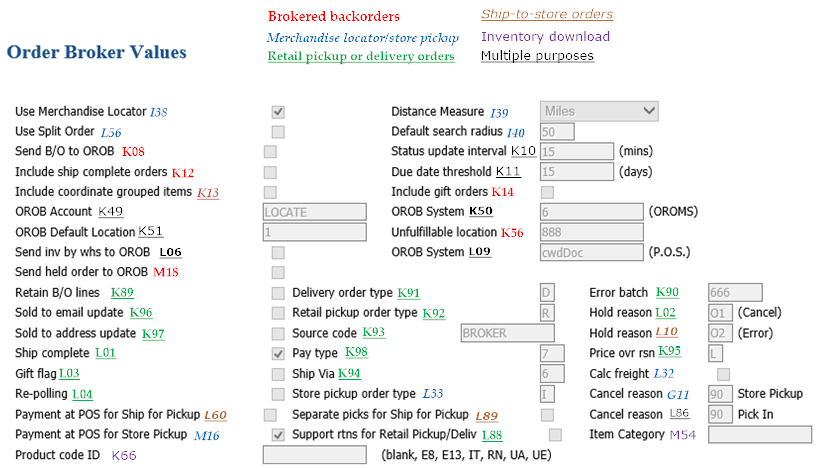

Order Broker Values (K15)
Defines default rules and settings for integration with the Order Broker in Order Broker.
Use Merchandise Locator (I38)
Defines whether merchandise locator searches are available for information and to support store pickup order creation.
Selected/ Unselected
Merchandise Locator Distance Measurement (I39)
Defines whether the distance measurement for merchandise locator or store pickup searches is miles or kilometers.
Code:
Use Split Order (L56)
Defines whether to submit all brokered backorders on an order in a single Submit Order message.
Default Search Within Radius (I40)
Indicates the default search radius, in miles or kilometers, for merchandise locator or store pickup searches.
Number:
Send B/O to OROB (K08)
Indicates whether to send fulfillments requests for backordered items (brokered backorders) to Order Broker’s Order Broker module.
Selected/ Unselected:
Order Broker Status Update Interval (K10)
Defines how many minutes to wait before sending a new status inquiry request for to the Order Broker for brokered backorders or for retail pickup, delivery, or store pickup orders.
Number:
Order Broker Include Ship Complete Orders (K12)
Indicates whether backordered items on orders flagged to ship complete are eligible for fulfillment through the Order Broker.
Order Broker Due Date Threshold (K11)
Defines the number of days in the future a purchase order’s expected date needs to be before the system requests the Order Broker fulfill a backordered item, or for the system to reject a retail pickup or delivery order.
Number:
Order Broker Include Coordinate Grouped Orders (K13)
Indicates whether backordered items assigned coordinate group codes are eligible for fulfillment through the Order Broker.
Order Broker Include Gift Orders (K14)
Indicates whether backordered items on gift orders are eligible for fulfillment through the Order Broker.
OROB Account (K49)
Defines the account number to specify in Order Broker request messages to identify the Order Broker database.
System name:
OROB System (K50)
Defines the system code to specify in Order Broker request messages to identify the requesting system.
System name:
OROB Default Location (K51)
Defines the default location code to specify in Order Broker request messages to identify the requesting warehouse in Order Management System.
System name:
OROB Default Location Code for Unfulfillable Orders (K56)
Defines the location code the Order Broker assigns to a brokered backorder when it cannot find a location to fulfill it.
System name:
Send Inventory by Warehouse to OROB (L06)
Indicates whether to send inventory information to and request orders from Order Broker separately by warehouse, or to aggregate information and to use the OROB Default Location (K51).
Name in OROB for Point of Sale (L09)
Defines the code in Order Broker identifying your default integrated point of sale system for assignment of ship-for-pickup or store pickup orders.
Code:
Retain Backordered Lines Brokered to OROMS (K89)
Indicates whether to accept delivery or retail pickup orders assigned by the Order Broker even if they include items that are backordered.
Order Type for Orders Brokered for Delivery (K91)
Defines the order type to apply to delivery orders assigned by the Order Broker.
Code:
Order Broker Error Batch Number (K90)
Define the batch number to use for delivery or retail pickup orders in error that are assigned by the Order Broker.
Number:
Sold to Email Update for Orders Brokered to OROMS (K96)
Indicates whether to update a customer’s email address based on the information received from the Order Broker when it sends delivery or retail pickup orders to Order Management System for fulfillment.
Order Type for Retail Pickup Orders Brokered to OROMS (K92)
Defines the order type to apply to retail pickup orders assigned by the Order Broker.
Code:
Order Broker Hold Reason (Cancel) (L02)
Defines the hold reason code to apply to a delivery or retail pickup order when Order Broker indicates that the order has been canceled during pick slip generation in Order Management System.
Code:
Sold to Address Update for Orders Brokered to OROMS (K97)
Order Broker Source Code (K93)
Defines the default source code to apply to delivery or retail pickup orders assigned to Order Management System for fulfillment if no source code was specified in the message from the Order Broker or for the Store Cross Reference record.
Code:
Hold Reason for Errored Ship for Pickup Orders (L10)
Defines the hold reason code to apply to ship-for-pickup orders if Order Broker returns an error when Order Management System.sends the submit order request during pick slip generation.
Code:
Ship Complete for Orders Brokered to OROMS (L01)
Indicates whether to flag a retail pickup or delivery order to ship complete.
Order Broker Payment Type (K98)
Defines the pay type to apply to retail pickup or delivery orders assigned to Order Management System for fulfillment.
Number:
Order Broker Price Override (K95)
Defines the price override reason code to use for order lines on retail pickup or delivery orders assigned to Order Management System for fulfillment.
Code:
Gift Flag for Orders Brokered to OROMS (L03)
Indicates whether to flag retail pickup or delivery orders as gifts in order to prevent prices from printing on pick slips.
Order Broker Ship Via (K94)
Defines the default ship via code to apply to retail pickup or delivery orders assigned to Order Management System for fulfillment if a ship via code is not specified in the message from the Order Broker.
Number:
Calculate Freight for Store Pickup Orders (L32)
Indicates whether to calculate freight for store pickup orders that you create in interactive order entry.
Re-Polling for Orders Brokered to OROMS (L04)
Indicates whether to send a status update of polled when a delivery or retail pickup order is received from the Order Broker and the order is in error.
Store Pickup Order Type (L33)
Defines the order type to assign to store pickup orders.
Code:
Cancel Reason (Rejected Store Pickup Orders) (G11)
Defines the cancel reason code to apply to store pickup orders rejected by Order Broker or by the assigned fulfilling location.
Code:
Payment at POS for Ship for Pickup Orders (L60)
Defines whether you collect payment for a ship-for-pickup order at the store location rather than billing the order when you ship it from the warehouse.
Cancel Reason (Pick In) (L86)
Defines whether to automatically cancel retail pickup, delivery, or special ship-for-pickup orders if their pick slips are voided through the generic pick in API.
Code:
Payment at POS for Store Pickup (M16)
Controls whether to authorize store pickup orders for verification only, or to authorize and bill store pickup orders in Order Management System.
Suppress Returns for Retail Pickup/Delivery (L88)
Defines whether you can process a return or a negative additional charge for a retail pickup or delivery order.
OROB Product Code ID (K66)
Indicates the field where you store Order Broker’s default product code.
Code:
OROB Item Category Value (M54)
Indicates whether to map the long SKU division or the item category to the category in Order Broker.
Code:

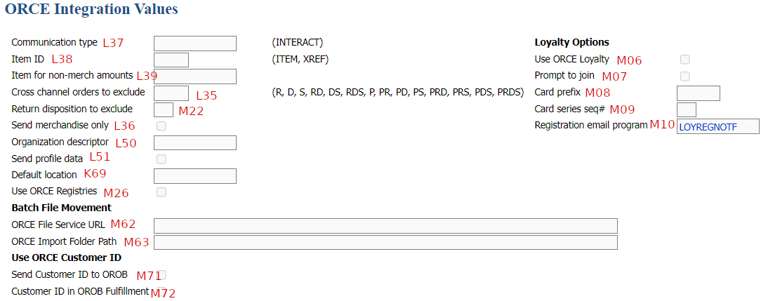

ORCE Integration Values (L52)
These values control integration with Oracle Retail Customer Engagement.
ORCE Customer Integration (L37)
Defines how Order Management System sends customer information to Oracle Retail Customer Engagement.
Code:
MICROS Integration Item ID (L38)
Defines how Order Management System identifies items/SKUs for integrations with other systems.
Code:
Item for Non-Merchandise Amounts (L39)
Defines the item code to include in the Customer Engagement Post POSlog Transaction Message to represent all non-merchandise amounts for an item, such as freight, additional freight, handling and additional charges.
Code:
Cross Channel Orders to Exclude in Sales Feed (L35)
Defines the types of orders Order Management System excludes in the Customer Engagement Sales Feed.
Code:
Return Disposition Code to Exclude in ORCE Sales Feed (M22)
Defines the return disposition code assigned to return (credit) invoices that Order Management System excludes from the Customer Engagement Sales Feed. In addition, Order Management System does not generate a return confirmation for these returns.
Code:
Merchandise Only in Sales Feed (L36)
Defines whether Order Management System includes full invoice totals or only merchandise and tax amounts in the Customer Engagement Sales Feed.
ORCE Organization Descriptor (L50)
Identifies the Oracle Retail Customer Engagement organization that maps to your Order Management System company.
Note:  For integration with Customer Engagement 20.0+, this field now controls the web service messages structure rather than the organization descriptor, and must be set to ws.
Code:
Send Profile Data to ORCE (L51)
Defines whether to include customer profile information when sending new or changed customer information to Oracle Retail Customer Engagement through the interactive customer integration.
Default Location for ORCE Integration (K69)
Indicates the store cross-reference record you use as part of an integration with a point-of-sale system.
Code:
Use ORCE Registries (M26)
Defines whether you use the Customer Engagement Gift Registry and Wish List Integration.
Use ORCE Loyalty (M06)
Defines whether you use the Customer Engagement Loyalty Integration.
Prompt to Join Loyalty (M07)
Defines whether the system automatically displays the Customer Loyalty Registration Window during Order Entry and Work with Customers (WCST) when the customer is not assigned to a loyalty card in Oracle Retail Customer Engagement.
ORCE Loyalty Card Prefix (M08)
Defines the 5 digit prefix assigned to the Loyalty Card Definition in Oracle Retail Customer Engagement that is used to assign new loyalty cards to sold to customers that join the loyalty program.
Code:

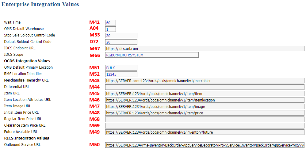

Enterprise Integration Values (M41)
These values control integration with integration with Oracle Retail Merchandising Foundation Cloud Service (RMFCS) and Oracle Retail Pricing Cloud Service (RPCS) through Omnichannel Cloud Data Service (OCDS), as well as with RICS.
Enterprise Integration Wait Time (M42)
Defines the number of seconds to wait for a response from OCDS for responses to requests for item and related data, and RICS for backorder notification requests.
Number:
OMS Default Warehouse (A04)
Defines the default warehouse to use when importing enterprise foundation data through OCDS.
Number:
OCDS Stop Sale Indicator SLC Code (M53)
Defines the soldout control code to use when Order Management System indicates to sell out an item immediately.
Code:
Default Sold Out Control Code (D72)
Defines the soldout control code to assign when creating items or SKUs.
Code:
OMS Default Primary Location (M51)
Defines the location to use when creating item location records through the OCDS import.
Code:
OCDS RMS Location Identifier (M52)
Defines the location identifier to map item and pricing from Oracle Retail Merchandising Foundation Cloud Service (RMFCS) and Oracle Retail Pricing Cloud Service (RPCS) to a company in Order Management System when integrating through OCDS.
Code:
OCDS Merchandise Hierarchy URL (M43)
Defines the URL to use when requesting merchandise hierarchy information from OCDS.
Long:
OCDS Differential URL (M44)
Defines the URL to use when requesting item differential information from OCDS. Not currently implemented.
Long:
OCDS Item URL (M45)
Defines the URL to use when requesting item information from OCDS.
Long:
OCDS Item Location Attributes URL (M46)
Defines the URL to use when requesting information derived from the ITEM_LOC table in OCDS.
Long:
OCDS Item Image URL (M47)
Defines the URL to use when requesting item image information from OCDS.
Long:
OCDS Initial Item Price URL (M48)
Defines the URL to use when requesting item price information from OCDS.
Long:
OCDS Regular Item Price URL (M68)
Defines the URL to use when requesting regular item price information from OCDS if OAuth is used for authentication.
Long:
OCDS Clearance Item Price URL (M69)
Defines the URL to use when requesting clearance item price information from OCDS if OAuth is used for authentication.
Long:
OCDS Future Available URL (M49)
Defines the URL to use when requesting future available inventory information from OCDS.
Long:
RICS Outbound Service URL (M50)
Defines the URL to use when submitting requests to RICS.
Long:
IDCS Enterprise Endpoint Scope (M66)
Defines the limits that control where the OAuth token can be used as part of Transmitting the RTLOG File to Object Storage.
Long:
IDCS Enterprise Endpoint URL (M67)
Defines the endpoint to use for OAuth authentication as part of Transmitting the RTLOG File to Object Storage.
Long:
Use this screen to work with values that control the integration between Order Management System and Order Broker’s Order Broker and merchandise locator function. You can use this integration to:
         search for inventory across the enterprise
         automatically have backorders originating in Order Management System fulfilled in an external system, such as Xstore, and prevent selling out backorders unnecessarily
         use Order Management System to fulfill orders originating in a point of sale system, such as Xstore
         send orders from your Order Management System warehouse to a retail store location, where the customer can pick it up
Supplier Direct Fulfillment integration: The integration with Order Broker’s Supplier Direct Fulfillment module uses the OROB System (K50) and OROB Default Location (K51), but none of the other system control values on this screen.
For more information: See:
         the Order Broker Integration Overview for a a high-level discussion of the integration
         the Order Broker Integration for detailed information on integration with the Order Broker
         the Merchandise Locator API for detailed information on searching for items across the enterprise
         Order Broker Configuration for additional setup requirements
Additional system control values related to the Order Broker: See Order Broker Configuration for information on additional system control values that are not included on this screen.
Order Broker values:
         OROB Account (K49)
         OROB System (K50)
         Send Held Orders to OROB (M18)
         Create Separate Picks for Ship for Pickup Orders (L89)
Enter the number of miles or kilometers, depending on the Merchandise Locator Distance Measurement, to default at the Merchandise Locator Search Window (Searching for an Item) and Merchandise Locator Search Window (Store Pickup). This field indicates the distance from the customer’s location to search for item availability in stores and warehouses. You can override this default at the search window.
Leave this field blank if you do not want a value to default at the search window or if you do not use the merchandise locator or store pickup options.
Yes/no field: Select this field to have Order Management System submit backordered lines to the Order Broker for fulfillment (brokered backorders), and prevent backordered lines from selling out unnecessarily.
Important:                           This system control value must be selected if the Use OROB for Fulfillment Assignment (M31) system control value is selected or the Use OROB for Ship for Pickup Fulfillment Assignment (M34) system control value is set to ALWAYS.
BROKER process: The BROKER process in Working with Integration Layer Processes (IJCT) generates order, status inquiry, and status update request messages to the Order Broker, and receives the response messages.
Leave this field unselected if you are not using the Order Broker to fulfill backordered lines.
See Brokered Backorders for background.
Number field: Enter the number of minutes that the BROKER process in Working with Integration Layer Processes (IJCT) should wait between including an order line in a status inquiry list request to Order Broker. Typically, you would set this field to a short interval when you are first implementing the Order Broker integration, then to a longer interval for production purposes. The default interval is 60 minutes.
The BROKER process “wakes up” to begin the process of evaluating each order line periodically based on the Outbound delay time specified through Working with Integration Layer Processes (IJCT). For example, if the Outbound delay time is set to 600 seconds (10 minutes), the BROKER process waits 10 minutes after finishing its evaluation before it starts the evaluation process again and determines whether to include a line on the order in a status inquiry list request. In evaluating each order line, it checks the latest time when the line was included in a status inquiry list, and determines whether the Order Broker Status Update Interval (K10) has elapsed since then.
Example:
         The Outbound delay time for the BROKER process is set to 600 seconds (10 minutes).
         The Order Broker Status Update Interval (K10) is set to 60 minutes.
         The last time the BROKER process received a status update on an order line was 8:02.
         You start the BROKER process at 8:50. It evaluates the order line and determines that it is not yet eligible for a status inquiry, since less than 60 minutes have elapsed since its last inquiry.
         The BROKER process finishes evaluating orders at 8:55 and “wakes up” again at 9:05 based on the Outbound delay time of 10 minutes.
         This time, the order line is eligible for a status inquiry, since it has been more than 60 minutes since the last inquiry, and it is included in the status inquiry list request.
Order lines evaluated independently: The BROKER process evaluates each order line on a brokered backorder or ship-for-pickup order independently to determine when to include each line in an inquiry request. For example, if one line was last updated at 4:17, and another was last updated at 4:56, the process includes the first line in a request at 5:17, and the second at 5:56, based on a 60-minute status update interval.
This field does not control when Order Management System sends:
         Submit order requests, or status update requests when you cancel or sell out an item or order; there is no built-in delay for sending these requests.
         Status inquiry list requests for Order Broker records whose current status is In Transit, Intransit Polled, Received by Store, or Partial Fulfill; it sends these requests once a day based on the OROB_LIMITED_STATUS_BEG_TIME and OROB_LIMITED_STATUS_END_TIME properties in Working with Customer Properties (PROP) and the setting of the Use OROB for Ship for Pickup Fulfillment Assignment (M34) system control value; see Setting the Daily Status Inquiry Time Window (all versions).
         Fulfillments requests; it sends these messages periodically based on the Outbound delay time specified through Working with Integration Layer Processes (IJCT).
         Status update requests: it sends these messages when the BROKER process “wakes up” after the Outbound delay time.
Leave this field blank if you are not using the Order Broker, or if you want to check for status updates every 60 minutes.
See the Order Broker Integration for background.
Yes/no field: Select this field to have orders that are flagged to ship complete be eligible for submission to the Order Broker as brokered backorders if they meet all the other Rules for Submitting Backorders to Order Broker.
You can review an order’s Ship complete setting at the Display Order Properties Screen.
Leave this field unselected if you want to exclude ship-complete orders from submission to the Order Broker.
Number field: Enter the number of days you want to wait for receipt of a purchase order rather than using the Order Broker integration for:
         Brokered backorders: If there is an open purchase order that could fulfill the backordered item, and the purchase order is due within the number of days specified here or sooner, then the BROKER process does not send the submit order request message for the brokered backorder. See Brokering Items with Soldout Control Codes for a discussion on how this threshold applies to items flagged with soldout control codes.
         Retail pickup or delivery orders: If the Retain Backordered Lines Brokered to OROMS (K89) system control value is unselected, and you receive a retail pickup or delivery order request that includes a backordered item that is not expected within the number of days specified here, then the BROKER process sends a status update request message to the Order Broker rejecting the order.
Example:
The Due Date Threshold system control value is set to 5 and:
1. There is an open purchase order for the backordered item due in 4 days. Result:
         Outbound (brokered backorder) order: Order Management System does not submit the order line to the Order Broker.
         Inbound (retail pickup or delivery) order: Order Management System accepts the order.
2. There is an open purchase order for the backordered item due in 6 days. Result:
         Outbound (brokered backorder) order: Order Management System submits the order line to the Order Broker.
         Inbound (retail pickup or delivery) order: Order Management System rejects the order.
3. There are 2 open purchase orders for the backordered item. One is due in 4 days, and the other is due in 10 days. After you run PO Layering, the full quantity of the first purchase order is accounted for on earlier orders. Result:
         Outbound (brokered backorder) order: Order Management System submits the order line to the Order Broker, because based on PO layering, you do not expect receipt of an eligible purchase order for 10 days.
Leave this field set to zero if you are not using the Order Broker or if you would always like to send backordered order lines to the Order Broker for fulfillment (outbound orders) or accept retail pickup or delivery orders from the Order Broker (inbound orders), regardless of when you are expecting receipt of any purchase orders that might be able to fulfill them.
Note:           Regardless of the setting of this system control value, drop ship items are always eligible to be retained for fulfillment through Order Management System.
Yes/no field: Select this field to have order lines assigned a Coordinate group code be eligible for submission to the Order Broker as brokered backorders if they meet all the other Rules for Submitting Backorders to Order Broker.
You can use coordinate group codes to ensure that certain groups of items, such as set components, ship together.
Leave this field unselected if you want to exclude coordinate-grouped order lines from submission to the Order Broker.
Note:           The setting of this system control value is ignored if the Use OROB for Fulfillment Assignment (M31) system control value is selected.
Yes/no field: Select this field to have gift orders be eligible for submission to the Order Broker as brokered backorders if they meet all the other Rules for Submitting Backorders to Order Broker.
You can review an order’s Gift flag at the Display Order Properties Screen. Flagging an order as a gift order prevents item prices from printing on the pick slip, and generates a gift acknowledgment to the customer sold-to. These options might not be supported when fulfilling the order through the Order Broker.
Leave this field blank if you want to exclude gift orders from submission to the Order Broker.
OROB Account (K49)
System name field: Use this field to specify the name of the Order Broker database, as specified in the account setting at the Order Broker Tenant screen. This account name is passed as the destination in Order Broker requests, Merchandise Locator Searching, and in Supplier Direct Fulfillment Processing.
This field is typically set to LOCATE. Although the account setting at the Tenant screen might be lowercase, the account entry here is not case-sensitive; LOCATE is the same as locate.
Note:           This setting is at the Tenant screen in version 5.1 or later of Order Broker. Order Broker versions 4.0 through 5.0 use a setting in the locate-config.properties file on the Order Broker server, and prior versions of Order Broker determine the account setting from an entry in the rms_admin database.
Leave this field blank if you do not use the Order Broker Integration or Merchandise Locator Searching.
OROB System (K50)
System name field: Use this field to specify the system code identifying your company in Order Broker for Order Broker requests and for Merchandise Locator Searching. The system code must be the same as your Order Management System company number.
This system code is passed as the system_cd in request messages to the Order Broker module, and in the LocateItems request message for Merchandise Locator Searching. For example, if your Order Management System company number is 2, you set this field to 2 (not 002; omit padding zeros unless that is how you created the system code in Order Broker).
Order Broker uses this code not only to identify the requesting system, but also to identify the system product code for the item that is passed in the request message. This identification is important if the system product codes for an item vary in different systems that integrate with Order Broker, such as when you use a different item/SKU code in Order Management System than you use in the retail store system.
Example:                 You call an item AB100 BLUE LRGE in Order Management System, and call the same item 6033 in retail store system. If the OROB System indicated here matches the system code identifying Order Management System in Order Broker, the Order Broker looks for a system product called AB100 BLUE LRGE. Then, if the Order Broker assigns the order to a retail store location for fulfillment, it sends a notification to the store indicating that item 6033 is required.
Also used for the Supplier Direct Fulfillment integration: The integration with Order Broker’s Supplier Direct Fulfillment module also uses this system control value to determine the requesting_system_cd. See the Drop Ship Integration Values (H20).
Leave this field blank if you do not integrate with Order Broker.
System name field: Use this field to specify the location for:
         Periodic inventory updates and interactive item availability responses to Order Broker: If the Send Inventory by Warehouse to OROB (L06) system control value is unselected, this code is used as the location representing the Order Management System warehouse in Order Broker when creating or update a product location with current inventory information. When other external systems submit a merchandise locator request or order to Order Broker, the response message indicates that the product is stocked in this location.
         Brokered backorder requests to Order Broker: This code is passed as the originating location in the Order Broker request message for brokered backorders if the Use OROB for Fulfillment Assignment (M31) system control value is unselected, regardless of the setting of the Send Inventory by Warehouse to OROB (L06) system control value. If the Use OROB for Fulfillment Assignment (M31) system control value is selected, the system passes the location in the Originating Location to Pass to OROB (M32) system control value to Order Broker.
Order Broker uses this code to track history for the Order Broker request, and to avoid assigning an Order Broker order to the requesting location, even if Order Broker’s most current inventory information indicates that the requesting location has the requested item in stock. This code is passed as the requesting location_cd in the SubmitOrder request message.
         Store pickup requests to Order Broker: This code is passed as the originating location in the Order Broker request message for store pickup orders regardless of the setting of the Send Inventory by Warehouse to OROB (L06) system control value. Order Broker uses this code to track history for the Order Broker request. This code is passed as the requesting location_cd in the SubmitOrder request message.
         Merchandise locator requests to Order Broker: This code is passed as the requesting location_cd in the LocateItems request regardless of the setting of the Send Inventory by Warehouse to OROB (L06) system control value. See Merchandise Locator API for an overview.
         Fulfillments request to Order Broker: If the Send Inventory by Warehouse to OROB (L06) system control value is unselected, this code is passed as the requesting location_cd in the fulfillments request for newly assigned retail pickup or delivery orders assigned to Order Management System for fulfillment. See Order Broker Integration for an overview.
         Status update and inquiry requests to Order Broker: If the Send Inventory by Warehouse to OROB (L06) system control value is unselected, this code is passed as the requesting location_cd in the status inquiry and update requests for retail pickup, delivery, or ship-for-pickup orders. See Order Broker Integration for an overview.
         Ship-for-pickup requests to Order Broker:
         If the Send Inventory by Warehouse to OROB (L06) system control value is unselected, this code is passed as the requesting location_cd in the submit order request for ship-for-pickup orders.
         This code is always passed as the location_cd when submitting a ship-for-pickup order for a drop ship item. See Order Broker Integration for an overview.
Note:           If you are generating ship-for-pickup orders for drop ship items, you need to specify a valid Order Broker location in this system control value; otherwise, Order Broker returns an error indicating that the requesting location is invalid.
Using a default requesting location relieves you of the requirement of setting up all of your allocatable warehouses as locations in Order Broker, even if you ordinarily ship merchandise from multiple warehouses.
For example, you might use Order Management System’s warehouse list functionality to reserve and ship orders from five warehouses; however, you can set this field to 1 in order to always specify a location_cd of 1 in a request message, so that you do not need to set up the additional four warehouses as locations in Order Broker.
The location code you enter here must be a valid location code in Order Broker in the system indicated in the OROB System (K50) system control value, and should be uppercase if it is not numeric. If you use Order Broker’s Product, Product Location, and Incremental Inventory Import Process, the process creates a product location record for each item in this location, provided the item is flagged as OROB eligible in Order Management System.
Also used for the Supplier Direct Fulfillment integration: The integration with Order Broker’s Supplier Direct Fulfillment module also uses this system control value to determine the requesting_location_cd for the CreateDSOrder message to send a drop ship purchase order to Order Broker. See the Drop Ship Integration Values (H20).
Leave this field blank if:
         you do not integrate Order Management System with Order Broker, or
         if you do not integrate with Order Broker’s Supplier Direct Fulfillment module, if you have the Send Inventory by Warehouse to OROB (L06) system control value selected, and if you:
         do not use the merchandise locator search, store pickup, or brokered backorder options in Order Management System, and
         have specified a OROB location for each warehouse that maps to a location in Order Broker
System name field: Use this field to identify the Default Unfulfillable Location set up in Order Broker. Your entry here must match the Default Unfulfillable Location you have set up in Order Broker, which is where the Order Broker assigns order lines it cannot fulfill. When Order Management System receives a response from the Order Broker indicating that a brokered backorder is assigned to this location, it indicates that the Order Broker is unable to fulfill the order. In this case, Order Management System returns the order line to standard backorder and fulfillment processing.
Note:           Prior to Order Broker 5.3, the Default Unfulfillable Location is labeled the Default Shipping Location at the Preferences screen.
Leave this field blank if you do not send brokered backorders to the Order Broker.
Yes/no field: Indicates whether:
         Order Broker’s Product, Product Location, and Incremental Inventory Import Process and Item Availability Updates should separate inventory information by warehouse, or aggregate information across warehouses and use the OROB Default Location (K51) as the location representing the distribution center in Order Management System.
         When polling for newly assigned retail pickup or delivery orders, to send a separate fulfillments request message to the Order Broker by warehouse, or to send a single request for the OROB Default Location (K51).
Note:           The BROKER process polls for retail pickup or delivery orders only if you specify an order type in the Order Type for Orders Brokered for Delivery (K91) or in the Order Type for Retail Pickup Orders Brokered to OROMS (K92) system control value.
         When sending a status update or inquiry request, whether the requesting location is the OROB location for the warehouse shipping the order, or to specify the OROB Default Location (K51).
If this value is:
Selected = Order Management System sends:
         product location information for each OROB eligible item in each warehouse that has an OROB location specified.
         a separate fulfillments request message for each warehouse that has a OROB location specified. The requesting location code is the OROB location.
         a status update or inquiry request message identifying the warehouse’s OROB location as the requesting location.
Note:           If this system control value is selected but the OROB location is not defined for the warehouse, Order Management System does not send inventory information for each item flagged as OROB eligible if it has a record in this warehouse when a system import is initiated in Order Broker, and does not send fulfillments request messages for the warehouse.
Unselected = Order Management System sends:
         product location information for the OROB Default Location (K51), summing up information across all allocatable warehouses.
         a single fulfillments request message, using the OROB Default Location (K51) as the requesting location.
         a status update or inquiry request message identifying the OROB Default Location (K51) as the requesting location.
See Order Broker’s Product, Product Location, and Incremental Inventory Import Process and Retail Pickup (including Ship-for-Pickup) or Delivery Orders for more information and examples.
Code field: Use this code to identify the code representing your default point of sale system in Order Broker for ship-for-pickup or store pickup orders.
Important:                           Your entry here must be a valid system code in Order Broker and the case must match exactly.
Override: You can use the System Code specified for a Store Cross Reference to override the default system name. For example, if you use the Store Connect module for pickup orders in some store locations, but use a point-of-sale system for other locations that support ship-for-pickup orders, you might set this system control value to the code identifying your point-of-sale system, and enter the code for your Store Connect system for the Store Cross Reference records used for Store Connect locations. When submitting a store pickup or ship-for-pickup order to Order Broker, Order Management System uses the System Code, if any, from the Store Cross Reference record; otherwise, it uses the system code from this system control value.
Ship-for-pickup orders: If you specify a code here, the Store option is available at the Create One Time Ship To Address Screen in order entry, so that you can select the store where the customer wants to pick up a ship-for-pickup order. Otherwise, if this field is blank, you cannot create ship-for-pickup orders in order entry.
Store pickup orders: If you do not specify a code here or for the Store Cross Reference record, Order Management System cannot successfully submit a store pickup order to Order Broker.
Leave this field blank if you do not submit ship-for-pickup or store pickup orders to Order Broker.
See Ship-for-Pickup Orders and Store Pickup Orders for background.
Yes/no field: Indicates whether to submit backordered items to Order Broker for reservation and preliminary processing even if the order is held.
Important:                           If the Use OROB for Fulfillment Assignment (M31) system control value is selected or the Use OROB for Ship for Pickup Fulfillment Assignment (M34) system control value is set to ALWAYS, the recommended setting for this system control value is unselected.
Select this field to have Order Management System submit backordered items to Order Broker even if the order is still held, provided it is otherwise eligible based on the Rules for Submitting Backorders to Order Broker. The SubmitOrder message to Order Broker indicates that the order is Under Review, and should not be shipped until the order’s Under Review flag is cleared.
You might use this setting to provide the location that fulfills a brokered backorder or a ship-for-pickup order with the opportunity to reserve stock and begin order processing before the order is removed from hold.
Notifying Order Broker of a change: If this system control value is selected, Order Management System sends an order update to Order Broker whenever an order that includes a brokered backorder item, or is a ship-for-pickup order, changes from held to open, or vice versa:
         held order in Order Management System = Under Review flag selected in Order Broker
         open order in Order Management System = Under Review flag unselected in Order Broker
See Order Update Request Sample (Changing the Under Review Setting for a Brokered Backorder or Store Pickup Order).
Important:
         Order Broker does not prevent an integrated system from fulfilling an order flagged as Under Review. The integrated system needs to check the setting of the Under Review flag to determine whether an order is eligible for fulfillment.
         If you select the Use OROB for Fulfillment Assignment (M31) system control value or set the Use OROB for Ship for Pickup Fulfillment Assignment (M34) system control value to ALWAYS, it is recommended that you deselect the Send Held Orders to OROB (M18) system control value.
Tracking changes: Updates to the Under Review flag are not tracked through Working with Order Broker (WOBR) or at the Display Order Broker Details Screen; however, a message is displayed at the Display Order History Screen, and the initial setting and any changes are tracked in Order Broker under order status history. This information is displayed at the Order screen in Order Broker, under the History tab.w
Active PO items: This system control value also controls whether the PREORDER or ACTPO periodic function includes held orders. See Releasing Eligible Orders to Order Broker and Submitting the Backorder Quantity Update Notification for more information.
When releasing the order is prevented: See Reauthorization and Under Review Hold Scenarios for Orders Fulfilled through Order Broker for a discussion of when the system prevents you from releasing an order from hold if the order payment method is not yet authorized.
Leave this field unselected if you do not want Order Management System to submit backordered items to Order Broker unless the order status is open:
         Order Management System does not submit brokered backorders or ship-for-pickup orders to Order Broker if the order is created in held status.
Note: To prevent sending orders to Order Broker if they have failed authorization, you need to specify a hold reason code for each declined response code. See Defining Vendor Response Codes for more information.
         If you release an order from hold after initial creation, the order is not submitted to Order Broker unless you run the BROKER Periodic Function.
         Order Management System does not submit updates based on changes to the order’s status.
         If an order is held after initial creation of the order and of the Order Broker record, Order Management System does not send an order update message to Order Broker; the order is still eligible for fulfillment by the assigned fulfilling location unless you cancel the order, update the order in Order Broker, or notify the location.
Note:             This setting applies to Brokered Backorders only. If the Payment at POS for Store Pickup (M16) system control value is unselected, similar rules apply to store pickup orders. See that system control value for more information.
Hold reason requirement: The system puts an order on hold for a declined authorization based on the hold reason code, if any, defined for the vendor response. If no hold reason is defined, the order does not go on hold and can be eligible to send to Order Broker even if this system control value is unselected. See Defining Vendor Response Codes for more information.
Yes/no field: Indicates whether to accept retail pickup or delivery orders assigned by the Order Broker even if any of the items are currently on backorder. If this value is:
Selected = Order Management System accepts retail pickup or delivery orders regardless of whether any of the items are fully or partially backordered.
Unselected = Order Management System accepts a retail pickup or delivery order that includes a backordered item only if the item is expected on a purchase order due within the Order Broker Due Date Threshold (K11).
See the Order Broker Due Date Threshold (K11) system control value for a discussion and examples.
Code field: Use this field to indicate the order type to assign to orders received from the Order Broker with a delivery type of Delivery. These are orders that originated in an external system, such as Xstore, and were assigned to Order Management System through the Order Broker integration in order to ship them directly to the customer. Your entry must be a valid order type, as specified through Establishing Order Types (WOTY).
If you specify an order type both here and in the Order Type for Retail Pickup Orders Brokered to OROMS (K92), the BROKER process sends fulfillments request messages to Order Broker periodically to poll for newly assigned orders. Both order types must be specified, even if you fulfill only one type of these types of orders.
Note:         This system control value is also used when notifying Order Broker to set the status of a ship-for-pickup order to intransit, so it must be populated if you process ship-for-pickup orders even if you do not process delivery orders.
Leave this field blank only if you do not process delivery, retail pickup, or ship-for-pickup orders with the Order Broker.
See Retail Pickup (including Ship-for-Pickup) or Delivery Orders for background.
Number field: Use this field to indicate the batch number to assign to delivery or retail pickup orders received from the Order Broker if they are in error for any reason. If an order is in error and you do not specify a batch number here, the system assigns the order to the Default Batch for E-Commerce Orders in Error (G41).
Leave this field set to zero if you do not receive delivery or retail pickup orders from the Order Broker, or if you want to assign the orders to the Default Batch for E-Commerce Orders in Error (G41) if they are in error.
Yes/no field: Use this field to indicate whether to update a customer’s email address based on the information received from the Order Broker for a delivery or retail pickup order:
Selected = Update an existing customer's email address at the customer sold-to level, and primary email address in the Customer Sold To Email table.
Unselected = Do not update an existing customer’s email address.
See Working with Customer Email Addresses for an overview on email addresses, and see Retail Pickup (including Ship-for-Pickup) or Delivery Orders for a process overview.
Note:           If ORCE Customer ID in OROB Fulfillment (M72) is selected, the email address from Customer Engagement is used.
Note:           Regardless of the setting of this system control value, email updates you receive in Order Management System on a retail pickup or delivery order do not update the associated customer record in Oracle Retail Customer Engagement when you use the Customer Engagement Customer Integration. As a result, the customer’s primary email address is overwritten if you retrieve the customer information from Oracle Retail Customer Engagement.
Code field: Use this field to indicate the order type to assign to orders received from the Order Broker with a delivery type of Retail pickup. These are orders that originated in an external system, such as Xstore, and were assigned to Order Management System through the Order Broker integration in order to ship the merchandise to the originating store location. Your entry must be a valid order type, as specified through Establishing Order Types (WOTY).
If you specify an order type both here and in the Order Type for Orders Brokered for Delivery (K91), the BROKER process sends fulfillments request messages to Order Broker periodically to poll for newly assigned orders. Both order types must be specified, even if you fulfill only one type of these types of orders.
Note:           This system control value is also used when notifying Order Broker to set the status of a ship-for-pickup order to intransit, so it must be populated if you process ship-for-pickup orders even if you do not process retail pickup orders.
Code field: Use this field to specify the hold reason code to apply when pick slip generation sends a status list or status inquiry request to the Order Broker to check the status of a retail pickup or delivery order, and the Order Broker indicates that the order has been canceled. In this situation, you also need to cancel the order in Order Management System.
Your entry must be a valid hold reason code, as specified through Establishing Order Hold Reason Codes (WOHR).
Leave this field blank if you do not receive retail pickup or delivery orders from the Order Broker.
Note:           If you leave this field blank and Order Broker indicates that a retail pickup or delivery order is canceled in response to the status inquiry during pick slip generation, the system does not put the order on hold, and the pick slip generation job will continue to evaluate the order and submit status inquiry requests to Order Broker. See Use OROB Status Inquiry List Web Service (M05) for a discussion.
When you subsequently cancel the order line in Order Management System, no update is generated to Order Broker.
Yes/no field: Use this field to indicate whether to update a customer’s name and address based on the information received from the Order Broker for a delivery or retail pickup order:
Selected = Update an existing customer's name and address at the customer sold-to level.
Unselected = Do not update an existing customer’s name and address.
Regardless of the setting of this system control value, the system always updates the customer’s day and evening phone numbers if they are provided in the fulfillments response message from the Order Broker.
Note:           If ORCE Customer ID in OROB Fulfillment (M72) is selected, the customer information from Customer Engagement is used.
Note:           Regardless of the setting of this system control value, name and address updates you receive in Order Management System on a retail pickup or delivery order do not update the associated customer record in Oracle Retail Customer Engagement when you use the Customer Engagement Customer Integration. As a result, the customer’s name and address are overwritten if you retrieve the customer information from Oracle Retail Customer Engagement.
Code field: Use this field to indicate the default source code to assign to retail pickup or delivery orders received from the Order Broker for fulfillment, including orders that originated in Order Management System.
Which source code to use? The hierarchy that the system uses to determine the source code varies depending on whether the order originated in Order Management System.
         If the order did originate in Order Management System and Order Broker assigned it back to Order Management System for fulfillment:
         Use the Order Broker Source Code (K93), if specified; otherwise, if this system control value is blank,
         Use the source code, if any, specified for the store cross reference record (WSCR) for the originating location, which is based on the Originating Location to Pass to OROB (M32) system control value; otherwise,
         Use the source code passed in the fulfillments response message from Order Broker. This would be from the originating order.
         If the order did not originate in Order Management System:
         Use the source code, if any, passed in the fulfillments response message from Order Broker; otherwise,
         Use the source code specified for the originating store location through Work with Store Cross Reference (WSCR); otherwise,
         Use the source code specified in this system control value, if any; otherwise, if this system control value is blank,
         The order is created in error status because of the missing source code.
Your entry must be a valid source code. Typically, you would create a source code that is not eligible for free gifts, promotions, or other updates that could apply at order creation, and is not associated with an offer that could add any accompanying items. Also, you should confirm that your entry is not a restricted source code and is associated with a current offer. See Working with Source Codes (WSRC) for more information on setting up source codes.
Leave this field blank if you do not receive retail pickup or delivery orders from Order Broker.
Code field: Use this field to indicate the hold reason code to apply to a ship-for-pickup order if the Order Broker responds with an error when pick slip generation attempts to submit the order.
Leave this field blank if you do not send ship-for-pickup orders to the Order Broker during pick slip generation.
The system submits a ship-for-pickup order to Order Broker during pick slip generation or drop ship purchase order processing in the following scenarios.
         When the Use OROB for Ship for Pickup Fulfillment Assignment (M34) system control value is set to NEVER, or
         When the Use OROB for Ship for Pickup Fulfillment Assignment (M34) system control value is set to ALWAYS but the Send B/O to OROB (K08) system control value is unselected.
See Ship-for-Pickup Orders for background.
Yes/no field: Use this field to indicate whether to have the system flag retail pickup or delivery orders sent from the Order Broker as Ship complete.
Selected (default) = Select the Ship complete flag when creating a retail pickup or delivery order from the Order Broker. The order is not eligible to have a pick slip printed until all items are reserved, resulting in a single shipment.
Unselected = Leave the Ship complete flag unselected when creating a retail pickup or delivery order. The order is eligible to have a pick slip printed as items on the order become reserved, possibly resulting in multiple shipments.
Note:           This system control value is not currently implemented. When the message version is set to 5.0 or higher, the ship_complete setting passed in the fulfillments response message applies.
Selecting this field can help eliminate confusion for the system originating the order, since Order Management System does not send a status update message indicating that the order has been shipped until the entire order is shipped.
Number field: Use this field to specify the pay type to apply to retail pickup or delivery orders sent from the Order Broker.
Setup: This pay type is typically a “dummy” payment method, since the order is typically paid for at the originating store location. To simplify the order creation and fulfillment process, you can set up a payment method as a credit card that is not associated with an authorization or deposit service and has no other validation or requirements, such as leading digits, length, modulus check, and start or expiration date.
The pay type you enter here must be a valid pay type, as set up through Working with Pay Types (WPAY).
Order creation: When the system creates the retail pickup or delivery order in Order Management System, it uses the Description of this pay type as the Credit card # for the payment method on the order.
Restrictions: You cannot apply this pay type to an order in order entry or order maintenance; however, there is no restriction against applying this pay type through the generic order API.
Code field: Use this field to specify the price override reason code to apply to order lines on retail pickup or delivery orders sent from the Order Broker.
A price override reason code is required in order to preserve the pricing passed from the Order Broker in the fulfillments response message and prevent Order Management System from repricing the order.
The price override reason code you enter here must be a valid code, as set up through Establishing Price Override Reason Codes (WPOR).
Yes/no field: Use this field to indicate whether to have the system flag retail pickup or delivery orders sent from the Order Broker as Gift orders.
Selected = Select the Gift flag when creating a retail pickup or delivery order from the Order Broker. Prices and dollar totals do not print on the pick slip. You might use this setting to eliminate confusion about possible discrepancies between the totals in Order Management System and in the originating system.
Unselected = Leave the Gift flag unselected when creating a retail pickup or delivery order.
Note:         This system control value overrides the setting, if any, passed in the fulfillments response message.
Number field: Use this field to indicate the default ship via code to apply to retail pickup or delivery orders sent from the Order Broker. The system applies this ship via to the order if no ship via code was passed in the fulfillments response message received from the Order Broker.
The ship via code you enter here must be a valid code, as set up through Working with Ship Via Codes (WVIA). Typically, you would select a ship via that does not add any additional freight charges to the order.
If this system control value is blank, the Default Ship Via (A77) applies.
Yes/no field: Indicates whether to calculate freight for store pickup orders you create in interactive order entry.
Select this field to have order entry use standard freight calculation based on the source code for store pickup orders.
Leave this field unselected to set the Calculate freight flag to N for store pickup orders, so that no freight applies.
         Additional freight: Regardless of the setting of this field, additional freight charges still apply if specified for the ship via.
         Order API: This field does not affect store pickup orders you receive through the order API. Even if this field is unselected, the order API still uses the regular freight calculation unless a freight amount is passed in the CWOrderIn message, or the calc_frt tag in the message is set to N.
Yes/no field: Indicates whether to send a status of polled to the Order Broker when a retail pickup or delivery order received in the fulfillments response message is in error.
Background: In Order Broker, the Require status update flag for a system (such as Order Management System) indicates:
         require a status update: the Order Broker continues to send retail pickup or delivery orders in the fulfillments response message until the system sends a status update of polled or accepted
         do not require status update: the Order Broker includes each new retail pickup or delivery order just once in the fulfillments responsefulfillments request message
The setting of this system control value must match the setting of the Require status update flag in Order Broker:
selected: the Order Broker continues to send a delivery or retail pickup order until it receives a status update of polled or accepted.
selected: If a retail pickup or delivery order is in error, Order Management System sends a status update of polled; otherwise, if the order is created without error, Order Management System sends a status update of accepted. Either status update prevents the Order Broker from sending the same order again.
unselected: the Order Broker sends a delivery or retail pickup order just once.
unselected: Order Management System sends a status update of accepted only when the order is created without error. It does not send a status update of polled for orders that are initially in error.
Important:                           If the Require status update flag is selected in Order Broker but this system control value is unselected, then the Order Broker would continue sending an order if there was an error in creating it in Order Management System, so the order could be created multiple times in Order Management System.
Code field: Use this field to indicate the order type to apply to store pickup orders. If you enter a valid order type code and the Use Merchandise Locator (I38) system control value is also selected:
         the Store Pickup option is available at the Order Detail screen in order entry, enabling you to create store pickup orders
         the system assigns this order type to an order when it is flagged for store pickup, regardless of the order type entered or defaulted in order entry, or passed in the order_type attribute in the CWOrderIn message
         The BROKER process sends status inquiry messages for store pickup orders
Note:           The system does not prevent you from assigning this order type to orders that do not specify a store location for store pickup.
Typically, the order type you specify here should not be flagged for online authorization. You can also use the order type to control the email notifications you send to the customer.
Note:           This order type must be flagged for Email notification so that the system generates the store pickup notification email. See Store Pickup Notifications for more information.
Leave this field blank if you are not creating store pickup orders.
Code field: Use this field to indicate the cancel reason to use if:
         the assigned store location for a store pickup order rejects the order, or
         the Order Broker cannot create a store pickup order (for example, if the selected store location specified in the SubmitOrder request message is not a valid location in the Name in OROB for Point of Sale (L09))
         the customer cancels the order at a retail location, and the system receives the status update when it sends a periodic status inquiry request
         If you leave this field blank when you use store pickup orders, any orders rejected by the selected location or by Order Broker will remain in open status.
         The Order Broker actually returns a status of unfulfillable when the order is rejected; however, the Order Broker status in Order Management System is rejected.
Cancel reason codes are defined in and validated against the Cancel Reason table. See Establishing Cancel Reason Codes (WCNR) for more information.
Yes/no field: Select this field if the customer needs to pay for a ship-for-pickup order at the store. When this field is selected, the following rules apply to ship-for-pickup orders:
         The order must include only credit card payment methods; also, each pay type’s Card type must be set to Credit. No other card types, such as stored value cards, can be included. Otherwise:
         Order entry: you cannot complete entry of the order; instead, the screen displays the error Invalid pay type for ship for pickup order and you cannot complete creation of the order without correcting the payment method(s).
         Order API: the order is in error with an error reason of Non-CC on Ship for Pickup (error code SA).
         The payment method’s Suppress deposit and Suppress refund flags are set to Y.
         The payment method is authorized for $1.00 only during online authorization.
         Authorization is suppressed during pick slip generation.
         Order Management System sends the pick slip total to the Order Broker as the balance_due in the Submit Order message.
         Returns and refunds are restricted against ship-for-pickup orders, so that you cannot:
         process a return against an entire ship-for-pickup order or a line on a ship-for-pickup order in order maintenance, through the Work with Return Authorizations menu option or the CWRETURNIN message
         create a return authorization for a ship-for-pickup order through the Work with Return Authorizations menu option or the CWReturn message
         enter a negative additional charge against a ship-for-pickup order in order maintenance
         enter a line with a negative quantity on a ship-for-pickup order in order entry or order maintenance
         apply a discount to a closed order line on a ship-for-pickup order in order maintenance
Do restrictions apply to special orders? For the most part, the above restrictions do not apply to ship-for-pickup orders whose order type matches the Order Type for Special Orders (L15); however, the returns and refunds restrictions listed above apply to all ship-for-pickup orders, including special orders.
Leave this field unselected if you do not create ship-for-pickup orders, or if you do not collect payment for ship-for-pickup orders at the store.

Order Broker Fulfillment Values
Select Order Broker Fulfillment on the Order Broker Values (K15) screen to display the system control values related to Brokered Backorders for fulfillment assignment.
         Order Type for Delivery Orders Originating in OROMS (M33)
         Invoice Ship For Pickup Order Once Intransit (M73) (described under Setting Up Customer Service Values)
Purpose: Use this screen to indicate whether you will use the Order Broker Drop Ship Integration to process drop ship orders, and to define the values used to pass information.
About the Oracle Retail Order Broker Supplier Direct Fulfillment module: The Supplier Direct Fulfillment module in Order Broker provides an internet-based, collaborative environment for retailers and vendors to share and process information related to drop ship orders. If you use Order Broker to process drop ship orders for a vendor, your system generates a drop ship purchase order and automatically transmits the purchase order information to Order Broker, where your vendor can access it through a browser window. You must purchase the Order Broker Supplier Direct Fulfillment module.
For more information: See Order Broker Drop Ship Integration.
System control values on this screen:
         Use OROB Drop Shipping (H13)
         Drop Ship Lead Days (H36)
         OROB Account (K49)
         OROB System (K50)
Select this field if you are using Order Broker to process drop ship purchase orders.
This value determines whether:
         You can assign a Drop ship output setting of OROB Drop Shipping to a vendor.
         The CDC async job processes drop ship transactions for your company.
At least one company in your environment must have this system control value selected in order for you to start the CDC async job.
Leave this field blank if you are not using Order Broker’s Supplier Direct Fulfillment module to process drop ship orders.
Enter the number of days you want to add to the data passed to Order Broker to calculate the Expected ship date stored in Order Management System for a drop ship purchase order line. If you enter a value in this system control value, the date passed to Order Broker is: Arrival date + CDC Drop Ship Lead Days + vendor lead days.
The date stored in Order Management System for the drop ship order line is: Arrival date + vendor lead days + drop ship lead days (the Lead days specified for the vendor item).
         Assign Drop Ship Expected Ship Date (I59) for a list of screens, reports, and notices that indicate the expected ship date.
         Supplier Direct Fulfillment Backorder Notice Processing for a discussion of how the expected ship date is calculated.
OROB Account (K49)
This system control value is not currently used as part of the integration with Order Broker’s Supplier Direct Fulfillment module.
See OROB Account (K49) under the Order Broker Values (K15) for information on how the integration with Order Broker’s Order Broker module uses this system control value.
OROB System (K50)
System name field: Use this field to specify the system code identifying your company in Order Broker for integration with the Supplier Direct Fulfillment module. The system code must be the same as your Order Management System company number.
This system code is passed as the requesting_system_cd in all request messages to the Supplier Direct Fulfillment module. For example, if your Order Management System company number is 2, you can set this field to 2 (not 002; omit padding zeroed unless that is how you created the system code in Order Broker).
Also used with Order Broker module: The integration with the Order Broker module also uses this system control value. See OROB System (K50) under the Order Broker Values (K15) for more information.
Leave this field blank if you do not integrate with Order Broker’s Order Broker or with Order Broker’s Supplier Direct Fulfillment module.
System name field: Use this field to specify the location code identifying your default warehouse in Order Broker for integration with the Supplier Direct Fulfillment module.
The location code is passed as the requesting_location_cd in the CreateDSOrder message to the Supplier Direct Fulfillment module. This message creates the drop ship purchase order in Order Broker.
The location code must match an existing location code in Order Broker for the OROB System (K50).
Also used with Order Broker module: The integration with the Order Broker module also uses this system control value. See OROB Default Location (K51) under the Order Broker Values (K15) for more information.
Leave this field blank if you do not integrate with Order Broker’s Order Broker module or with Order Broker’s Supplier Direct Fulfillment module.
Purpose: This screen includes the following system control values for integration with Oracle Retail Customer Engagement:
         ORCE Loyalty Card Series Sequence Number (M09)
         ORCE Loyalty Registration Notification Email Program (M10)
         ORCE File Service URL (M62)
         ORCE Import Folder Path (M63)
         Send ORCE Customer ID to OROB (M71)
Each is described below.
Additional related system control values: See Send ORCE Customer ID to Narvar (M70), Send ORCE Customer ID to OROB (M71), and ORCE Customer ID in OROB Fulfillment (M72) for additional system control values related to the Customer Engagement integration.
Purpose: Defines how Order Management System communicates customer information with Oracle Retail Customer Engagement.
Code field: Set this field to:
         INTERACT: Order Management System communicates interactively with Customer Engagement when you create or update a customer, and also populates the Customer Engagement Customer file with a Customer Engagement Add or Update Customer Message based on customer activity when you run the Customer Engagement Sales Feed. When you search for a customer in customer maintenance, order entry, when creating catalog requests, or when creating customer memberships, Order Management System looks first to Oracle Retail Customer Engagement, rather than the Order Management System Customer Sold To table, and you use the Customer Scan Screen. Use this setting if Oracle Retail Customer Engagement is the system of record for customer information. Also, when this field is set to INTERACT:
         Modern View:
         When you create or update a customer, the customer information is created or updated in Customer Engagement. See Customer Synchronization through Modern View for more information.
         Searching for a customer in Modern View retrieves customer records from Customer Engagement.
         The Customer Since date displayed in Contact Center is from the original signup date in Customer Engagement. Note that this date might be later than the earliest orders for the customer if you enabled the integration with Customer Engagement after you began creating orders and customers in Order Management System.
         Web services: The ORCE customer ID is included in the Generic Invoice Download API, Outbound Email API, and Generic Pick Out API. Also, the ORCE customer ID is sent instead of the Order Management System customer number in the Narvar Integration if it exists, and if the Send ORCE Customer ID to Narvar (M70) system control value is selected.
         Order Broker: If the Send ORCE Customer ID to OROB (M71) is selected, the SubmitOrder request to Order Broker includes the ORCE customer ID rather than the Order Management System customer number. Also, if the ORCE Customer ID in OROB Fulfillment (M72) is selected, the customer number passed in the fulfillments response message maps to the ORCE customer ID rather than the Order Management System customer number.
         blank: Order Management System does not communicate customer information to Oracle Retail Customer Engagement, or search the Oracle Retail Customer Engagement database for customers.
Note:           A setting of SALES is no longer supported in Order management System 21.0 or higher.
For more information:  See the Customer Engagement Batch Customer and Sales Integration and the Customer Engagement Customer Integration.
Also required for: An INTERACT setting is also required for the Customer Engagement Loyalty Integration and the Customer Engagement Gift Registry and Wish List Integration.
Purpose: Defines how Order Management System identifies items/SKUs for integrations with other systems.
ITEM
Order Management System uses the Item code and SKU code to identify items/SKUs for integrations with other systems.
XREF
Order Management System uses the Retail reference number to identify items/SKUs for integrations with other systems.
If you use retail reference number, make sure you define a unique reference number for each of your items/SKUs.
         You can define a retail reference number for a non-SKUed item on the Create or Change Item (Base Information) screen.
         You can define a retail reference number for a SKUed item on the Create or Change SKU - 1 of 2 (With Overrides) screen.
Note:  You do not need to define a Retail reference number for the item defined in the Item for Non-Merchandise Amounts (L39) system control value; the system sends the item code defined in this system control value to Oracle Retail Customer Engagement, regardless of how the MICROS Integration Item ID system control value is set.
Oracle Retail Customer Engagement Sales Feed Process: If you leave this system control value blank, the system writes an error in the Application Log when you submit the Customer Engagement Sales Feed Process: ORCE Sales Feed not run because SCV L38 MICROS Integration Item ID was not set up.
         Customer Engagement Purchase History Integration
Purpose: Defines the item code to include in the Customer Engagement Post POSlog Transaction Message to represent all non-merchandise amounts for an invoice, such as freight, additional freight, handling and additional charges.
Integration with the Sales Audit module of the Oracle Retail Merchandising Foundation Cloud Service: This system control value is also used as part of the Integration with the Sales Audit Module of the Oracle Retail Merchandising Foundation Cloud Service.
Enter an item code in this field if the Merchandise Only in Sales Feed (L36) system control value is unselected.
Note:             The item code cannot be greater than 10 positions. Create the item as a non-SKUed, non-inventory item.
For more information: See Customer Engagement Batch Customer and Sales Integration or the Integration with the Sales Audit Module of the Oracle Retail Merchandising Foundation Cloud Service for background.
Purpose: Use this field to specify the code that identifies the Oracle Retail Customer Engagement organization that maps to your Order Management System company.
Code field: Enter the three-position code that matches the Organization descriptor specified through the Oracle Retail Customer Engagement System Configuration option if you use Customer Engagement 15.x or earlier, or the Organization ID Descriptor property if you use a later version of Customer Engagement.
The system uses the value in this field during web service calls to Oracle Retail Customer Engagement.
This entry should typically be entered in lower case.
Important:                           For integration with Customer Engagement 20.0+, this field now controls the web service messages structure rather than the organization descriptor, and must be set to ws.
Note:           This system control value is also defined under the Stored Value Card Processing Values (I71) umbrella system control value.
Purpose: Use this field to control whether to send customer profile data through the interactive customer integration with Oracle Retail Customer Engagement.
Yes/No field: Select this field to include customer profile data in the interactive customer integration with Oracle Retail Customer Engagement; otherwise, leave this field unselected if the data should not be sent to Oracle Retail Customer Engagement.
Note:           This system control value affects the interactive Customer Engagement Customer Integration only; it does not affect sending customers to Oracle Retail Customer Engagement through the Customer Engagement Batch Customer and Sales Integration, as described under Customer Engagement Add or Update Customer Message.
         Customer Engagement Customer Integration for an overview and background on the integration.
         Order Management System Customer Profile > Customer Engagement Attribute Definition for more information on the setup required in Oracle Retail Customer Engagement in order to map customer profile data.
         Setting Up Customer Profiles (WPFL) for background on setting up and using customer demographic profiles.
Purpose: Use this field to define the location Order Management System sends to an external system, such as Oracle Retail Customer Engagement. You can also use this number as part of your unique POSLog integration. This setting is also required for the Customer Engagement Gift Registry and Wish List Integration.
Code field: Enter the store number you have set up through Work with Store Cross Reference (WSCR).
Note:           The location code specified here must be numeric to prevent any possible issues displaying a customer’s purchase history in Xstore. Also, your entry must not exceed the length defined in the Retail Transaction Location ID Length property in Customer Engagement.
When you specify a location in this system control value, the following cross-reference fields are available for review or entry:
         Store tender field on the Create Pay Type Screen provides a cross-reference to the corresponding tender code in a point-of-sale system. This code is passed in the POSLog integration to Customer Engagement, where it can be used as a loyalty qualifier.
         Store tax code field on the Create Postal Code Screen and Create SCF Screen provides a cross-reference to the corresponding tax code in a point-of-sale system.
Leave this field blank if you do not have an integration with a point-of-sale system.
Oracle Retail Customer Engagement integration: The system includes the location you define here:
         In the name of the XML batch file that is sent to Oracle Retail Customer Engagement and as the Relate Store ID if the customer does not already have a Relate ID assigned. See Customer Engagement Batch Customer and Sales Integration for more information on sending customer, item, sales and return information from Order Management System to Oracle Retail Customer Engagement, including when the default location is passed as the customer’s signup and home store location. Also, see Customer Data Mapping between Order Management System and Customer Engagement for information on when the default location is passed as the customer’s signup home and store location through the Customer Engagement Customer Integration.
         In the stored value card transactions sent to Oracle Retail Customer Engagement. See Customer Engagement Stored Value Card Integration.
Note:           For the Customer Engagement integration, the location cannot be greater than 8 positions and should not be greater than the length specified in the Retail Transaction Location ID Length specified in Customer Engagement.
Custom POSLog Integration: POSLog is a text file of the day’s sales transactions. A daily process generates the file based on the invoices for that day. You can use a periodic function, typically named POSLOG, to extract data from invoices and generate the POSLog file to support your unique POSLog integration. For information on setting up the POSLOG periodic function, contact your Order Management System representative.
POSLog property settings: Use the following properties to define the information required to transmit the POSLog file from Order Management System via FTP for integration with a point-of-sale system. You use a periodic function to extract transaction information to a file name Store#123.POL, where 123 is the store number assigned in the Default Location for Sales Download (K69) system control value.
If you use a unique POSLog integration, define the following properties:
         CW_POS_LOG_FILE_NAME: Specifies the name of the POSLog file, with the pound sign (#) indicating where to insert the three-position Default Location for Sales Download (K69). For example, if you set this property to Store #.POL, the file is named Store #123.POL, where 123 is the Default Location for Sales Download (K69).
         CW_FTP_POS_LOG_FILE: If set to Y, indicates to FTP the POSLog file using the poslog_ftp_commands.script, described below.
         CW_DELETE_POS_LOG_FILE_AFTER_FTP: If set to Y, indicates to delete the POSLog file after sending it by FTP.
         FTP script: The FTP script for POSLog integration is defined in the poslog_ftp_commands.script file. This file is located in the CWDIRECTCP_FTP_FOLDER property. The script consists of:
open | server | userID | passwd
put | /poslog/FTP_REMOTE_FILE_NAME
where:
server = the name of the destination server
userID = a valid user ID for the destination system
passwd = the user ID’s password
Note:           You should not modify the second line of the command file.
Purpose: Use this field to define whether you use the Customer Engagement Gift Registry and Wish List Integration.
Yes/No field: Select this field if you want to use the Customer Engagement Registry and Wish List integration.
Important: If you select this field, the ORCE Customer Integration (L37) system control value must be set to INTERACT, indicating you communicate with Customer Engagement interactively.
Leave this field unselected if you do not want to use the Customer Engagement Registry and Wish List integration.
Purpose: Use this field to define whether you use the Customer Engagement Loyalty Integration.
Yes/No field: Select this field if you want to use the Oracle Retail Customer Engagement Loyalty integration.
Important: If you select this field:
         The ORCE Customer Integration (L37) system control value must be set to INTERACT, indicating you communicate with Oracle Retail Customer Engagement interactively.
         You must define a card prefix in the ORCE Loyalty Card Prefix (M08) system control value.
         You must define a card series sequence number in the ORCE Loyalty Card Series Sequence Number (M09) system control value.
Leave this field unselected if you do not want to use the Oracle Retail Customer Engagement Loyalty integration.
For more information: See Customer Engagement Loyalty Integration for processing details and the required setup.
Purpose: Use this field to define whether the system automatically displays the Customer Loyalty Registration Window during Order Entry and Work with Customers (WCST) when Oracle Retail Customer Engagement does not find a loyalty card for the customer.
Yes/No field: Select this field to automatically display the Customer Loyalty Registration window when you:
         Select a sold to customer on the Customer Selection Screen if Oracle Retail Customer Engagement does not find a loyalty card for the customer and the customer’s ORCE_LOYALTY_PROMPT_ATTRIBUTE setting in Oracle Retail Customer Engagement is TRUE or blank.
         Change a sold to customer in Creating and Updating Sold-to Customers (WCST) if Oracle Retail Customer Engagement does not find a loyalty card for the customer and the customer’s ORCE_LOYALTY_PROMPT_ATTRIBUTE setting in Oracle Retail Customer Engagement is TRUE or blank.
         Create a sold to customer in Creating and Updating Sold-to Customers (WCST) or Order Entry (OEOM) after the customer is created in Oracle Retail Customer Engagement.
         In Work with Customers, this window automatically displays after the final Accept to create the customer.
         In Order Entry, this window automatically displays after the system validates the customer information and source code on the order and you click Accept.
         Create an order in Order Entry (OEOM) if you do not use the CTI Customer Selection Screen and Oracle Retail Customer Engagement does not find a loyalty card for the customer and the customer’s ORCE_LOYALTY_PROMPT_ATTRIBUTE setting in Oracle Retail Customer Engagement is TRUE or blank. This window automatically displays after the system validates the customer information and source code on the order and you click Accept.
Modern View: When this system control value is selected and ORCE Customer Integration (L37) is set to INTERACT, The Customer Loyalty List page is available in Modern View. You can use this page to review loyalty and awards programs and account details. See the Customer Engagement Loyalty Integration and the Modern View online help for more information.
Leave this field unselected if you do not want the Customer Loyalty Registration window to automatically display or the Customer Loyalty List page to be available in Modern View. Regardless of the setting of this system control value, this window displays when you:
         Select Loyalty from the Action drop-down menu on the Customer Scan Screen in Work with Customers (WCST) or Order Entry (OEOM).
         Select Loyalty on the Customer Selection Screen after selecting a sold to customer.
         Select Loyalty Account on the Display More Options Screen.
         Select Loyalty Account on the More Customer Sold To Options Screen.
         Select Loyalty on the Third Streamlined Order Inquiry Screen (Order Summary) in Streamlined Order Inquiry (DORI).
When you select the Loyalty option, the system retrieves the sold to customer’s information from Oracle Retail Customer Engagement. If Oracle Retail Customer Engagement does not find a loyalty card for the customer, the system advances you to the Customer Loyalty Registration Window, where you can select to enroll the customer in the Oracle Retail Customer Engagement Loyalty program.
         If Oracle Retail Customer Engagement finds a loyalty card assigned to the customer, the system advances you to the Display Loyalty Account Screen. If Oracle Retail Customer Engagement finds more than one loyalty card assigned to the customer, the loyalty account information for the first card displays on the screen.
         If a Relate ID is not defined for the customer in the Customer Sold To table, the system displays an error message similar to the following: This customer does not have a Relate ID. Note: If a Relate ID is not defined for the sold to customer, the Loyalty option does not display on the Third Streamlined Order Inquiry Screen (Order Summary) in Streamlined Order Inquiry (DORI).
         If a connection could not be made to Oracle Retail Customer Engagement, the system displays an error message similar to the following: Unable to connect to ORCE.
Note:           In order to display the Customer Loyalty Registration window, the Use ORCE Loyalty (M06) system control value must be selected and the ORCE Customer Integration (L37) system control value must be set to INTERACT.
Purpose: Use this field to define the 5 digit prefix assigned to the Loyalty Card Definition in Oracle Retail Customer Engagement that is used to assign new loyalty cards to sold to customers that join the loyalty program.
Code field: Enter the 5 digit prefix assigned to the Loyalty Card Definition in Oracle Retail Customer Engagement that is used to assign new loyalty cards to customers.
         You must define a loyalty card prefix if the Use ORCE Loyalty (M06) system control is selected.
         The 5 digit card prefix you enter here must match the 5 digit card prefix in Oracle Retail Customer Engagement; for example, if the card prefix in Oracle Retail Customer Engagement is 00905, you must enter 00905 in this field.
         A different card prefix is used for the Customer Engagement Stored Value Card Integration.
For more information: See Customer Engagement Loyalty Integration.
Purpose: Use this field to define the 2 digit card series number assigned to the Loyalty Card Definition in Oracle Retail Customer Engagement that is used to assign new loyalty cards to sold to customers that join the loyalty program.
Code field: Enter the 2 digit card series sequence number assigned to the Loyalty Card Definition in Oracle Retail Customer Engagement that is used to assign new loyalty cards to customers.
         You must define a loyalty card series sequence number if the Use ORCE Loyalty (M06) system control is selected.
         The 2 digit card number you enter here must match the 2 digit card number in Oracle Retail Customer Engagement; for example, if the card series sequence number in Oracle Retail Customer Engagement is 02, you must enter 02 in this field.
         A different card series sequence number is used for the Customer Engagement Stored Value Card Integration.
Purpose: Use this field to define the program used to generate a Oracle Retail Customer Engagement Loyalty Registration Notifications email when a sold to customer joins the loyalty program and is assigned a loyalty card in Oracle Retail Customer Engagement. This email contains the loyalty card number assigned to the customer during the loyalty registration process; see Oracle Retail Customer Engagement Loyalty Registration Notification Sample and Contents for a sample email.
System name field: Enter the program used to generate a Loyalty Registration Notification email. The base program name is LoyRegNotf.
Leave this field blank if you do not want to generate a Oracle Retail Customer Engagement Loyalty Registration Notification email when a sold to customer joins the loyalty program and is assigned a loyalty card in Oracle Retail Customer Engagement.
Purpose: Use this field to define the URL to use when sending customer, sales, or item information XML files to Oracle Retail Customer Engagement through the file transfer service (FTS). This field is required for transfers to Oracle Retail Customer Engagement 20.0 or higher; otherwise, leave this field blank. See Customer Engagement File Transfer Service (FTS) for more information.
Long field: Enter the URL to use when sending customer, sales, and item information to Oracle Retail Customer Engagement through the file transfer service, for example, https://server.com/rgbu-orce_env/ws/v1/FileServices/par.
Note:           Verify the URL to specify in this system control value through the Oracle Retail Customer Engagement Playbook, available on My Oracle Support (1994453.1).
If the ORCE File Service URL and ORCE Import Folder Path are blank, Order Management System posts the XML files to a specified folder for secure FTP rather than the file transfer service to send customer, sales, and item information XML files to Oracle Retail Customer Engagement.
Purpose: Use this field to define the folder path where the file transfer service (FTS) should place zip files containing customer, sales, or item information XML files for import into Oracle Retail Customer Engagement. This field is required for transfers to Oracle Retail Customer Engagement 20.0 or higher; otherwise, leave this field blank. See Customer Engagement File Transfer Service (FTS) for more information.
Long field: Enter the relative path of the folder where the file transfer service should place the zip file (for example, imports/fileset/).
Note:           Verify the folder path for this system control value through the Oracle Retail Customer Engagement Playbook, available on My Oracle Support (1994453.1). If the folder path is not correct, Oracle Retail Customer Engagement does not return an error, but does not import the customer, sales, and item information sent, and the zip file is eventually deleted.
Purpose: Defines whether to send the customer’s ORCE customer ID or the Order Management System customer number as the customer_no in the SubmitOrder request message to Order Broker.
Yes/no field: Select this field to send the customer’s ORCE customer ID in the SubmitOrder request message, or leave it unselected to send the Order Management System customer number. The ORCE customer ID is specified in the submit order request message to Order Broker only if:
         An ORCE customer ID is assigned to the customer, and
         The ORCE Customer Integration (L37) system control value is set to INTERACT, and
         This system control value is selected.
Otherwise, the Order Management System customer number is sent as the customer_no in the SubmitOrder request message.
For more information: See the Order Broker Integration.
Purpose: Defines whether to map the customer_no sent from Order Broker in the fulfillments response message to the customer’s ORCE customer ID or to the Order Management System customer number.
Yes/no field: Select this field to map the customer_no passed in the fulfillments response message to the ORCE customer ID. This mapping occurs only if:
Otherwise, the customer_number in the fulfillments response message maps to the Order Management System customer number.
See Building the Retail Pickup (including Ship-for-Pickup) or Delivery Order for more information on mapping the customer information in the fulfillments response message.
Purpose: This screen includes the following system control values for enterprise integration with Oracle Retail Merchandising Foundation Cloud Service (RMFCS) and Oracle Retail Pricing Cloud Service (RPCS) through Omnichannel Cloud Data Service (OCDS)
Purpose: Defines the number of seconds to wait for a response from:
Number field: Enter the number of seconds to wait. The default setting is 60 seconds. Required.
         Importing Enterprise Foundation Data through Omnichannel Cloud Data Service (OCDS)
         Enterprise Order Integration (Future Receipts and Active PO/Pre-Order Processing)
Purpose: Defines the default warehouse to use for creating item warehouse and item location records when importing enterprise foundation data through OCDS.
Number field: If necessary, enter a numeric code identifying the default warehouse. Your entry needs to be a valid warehouse code.
Usage:
         The OCDSITM Periodic Function creates item warehouse records in this warehouse. See Item-Related Import and Mapping for information on how this system control value is used when Importing Enterprise Foundation Data through Omnichannel Cloud Data Service (OCDS).
         The OCDSFA periodic function updates inventory information for item warehouse records in this warehouse. See Importing Future Available Information (OCDSFA Periodic Function).
Note:             Additional uses for this system control value are described under Default Warehouse (A04).
Purpose: Not currently implemented. Future use.
Purpose: Defines the soldout control code to assign when creating items or SKUs.
Code field: Enter the code to assign by default when creating items or SKUs. Your entry needs to be a valid soldout control code. See Working with Soldout Controls (WSLD) for background.
When you use Enterprise Order Integration (Future Receipts and Active PO/Pre-Order Processing), this value should be set to a soldout control code with a value of 2, indicating to include the on-order quantity when determining whether to sell out an item.
Note:             Additional uses for this system control value are described under Default Soldout Control Code (D72).
Purpose: Defines the limits that control where the OAuth token can be used as part of Transmitting the RTLOG File to Object Storage. See Integration with the Sales Audit Module of the Oracle Retail Merchandising Foundation Cloud Service for a general overview.
Long field: Enter the scope, such as RGBU:MERCH:SYSTEM. Contact your Oracle representative to confirm the scope.
Purpose: Defines the endpoint to use for OAuth authentication as part of Transmitting the RTLOG File to Object Storage. See Integration with the Sales Audit Module of the Oracle Retail Merchandising Foundation Cloud Service for a general overview.
Purpose: Long field: Enter the endpoint URL, such as https://idcs.url.com. Contact your Oracle representative to confirm the URL.
Purpose: Defines the location to use for creating item location records when importing enterprise foundation data through OCDS.
Code field: Enter the code identifying the location where item locations records should be created through the OCDS item/SKU import. See Item-Related Import and Mapping for more information.
Your entry needs to be a valid location code for the specified OMS Default Warehouse (A04). See Creating and Maintaining Locations (WLOC) for background.
Purpose: Defines the location identifier to map item location attributes and item pricing from Oracle Retail Merchandising Foundation Cloud Service (RMFCS) when integrating through OCDS, as well as Oracle Retail Pricing Cloud Service (RPCS), to a company in Order Management System.
This system control value is required for the item location attributes and item price imports. See Item Location Attributes Import and Mapping and Item Price Import and Mapping for details.
Not used for other imports: This system control value is not used as part of the merchandise hierarchy, item/SKU, or item image imports. See Data Flow from OCDS to Order Management System and Mapping Information into Order Management System for background.
Code field: Enter the code that maps your company in Order Management System to a location in RMFCS and RPCS.
Purpose: Defines the URL to use when requesting merchandise hierarchy information from OCDS.
Long field: Enter the URL to use for merchandise hierarchy requests. For example, enter https://server.com:1234/ords/ocds/omnichannel/v1/merchhier, where server is the name of the server and 1234 is the port. Your entry can be up to 255 positions.
For more information:  See Data Flow from OCDS to Order Management System and Merchandise Hierarchy Import and Mapping.
OCDS Item URL (M45)
Purpose: Defines the URL to use when requesting item information from OCDS in order to create or update item, SKU, item warehouse, and item location records.
Long field: Enter the URL to use for item requests. For example, enter https://server.com:1234/ords/ocds/omnichannel/v2/item, where server is the name of the server and 1234 is the port. Your entry can be up to 255 positions.
For more information: See Data Flow from OCDS to Order Management System and Item-Related Import and Mapping.
Purpose: Defines the URL to use when requesting additional item-related information derived from the ITEM_LOC table in OCDS. This information updates additional fields for the item/SKU in Order Management System.
Long field: Enter the URL to use for item location attribute requests. For example, enter https://server.com:1234/ords/ocds/omnichannel/v2/item/itemlocation, where server is the name of the server and 1234 is the port. Your entry can be up to 255 positions.
For more information: See Data Flow from OCDS to Order Management System and Item Location Attributes Import and Mapping.
Purpose: Defines the URL to use when requesting item image information from OCDS.
Long field: Enter the URL to use for item image requests. For example, enter https://server.com:1234/ords/ocds/omnichannel/v2/item/image, where server is the name of the server and 1234 is the port. Your entry can be up to 255 positions.
For more information: See Data Flow from OCDS to Order Management System and Item Image Import and Mapping.
Purpose: Defines the URL to use when requesting initial item price information from OCDS.
Long field: Enter the URL to use for item price requests. For example, enter https://server.com:1234/ords/ocds/omnichannel/v2/item/price/initial, where server is the name of the server and 1234 is the port. Your entry can be up to 255 positions.
The OCDSITM periodic function uses this URL to request item price information. See Data Flow from OCDS to Order Management System and Item Price Import and Mapping for background.
Additional prices? If the OCDS Service is configured in Working with Web Service Authentication (WWSA) to use OAuth, then the OCDSITM periodic function requests not only the initial item price, but also the regular item price and the clearance item price, using the URLs specified in the following system control values.
Otherwise, if the OCDS Service is configured to use basic authentication, the OCDSITM periodic function requests just the initial item price.
The system uses the most current price record to price an item added to an order.
Purpose: Defines the URL to use when requesting regular item price information from OCDS.
Long field: Enter the URL to use for regular item price requests. For example, enter https://server.com:1234/ords/ocds/omnichannel/v2/item/price/regular, where server is the name of the server and 1234 is the port. Your entry can be up to 255 positions.
The OCDSITM periodic function uses this URL to request regular item price information if the ODCS Service is configured in Working with Web Service Authentication (WWSA) to use OAuth for authentication; otherwise, if the service is configured to use basic authentication, this URL is not used. See Data Flow from OCDS to Order Management System and Item Price Import and Mapping for background.
Purpose: Defines the URL to use when requesting clearance item price information from OCDS.
Long field: Enter the URL to use for clearance item price requests. For example, enter https://server.com:1234/ords/ocds/omnichannel/v2/item/price/clearance, where server is the name of the server and 1234 is the port. Your entry can be up to 255 positions.
The OCDSITM periodic function uses this URL to request clearance item price information if the ODCS Service is configured in Working with Web Service Authentication (WWSA) to use OAuth for authentication; otherwise, if the service is configured to use basic authentication, this URL is not used. See Data Flow from OCDS to Order Management System and Item Price Import and Mapping for background.
Purpose: Defines the URL to use when requesting future available inventory information from OCDS.
Long field: Enter the URL to use for future available inventory requests. For example, enter https://server.com:1234/ords/ocds/omnichannel/v2/inventory/future, where server is the name of the server and 1234 is the port. Your entry can be up to 255 positions.
The OCDSFA periodic function uses this URL. See Importing Future Available Information (OCDSFA Periodic Function) for more information.
Purpose: Defines the URL to use for the outbound RICS web service. This URL actually specifies the Oracle Retail Service Backbone (RSB).
Long field: Enter the URL to use for the RICS service. For example, enter https://server:1234/rms-InventoryBackOrder-AppServiceDecorator/ProxyService/InventoryBackOrderAppServiceProxy?WSDL, where server is the name of the server and 1234 is the port. Your entry can be up to 255 positions.
The pre-order (backorder quantity update) notification message uses this URL. See Generating the Backorder Quantity Update Notification Message (PREORDER or ACTPO Periodic Function) for more information.

Sales Audit File Service URL (M64)
Purpose: Defines the endpoint for the SNDRTLG periodic function to use when submitting the RTLOG file to object storage. See Transmitting the RTLOG File to Object Storage for background on submitting RTLOG files to object storage, and see Integration with the Sales Audit Module of the Oracle Retail Merchandising Foundation Cloud Service for a general overview.
Long field: Enter the URL to use as the endpoint. For example, enter https://SERVER/RmsReSTServices/services/private/fts/retrievePar/uploadFiles, where SERVER. Your entry can be up to 255 positions. Contact your Oracle representative to confirm the URL.
Sales Audit Import Folder Path (M65)
Purpose: Defines the folder where RTLOG files should be placed when you are using object storage. See Transmitting the RTLOG File to Object Storage for background on submitting RTLOG files to object storage, and see Integration with the Sales Audit Module of the Oracle Retail Merchandising Foundation Cloud Service for a general overview.
Long field: Enter the name of the folder where the RTLOG files should be placed. For example, enter /imports/fileset if that is the name of the folder. Contact your Oracle representative to confirm the folder.
Purpose: Defines whether to send the ORCE customer ID or the Order Management System customer number as the customer_id in the Narvar Order Request Message.
Yes/no field: Select this field to send the ORCE customer ID, if assigned to the customer, in the Narvar Order Request message, or leave it unselected to send the Order Management System customer number. The ORCE customer ID is specified in the order request message to Narvar only if:
Otherwise, the Order Management System customer number is sent as the customer_id in the Narvar Order Request message. This situation might occur if ORCE Customer Integration (L37) is not set to INTERACT, or if communication with Customer Engagement failed.
Send Payment Card Data in ReSA RTLOG (M74)
Purpose: Defines whether to populate additional fields in the TTEND record of the RTLog file.
Yes/no field: Select this field to include the Cc_no, cc_token, and Voucher_no in the TTEND record of the RTLog file. Otherwise, these fields are blank.
For more information: See Integration with the Sales Audit Module of the Oracle Retail Merchandising Foundation Cloud Service.
