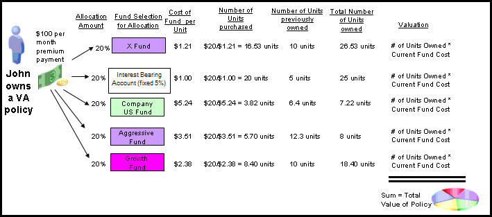

The calculation of a policy’s value is determined by the type of funds in the policy. A policy owner invests money in a policy by making deposits into specific fund(s). The value of a policy depends on the amount in the funds, the type of funds the policy owner has elected to purchase and the funds' performance in the marketplace. The policy owner may move money out of funds or transfer between funds, which will also affect the policy’s value.

Simplified Valuation Diagram
