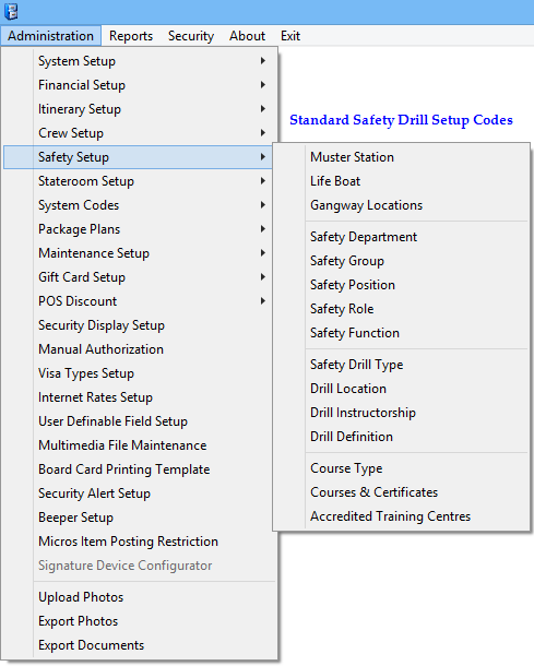

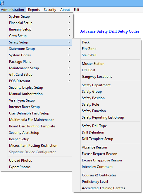

The Safety Setup contains all the codes required in Standard Safety Drill and Advance Safety Drill modes. The setup varies depending on the mode defined in Parameter group, Safety, Advance Safety Drill (0=Standard Safety Drill / 1 = Advance Safety Drill).
In the following figures, you will see the list of codes available to Standard Safety Drill and Advanced Safety Drill mode.
Below are the function codes available to Standard Safety Drill mode where Parameter, Safety, Advance Safety Drill are set to zero.
Figure 7-1 Standard Safety Drill Setup Codes
Figure 7-2 Advance Safety Drill Setup Codes
Table 7-1 Safety Setup Configuration Codes

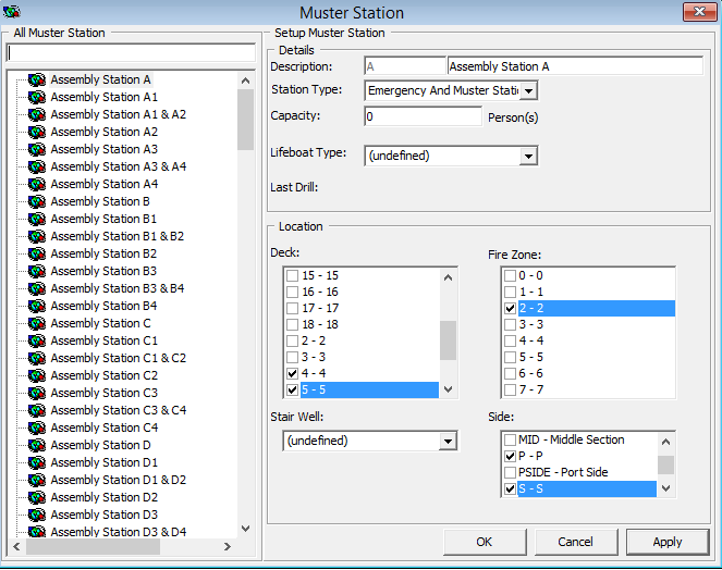

Muster Station Setup (definable label - TYP_LBL = SFTMST) |
Define the assembly location. |

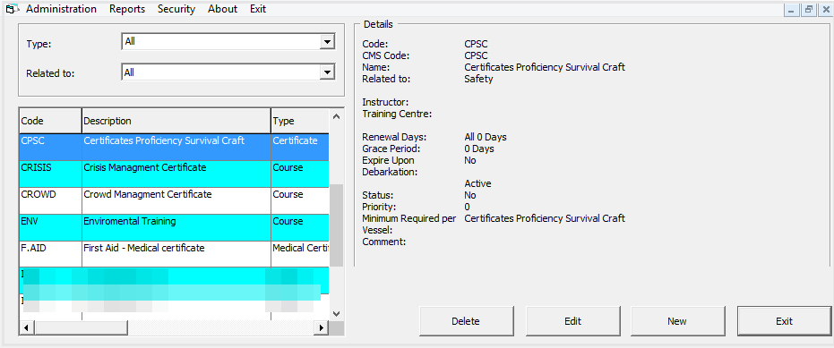

Course & Certificates |
Type of Courses and Certification required for each drill type. |

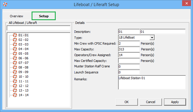

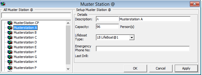

A lifeboat/liferaft has a maximum capacity and does require a number of qualified crew to handle them in the event of an emergency.
Figure 7-4 Lifeboat/Liferaft Setup
Table 7-2 Lifeboat/Liferaft Setup Field Definition
| Field Name | Description |
Description |
Short code and description of the lifeboat/liferaft. |
Type |
The type of lifeboat/liferaft. These codes are predefined and hard coded. |
Min. Crew with CPSC Required |
Minimum number of CPSC certified crew on lifeboat/liferaft. |
Max Capacity |
Maximum capacity allowed per lifeboat/liferaft. |
Operators/Crew Assigned |
Number of crew assigned to this lifeboat/raft. |
Max Certified Capacity |
Maximum certified capacity of the lifeboat/raft. |
Muster Station Raft Crane |
Raft crane the lifeboat is assigned to in Muster Station. |
Launch Sequence |
Launch sequence of the lifeboat. |
Remarks |
Additional remarks of the lifeboat. |
To set up the codes, repeat the steps in Setting Up Muster Station. You can also duplicate an existing Lifeboat code using the same steps.

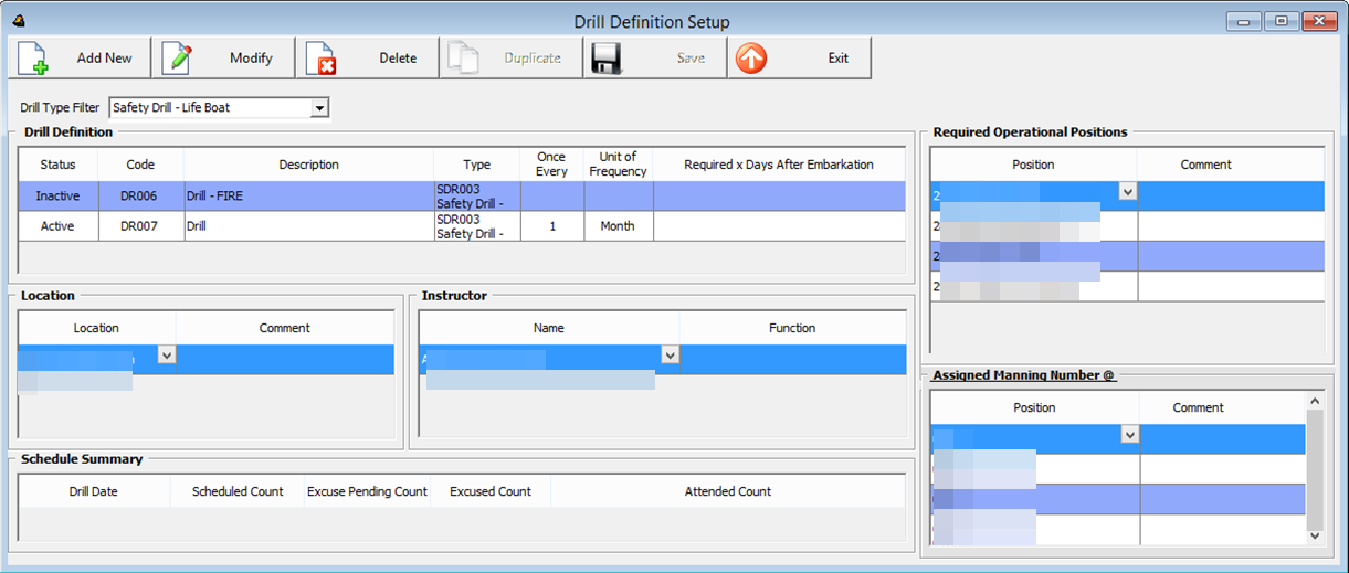

Figure 7-5 Drill Definition Setup

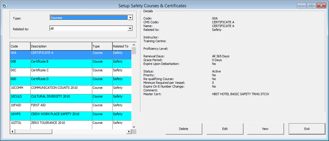

Figure 7-6 Course and Certificates Setup Window

Courses & Certificates

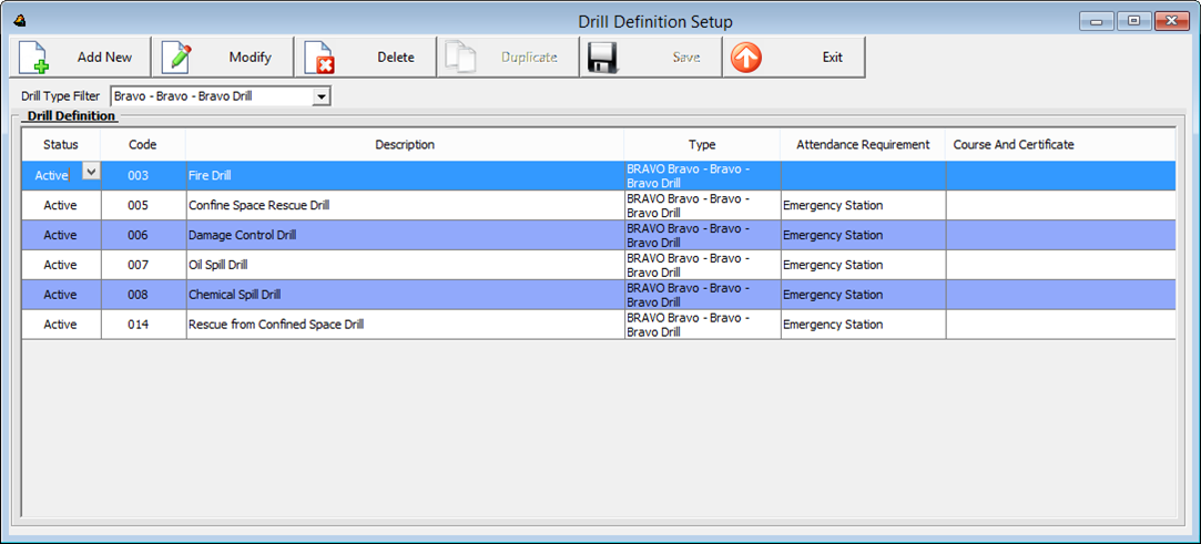

The Drill Definition code defines the type of drills, attendance requirements and identify whether drills are Course and Certificate related.
Figure 7-9 Drill Definition Window

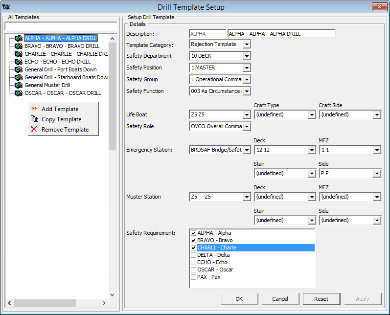

A drill template is setup to assist you in generating a crew list under Proposed Crew section using the criteria defined when creating a drill.
Figure 7-10 Drill Template Setup

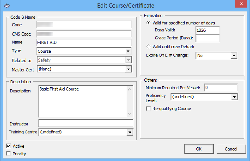

Figure 7-11 Course and Certificate Setup Advance Drill Mode
Figure 7-12 Edit Course/Certificate Window
