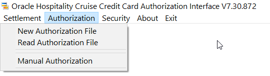

Start the Credit Card Transfer Interface, select the Authorization menu, and select the New Authorization File from the drop-down menu.
Figure 2-6 Credit Card Transfer — Authorization Tab

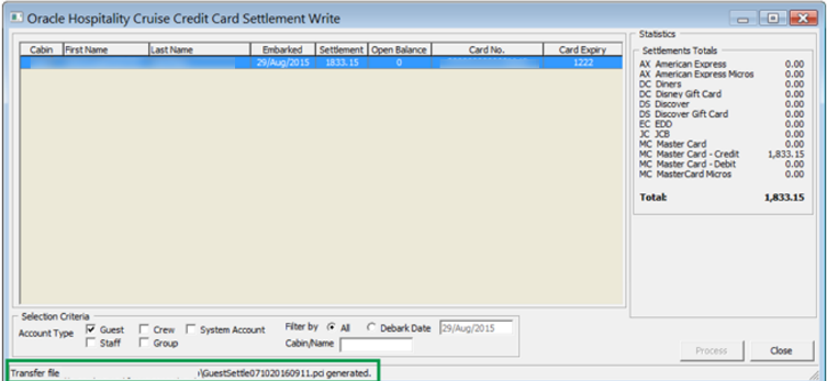

In the Credit Card Transfer Interface program, select from the drop-down menu Settlement, then New Settlement File.
Click the Process button to generate the Settlement File. After the Settlement file is created, the location of the saved file is shown on the screen.
Figure 2-13 Settlement Write Screen

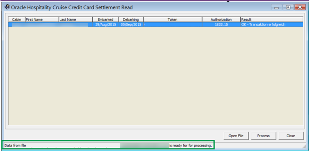

From the Settlement drop-down menu, select Read Settlement File.
On the Cruise Credit Card Settlement Read screen, click the Open File button and locate the Settlement Response file.
The status of the process is on the Settlement Read screen. Click the Process button to read and update the Settlement record.
Figure 2-14 Settlement Read Screen
