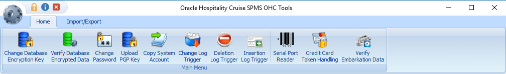

Run OHC Tools and select Upload PGP Key to upload PGP key pair for DCC handling.
Figure 6-2 OHC Tools Menu

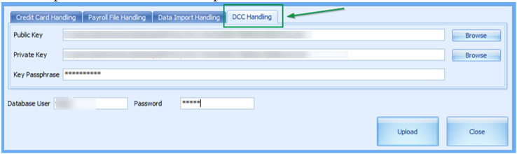

At the PGP Key Uploaded screen, navigate to the DCC handling tab.
Browse for the bank public key (file format is .pkr) under Public Key column.
Browse for the secret key (file format is .skr) under Private Key column.
Enter a Key Passphrase if the key pair is generated with a passphrase.
Enter Ship’s database username and password.
Figure 6-3 PGP Key Uploader — DCC Handling Tab
Click the Upload button to begin the key upload for DCC Handling.
Upon successful upload, the system prompts a message box. Click OK to close and exit.

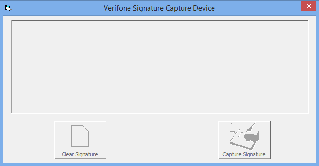

To use the Signature Capture feature, the Enable Signature Capture for Credit Card parameter and the Signature screen will prompt when the card is registered at both the Management module and the device.
Figure 6-7 Signature Screen at Module
After the guest places their signature on the device, click Enter to complete the credit card registration process. If Cancel is pressed, you will receive a No Signature Received promptly in Guest Handling screen.
A Transaction Completed screen appears on the device when the registration completes or Transaction Cancelled appears when the Cancel button is pressed.
The signature captured is shown on the signature screen. Clicking the Clear Signature button resets the signature and allows the guest to place a fresh signature.
Click the Capture Signature button to complete the credit card registration on the guest account.

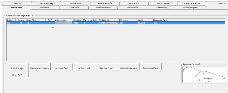

The registered credit card details are stored in the Credit Card tab of Guest handling screen, with the DCC column flagged with ‘Y’ when the card is enrolled with DCC. At the Signature Captured column, the signature captured during the credit card registration is shown. The program does not allow credit card registration without a signature when Enable Signature Capture for Credit Card parameter is enabled.
Figure 6-8 Guest Handling Credit Card Screen

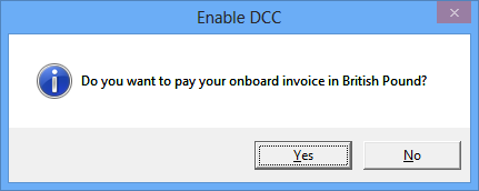

For DCC handling, the folowing message box will prompt when the ‘Card Reader Type’ is assigned to a magnetic swipe device. This shows that the credit card is eligible for DCC enrollment.
Figure 6-9 DCC Enable Screen — Manual Card Swipe
Click Yes to enroll the DCC handling or No to register the credit card without DCC handling.

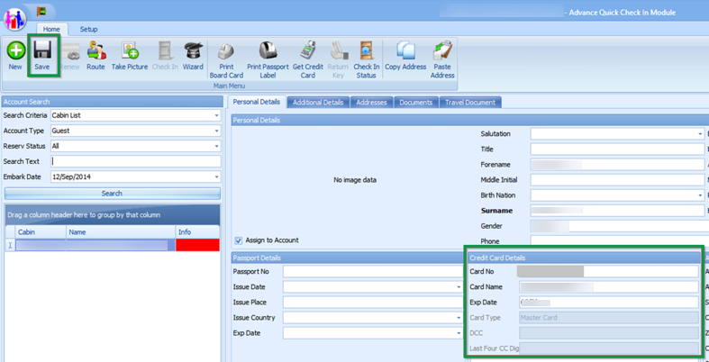

After the card is swiped, the credit card details populate in the respective field of Credit Card Details section.
Figure 6-10 AQCI Credit Card Section
Click Save to proceed with the registration. If the credit card is eligible for DCC (Dynamic Currency Conversion) enrolment, the system prompts the DCC handling message, requesting you to select the currency on the device.

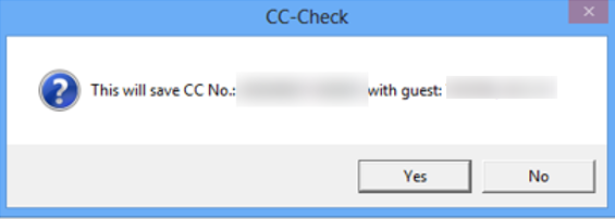

At the AQCI screen, select Yes at the confirmation to write the card details into the database.

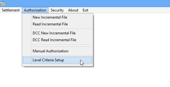

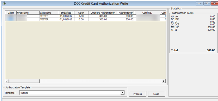

At the Authorization menu, click the DCC New Incremental File to list all the credit cards requiring authorization that are flagged with DCC= “Y” on the DCC Credit Card Authorization Write screen.
Figure 6-13 DCC Credit Card Authorization Write Screen

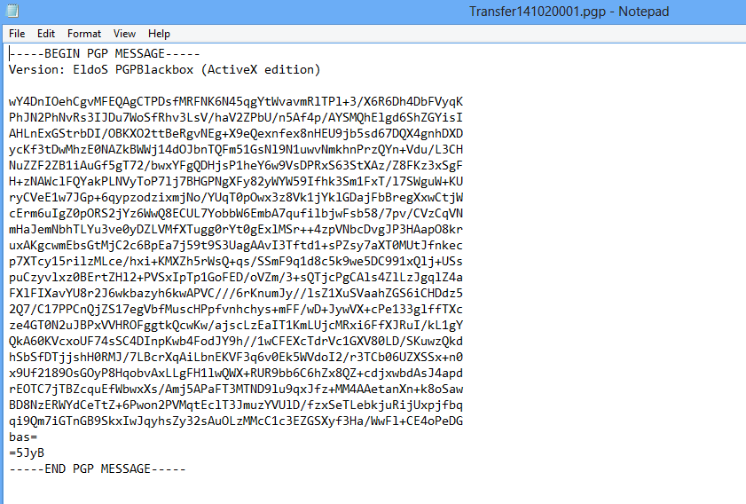

The initial authorization amount refers to Minimum Authorization in Credit Card Financial Setup.After you click the Process button, an Authorization file is generated and encrypted with a PGP key.
Figure 6-14 Sample PGP Encrypted Authorization File

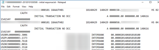

After you have obtained the response file from the merchant, at the Authorization menu, select DCC Read Increment File.
Click the Open File button and locate the response file from the merchant.

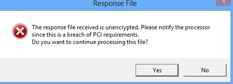

If the response file is not encrypted, an alert message box will prompt. Select the appropriate response.
Figure 6-16 Non-encrypted Response File
You will receive a batch with currency exchange rate provided by the merchant. See the figure below for sample.
Figure 6-17 Sample Response File with Currency Exchange Rate

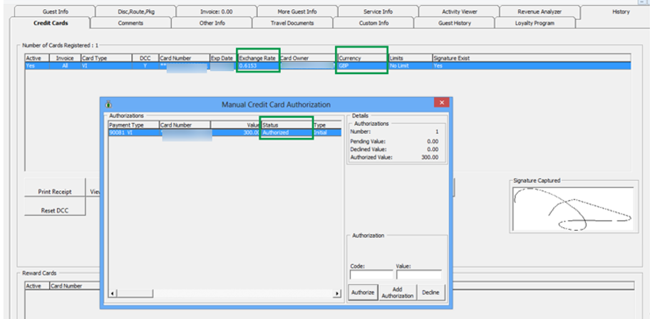

Click the Process button again to begin the process. The progress status appears on DCC Credit Card Authorization Read screen.
After the authorization completes, the authorization status in Guest Handling, Credit Card tab, View Authorization is updated to Authorized, with the exchange rate provided in the response file. The exchange rate is also stored in the DCC table.
Figure 6-19 OHC Management — Credit Card Tab
At the DCC Credit Card Authorization Write screen, a converted (Onboard Authorization * Currency Exchange Rate) pending authorization transaction is listed. Click the Process button to write the authorization transactions into the file.
Figure 6-20 DCC Credit Card Authorization Write
In the Guest Handling, Credit Card, View Authorization screen, the status of the unconverted incremental authorization amount is listed as Outstanding status.
To change the status to Authorize, see Reading an Authorization.
Figure 6-21 View Authorization with Incremental Authorization — Pending Approval
An Authorization Template is used to obtain additional authorization amounts. The template only applies to Incremental Authorization. Use the following steps to set up the Authorization Template.
At the Authorization menu, select Level Criteria Setupfrom the drop-down list.
Figure 6-22 OHC Credit Card Transfer — Authorization

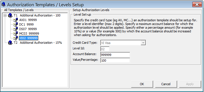

Configure the Authorization template in value amount. For example, see Figure 6–22 — Sample Level Criteria Setup in Value.
Define the credit card type (VI Visa).
Define the Level ID (02)
Define the Account Balance (999999)
Define the Value/Percentage (100)
Figure 6-23 Sample Level Criteria Setup in Value

Figure 6-25 DCC Credit Card Authorization Write with Authorization Template

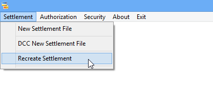

After a settlement is performed on a guest account, the settlement transaction requiring approval becomes listed under DCC New Settlement file.
Figure 6-26 OHC Credit Card Transfer — Settlement Menu
At the Settlement Menu, DCC New Settlement screen, the settlement transaction is flagged with DCC, and the amount shown is converted using the exchange rate from the DCC table. (Onboard Settlement * Currency Exchange Rate).
Figure 6-27 DCC Credit Card Settlement Write Screen (With Settlement Transaction)
Click the Process button to write the settlement transaction into the settlement file.
The NCL Credit Card format does not read the settlement response file. Hence the CCT_STATUS is updated to ‘1’ upon generation of the settlement file.Click the Recreate Settlement from the Settlement menu.
Figure 6-28 Settlement Menu — Recreate Settlement
At the Restore Settlement Data screen, select a Transfer Date to recreate and click Process.
Figure 6-29 OHC Credit Card Transfer — Recreate Settlement Screen
At the DCC Credit Card Settlement Write screen, select the Recreate Settlement check box to list the transaction.
Figure 6-30 DCC Credit Card Settlement Write Screen — Recreate Settlement Checkbox
Transfer161108006.pgp
Transfer<DATE><SEQ#>.pgp
