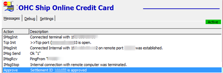

OHC Transfer Setup
The OHC Ship Transfer Interface is an interface that sends credit card payments from SPMS to Paypoint Payment Gateway for credit card payments to be authorized using interface program OHC Ship Transf.exe
Configure OHC Ship Transfer

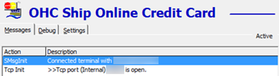

  1. Start OHC Ship Transf.exe and navigate to the Settings tab.
  2. Enter the Shore Remote Host IP address. The shore remote host is the Paypoint Terminal IP address.
    Figure 5-2 OHC Ship Transfer — Setting Screen
    This figure shows the OHC Ship Transfer — Setting Screen
  3. The connection is shown in Message tab per below figure.
Figure 5-3 OHC Ship Transfer — Message Screen
This figure shows the OHC Ship Transfer — Message Screen

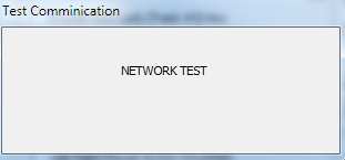

  3. After the Save PED IP button is clicked, a Test Communication between the Management module and the device shall commence.
    Figure 5-6 Management — Test Communication — In Progress
    This figure shows the Management — Test Communication — In Progress

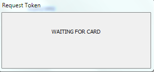

    Figure 5-7 Management — Get Credit Card
    This figure shows the Management — Get Credit Card
  4. When you click the Get Credit Card button at Guest Handling, the program communicates with the device and prompts to insert/swipe a credit card.

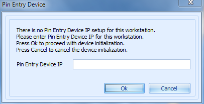

Setting up Device in Advance Quick Check-In module
  1. At the start up the AQCI module and if the module has never been connected/configured with a card device, the Pin Entry Device screen without an IP address prompts ‘Enter the device’s IP address’ and click OK.
    Figure 5-8 Advance QCI — Pin Entry Device
    This figure shows the Advance QCI — Pin Entry Device

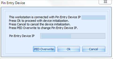

  2. If AQCI has been connected to the card device before, the previous IP address is stored in Pin Entry Device. Click the PED Overwrite button to change the IP address if the device’s IP is different.
    Figure 5-9 Advance QCI — Pin Entry Device — with IP address
    This figure shows the Advance QCI — Pin Entry Device — with IP address

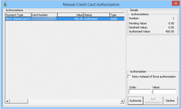

Viewing Authorization Amount in Management module
  1. Log in to Management module and navigate to Guest Handling screen.
  2. At the Search Panel, browse the guest account.
  3. Navigate to the Credit Card tab of the guest account. The registered card status should be in Inactive mode.
    Figure 5-11 Management Credit Card
    This figure shows the Management Credit Card
  4. To display the initial authorization, select the credit card and click View Authorization.
  5. The Authorized Value shown in View Authorization is the last authorization amount, excluding the amount from Direct Sales.
    Figure 5-12 Management View Authorization
    This figure shows the Management View Authorization
