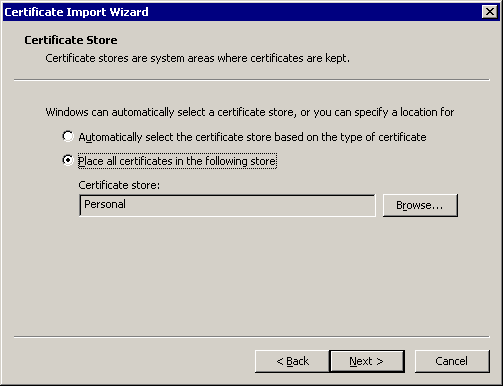

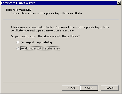

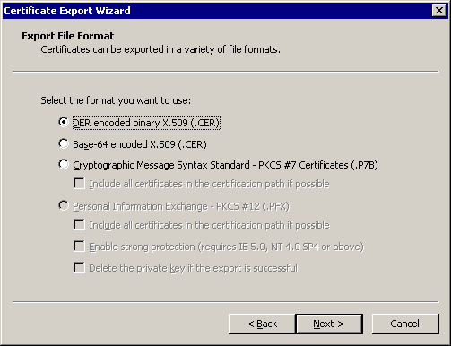

You can also create the PFX file on any machine and import it into the local machine. See Exporting Shipboard Keypair and Importing Shipboard Keypair (Once Per Ship BIZ02 Engine) for steps to export/import a keypair.

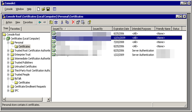

When opening the MMC for “Local Computer” certificates, you should see something similar to Figure 1–1 Console Root Window below. Notice the Certificates (Local Computer) / Personal / Certificates is showing the new certificate.
Figure 1-1 Console Root Window
When opening up the details of the certificate, you can see at the bottom, “You have a private key that corresponds to this certificate.” This means the OS Key Container public/private keypair is associated with the certificate in the Certificate Store, and you can decrypt items as they come into this “BizTalk” Node.

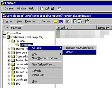

Console Root\Certificates (Local Computer), right-click the Other People folder.
