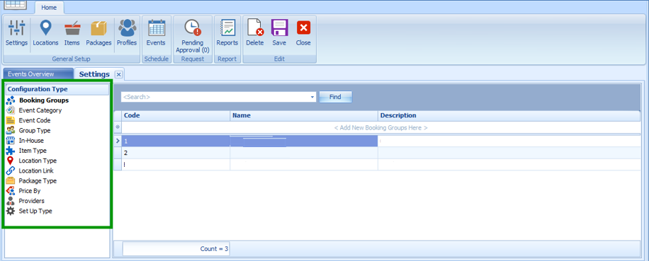

Event Settings Overview
Figure 1-1 System Setup
This figure shows the Configuration Type in System Setup
The Event Settings Overview is the main configuration window for setting up parameters and settings for furniture fitting, sound systems, utensils, and other equipment needed by the ship operator to organize an event. The Configuration Type features Booking Groups, Event Category, Event Code, Group Type, In-House, Item Type, Location Type, Location Link, Package Type, Price By, Providers, and Set Up Type Functions.
Configuration Type
Configuration Type contains all the general settings used in the Event module and are described below:
  • Booking Group: The Booking Group holds the security codes that determine who is allowed to book or change an event location.
  • Event Category: The Event Category code is used to categorize the type of event and is mainly used in report printing.
  • Event Code: The Event Code holds the Priced By, Event Category, and Event Name that enables a quick entry of an Event on the Event Detail Form.
  • Group Type: The Group Type code defines the specific type of Group, which vary from one Cruise Line to another.
  • In-House: The In-House code defines an event category associated with the department or area for a non-group event.
  • Item Type: The Item Type code defines the items by groups, for example, cutleries, linens, furniture and much more.
  • Location Link: The Location Link holds a generic code for a location that groups a few locations, to facilitate the copying of templates from one ship to another.
  • Package Type: The Package Type defines the packages used to help find a specific package.
  • Price By: This stores the price by codes available to the cruise liner. See the table below:
    Table 1-1 Price by Configuration Type
    Field Name Description
    C
    Consumption
    F
    Fixed
    A
    Fixed Guests
    R
    Fixed Cabins
    L
    Calculated Guests
    S
    Calculated Cabins
  • Providers: The Providers code defines the shipboard group responsible for fulfilling items required by the event.
  • Setup Type: The Setup Type defines the available seating or set up for the location. For example, U-Shape seating, Theatre, Pool Party, Conference, and others.

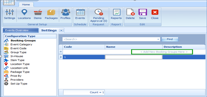

Adding New Configuration Codes
Figure 1-2 New Configuration Codes Window
This figure shows the New Configuration Codes Window.
  1. From the ribbon bar General Setup group, click Settings and then navigate to Configuration Type to select the configuration type to add.
  2. The Code field is mandatory. Insert the code, name, and description in the field below the Search bar, and then click Save to save the record.
  3. When you click Save on the input field when the code is empty, the system prompts a warning message:Please enter a unique code. Do you want to correct the value?
  4. Click Yes and insert the code accordingly.
  5. Click Save to save the record.

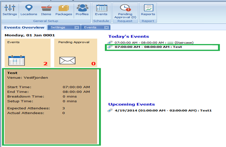

Events Overview
Figure 1-3 Events Overview
This figure shows the Events Overview window
The Events Overview shows the summary of events for today and upcoming events with the summary of total events pending approval. Click the functions available on the window to view additional event information details.

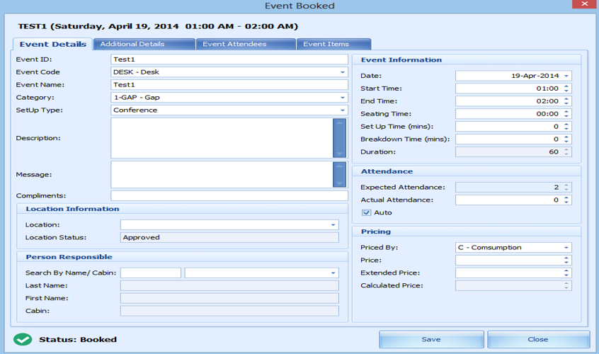

Double-clicking on any available event in the Today’s Events or Upcoming Events section launches the Event Booked window.
Figure 1-4 Event Booked
This figure shows the Event Booked window

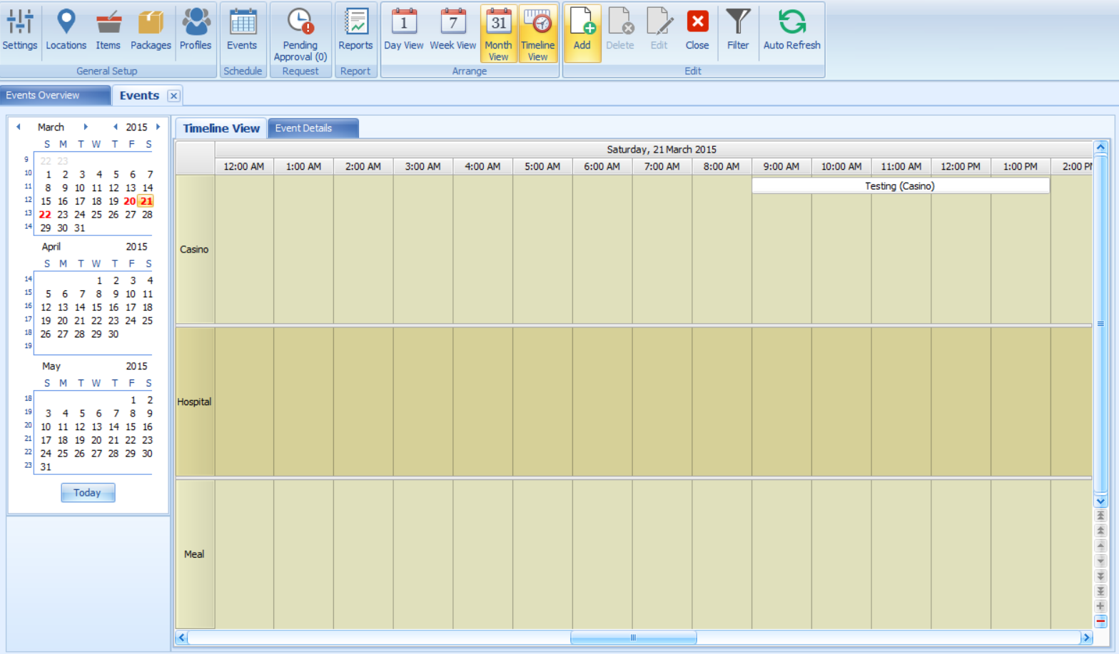

Clicking the number of events in the Events section displays the event in Date, Week, Month or Timeline grid. You can also add or edit an event from this window. See Event Management section for steps to add, delete, and edit an event.
Figure 1-5 Events —Timeline View
This figure shows the Events in Timeline View.

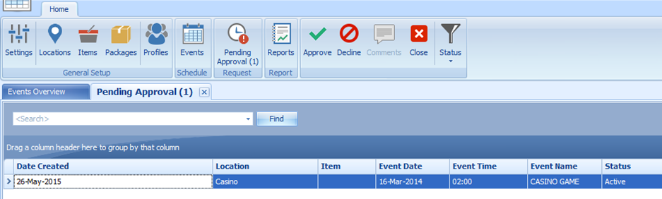

Clicking the number in the Pending Approval section displays the list of events that are waiting to be approved.
Figure 1-6 Event - Pending Approval Tab
This figure shows the Event - Pending Approval Tab

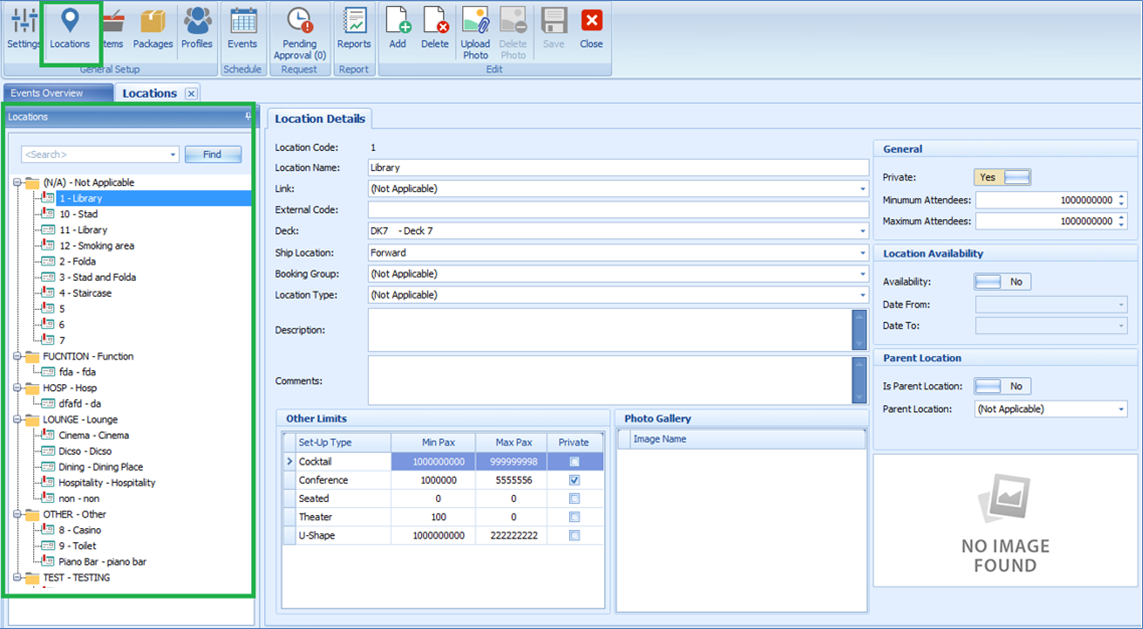

Locations Setup
Figure 1-7 Locations Tab
This figure shows the Locations Tab
The Locations Setup is accessible through the General Setup, Locations icon on the ribbon bar. It shows the location available for an event booking and is grouped by location category.
In each location, you can define the location details, determine the seating style suitable for that location, attach a photo gallery and set the minimum/maximum person allowed. All of these settings are linked to codes configured in Event Settings Overview.
Adding New Location
  1. Click Location from the General Setup group.
  2. On the Location tab, the sub-locations are listed in a container view. Click the + button to expand the container list.
  3. To add a new location, select the main location, and then click Add on the ribbon bar.
  4. In the Location Details section, enter all the necessary fields. The Location Code, Location Name, Booking Group, and Location Type are mandatory fields and the system prompts an error when the field is empty.
  5. Navigate to the Other Limits section, select the Set-Up Type suitable for this location, enter the minimum/maximum number of person allowed for each seating type and select the Private check box for events that are held privately.
  6. Click the Upload Photo icon on the ribbon bar to attach images of the location to the Photo Gallery section.
  7. At the General section, insert the minimum/maximum number of attendees allowed using the arrow up/down key. Turning the Private toggle to Yes indicates that the location use with other events at the same time.
  8. At the Location Availability section, the availability is default to Yes. Sliding it to No makes the location unavailable. Select the available date from/to using the date editor.
  9. At the Parent Location section, select the Parent Location from the drop-down list if it is a sub-location. Sliding the toggle to Yes makes the location a Parent Location.
  10. Click Save on the ribbon bar to save the location.

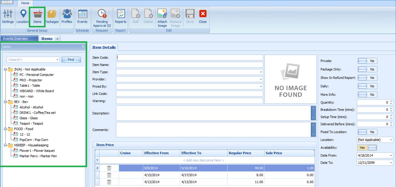

Items Setup
Figure 1-8 Items Tab
This figure shows the Items Tab
The Items Setup allows you to define every item used for an event from the type of cutleries, flower arrangements, furniture and others. Multiple prices per item based on a date period is allowed, enabling a selection based om the cruise selection and Effective From and Effective To dates.

Adding an Item/Price
  1. Under the General Setup group on the ribbon bar, click Item Setup. The Item Code, Item Name, Item Type, Provider, and Priced By are mandatory fields. The system prompts an error if one of the fields is empty.
  2. On the left of the Items tab, expand the tree view and then click Add to add a new item.
  3. In the Item Details section, enter all the necessary fields.
  4. Navigate to the Item Price section, select the cruise, select the effective date from/to from the drop-down list and insert the regular price and sale price. Overlapping dates are not permissible in item price setup. For an item price changed that is already booked for the current system date or future event, price changes apply to these events also.
  5. It is not permissible to set up item prices with an overlapping date. If the input item price has an invalid date, the system prompts a Confirmation prompt. Click Yes to edit or No to exit without making any changes.
  6. Various controls are available and switching these controls to Yes does affect the Item Price behavior.
  7. Once all the required information is entered, click Save to save the changes.
