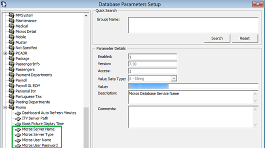

  1. In the Database Parameters Setup window, expand the Promo group.
  2. Enter these value in the respective parameter fields:
    • MICROS Server Name- Database Net Service name
    • MICROS Server Type- Set value of ‘0’ for Oracle Server
    • MICROS User Name- Username to login into database.
    • MICROS Password- Password to login into database.
  3. If the parameter entered is incorrect, the system will prompt an error “MICROS Server is offline, MICROS setup will be disabled”

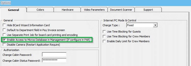

  4. Navigate to the Management module and select Options, General tab
  5. Select Enable Access to MICROS Database in Management, and click Apply to save.

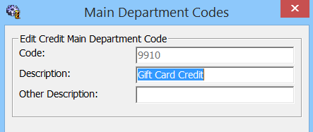

Setting up Credit Department Code
Log in to the Administration module and select Financial Setup, Department Setup from the drop-down list.
  1. Click New to create a Main Department code.
    This figure shows the Main Credit Department Code Setup

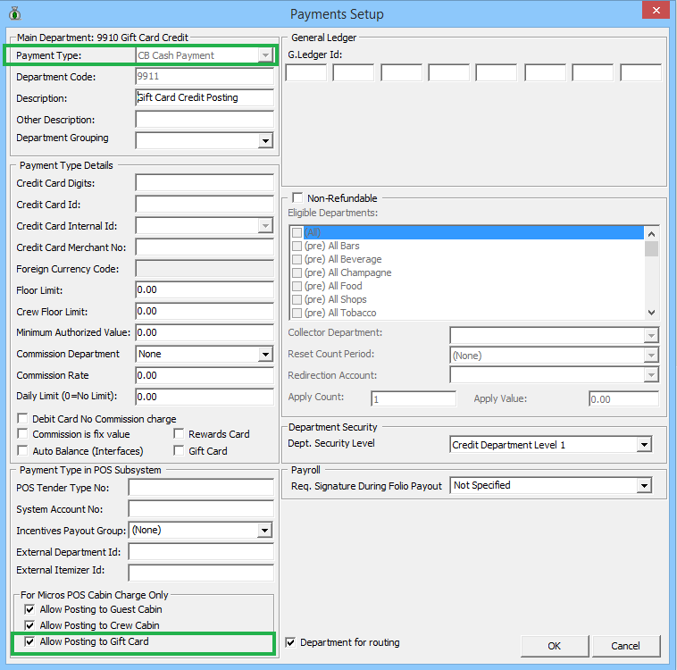

  3. In the Payment Setup window, complete the following:
    1. Select the Payment Type as CB Cash Payment.
    2. Insert a unique Department Code.
    3. Insert the sub-department Description.
    4. Select the Allow Posting to Gift Card check box to enable Gift Card posting in MICROS outlets.

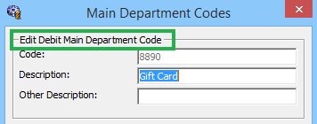

Setting up Debit Department Code
  1. Select Financial Setup, Department Setup from the drop-down list.
    Figure 1-4 Main Debit Department Code Setup
    This figure shows the Main Debit Department Code Setup

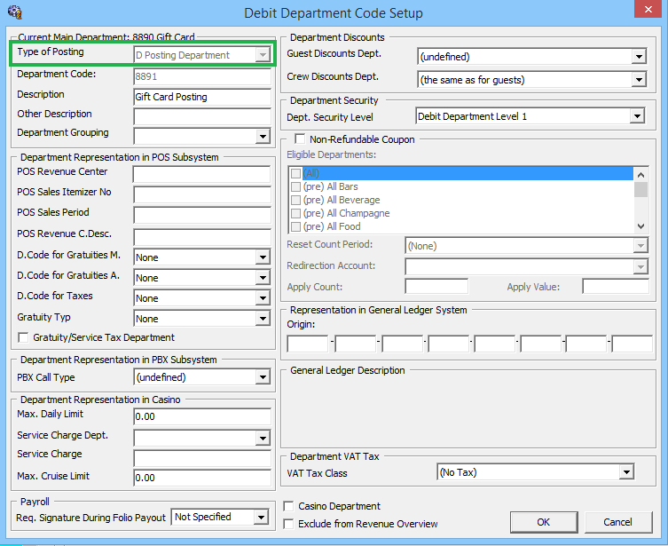

  2. In the Department Code Setup window, click New to create a Sub-Department code.
    Figure 1-5 Sub Debit Department Code Setup
    This figure shows the Sub Debit Department Code Setup
  3. In the Debit Department Code setup window, select the Type of Posting as Posting Department, define a unique Department Code, and insert the sub-department Description.

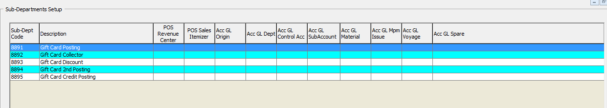

  4. Repeat the above setup for the following sub departments:
    Table 1-1 Gift Card Sub Department List
    Sub Department Description
    Gift Card Posting
    Use for posting when selling Gift Card.
    Gift Card Collector
    Use for unused balance posting. Example: Gift Card expired with remaining balance.
    Gift Card Discount
    Use for posting of difference amount between Gift Card face value and selling amount.
    Gift Card Second Posting
    Use for split posting when selling Gift Card.
    Gift Card Credit Posting
    Use for Gift Card credit posting.
Figure 1-6 Gift Card Sub Debit Department Code Setup
This figure shows the Gift Card Sub Debit Department Code Setup

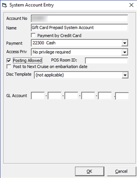

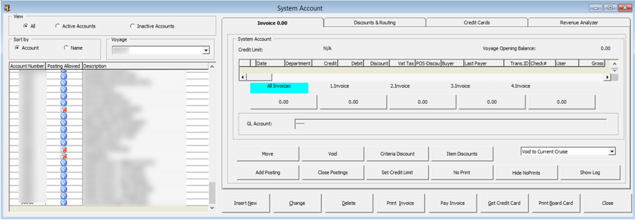

  1. Launch the Management module, and select Cashier, System Accounts from the drop-down menu.
  2. In the System Account window, select Insert New.
    Figure 1-8 System Account Entry Form
    This figure shows the System Account Window
  3. In the System Account Entry window, insert a unique System Account number, Name, and select the default payment department, or create a different credit department to cater for pre-paid account balancing, and check the Posting Allowed check box.
  4. Repeat the above setup to create the following System Account.
Table 1-2 Gift Card System Accounts
System Account Description
Gift Card Prepaid System Account
Use for pre-sold Gift Card posting apply when importing Gift Card records from Data Import / DGS ResOnline)
Gift Card Discount System Account
Use for posting of difference amount between promotional value of Gift Card and prepaid amount (Face value — Selling Price)

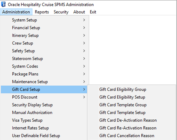

Gift Card Setup
Create a Gift Card product based on the following entitlement and set it up in the Administration module, Gift Card Setup.
  • Gift Card Eligibility Group
  • Gift Card Eligibility Setup
  • Gift Card Template Group
  • Gift Card Template Setup
  • Gift Card De-Activation Reason
  • Gift Card Re-Activation Reason
  • Gift Card Cancellation Reason
Figure 1-9 Gift Card Setup
This figure shows the Gift Card Setup

  1. From the Administration, Gift Card Setup menu, select Gift Card Eligibility Group.
  2. In the Gift Card Eligibility Group Setup window, right-click and select Add New.

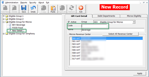

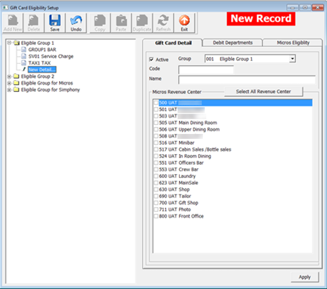

  2. On the Gift Card Eligibility Setup window ribbon bar, click Add New to add a new record.
    Figure 1-12 Gift Card Eligibility Setup
    This figure shows the Gift Card Eligibility Setup

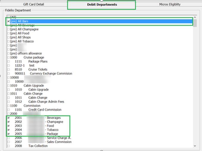

  3. On the Gift Card Detail tab, select the Group from the drop-down list. Insert a unique Gift Card code and name.
  4. Select the applicable MICROS Revenue Centre by selecting the respective check box.
  5. Navigate to the Debit Department tab and select the eligible SPMS Posting Departments, by selecting the Main Department. This will also include all the sub-department codes.
    Figure 1-13 Gift Card Eligibility Debit Department Setup
    This figure shows the Gift Card Eligibility Debit Department Setup
  6. Click Save on the ribbon bar to save the record.

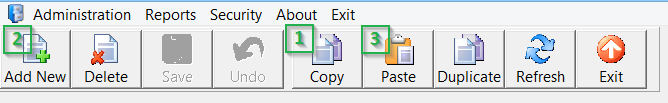

Copying Eligibility Setup
An existing eligibility details can be copied to a new record using the simple steps.
Figure 1-14 Steps to Perform Copy/Paste
Steps to Perform Copy & Paste
  1. From the Eligibility Group tree view, select the code to copy and then click Copy on the ribbon bar.
  2. Click Add New, followed by Paste from the ribbon bar.
  3. Insert a unique code and make the necessary changes, if any, then click Apply.
  4. Click Save to save the record.

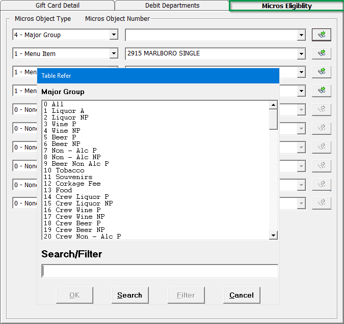

Adding MICROS Sales Itemizer to GC Eligibility Setup
  1. From the GC Eligibility Setup form, select the Gift Card code.
  2. Navigate to the MICROS Eligibility tab and select the MICROS Object Type from the drop-down list.
  3. Click the object drop-down list to select the object, or use the search function by clicking the Binocular icon to open the MICROS Object Number list.
Figure 1-16 MICROS Object Number List
This figure shows the MICROS Object Number List
Each GC can have up to 10 different MICROS family groups and are eligible to all outlets for all departments.

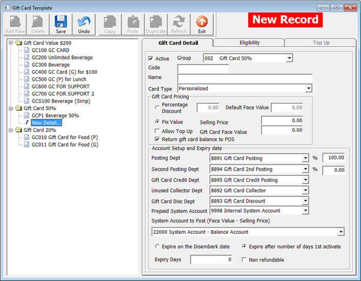

The Gift Card Template allows you to predefine the Gift Card value, selling price and eligibility within a template, for use during the Gift card sale.

  1. From the Administration, Gift Card Setup menu, select Gift Card Template.
  2. In the Gift Card Template Setup window, click Add New on the ribbon bar.
  3. Navigate to the Gift Card detail tab and select the Group from the drop-down list.
  4. Insert a unique code, nameand select the Card Type from the drop-down list.
  5. In the Gift Card Pricing section, select the pricing method from the drop-down list.
  6. Select the Allow Gift Card Top Up, if applicable and return Gift Card Balance to POS (MICROS) for GC balance to print on bill image.
  7. In the Account Setup and Expiry date section, select the respective Posting Department from the drop-down list.

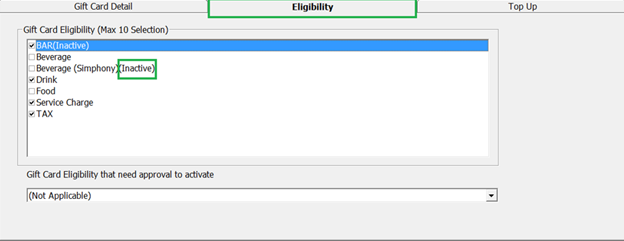

  8. Next, navigate to the Eligibility tab and select the eligible department group and the maximum allowed (10 department groups). An inactive department group is indicated with (Inactive).
  9. In the Gift Card Eligibility that needs approval to activate section, select the eligibility activation approval from the drop-down list.
    Figure 1-17 Gift Card Template Eligibility Setup
    This figure shows the Gift Card Template Eligibility Setup
    This option is used in the Management module, Gift Card Handling, Special Department / Family group when it is set to active.

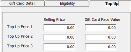

  10. Navigate to Top Up tab and insert the Selling Price and Gift Card Face Value.
    Figure 1-18 Gift Card Top Up Setup
    This figure shows the Gift Card Top Up Setup
    This option is available when ‘Allow Top Up’ is enable in Gift Card Pricing section.
