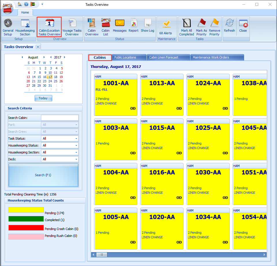

The Cabin/Location Task Overview not only provides a view of the overall cabin status, it also allows you to update the cabin clean status and the task status. It comprises the following tabs: Cabins, Public Locations, Cabin Linen Forecast and Maintenance Work Orders, with the Cabins tab being the main tab. In this window, you can search for a cabin by task status, housekeeping status, housekeeping section, deck and the total counts.
Figure 3-1 Cabin Tasks Overview
The figure shows the Cabin Tasks Overview window.
Above the Housekeeping Status Total Counts section, the Total Pending Cleaning Time (m) sums up all the pending task durations based on the search criteria and time shown in minutes.

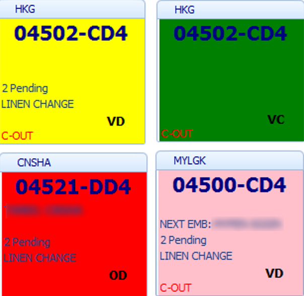

In the Cabins tab, the cabins are shown in the grid layout with their status and number of pending tasks. See the following table for an explanation of the fields.
Figure 3-2 Pending Cabin Task
The figure shows the Pending Cabin Task display.
Table 3-1 Pending Cabin Task Labels Definition
Label Definition
Yellow
Cabin with pending task.
Red
Crash Cabin
Pink
Rush Cabin
Green
Cabin with completed task.
HKG
Indicates the port code where the tasks is generated, based on the arrival port setup in Cruise Setup.
04502-CD2
Indicates the cabin number followed by the cabin category code.
NEXT EMB: MYPEN-SGSIN
Indicates the next embarkation port and disembarkation port for the expected checked-in guest
2 Pending
Indicates the number of pending task for the cabin.
LINEN CHANGE
Indicates the cabin requires a linen change
VD
Indicates the cabin housekeeping status: VD for Vacant Dirty and OD for Occupied Dirty.
C-OUT
Indicates the passenger has checked-out from the cabin.

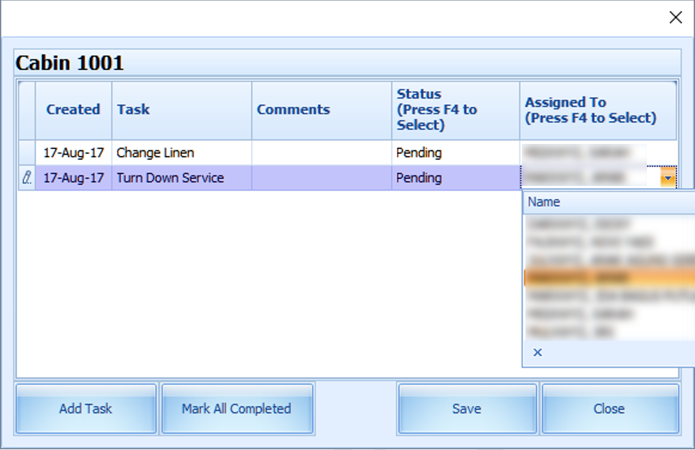

Apart from the system-generated task, additional tasks can be added to the cabin from the Cabins Overview window using the following steps:
  1. At the Home tab, click Cabin/Location Tasks Overview.
  2. Double-click the cabin box to open the cabin detail window. You can insert a comment, edit the status or assign the task to a housekeeper using an inline edit feature by highlighting the task and selecting it from the drop-down list.
    Figure 3-3 Cabin’s Task Details
    The figure shows the Cabin Detail window.

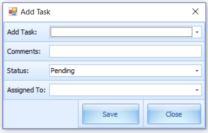

  3. Click Add Task, fill in the Add Task form, and click Save.
    Figure 3-4 Add Cabin Task
    The figure shows the Add Task form.
  4. If the housekeeping staff member has finished all assigned tasks for a cabin, instead of updating the task individually, the staff member can click the Mark All Completed to set all tasks as complete.
    If the logged in user is not associated to a crew ID or linked to User Security rights and attempts to mark the task as complete, the system returns a warning message Task updates have failed, please check the log activity entries for error.

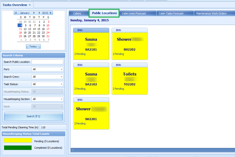

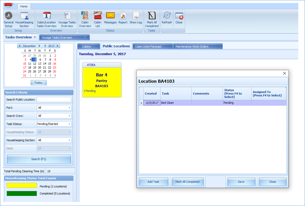

Public Location Task Overview
The Public Location Task Overview feature works the same as the Cabin Task Overview. Use the following steps to view the public location task created in the task overview:

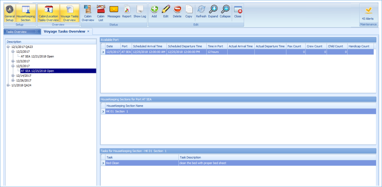

  1. In the Voyage Tasks Overview, select a date and click Add to add a task to a housekeeping section.
    Figure 3-6 Select the Date
    The figure shows the Voyage Tasks Overview window, where you can select a date.
  2. Change the system date to the date of the task. The task will auto create in Public Locations.
    Figure 3-7 Location Created
    The figure shows the Voyage Tasks Overview window, with a created location.
  3. At the Cabin/Location Tasks Overview, select the Public Locations tab.
  4. To edit or change the task status, follow the steps detailed in the Cabin Task Overview.
    Figure 3-8 Location Task Overview
    The figure shows the Location Task Overview window.
  5. The following screen describes Pending Location task label:
    Figure 3-9 Pending Location Task
    The figure shows a Pending Location Task displayed in yellow.
Table 3-2 Pending Location Task Labels Definition
Label Definition
BNN
Indicates the port code where the tasks are generated based on Voyage Task Overview Setup
Shower Female
Indicates the Public Location description where the tasks are supposed to be carried out by housekeeper
SH2201
Indicates the Public Location code
2 Pending
Indicates the number of pending tasks for the Public Location

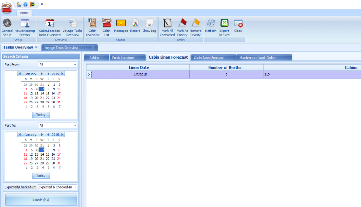

The Cabin Linen Forecast provides an overview of all cabins that are currently checked-in, expected to arrive or checked-out, that require a linen change.
During the System Date Change, the system generates a forecast based on the parameters defined in the database related to the Cabin Linen change. With this, the housekeeper can plan for the linen turnover.
For example, a guest in cabin 1234 checked-in on May 13 and is expected to checkout on May 20. During the system date change on May 16 being the 4th day after check-in and based on parameter “X day to Change Linen = 3 days”, this cabin will be listed in the Cabin Linen Forecast list.
  1. From the Cabin/Location Tasks Overview, select the Cabin Linen Forecast tab. The cabins with linen change are listed in the Cabin Linen Forecast tab.
    Figure 3-10 Cabin Linen Forecast
    The figure shows the Cabin Linen Forecast tab.
  2. You can search the Cabin Linen Forecast by date range or the reservation status using the Search Criteria filter.

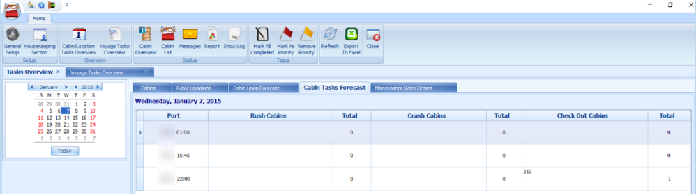

Cabin Tasks Forecast
The system can generate a Cabin Task Forecast based on the available port of the selected date.
See System Parameters on how to set up the following parameters to work with the Cabin Linen Forecast.
  1. Minimum number of days onboard for Linen Change = 7 days
  2. X day Before Check-Out To Skip Linen Change = 1 days
  3. X day to Change Linen = 3 days
For example, the guest in cabin 04500 checked-in on May 13, and is expected to check out on May 20. When system date changed to May 16th, which is the 4th day (based on parameter X day to Change Linen = 3 days) after check-in, the system will show that cabin 04500 needs a linen change in the Cabin Linen Forecast list.
Figure 3-11 Cabin Tasks Forecast
The figure shows the Cabin Tasks Forecast tab.
The screen above shows the cabin number and total number of Rush Cabins, Crash Cabins and Checked Out cabins by port respectively.

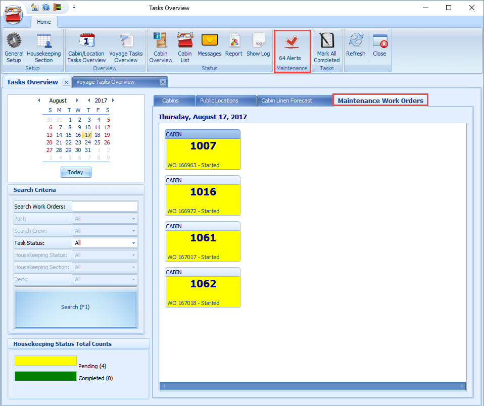

The Maintenance Task created in the Maintenance module is linked and shown in the Maintenance Works Orders tab. This enables the housekeeper to monitor and follow up on the progress of the maintenance tasks.
Figure 3-12 Maintenance Work Orders
The figure shows the Maintenance Work Orders tab.

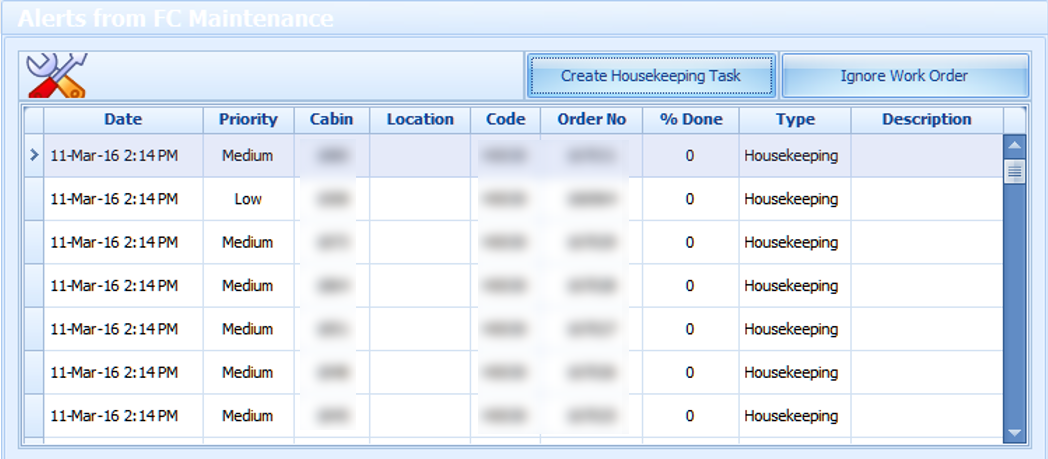

  • When creating a new task in the Maintenance module, you can opt to flag the Inform Housekeeping option in the Work Order Details window to send an alert to the housekeeper.
  • The system checks for any maintenance tasks created every 15 minutes. Once it detects a task, it sets the Alerts icon on the ribbon bar to blink.
  • Click the Alert option open the Alerts from Maintenance window.
    Figure 3-13 Alert from Maintenance Module
    The figure shows the Alerts from Maintenance window.
  • Select a line item and click the Create Housekeeping Task to create a task in the Maintenance Work Orders tab. If you click the Ignore Work Order, it will ignore the work order and delete it from the Alerts from Maintenance window.
  • To mark the work order task as complete, select a work order and click Mark All Completed on the ribbon bar. This changes the color to green.
