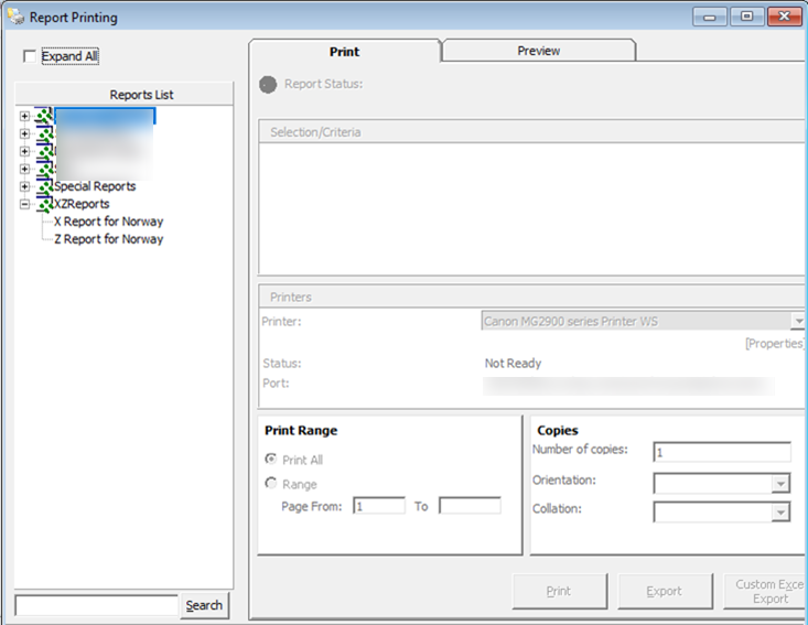

The X and Z report are generated from Administration, Reports, Reports module.
For X and Z Report Structure, see X and Z Report Structure in the Appendix section.
Figure 6-1 Report Printing Function
