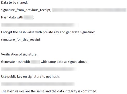

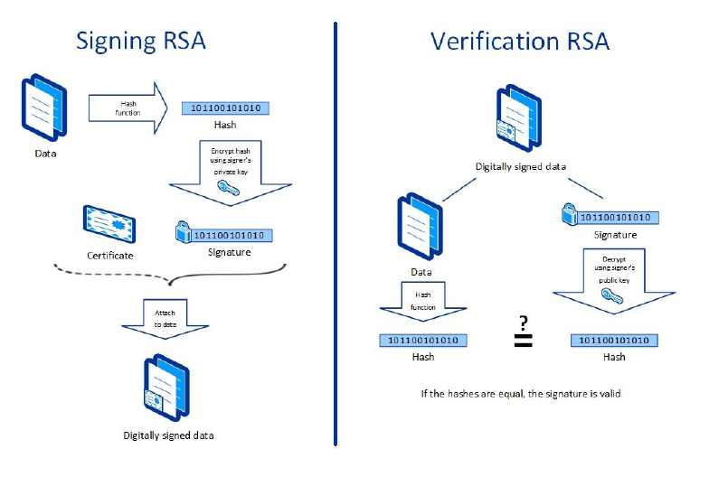

Digital Signature
Digital signature in our context here is the asymmetrically encrypted hash of the Transaction Data. Briefly, the digital signature is defined as:
<Transactiondatahash> = Sha-1(<Transactiondata>) <Digitalsignature> = Rsa-1024(<Transactiondatahash >) Using The Private Key
Signing and Verification Process
Figure -2 Signing and Verification Process
Figure -3 Sample Signed and Verified Certificate

Get Transaction Data from e-journal xml file.
Ensure that you have the public key in PEM format. You need this to verify the signature.
Save the transaction data in message.txt file.
Save the signature in signature.txt file.
Go to Windows search and type “git bash” to start the command line tool.
Extract the public key from the certificate.
$ openssl x509 -pubkey -noout -in <certificate_name> > pubkey.pem
Now, decode the base64 encoded signature and store it in “<signature_name>.txt” file.
$ cat signature.txt| base64 -d > <signature_name>.txt
Finally, verify the signature.
$ openssl dgst -<name> -verify pubkey.pem -signature <signature_name>.txt message.txt
