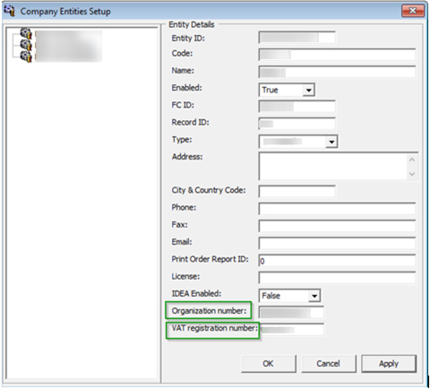

You must set up the Company entities for the company information to be shown on the report.
Figure 2-1 Company Entities Setup
Log in to the Administration module and select Administration, System Setup.
Select Company Entities Setup and enter the value for two new entities as follows:
Organization number: Organization number from Register Centre or other relevant government authority.
VAT registration number: The Company’s Value Added Tax (VAT) number. This is the unique number from the Register Centre.

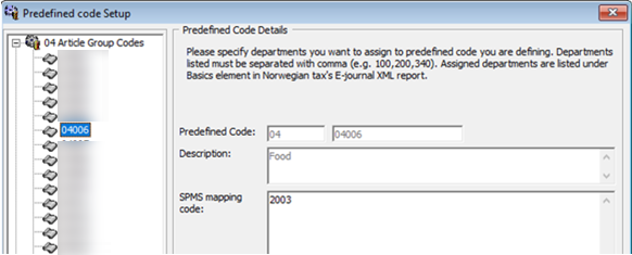

Standard Predefined Code 04 — Article Group/Department Codes
Figure 2-2 Sample Predefined Article Group
This code is used to configure the system debit department code. In the screen example above (Figure 2–2), the system debit department code 2003 for food is mapped to standard predefined code 04 and predefined ID 04006.
The report displays this standard predefined code in <basicType> and <predefinedBasicID> under <basics> element.

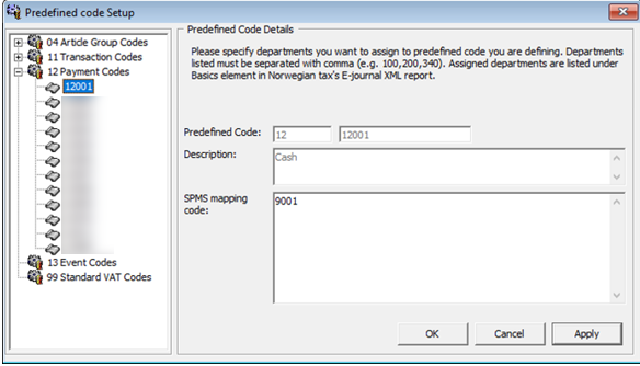

Standard Predefined Code 12 — Payment Codes
Figure 2-4 Sample Predefined Payment Codes
This code is used to configure the system credit department code or payment code. In example above (Figure 2–4), the credit department code 9001 for cash is mapped to standard predefined code 12 and predefined ID 12001.
This appears in <basicType> and <predefinedBasicID> under <basics> element on the report.

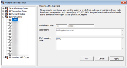

Standard Predefined Code 13 — Event Codes
Figure 2-5 Sample Predefined Event Codes
This code is used to configure system event code. In the below example, the system event code LOAD for application starting is mapped to standard predefined code 13 and predefined ID 13001.
This appears in <event> under <cashregister> element on the report.

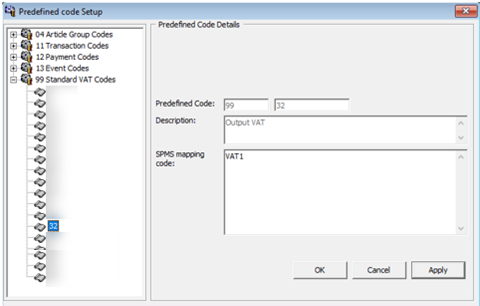

Standard Predefined Code 99 – Standard VAT Codes
Figure 2-6 Sample Predefined VAT Codes
This code is used to configure system VAT code. In example abov (Figure 2–6), the system VAT code VAT1 is mapped to standard predefined code 99 and predefined ID 32.
This is displayed in <standardVatCode> under <vatCodeDetails> element on report.

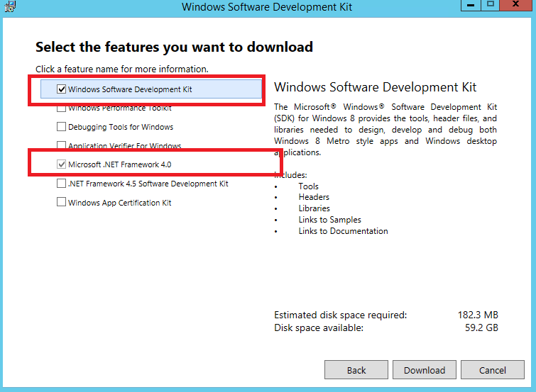

This method is recommended if the target machine is Windows 10 and Windows Server 2012. Download and install the Windows 10 SDK from: https://developer.microsoft.com/en-us/windows/downloads/sdk-archive.
Start the installation and select the option as shown in below figure.
Figure 2-7 Windows Software Development Kit Options

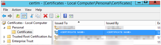

At the Search Windows prompt, type in Manage computer certificates to open the "certlm" console.
At the tree view on the left panel, expand the Personal folder under "Certificates - Local Computer, and then click the Certificates folder.
At the Certificates folder, look for the certificate issued to "Cruise Digital Signature" on the right panel.
Figure 2-8 Certificates Repository on Local Computer
Double-click to open the certificate and ensure it contains the private key. You should see the golden key icon with this message: "You have a private key that corresponds to this certificate" under the General tab.

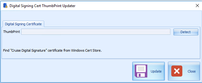

Although the key pair is stored in the Windows certificate store, SPMS must manage the key version. Every new key pair used in SPMS will be recorded in the KEY table of the SPMS schema.
Log in to the OHC Tools module.
At the ribbon bar, click the Update Cert ThumbPrint.
At the Digital Signing Certificate window, click Detect for the program to look up the certificate name < CERTIFICATE NAME>" and obtain the ThumbPrint of the public key.
Figure 2-9 Digital Signing Cert Thumbprint Updater
Click Update to store the key in the KEY table.
