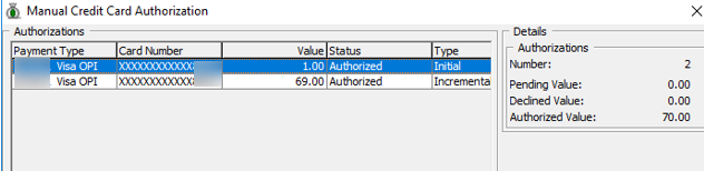

Viewing Authorization Amount
Log in to OHC Management module and navigate to the Guest Handling screen.
In the Search Panel, browse for the guest account.
Navigate to the Credit Card tab in the guest account. The registered card should be in Active mode.
To display the authorization, select the credit card and click View Authorization.

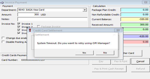

The settlement triggered by the Pay Invoice button whether to send in an online or offline request is based on the Enable Online Settlement parameter. If the parameter value is ‘1’, it sends to OPI immediately. Otherwise, it is processed by OPI Manager.
When Vendor Has No Internet
For the Enable Online Settlement parameter = 1:
When the Settlement response with <> OK and <> TO, the system inserts a record with -1* POS amount into table POS to offset the credit amount. This is to ensure the invoice balance does not become 0 when the settlement failed.
On time-out (TO), you have the option to either retry the transaction at OPI Manager or terminate the transaction per the following process:
Yes: The OPI Manager processes the transaction and sets the CCT_STATUS to 4. The number of retries is set in the Number of retry for Outstanding Incremental Process parameter. Once it reaches the maximum number of retries, the system sets the CCT_STATUS to 5 and inserts a record with -1* POS amount into the POS table.
No: The transaction is terminated and CCT_STATUS is set to 6. The system inserts a record with -1* POS amount into the POS table.
The system sets the CCT_STATUS to 5 and inserts a record with -1* POS amount into table POS.
Figure 4-2 System Timeout

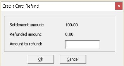

To perform the refund,
Login to OHC Management / OHC Crew module.
In the Cashier Menu, select a checked-in guest that you wish to refund with a credit card payment.
Under the Invoice tab, click the Credit Card Refund button. This launches the Credit Card Refund window, showing the Settlement amount, Refunded amount, and Amount to refund.
Settlement Amount: The selected settlement amount
Refunded Amount: Total refunded amount for the selected settlement
Amount To Refund: User input amount to refund
Figure 4-3 Credit Card Refund window
Insert the value in Amount to refund and click OK button to proceed. The sum of the Refunded amount and Amount to refund must not exceed the Settlement amount.
A success message is shown when the refund is successful.
The refunded amount is reflected in the Invoice tab, Credit column as a negative amount.
