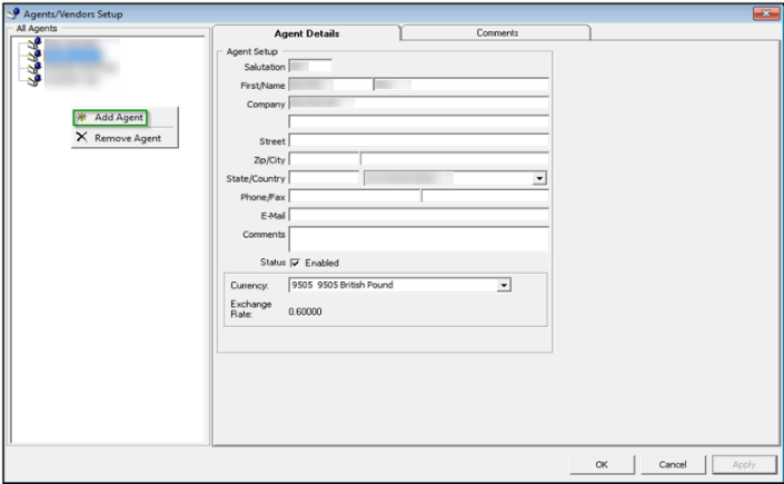

Vendors
The Vendors Setup is used to store contact details of vendors fulfilling the ground arrangements, supplying equipment or other services for the tours.
Figure 3-1 Vendor/Agent Setup
This figure shows the Vendor/Agent Setup window.
  1. From the Agents/Vendors Setup window, right-click and select Add Agent.
  2. Enter the agent’s details and then navigate to Comments tab to add an additional comment or document image.
  3. In the Comments tab, select Add Comment to enter a new comment by inserting the relevant details.
  4. Navigate to the Document tab to upload, scan or export an image file and then click Save.
  5. Click OK to save the agent details.

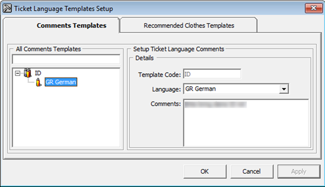

Ticket Language Template Setup
The Ticket Language Template Setup allows you to create comment templates and the recommended clothing templates used in Shore Excursion in different languages. This function only works when the Language Module Setup is activated. Once enabled and if no language is selected during booking, the system will use the default language.
Figure 3-2 Ticket Language Templates Setup
This figure shows the Ticket Language Templates Setup.
  1. From the Setup menu, select Ticket Language Template Setup.
  2. Select either the Comments Templates or the Recommended Clothes Templates tab.
  3. Right-click and select Add Template.
  4. At the Code field, enter the code ID and comments, and click Apply.
  5. Right-click the newly created code and select Add Language.
  6. At the form, select the Language from the drop-down list and enter the comments and click Apply.

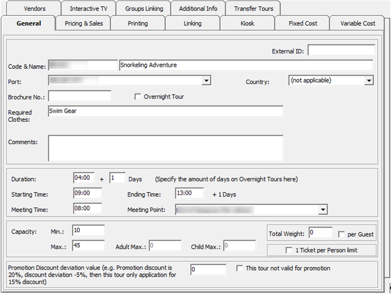

A Tour Template enables you to create a base for recurring tours instead of creating the tour individually.
Tour Templates Tabs and Descriptions
Figure 3-3 Tour Templates General Tab
This figure shows the Tour Templates General tab.
Table 3-2 Field Description of Tour Templates General Tab
Field Name Description
External ID
External ID.
Code & Name
Short Code and Name of the tour.
Port
Port of the tour, selectable from the drop-down menu.
Country
Country of the tour, selectable from the drop-down menu.
Brochure No.
Brochure Number in the cruise catalogue number.
Overnight Tour
Sets the tour as an overnight tour when selected.
Required Clothes/ Comments
Additional information to be printed on tour ticket.
Duration & Times
Duration of the tour, Starting/Ending Time/ Meeting Time and Meeting Point of the tour.
Capacity
Max/ Min seat capacity of the tour.
Adult/ Child Max
Max seat capacity for an adult/ child of the tour.
Total Weight
Max total weight allowed for the tour.
Total Weight per guest
Sets the max weight per guest allowed for the tour when selected.
1 Ticket per person limit
Sets the purchase to allow one ticket per person after selected.
Promotion discount deviation value
Discounts deviation value for the tour.
This tour not valid for promotion
Disables the tour from promotional sale when selected.

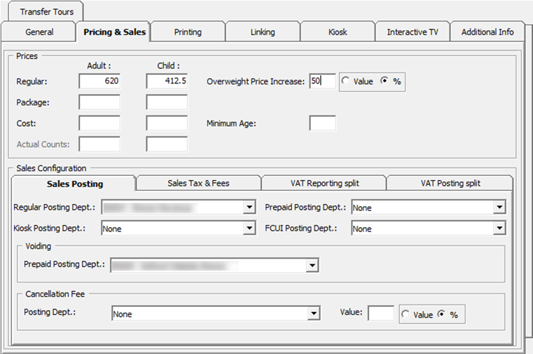

Figure 3-4 Tour Template Pricing and Sales Tab
This figure shows the Tour Templates Pricing and Sales tab.
Table 3-3 Field Description of Tour Templates Pricing and Sales Tab
Regular Adult/Child Price
Tour selling price for an adult/ child.
Package Adult/Child Price
Tour package selling price for an adult/ child.
Cost Adult/Child
Tour costs for the adult/ child. Cost prices text boxes are disabled in order to display-only. This field gets updated automatically when adding a new booking or voiding an existing one based on the variable cost applied.
Actual Counts Adult/ Child
Actual Tour counts for an adult/ child for the tour.
Overweight Price Increase
Value or percent to increase if overweight occurs.
Minimum Age
The minimum age allowed for the tour.
Posting Departments
Reference to Financial Setup, Department Code setup.
Voiding Departments
Cancellation Department & value
Cancellation fee definable in value or percentage. Reference to Financial Setup, Department Code setup for posting code.
Sales Tax & Fees
Sales Tax & Fees Tab:
  • Sales Tax definable in value or percentage.
  • Additional Fees definable in value or percentage.
VAT Reporting Split
VAT Reporting Split Tab:
For reporting purposes. Use of different VAT percentages resulting from the selling of excursion in order to produce a report where the respective VAT classes.
The four ype of VAT categories are user definable. You can change the label name from Administration module, System Setup, Label Setup.
VAT Posting Split
VAT rate in percentage or price used for posting.

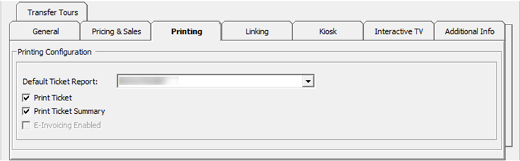

Figure 3-5 Tour Template Printing Tab
This figure shows the Tour Template Printing tab.
Table 3-4 Field Description of Tour Templates Printing Tab
Default Ticket Report
Default ticket report used for ticket printing for the tour, selectable from the drop-down menu.
Print Ticket & Ticket Summary
After selected, ticket and ticket summary are printed upon posting of the tour.

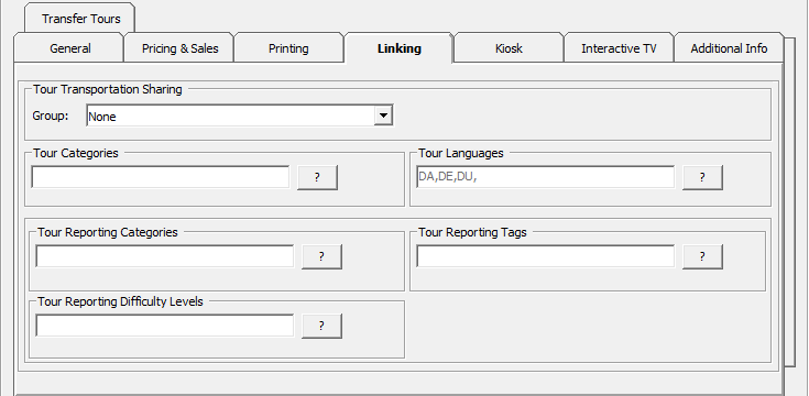

Figure 3-6 Tour Template Linking Tab
This figure shows the Tour Template Linking Tab
Table 3-5 Field Description of Tour Template Linking Tab
Tour Transportation Sharing
Link tour transportation sharing for the tour, selectable from the drop-down menu. In Bookings window, all the bookable tours boxes have the tour transportation sharing code with the yellow background.
Tour Categories & Languages
Link tour categories and languages for the tour, selectable from the drop-down menu. See Language Module Setup and Ticket Language Template Setup for more information
Tour Reporting Categories, Tags & Difficulty levels
Link tour reporting categories, tags, and difficulty levels for the tour, selectable from the drop-down menu.

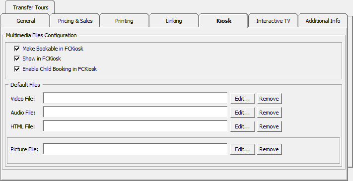

Figure 3-7 Tour Templates Kiosk Tab
This figure shows the Tour Templates Kiosk Tab
Table 3-6 Field Description of Tour Templates Kiosk Tab
Make Bookable in Kiosk.
Sets this tour as available for booking by using the Kiosk
Show in Kiosk
Sets this tour as visible in the Kiosk.
Enable Child Booking in Kiosk
Sets this tour as available for child booking by using the Kiosk.

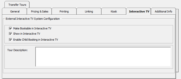

Figure 3-8 Tour Templates Interactive TV
This figure shows the Tour Templates Interactive TV tab
Table 3-7 Field Description of Tour Templates Interactive TV
Make Bookable in Interactive TV.
Sets this tour as bookable in Interactive TV.
Show in Interactive TV.
Sets this tour visible in Interactive TV.
Enable Child Booking in Interactive TV.
Sets this tour available for child booking in Interactive TV.
Tour Description
Additional details for the tour.

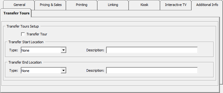

Figure 3-9 Tour Templates Transfer Tours
This figure shows the Tour Templates Transfer Tours tab
Table 3-8 Field Description of Tour Templates Transfer Tours
Transfer Tours
Select the check box to mark the tour as a transfer tour.
Transfer Start Location
The start location of the tour.
Transfer End Location
The end location of the tour.
  1. Select Transfer Tour if the tour is a transferred tour.
  2. Select Transfer Start Location type, for example, Airport, Hotel, Train station.
  3. Enter Transfer start location description.
  4. Select Transfer End Location type and enter the description.

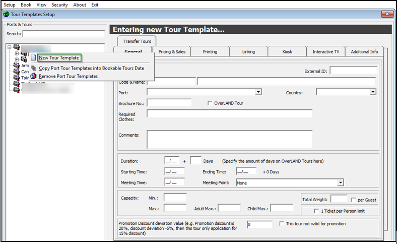

New Tour Template
  1. From the Setup menu, select Tour Template Setup.
  2. Expand the Country tree view and select the country the template resides. These are grouped by the field selection in General Tab, Port or Country.
  3. Right-click and select New Tour Template.
    Figure 3-10 Tour Templates Setup
    This figure shows the Tour Templates Setup, where a new tour template is setup.
  4. At Tour Template window, in the respective tabs, insert all the relevant information such as price, meeting time/location, weight/clothing/equipment requirement, and transport arrangements. See Table 3-2for a description of the available fields.
  5. Click Apply to save the template and close the form.

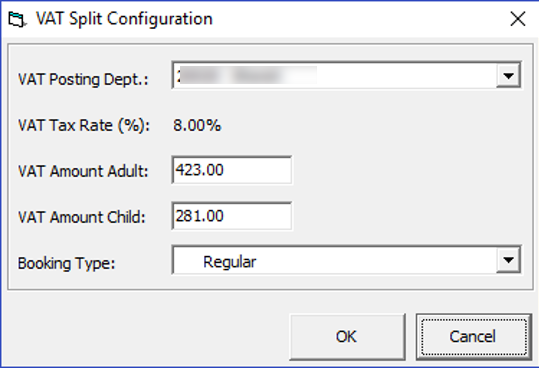

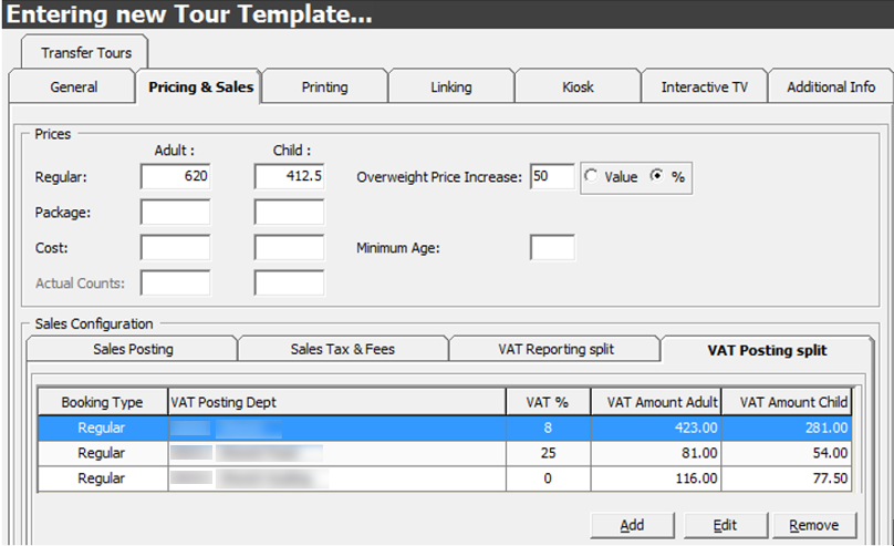

Setting up Tour Template with VAT Split
The VAT Tax Split feature enables different tour elements to have different VAT Tax assignments.
In the following example, assume the tour is priced at $620 and comprises three elements that have different VAT Tax and pricing:
Table 3-9 Example Of Price and VAT Breakdown
Item Cost VAT%
Excursion

  1. At the Financial Setup window, create the Department Code and associate the corresponding VAT Tax Class.
  2. At the Tour Template Setup, navigate to Pricing & Sales, VAT Posting Split tab.
  3. Click Add to add the VAT Department.
  4. At the VAT Split Configuration window, select the Posting Department from the drop-down list, enter the Amount for Adult/Child and select the Booking Type.
    Figure 3-11 VAT Split Configuration Window
    This figure shows the VAT Split Configuration window.
  5. Click OK to save and repeat the steps above for the other elements.
    Figure 3-12 VAT Posting Split in Pricing and Sales
    This figure shows the VAT Posting Split in Pricing and Sales Tab
  6. When copying the template from Port Tour Template into Bookable Tours Date or Tour Template into Bookable Tour, it copies the VAT Posting Split setup to the selected port date. The same applies when copying using Copy Date Bookable Tours into another Date in Bookable Tours Setup.
    The formula to calculate the VAT Posting Split is: Total - round (Total / (1+VAT_RATE)/100).

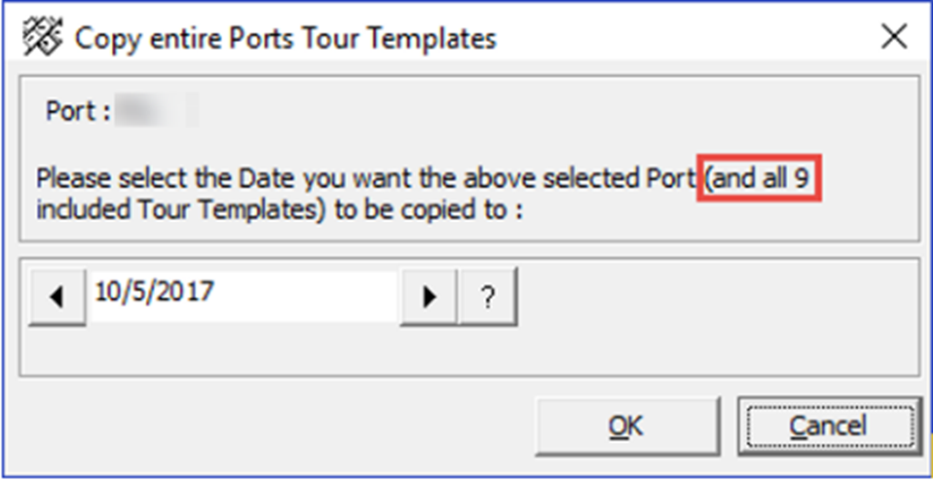

Copy Template by Batch
  1. At the Tour Templates Setup, expand the tree view and select the port. The total number of templates linked to the port is shown in a bracket ( ).
  2. Right-click and select Copy Port Tour Templates into Bookable Tours Date.
  3. At the Copy entire Ports Tour Templates window, select the desired date using the date editor.
    Figure 3-13 Copy Port Tours Templates
    This figure shows the function to copy the Port Tour Templates into Bookable Tours
  4. Do note the number of templates to copy across before proceeding. Click OK to confirm or Cancel to abort.
Copy Template Individually
  1. At the Tour Templates Setup window, expand the tree view until you see the template name or codes.
  2. Right-click and select Copy Tour Templates into Bookable Tours Date.
  3. At the Copy selected Tour Template window, select the desired date using the date editor.
  4. Click OK to proceed or Cancel to abort.

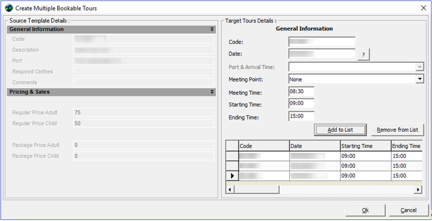

Create Multiple Bookable Tours
The Create Multiple Bookable Tours enables you to create a tour from a single template across multiple dates.
Figure 3-14 Create Multiple Bookable Tours
This figure shows the Create Multiple Bookable Tours window where you can set up multiple tours from one location.
  1. Repeat step 1 of Copy Template Individually.
  2. Right-click and select Create Multiple Bookable Tours.
  3. At the Target Tour Details section, select a date and click Add to List.
  4. Repeat until you have all the dates.
  5. Click OK to confirm.

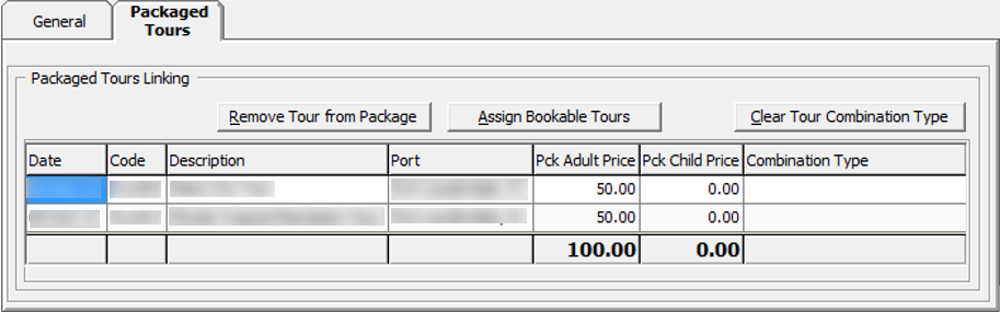

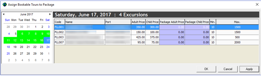

  9. For the Link to Package Combination Type, the package tours shown in the Combination Type column are the combined package.
    Figure 3-15 Package Tours Link
    This figure shows the option to link a tour to a Package Tour.
  10. Navigate to the tab and click Assign Bookable Tours to assign the bookable tours.
    Figure 3-16 Assign Bookable Tours to Package
    This figure shows the Assign Bookable Tours to Package window, where you assign tours to the bookable package dates.
  11. Select the date and tour to assign.
  12. Click Apply and select another tour to add to the package.
  13. Click OK to return to the previous window.
  14. Define the price per adult/child in the grid.

Adding new Bookable Tour
  1. From the Setup menu, select Bookable Tours Setup.
  2. At the Bookable Tours Date editor, right-click the desired date and select New Bookable Tour.
  3. Fill in all the required the details of the tour in each of the tabs.
  4. Click Apply to save.

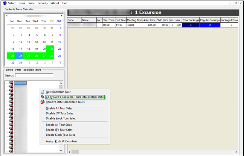

Copy Bookable Tour to another Date
Instead of creating a tour from scratch, you can copy the same Bookable Tour information into another date with this function.
Figure 3-17 Copy Bookable Date to another Date
This figure shows the option to copy Bookable Tours into another date.
  1. At the Date editor, select the date to copyin the tour from.
  2. Right-click and select the Copy Date’s Bookable Tours into another Date option.
  3. At the Copy Entire Bookable Tours Date window, select a new date to copy to.
  4. Click OK to proceed. Note that only the non-existing tours are copied.
