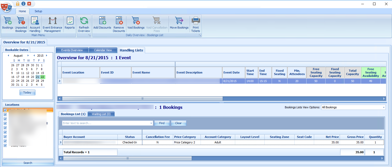

Event Overview
Calendar View
Handling List
Figure 2-1 Event Overview
A view of all bookable events according to the event start and end time.
List all events of the selected date, including information such as start and end time, seating type minimum / maximum attendees, total bookings, and others.
Figure 2-2 Calendar View
The Calendar View displays the weekly events of the selected date in time order. Scrolling downwards moves the date forward by one week.
Figure 2-3 Event Handling List
The Handling Lists provide an overview of the selected event allowing you to manage the event from one location. It lists the details and total number of events of the selected date in the grid. A list of the bookings appears in the Booking List tab while the Waiting List tab lists all of he guests on waiting lists. The total number of bookings for the event is shown on the far right side aof the grid. Scroll right to view the remaining columns.

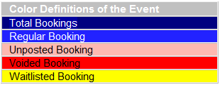

Figure 2-4 Color Definition
Booking List
Under the Booking List tab, you can perform functions such as Add Discounts, Void, Move Bookings, and Print Tickets. See the Account Handling for more details.

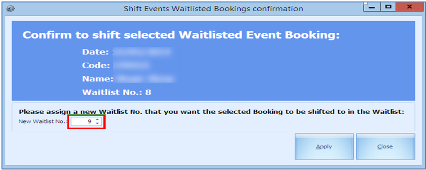

You can select All, to remove all the waitlist booking from the grid.Shifting a Waitlist Booking
This function enables you to reorder the waitlist booking, depending on the new number you insert. For example, if the current waitlist number is eight and the new waitlist number is ten, it will move this booking to the bottom of the list.
Select the booking to shift from the Waiting List tab.
Click the Shift Waitlisted Bookings button at the ribbon bar.
Insert a new waitlist number and click Apply.
Figure 2-5 Shift Events for Waitlisted Bookings

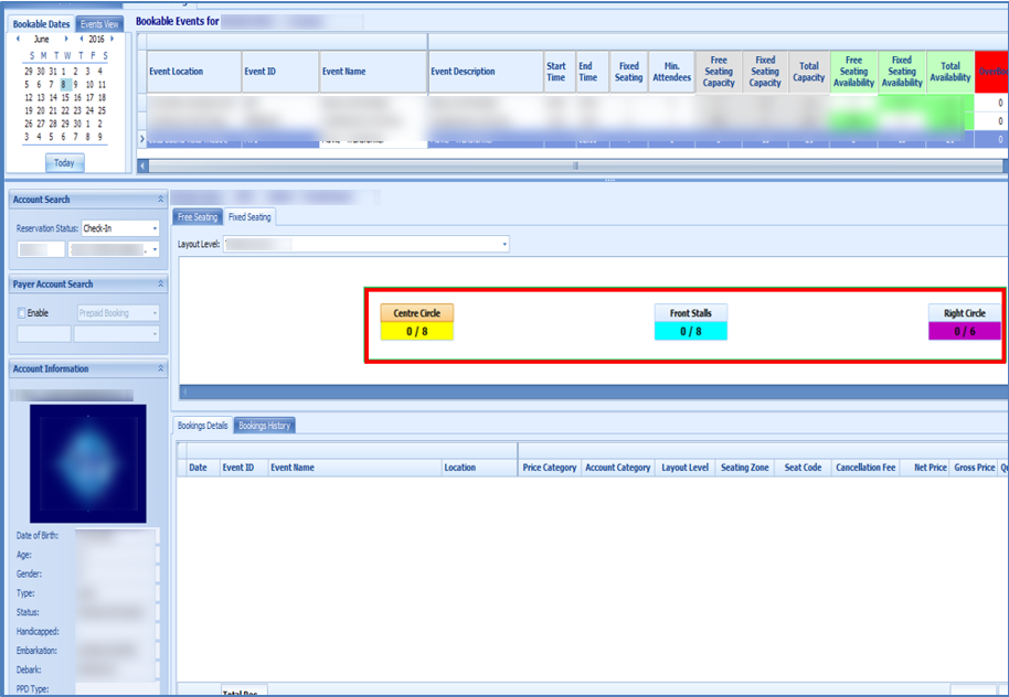

Figure 2-7 Bookable Event Fixed Seating Tab
Bookable Date View: Shows the bookable event by date in a calendar view.
Events View: Enables you to search for events of the same ID.
Bookable Date View
Dates marked with green denotes the event available for that date.
Dates marked with gray are the selected date sand correspond to the date shown in Dates, Locations, and Events.

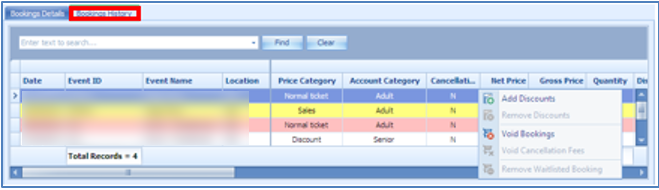

The Booking Details tab displays details of the selected event, total records and prices. Functions such as Add Discounts, Remove Discounts, Void Bookings, Void Cancellation Fees, and Move Bookings can be performed by right clicking the selected booking or using the button on the ribbon bar.
Booking History
Figure 2-8 Booking History
This tab displays the history details of event previously booked. Scroll to the right for more information.

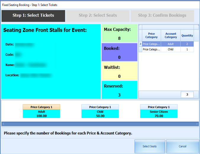

Fixed Seating Booking
Before you can book a seat using Fixed Seating, make sure you have the event location and layout setup. See Locations Layout and Creating Layout Template for more information.
Select an event from the Event Bookings tab. Select a guest and select a fixed seating event.
Under the Fixed Seating tab, select a layoutfrom the drop-down list. The available pricing for the selected layout is displayed, for example ‘0/8’ in the xxx Price Category. “0” indicates the number of tickets booked while “8” indicates the total number of tickets available.
Select a Price Category and the number of tickets.
Click Select Seats to go to Step 2:Select Seats and allocate a seat number. The default layout view for this booking is Booking View. You can change the view to Zones or Type.
Click Book Seats.
At the Step 3: Confirm Booking tab, verify the information shown and click Confirm Bookings to complete the booking.
Figure 2-9 Fixed Seating Booking Step 1: Select Tickets
Layout View by Zones, Types or Bookings
The information shown in the Layout by Zones and Types is similar. It lists the availability of the seating zones and corresponding colors, whereas the Bookings view lists the booking information of the selected seat.

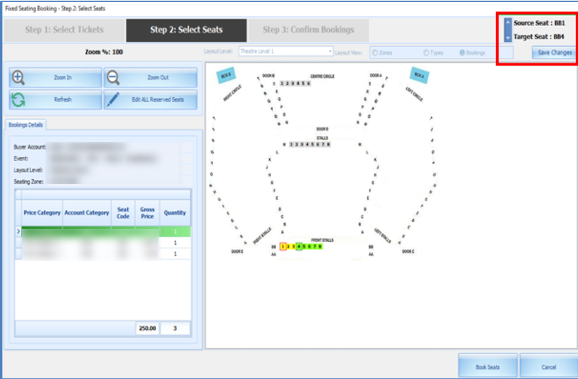

Relocating Seat in Step 2 of the Booking Wizard
Figure 2-10 Fixed Seating Booking Step 2: Select Seats
To move an allocated seat to another in Step 2: Select Seats:
Select Edit ALL Reserved Seats. This button toggles to Stop Editing ALL Reserved Seats and vice versa when clicked.
Select a new seat code to begin from the layout.
For example, the assign seat is BB1-BB3 and selecting BB4, will move all three seats to BB4-BB6.
If the number of the allocated seats is less than the seats you are moving, a warning message appears.
Click the Stop Editing ALL Reserved Seats once all seats are moved.
Click Save Changes to update the layout view and at the grid.
Once confirmed, click Book Seats to go to next tab, Step 3: Confirm Bookings.
Complete the booking by clicking Confirm Bookings.
