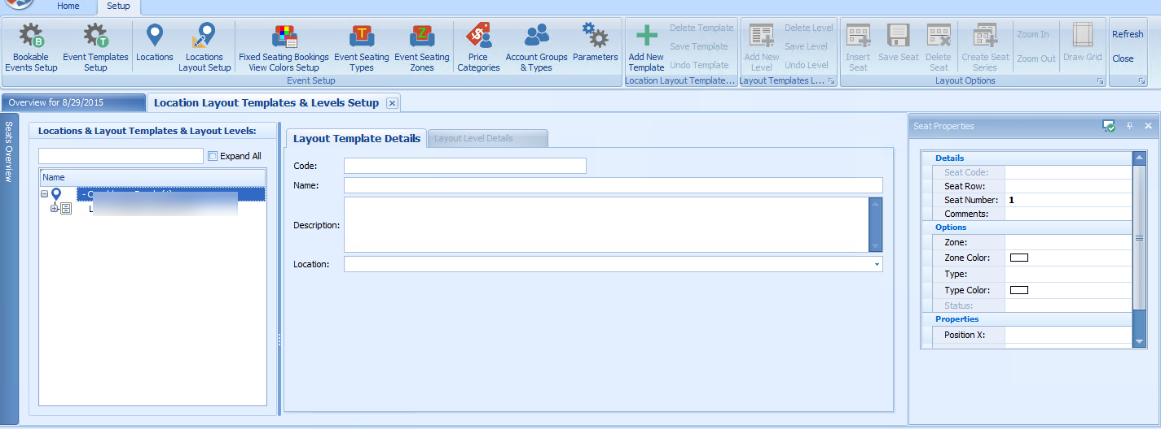

Locations Layout Setup
Layout Template Details
Layout Level Details
At the Setup tab, click Locations Layout Setup.
Click Add New Template to create a new template.
Enter all the information and click Save Template and then Close.

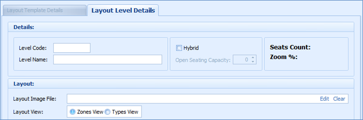

Figure 1-1 Layout Level Details
Select a layout template that you created earlier.
Click the Add New Level button.
Enter the Layout Level Details consisting of Level Code, Level Name, Hybrid, Open Seating Capacity, Layout Image File, and Layout View.
Click Save Level to save.
Creating Layout Template
Figure 1-2 Layout Template
You can add a template, delete, save or undo the previous change made on the template. After creating the location template, add a new level for the template or define the seating zones by location.
One location can have multiple templates.
One template can have multiple layouts.

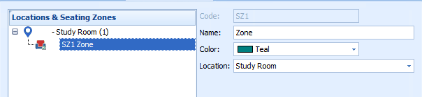

Figure 1-4 Event Seating Zones
This function allows you to define the zone for use in seating plan setup.
At the Setup tab, select Event Seating Zones.
Click Add New to add a new zone.
At the Seating Zones form, enter the code, name and select a color and location from the drop-down list.
Click Save.

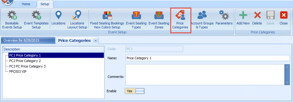

Use Price Categories to categorize the event by price, sales type, seating zones, and others.
Figure 1-5 Price Categories
Click Price Categories.
Click Add New to add a new pricing for the required category.
Enter a Code, Name, and Comment in the respective fields.
Click Save.
To delete a specific pricing category, move the mouse pointer over the required description, and click Delete.
Click Close to close this window.

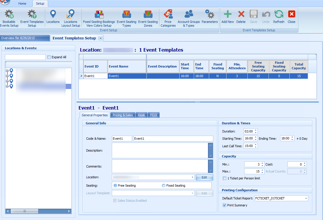

Figure 1-6 Event Templates Setup Details
Locations & Events: Displays the location name and type of events within the location.
Location Details for the Event ID: Displays the number of events templates created for the location with information such as Event ID, Event Name, Event Description, Start/End Time, Seating Type, Min/Max Attendees, Seating plan, Layout Template, and so on.
Event ID and Event Name Details: This section has four tabs: General Properties, Pricing & Sales, Kiosk, and FCUI, and Details of each tab are listed below.
General Info section: Code & Name, Description, Comments, Location, and Seating.
Duration & Times section: Duration, Starting Time, Ending Time, and Last Call Time.
Capacity section: Min, Max, and Cost.
Printing Configuration: Default Ticket Report.

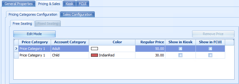

Figure 1-7 Bookable Event Setup — Pricing and Sales
Pricing Categories Configuration: Free Seating – Price Category, Account Category, Color, Regular Price, Show in Kiosk, Show in FCUI.
Sales Configuration: Sales Posting, Voiding Departments, Sales Tax and Cancellation Fee.
Use the Remove Price to remove the price category or the Edit Mode to add the required price category.Kiosk Sales enables you to define whether the ticket can be booked through the Kiosk or only to show the information. In the Multimedia Files Configuration, you can attach a video, audio or HTML file.

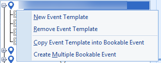

Creating New Event Template
Figure 1-8 New Event Template Options
Select Event Templates Setup.
Right-click the navigation tree and select New Event Template.
Enter all the required information in each of the tabs.

Copying an Event Template into Bookable Event
At the navigation tree, right-click the event you wish to copy.
Select Copy Event Template into Bookable Event.
At the dialog prompts “Please specify the Date you want the selected Event template to be copied to:”, select the new date and click OK to proceed.

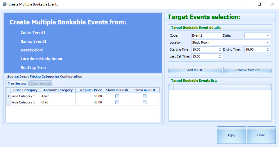

Creating Multiple Bookable Events
Figure 1-9 Create Multiple Bookable Events Form
The bookable event appears in the Code field.
In the drop-down list, select for Date, Location, Starting Time, Ending Time, and Last Call Time.
Click Add to List. Use Remove from List to remove unwanted events.
Click Apply to create.

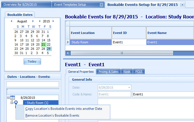

Ticketing By Location
Figure 1-11 Ticketing by Location Level
Copy Location’s Bookable Events into another Date.
Remove Location’s Bookable Events.
At the navigation panel, expand the date and right-click the event location.
Select the desired option. If you are copying the location to another date, select the new date when prompt.
At the confirmation prompt, click OK to proceed.
