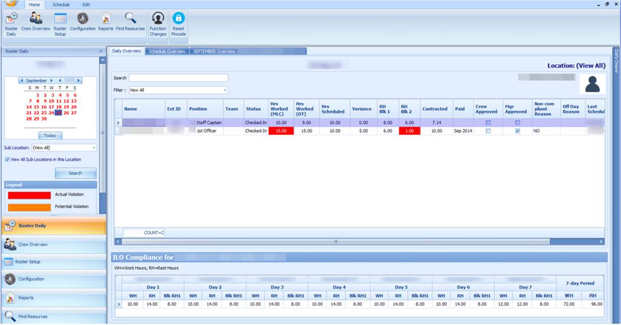

Daily Overview
Figure 4-1 Daily Overview in Time Approval Method
This figure shows the Daily Overview window in Time Approval Method.
Table 4-1 Field Definition of Daily Overview Tab
Field Name Definitions
Name

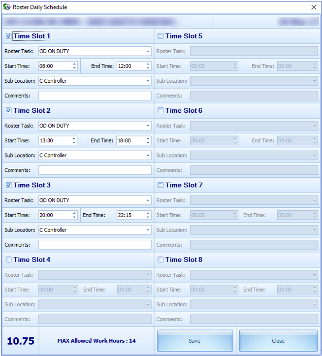

To view the start/end time of each time slot,
  1. Select the date from the Calendar Editor in the Roster Daily.
  2. Go to the Daily Overview tab and double-click the crew name to open the Roster Daily Schedule window.
Figure 4-2 Roster Daily Schedule
This figure shows the Roster Daily Schedule window where the start/end time of the schedule is shown.

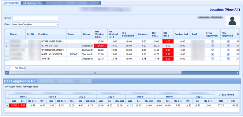

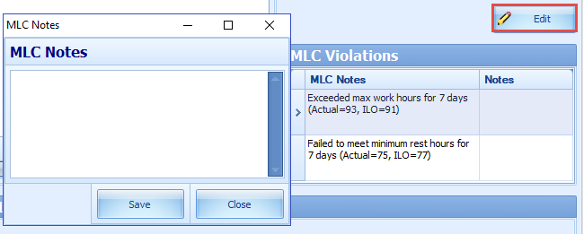

ILO Compliance
Figure 4-3 ILO Compliance in Daily Overview
This figure shows the day of the week in violation.
At the ILO Compliance section, the system automatically sets the columns in red when daily worked/rest hours violates the ILO Regulation. The hours shown in Worked Hours (WH) and Rest Hours (RH) are the accumulated daily worked/rest hour.
Selecting a crew will display the total WH and RH for seven-day period in the ILO Compliance section.
Modifying Roster Daily Schedule
The system allows you to modify a roster schedule created from the template by removing or adding new time slots. You are not allowed to modify or delete the schedule if the Roster has been paid through payroll. This function is only accessible by users that are granted with access rights “#3292 – Allow to Create & Modify Roster Schedule”.
In the Roster Daily Schedule window, select the time slot check box, enter the roster task, start/end time, and the sub location, and click the Save button. See Figure 4-2

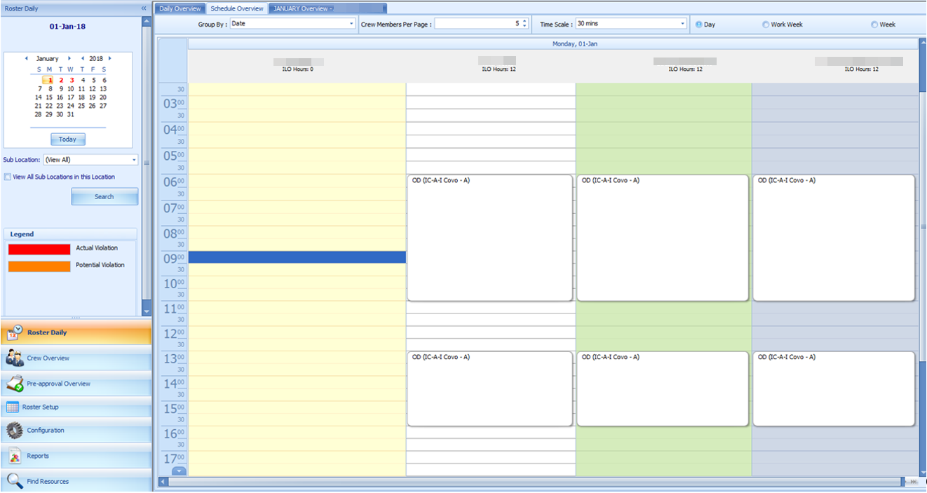

Schedule Overview
The Schedule Overview displays the crew schedules in a graph view, based on the following options and as shown in below figures.
Figure 4-4 Schedule Overview by Date
This figure shows the Schedule Overview Group by Date
Figure 4-5 Schedule Overview by Crew Members
This figure shows the Schedule Overview by Crew Members
Group By:
  • Date: Displays schedule by date.
  • Crew Member: Displays schedule by Crew Member.
Crew Members Per Screen:
  • Displays schedule with the number of members defined.
View:
  • Day View: Displays schedule by day.
  • Work Week: Displays schedule by the work week.
  • Week: Displays schedule by week.
  • Month: Displays schedule by month.
Time Scale:
  • Displays the hour in 15 or 30 minutes block.
Creating a Roster Schedule in Schedule Overview
A schedule can be added into the Schedule Overview tab using the drag and drop option or from a context menu.
Adding Schedule Using Context Menu
  1. At the crew name, select the time slot from the grid.
  2. Right-click to open the context menu.
  3. Select the task to add the schedule. This creates the bar graph in the Overview tab.
Adding Schedule Using Time Slot
  1. At the hour grid of the crew, double-click to open the Time Slot window.
  2. Select the Roster Task, Sub-Location from the drop-down list and insert a comment, if any.
  3. Select the Start and End Time for the task.
  4. Click OK to save. The system prompts:
    • An ILO Violation if the schedule hours is more than the allowed ILO hours per day
    • An Overlapping of Time Slots warning if the schedule is overlapping with others

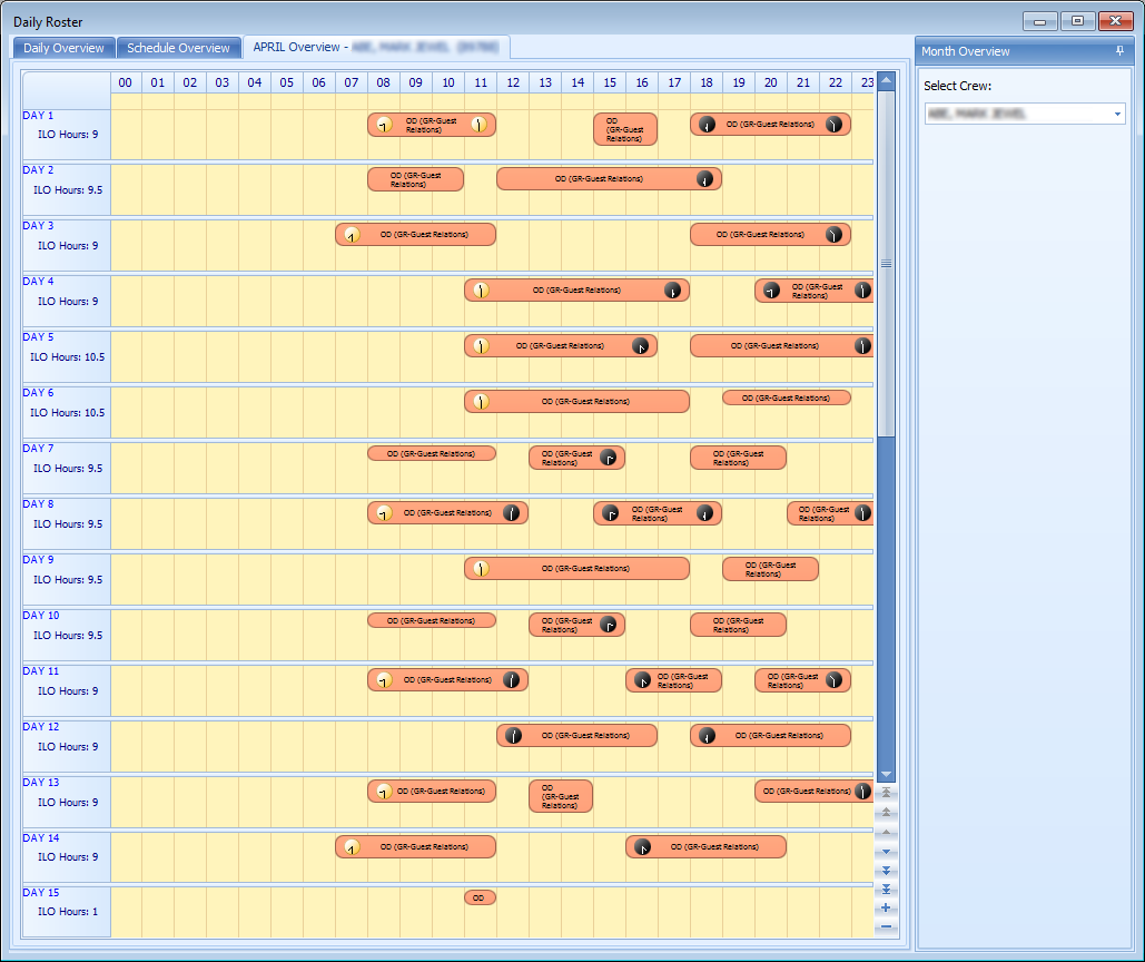

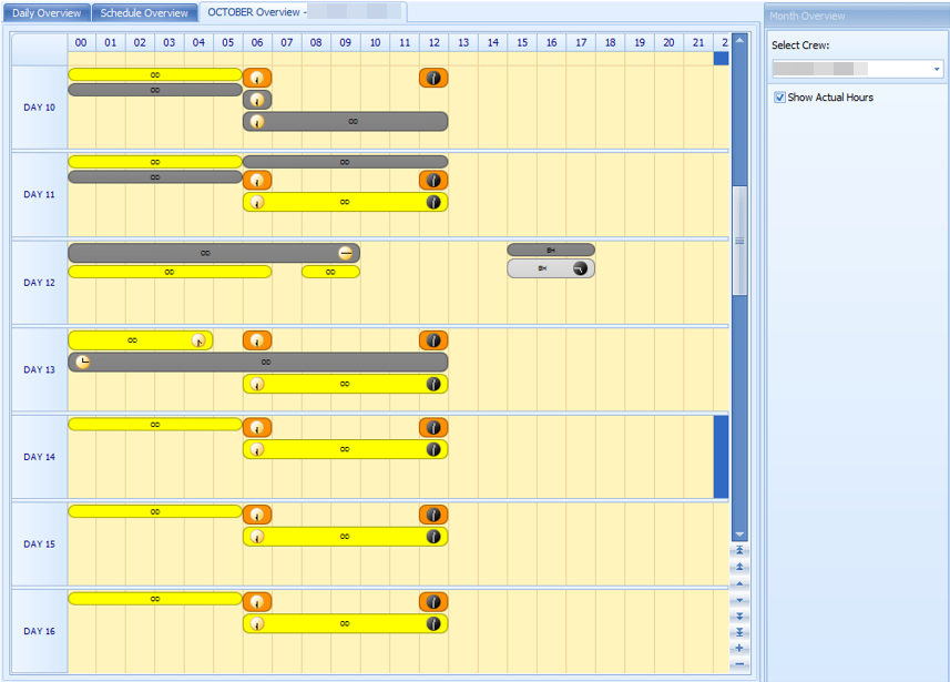

Monthly Overview
The Monthly Overview window provides an overview of the crew monthly schedule.
Figure 4-6 Monthly Overview
This figure shows the Monthly Overview tab in Roster Daily.
  1. From the Roster Daily, Calendar Editor, select the month to view.
  2. In the Daily Overview tab, select a crew and then navigate to the Montyly Overview tab to view the selected crew monthly schedule.
  3. To view another crew for the same month, select the name from the drop-down list. You can only select one crew at any given time.
  4. In the Monthly Overview tab, the same function as the Schedule Overview applies where you are allowed to add, modify, remove or paste a roster schedule.
  5. If the Time Attendance, Use Clock-In/Clock-Out parameter is enabled, the View Clock-In/Out menu button and Show Actual Hours check box will be available.
  6. Select the Show Actual Hours check box to show the crew actual clock-in/clock-out hours on the grid. The actual hours appear in grey color for each time slot.
    Figure 4-7 Monthly Overview Actual Hours View
    This figure shows the actual hours work in Monthly Overview.

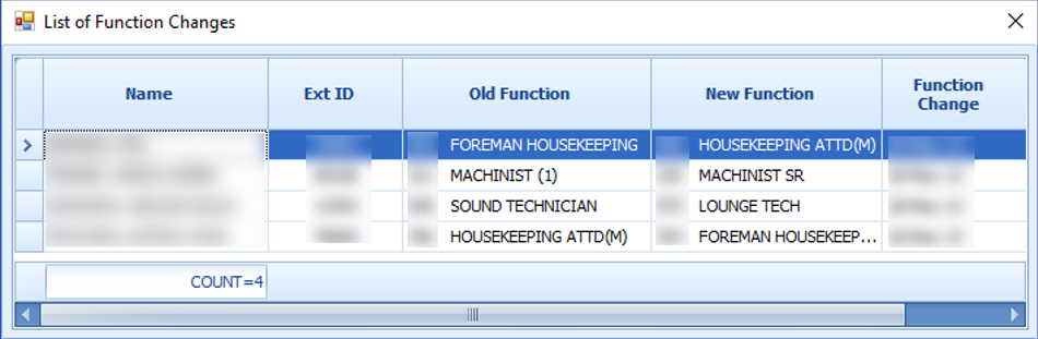

Function Change
The Function Change feature is an information window that lists all the position changes and the dates they were changed. The fields are not editable.
Figure 4-8 List of Function Change
This figure shows the lsit of Function Changes in Crew Roster.

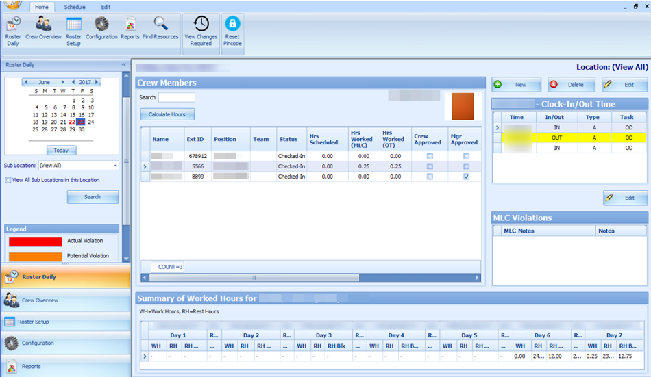

Daily Overview
Figure 4-9 Clock In/Out Daily Overview
This figure shows the Daily Overview in Clock In/Out Method.
The Daily Overview window is divided into the following multiple sections:
  • Calendar: Dates marked in red denotes dates with roster schedules created
  • Overview Tab: Lists all crew members that haves schedule on the selected date
  • Clock-In/Out Time: Clock-In/Out time recorded by the system
  • ILO Violations: Violations of work hours if any. Refer to the Legend indicators for type of violations
  • Summary of Worked Hours: A weekly summary of hours worked or rested
Viewing of Crew Schedule
  1. Select the date using the Calendar editor and the Sub-Location from the drop-down list.
  2. Click Search to refresh the window.
  3. In the Crew Member section, a list of crew matching the search criterion appears.
  4. Select a crew name and click Calculate Hours to refresh the information shown.
    1. At the Clock-In/Out Time section, the time logged for each task is shown.
    2. In the Summary Worked Hours section, the past week hours worked/rested is visible.
    3. If the crew work hours violates the ILO Compliance, a note is added to ILO Violations section.
See Table 4-1 description in Time Approval Method section.

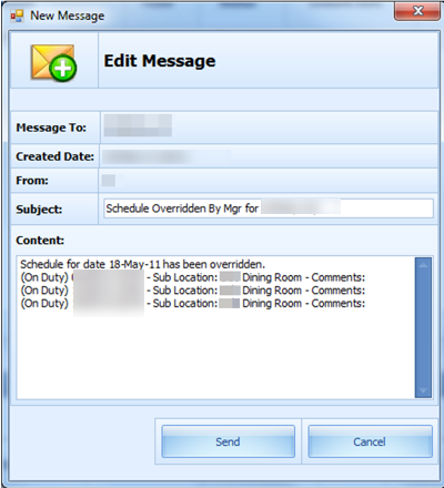

  • The system generates a notification message informing the crew of the schedule approval/unapproval
  • If the schedule is approved by the crew and changed by the manager, the crew is notified with a system generated message, indicating the reason for the change
    Figure 4-11 Schedule Change Notification
    This figure shows the Schedule Change Notification made by the manager.

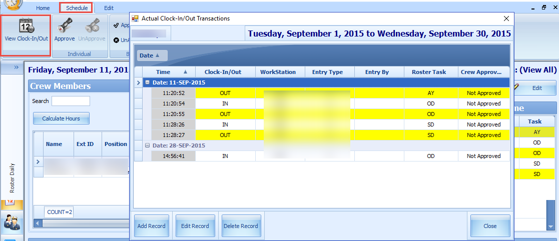

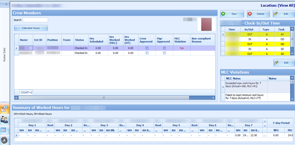

Editing Clock-In/Clock-Out Time
Figure 4-12 Clock-In/Clock-Out Transactions
This figure shows the Actual Clock-In/Clock-Out Transactions where you can add, edit or delete a record.
The system permits you to edit the clock-in/out time if needed using the following steps:
  1. Go to the Schedule tab and click the View Clock-In/Out button at the ribbon bar.
  2. At the Actual Clock-In/Out Transactions window, select a record to edit.
  3. Click the Edit Record button, alter the necessary details, and click Save.
  4. You can also click Add Record to insert a new clock-in/out record. The "Entered by" column is empty if the record is added/edited by the crew. Otherwise, the column displays the user name.
  5. Click the Delete Record tp prompt a confirmation window. Click Yes to proceed or No to return to the previous window.
To manually add a record, see: Manual Clock-In/Clock-Out.
Editing ILO Violations
The edit function in International Labour Organization (ILO) Violations enables the manager to view and input or edit the MLC notes.
To edit, click the Edit button and enter MLC Notes in the MLC Notes window and click Save to update.
Figure 4-13 ILO Violations
This figure shows the ILO Violations notes and function to edit the notes.

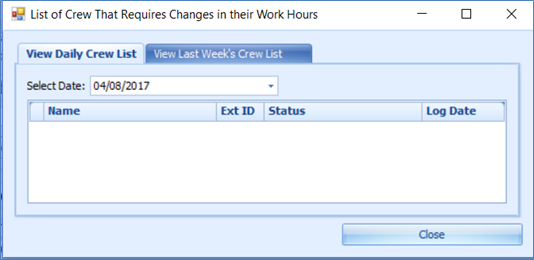

View Changes Required
Figure 4-14 Crew List Requesting Work Hour Change
This figure shows the list of crew requiring work hours change from View Changes Required function.
The View Changes Required function lists all changes requested by crew through the Time and Attendance Terminal, and the function is only accessible by the manager. A change request is generated when the crew presses Changes Required during Clock-In/Out at the Time and Attendance Terminal, Crew members are to discuss the change with their respective manager. It displays the daily/weekly or both daily/weekly request depending on the value defined in the Approved Weekly Hours parameter and/or the Approve Daily Worked Hours Clock-In/Out parameter.
To access this function, click the View Changes Required button on the ribbon bar. The information displayed on this window is a view only. See Editing Clock-In/Clock-Out Time or Manual Clock-In/Clock-Out section on how to change the information.

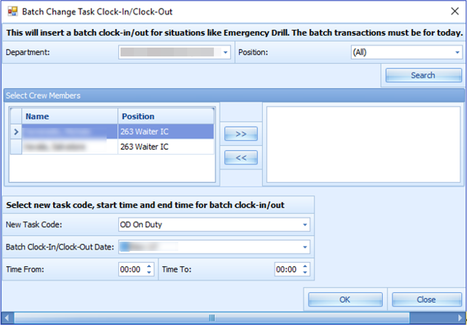

Batch Clock-In/Clock-Out
The Batch Clock-In/Out function allows the manager to perform a batch clock-in/out for the crew on selected tasks such as fire or emergency drill, based on the parameter set in Enable Batch ClockIn/Out. Use of this function is only permissible for users granted with privilege access #4686 - Batch Clock-In/Out. You can only post the batch clock-in/out for tasks past the server time and on the current system date.
  1. At the main window, navigate to the Schedule tab and click the Batch Clock-In/Out button from the ribbon bar.
    In the Batch Change Task Clock-In/Out window, select the Department and Position from the drop-down list, and click Search.
    Figure 4-15 Batch Clock-In/Out Task
    This figure shows the Batch Change Task in Clock-In/Out.
  2. At the Select Crew Members section, a list of crew matching the selection is shown. Select the names and click the double right arrow.
  3. Select the New Task Code, Batch Clock-In/Out Data and Time range from the drop-down list.
  4. Click OK to post the clock-in/out.
Below are the processes perform by the system automatically for the batch clock in/out.
  • For crews whose last transaction was a clock-in, the system performs:
    1. Clock-out with the task code that corresponds with the previous clock-in.
    2. Clock-in with the specified task code.
    3. Clock-out with the specified task code.
    4. Clock-in with the task code that corresponds with (i) and the time is 1 minute after the batch clock out time.
  • For crews whose last transaction is a clock-out, the system perform
    1. Clock-in with the specified task code.
    2. Clock-out with the specified task code.
