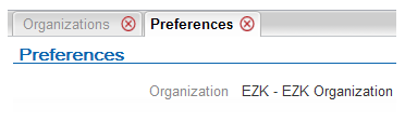

How to display this screen: Click
the Order Broker Preferences icon (
) for an organization
at the Organizations and Preferences screen.
Note: Available if Use Routing Engine is selected at the Tenant screen. Only users with Organization and Preferences authority can display this screen. See the Role Wizard for more information.

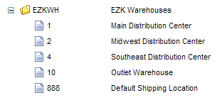

2. Click the plus sign next to the organization in the left-hand pane to display each location type for the organization if they are not already visible.
3. Location-type-level preferences: You can display the preferences for a location type by highlighting the location type name in the left-hand pane. 4. Click the plus sign next to a location type in the left-hand pane to display each location for the type.
5. Location-level preferences: You can display the preferences for a location by highlighting the location name in the left-hand pane. If you click the name of a location type or an organization in the left-hand pane, the tree-structure collapses to that level. For example, if you click the name of an organization while it is expanded to show location types, it collapses back to the organization level. |

Heading information The information displayed at the top of the screen varies depending on whether you are working with preferences for a specific location or location type, or for the organization itself. |
Organization |
When you first advance to this screen, the location hierarchy is collapsed to the level of the organization you selected at the Organizations and Preferences screen. The organization code is separated from the organization description by a hyphen (-).
See review preferences at a specific level for more information on how to work with preferences for an organization. Settings at the organization level: • The Use Probability Rules and Order Broker Settings are available at the organization level only. • The remaining preferences are Use Proximity Locator, No Offline Response Action, and Fulfillment tab settings. These preferences are available at all levels (organization, location type, and location); however, the organization-level settings apply if you do not set these preferences at the location type level or the location level. Important: You should set all preferences at the organization level in order to avoid unpredictable results. |

Navigational fields: Note: These fields are in the left-hand side of the Preferences screen, below the heading information. See review preferences at a specific level for information on advancing through these fields to display preferences for a specific organization, location type, and location. |
Organization |
An organization. |
Location Type |
Location |
A location. The location code is also displayed. |
