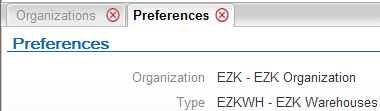

How to display this screen: Click the Order Broker Preferences icon (
) for an organization at the Organizations and Preferences screen.
Note: Available if Use Routing Engine is selected at the Tenant screen. Only users with Organization and Preferences authority can display this screen. See the Role Wizard for more information.

Heading information The information displayed at the top of the screen varies depending on whether you are working with preferences for a specific location or location type, or for the organization itself. |
Organization |
When you first advance to this screen, the location hierarchy is collapsed to the level of the organization you selected at the Organizations and Preferences screen. The organization code is separated from the organization description by a hyphen (-).
See review preferences at a specific level for more information on how to work with preferences for an organization. Settings at the organization level: • The Use Probability Rules and Order Broker Settings are available at the organization level only. • The remaining preferences are Use Proximity Locator, No Offline Response Action, and tab settings: Fulfillment tab, Standard Brokering tab, and Weighted Brokering tab. These preferences are available at all levels (organization, location type, and location); however, the organization-level settings apply if you do not set these preferences at the location type level or the location level. Important: You should set all preferences at the organization level in order to avoid unpredictable results. |
Type |
When you highlight a location type in the left-hand pane, its code and name are displayed at the top of the screen.
Settings at the location type level: • The Use Proximity Locator, No Offline Response Action, and Fulfillment tab settings at the location type level apply to locations of that type unless they are overridden at the location level. These settings override any settings at the organization level. • If a setting is set to Not Defined at the location type level, the organization-level setting applies. See review preferences at a specific level for more information on how to work with preferences for a location type. |
Location |
When you highlight a location in the left-hand pane, its code and description are displayed at the top of the screen.
Settings at the location level: • The Use Proximity Locator, No Offline Response Action, and Fulfillment tab settings at the location level apply to the selected location and override any settings at the location type or organization level. • If a setting is set to Not Defined at the location level, the location type-level setting, if any, applies; otherwise, if the setting is set to Not Defined at the location-type level, the organization-level setting applies. See review preferences at a specific level for more information on how to work with preferences for a location type. |
