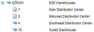

1. The organization associated with your Default Shipping System is selected by default. A blue arrow (
2. Optionally, click the plus sign next to the organization to display each Location Type for the organization if they are not already displayed. Again, a blue arrow next to the location type name indicates if there are any rules assigned at any level within the location type.
Note: If the organization includes a location type that does not include any locations, the location type is not displayed. |
3. Optionally, click the plus sign next to a location type to display each Location for the type if they are not already displayed. A blue arrow next to a location indicates if there are any rules assigned to that particular location.

Rule assigned? A blue arrow ( Note: To refresh the display of the blue arrows based on your activity at this screen, close the Probability Location screen and re-enter. |
