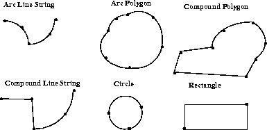

The object-relational implementation supports the types listed in Figure 1-1, as well as the types shown in Figure 1-2.
The object-relational model adds the following types to those previously listed:

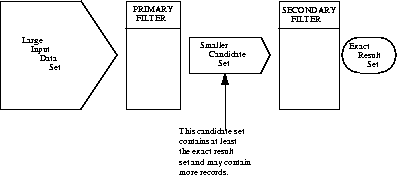

Spatial uses a two-tier query model to resolve spatial queries and spatial joins. The term is used to indicate that two distinct operations are performed in order to resolve queries. The output of both operations yields the exact result set.
The two operations are referred to as primary and secondary filter operations.
Figure 1-3 illustrates the relationship between the primary and secondary filters.
Spatial uses a linear quadtree-based spatial index to implement the primary filter. This is described in detail in following sections.
The function SDO_GEOM.RELATE() is used as a secondary filter. It evaluates the topological relationship-- such as whether two given geometries are touching, covering each other, or have any interaction.
Spatial does not require the use of both the primary and secondary filters. In some cases, just using the primary filter is sufficient. For example, a zoom feature in a mapping application queries for data that overlaps a rectangle representing visible boundaries. The primary filter very quickly returns a superset of the query. The mapping application can then apply clipping routines to display the target area.
The purpose of the primary filter is to quickly create a subset of the data and reduce the processing burden on the secondary filter. The primary filter therefore should be as efficient, that is selective yet fast, as possible. This is determined by the characteristics of the spatial index on the data.

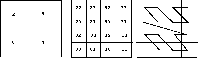

The process of determining which tiles cover a given geometry is called tessellation. The tessellation process is a quadtree decomposition, where the two-dimensional coordinate space is broken down into four equal-sized covering tiles. Successive tessellations divide those tiles that interact with the geometry down into smaller tiles, and this process continues until the desired level or number of tiles has been achieved. The results of the tessellation process on a geometry are stored in a table, referred to as the SDOINDEX table.
The tiles at a particular level can be linearly sorted by systematically visiting tiles in an order determined by a space-filling curve as shown in Figure 1-4. The tiles can also be assigned unique numeric identifiers, known as Morton codes or z-values. The terms tile and tile code will be used interchangeably in this and other sections related to spatial indexing.

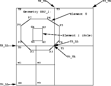

Figure 1-9 illustrates how geometry OBJ_1, represented using the object-relational implementation, is approximated with hybrid indexing (SDO_LEVEL = 1 and SDO_NUMTILES = 4). These are not recommended values for SDO_LEVEL and SDO_NUMTILES; they were chosen to simplify this example. The cover tiles are stored in the SDOINDEX table as shown in Table 1-2. Note that the tiles have been numbered for simplicity and do not reflect the format used in Spatial.
Decomposition of the GeometryIn Figure 1-9, note which fixed-size tiles are associated with geometry OBJ_1. Only three (T0, T2, T3) of the four large tiles (T0, T1, T2, T3) generated by the tessellation actually interact with the geometry. Only those are stored in the SDOINDEX table. In examining which variable sized tiles are used, tile T0 shows a further tessellation to four smaller tiles, two of which (T02, T03) are used to cover a portion of the geometry. The variable-sized tiles are stored in the SDO_CODE column in the Spatial index table. The fixed-size tiles are stored in the SDO_GROUPCODE column. The spatial index structure is discussed in Section 2.4.
Table 1-2 Section of the SDOINDEX Table
As with the fixed-size tile model, all elements in a geometry are tessellated in one step. In a multielement geometry like OBJ_1, Element 1 is covered by a redundant tile from the tessellation of Element 0 but the tile, T2, is stored only once.

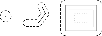

The other secondary filter, WITHIN_DISTANCE, determines if two spatial objects, A and B, are within a Euclidean distance of one another. First it constructs a distance buffer, Db, around the reference object B. It then checks that A and Db are non-disjoint.The distance buffer of an object consists of all points within the given distance from that object. Figure 1-11 shows the distance buffers for point, line, and area objects. Notice how the buffer is rounded near the corners of the objects.
