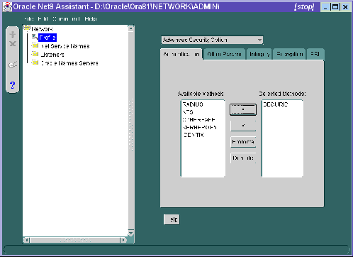

You configure SecurID authentication either by using Net8 Assistant, or by modifying the sqlnet.ora file with any text editor.
This graphical interface tool makes it easy to set parameters in the sqlnet.ora file and other Oracle8i configuration files.
In the Net8 Assistant's left pane, click the Profile folder. Then go to the drop down list box at the top of the right pane, and select Advanced Security Option. The tabbed pages for the Oracle Advanced Security option appear.
Go to the menu bar and click File > Save Network Configuration.
The following pages tell you how to set each parameter.
Do this by setting the SQLNET.AUTHENTICATION_SERVICES parameter.
